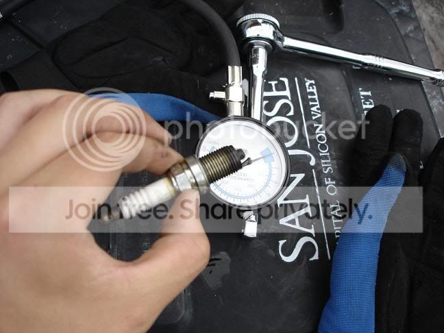

Finnaly did a Compression check on my motor today .... here are my numbers i got from Left to right Cyclinders... (155) (140) (135) (0) .... as I pulled out the last spark plug in Cycliner 1 there was oil all over it...and as you can see on the pix the spark plug is toast... could this have been the cause of my motor failing?? is there anyway i can fix the motor without buying a whole new LS engine?
also I think my seals are tost on my turbocharger as well because theres oil leakin between the DP and exhaustside of the turbo..... man I'm screwed...

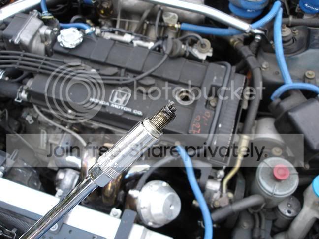

Is the spark electrode missing in the pic where your holding it up? If its not on the spark plug, its prolly floating around in the CC or messing up your turbine blades.... O wait your getting a new turbo... So what management were you running and how many lbs of boost and when did it blow?

detonation.....i can feel it in the AIR. Usually it causes the plugs to get fucked up like that and would be the reason for ur rings goin.

no sir... this is what we call pre-ignition. completly different from detonation. detonation normally will not melt things, pre-ignition will.
pre-ignition comes from running the car too lean, running with spark plugs that are too hot or a hot spot in the chamber that ignites the mixture. pre-ignition melts everything, chances are you have a melted piston

That's what mine looked like after I got a little detonation and busted up my pistons. It's a pretty common occurrence in boosted Hondas. I'd guess you need an engine rebuild. It might be cheaper and easier just to get another LS engine.

You think so? I was thinking that looks like the plugs that came out of my engine the first time I blew it up from detonation. Would the insulators be intact if he got it hot enough to melt the piston?

detonation wont do that by itself... but detonation can lean to pre-ignition
on a normal basis things in the engine are happy, detonation makes everything quite a bit hotter and will eventually lead to pre-ignition

were you at wot when you ran out? going really lean under load would cause pre ignition, which is what would cause your spark plug to look like it got prison raped

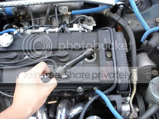

on the 2nd picture (i forgot to add) that there was oil all over the wire and sparkplug... the other sparkplugs and wires didnt have oil on it .... any clues?

Oil in your intake charge will dilute your fuel causing detonation :-/
