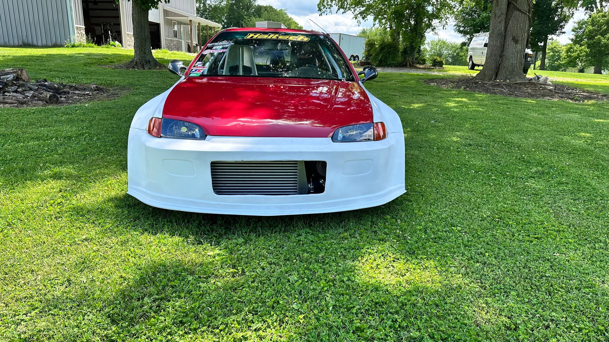

Originally Posted by r-boost77

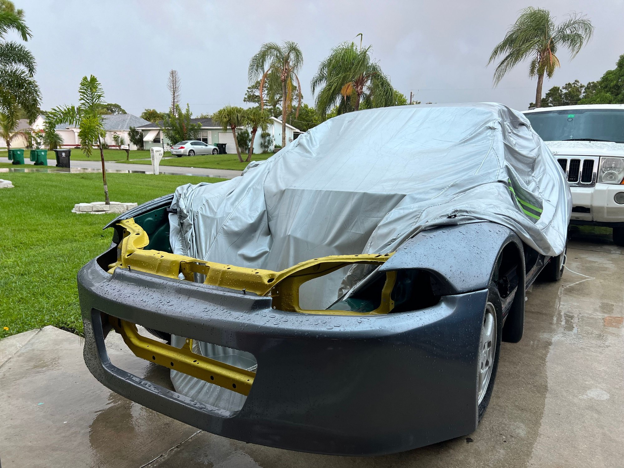

Woow bro! Congratulations! Nice nice build. I read the whole post. It took me a few days Lol. I’ll be doing my project post soon. I picked up this exospeed 3 pieces front end las weekend. You never upgraded the transmission gear set right? I’ll go with Liberty face plate gears definitely. What’s the size and brand of the last intercooler you installed? I gonna be using the Treadstone TR-1045 rated for 860hp.
Here a pic on the 3 pieces front end 🫶🏽.
I really like that front end, they are very clean looking. And thank you for your comments. I did change my gears, I ended up going with the GearX Top Eliminator Drag Kit and then I upgraded to the GearX extreme counter shaft and final drive and also bought the Speedfactory Billet Bellhousing. This is a synchro gear set and I’m considering sending them to Liberty for faceplates over the winter.

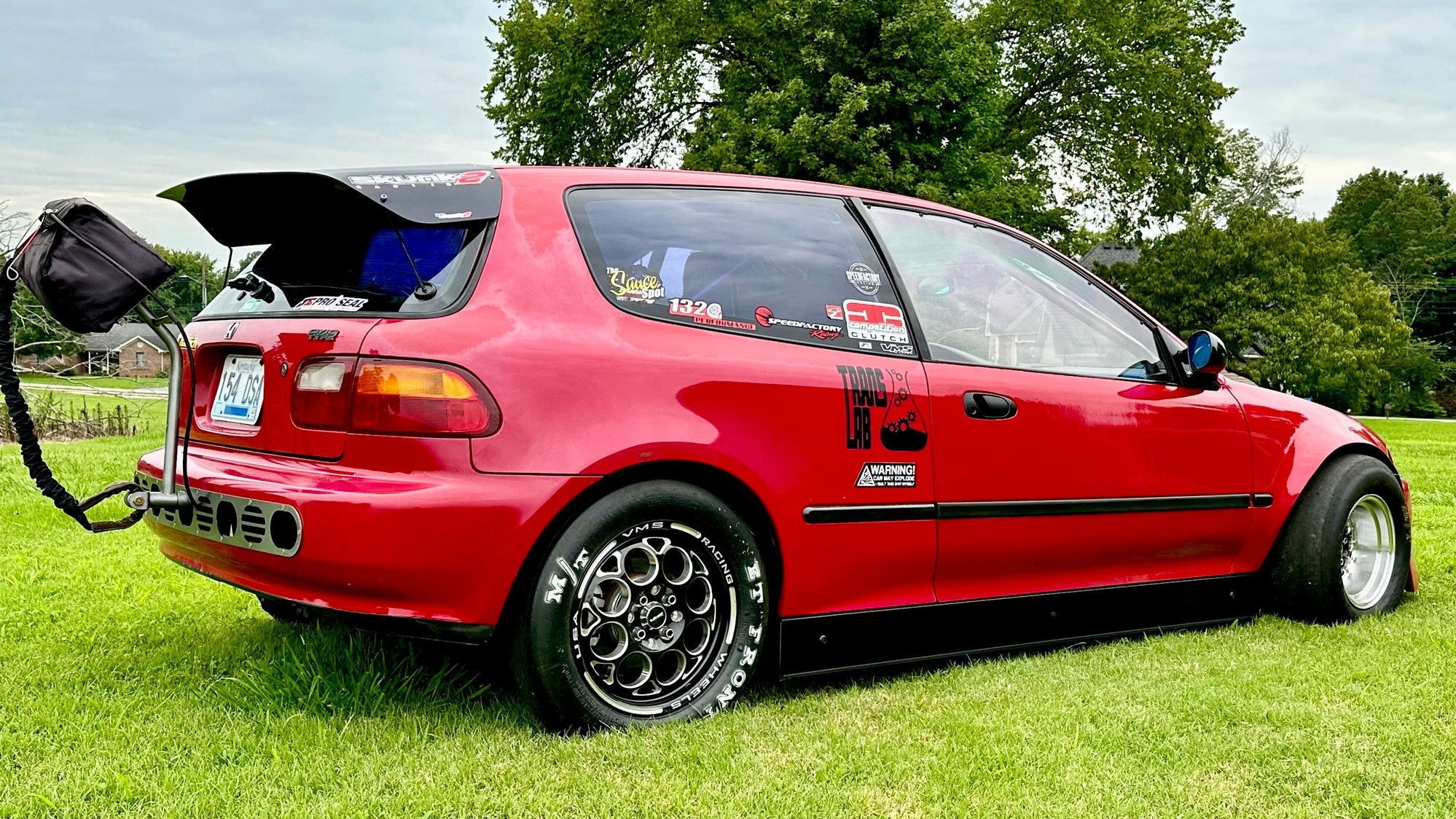

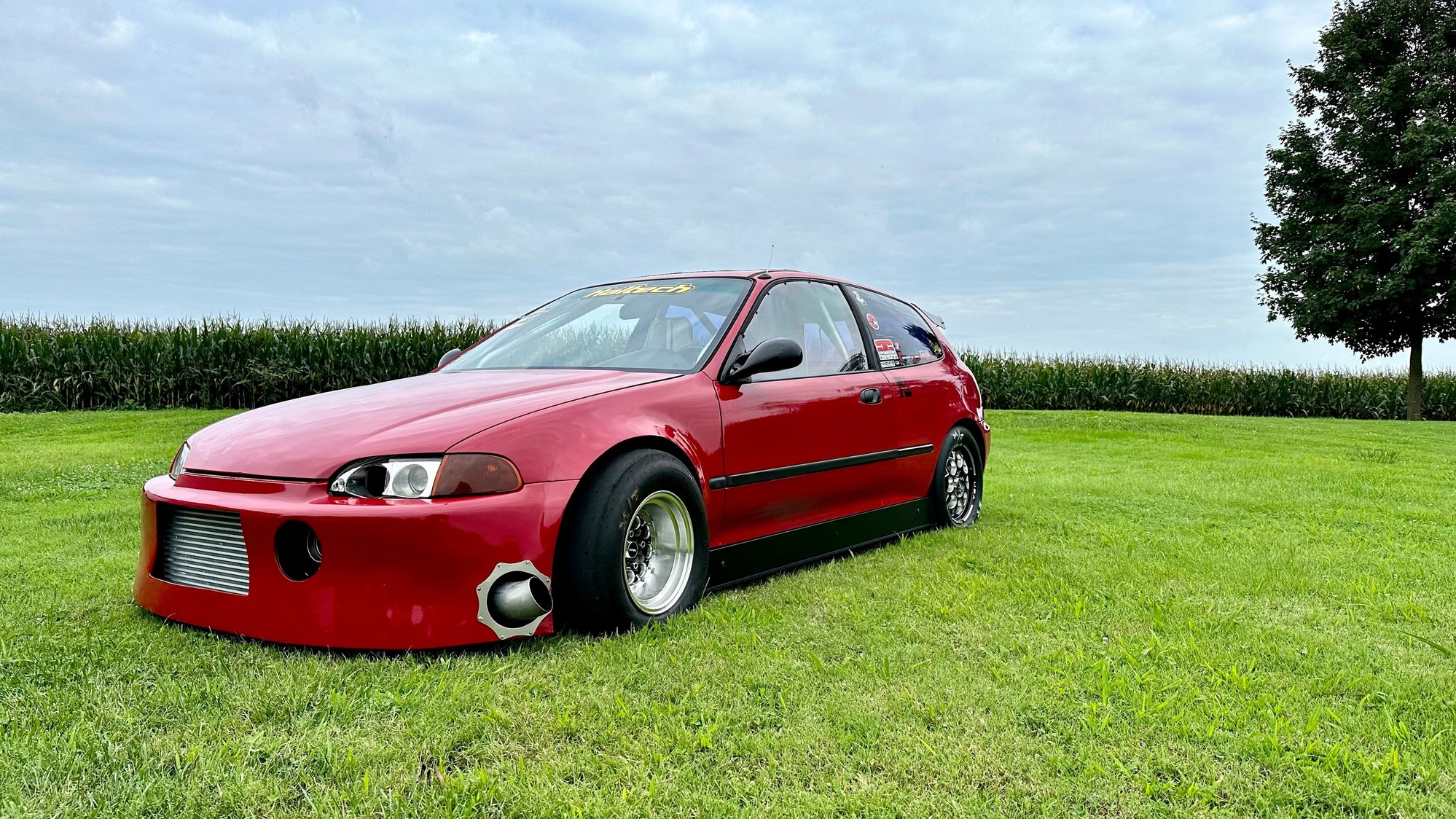

decided to order and install some 5 inch PCI side skirts. With the car trapping around 160mph I figured it would be a good idea to start focusing on some aerodynamics

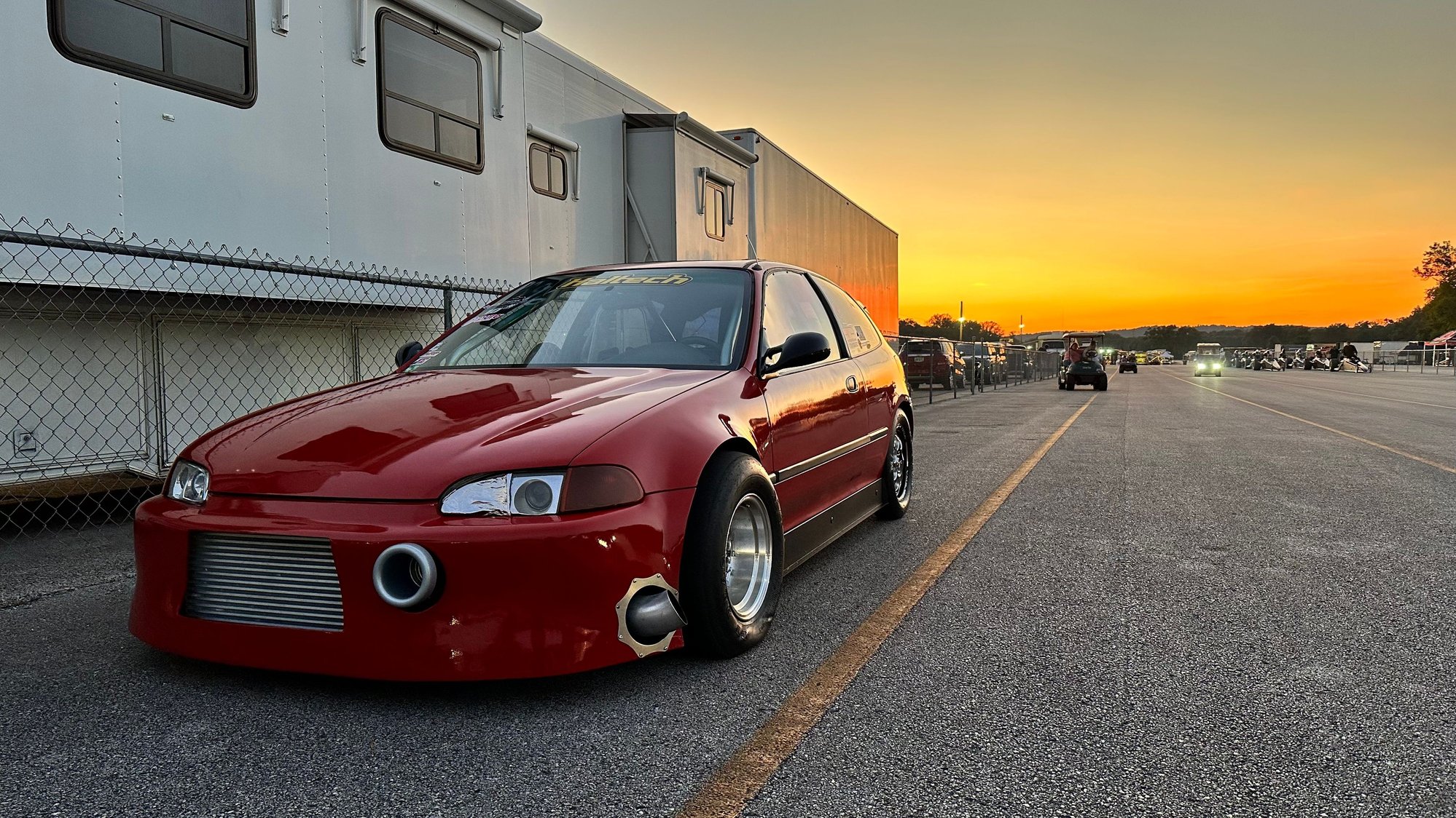

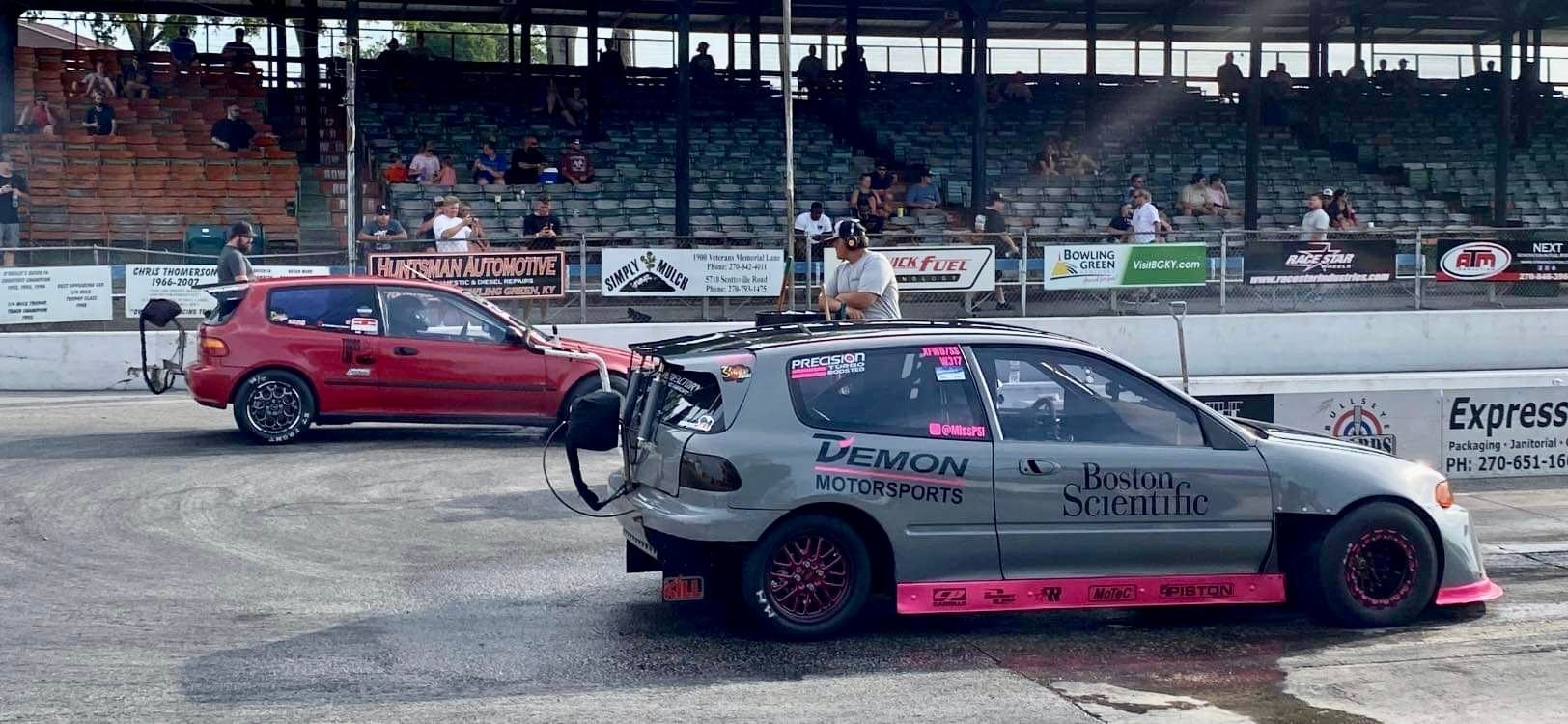

went to the track last night and love the way the car is running, I spun the whole 1/8th mile which the car has never done before, it left the line spinning and never stopped until 3rd gear. After looking over my logs I realized the launch control was building 5psi more than it should have and that was too much power off the line and once it starts spinning it almost never recovers. This was my best MPH ever!

Looks sick! I love it.

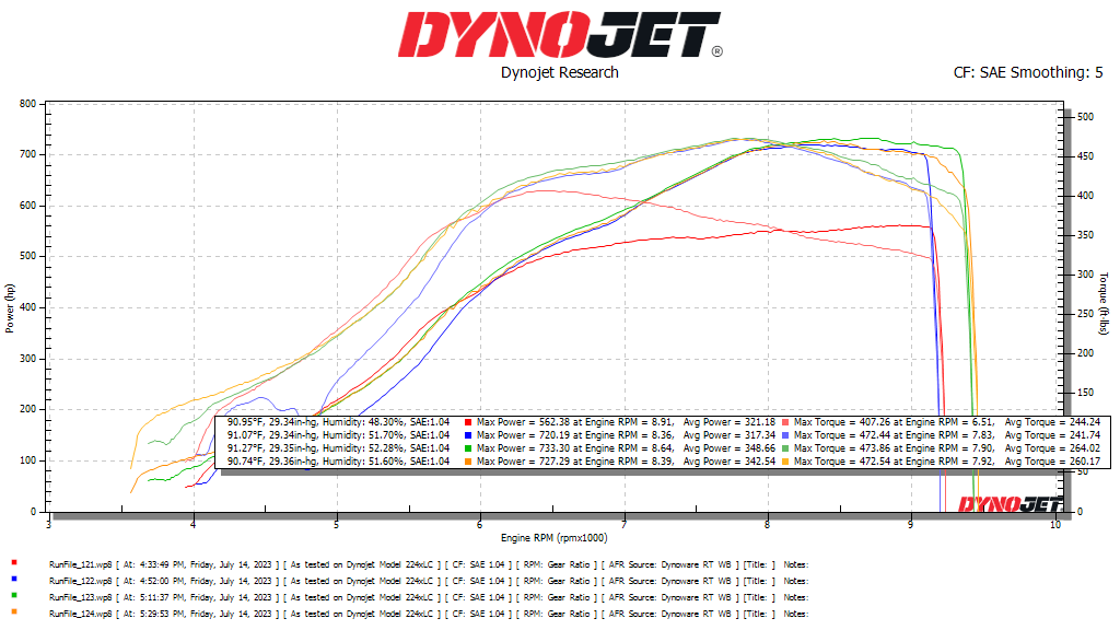

after I fixed the fueling issue I never went back to the dyno, but I did turn the boost up at the track to right at 40psi (39.4). The Pulsar turbo has done fantastic, car has trapped over 160mph a few time that I was able to run it.

Awesome! I’m wonder if at 40psi the car is at the 800WHP mark or closer to it. I’m still debating if I should upgrade the turbine housing to the 1.01ar or stay with the .82ar. 🤔

trap speed equals to 900+hp. So not truly sure

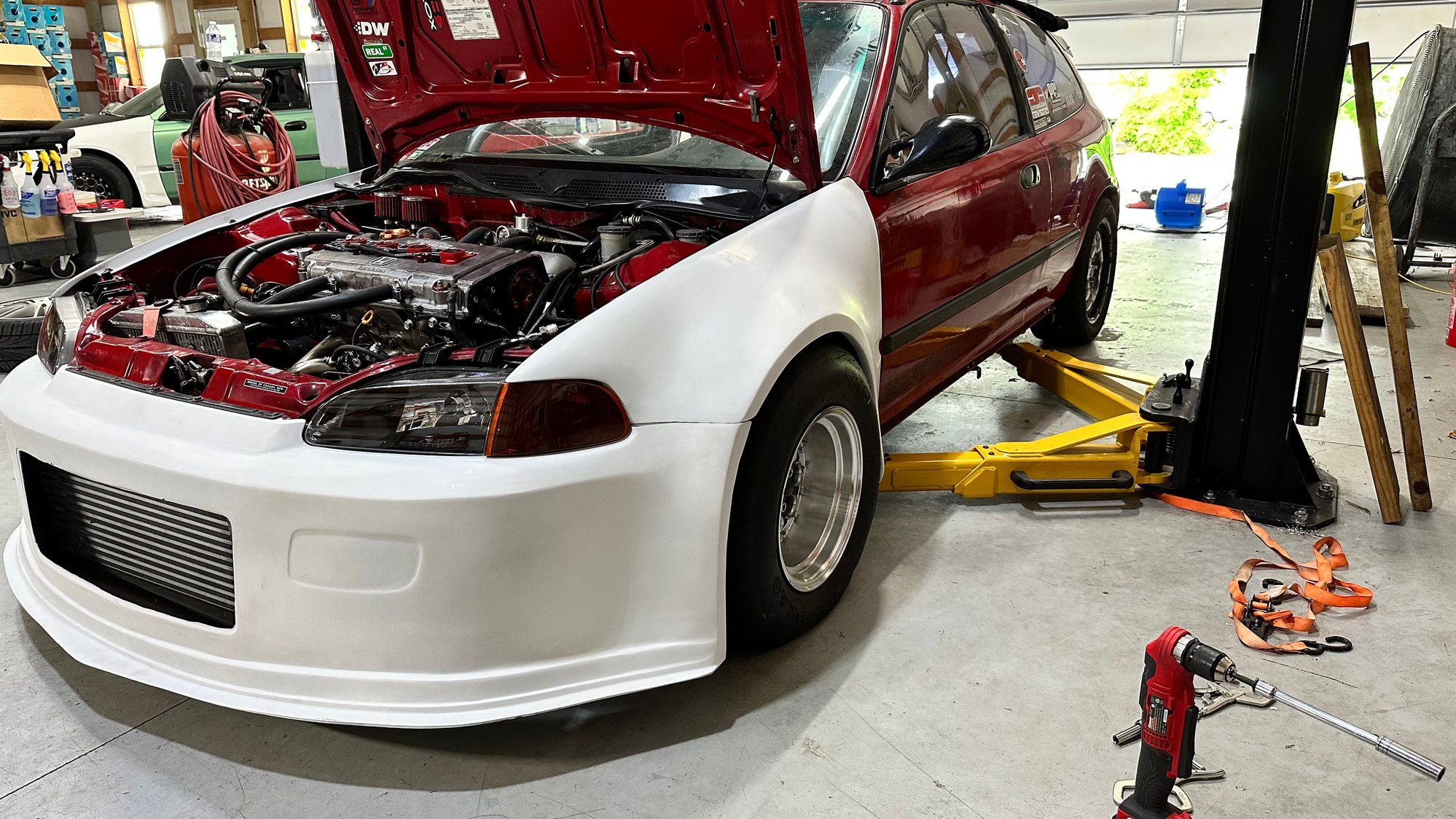

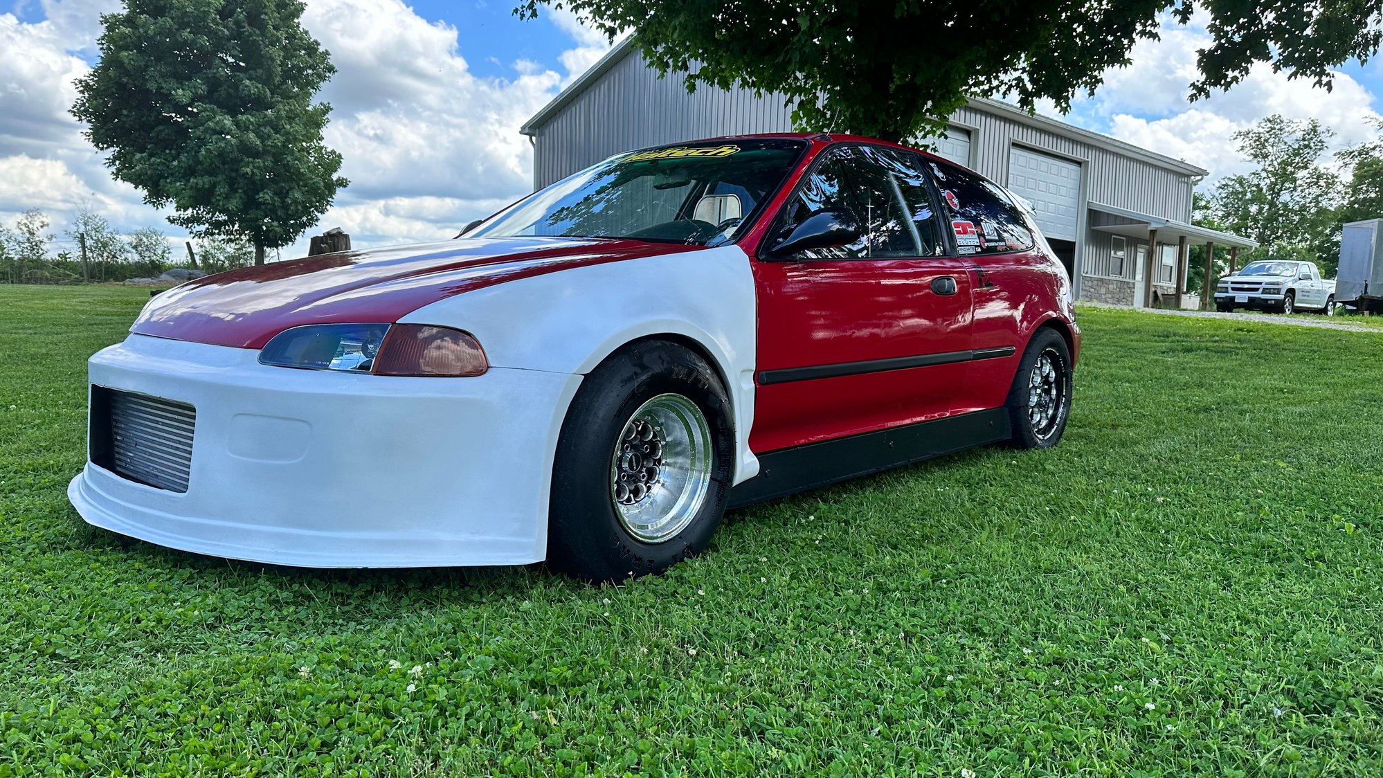

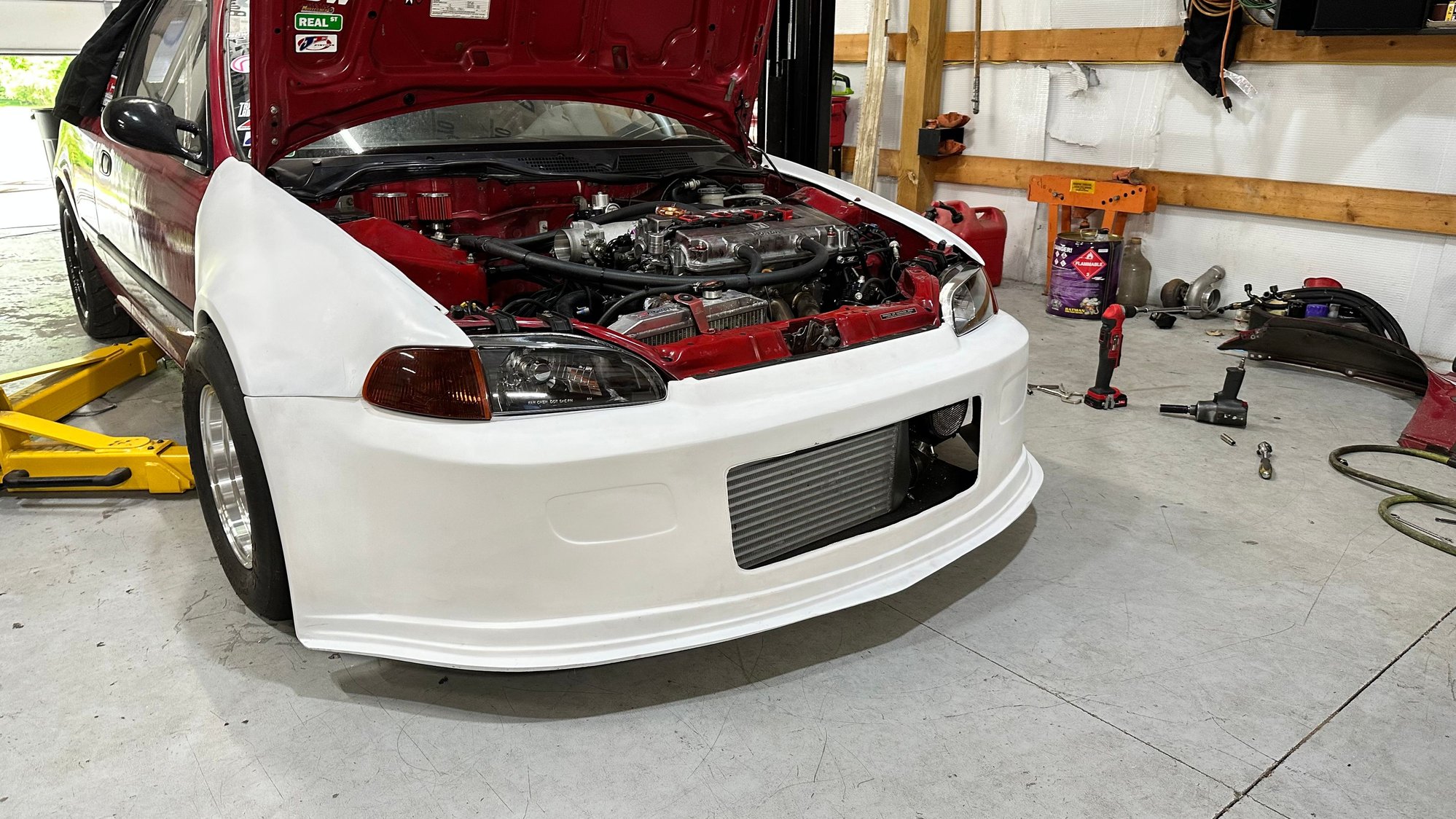

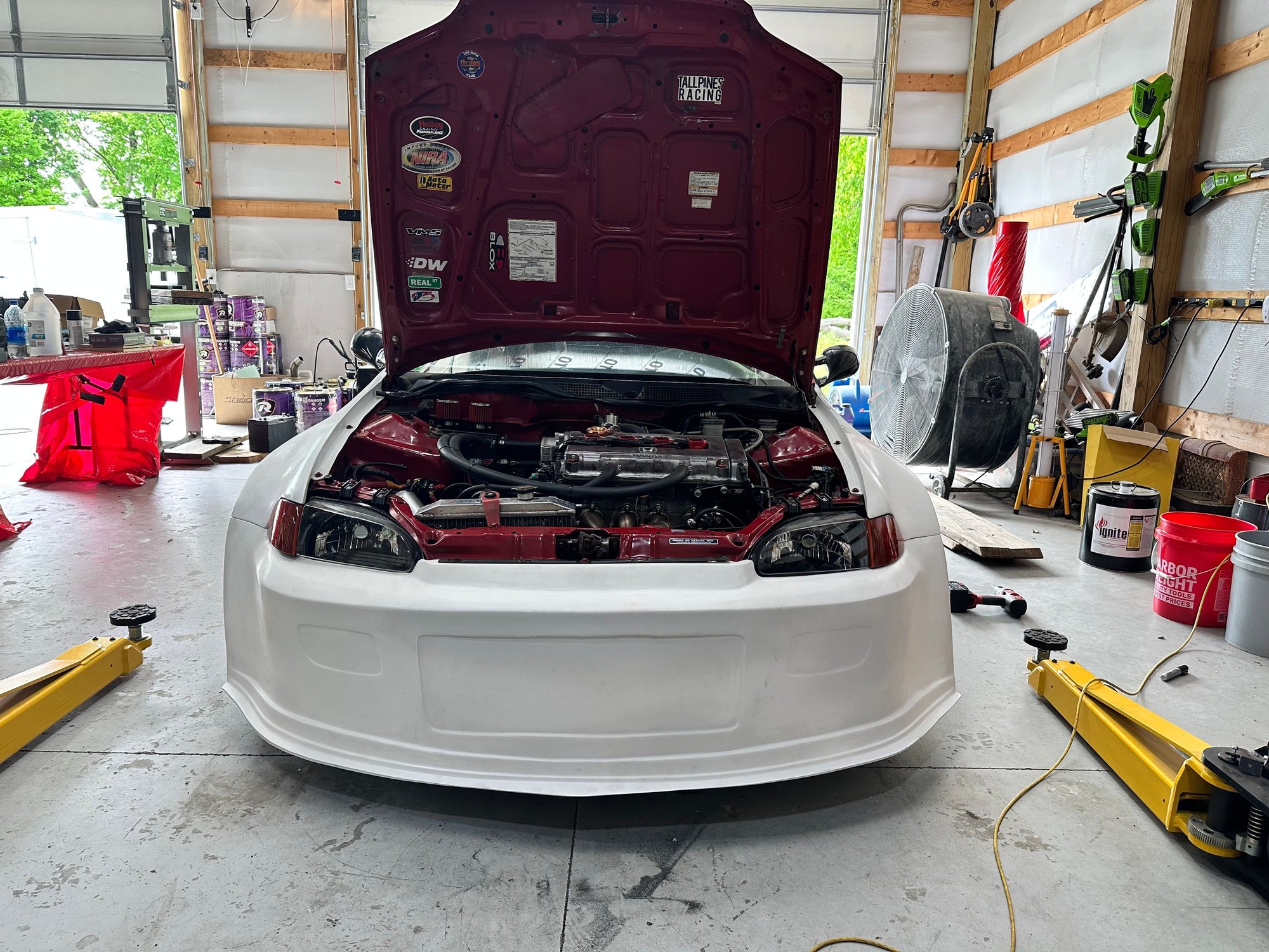

The last race of the year in 2023 I accidentally destroyed my custom made front end and it wasn’t repairable unfortunately. I decided it was time to just buy something, I decided to go with the Jerry Built 3 piece setup. Hopefully I’ll have time to finish up the body of the car and then off to the paint booth.

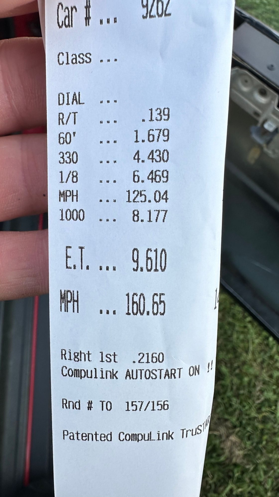

Final made it back out to the track to make a couple full passes ….. got a new PB and after looking at the logs i easily have 3-5 tenths left at the power I was at
