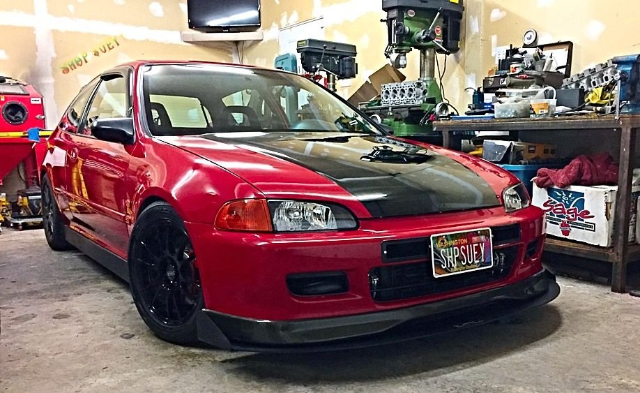

Wow awesome!. I hope you have some anti thief strategies. Perfect car.
I really like the front lip and side skirts(are they custom made?)
I dont really like too much the turbo but everything looks fine .

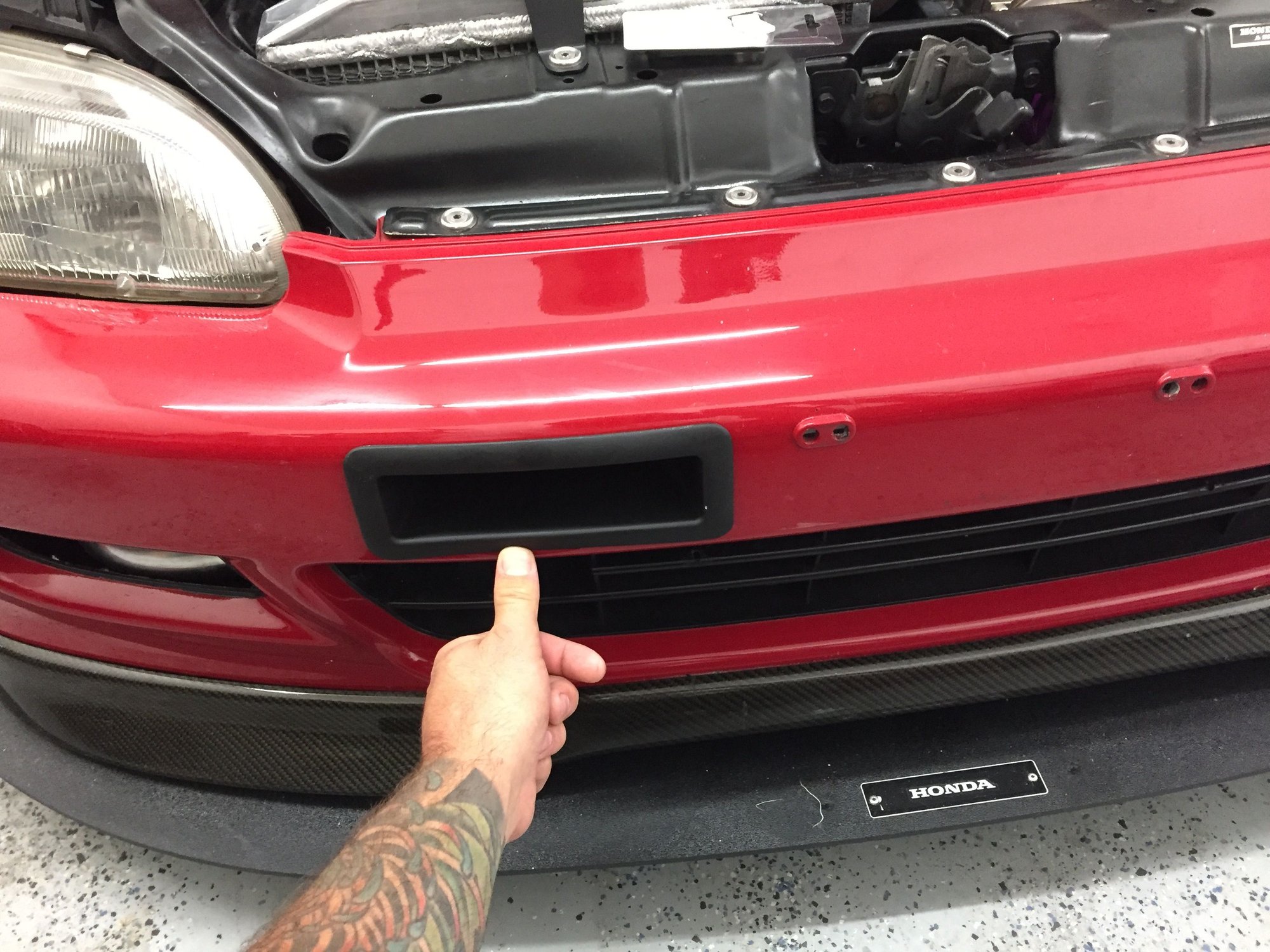

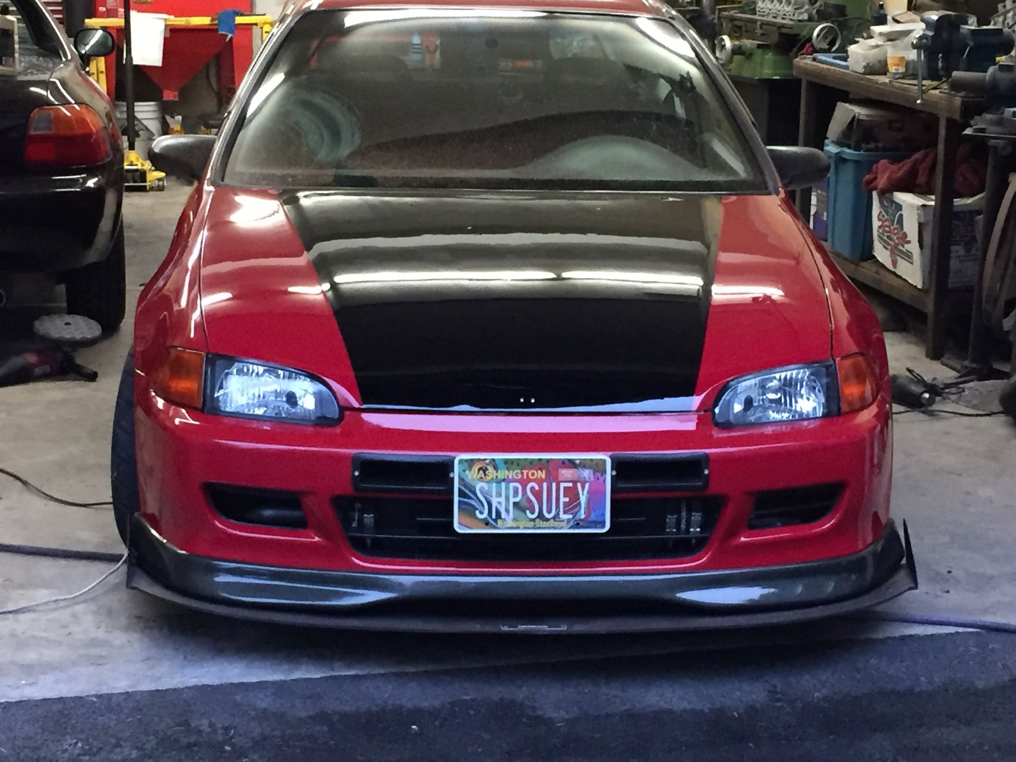

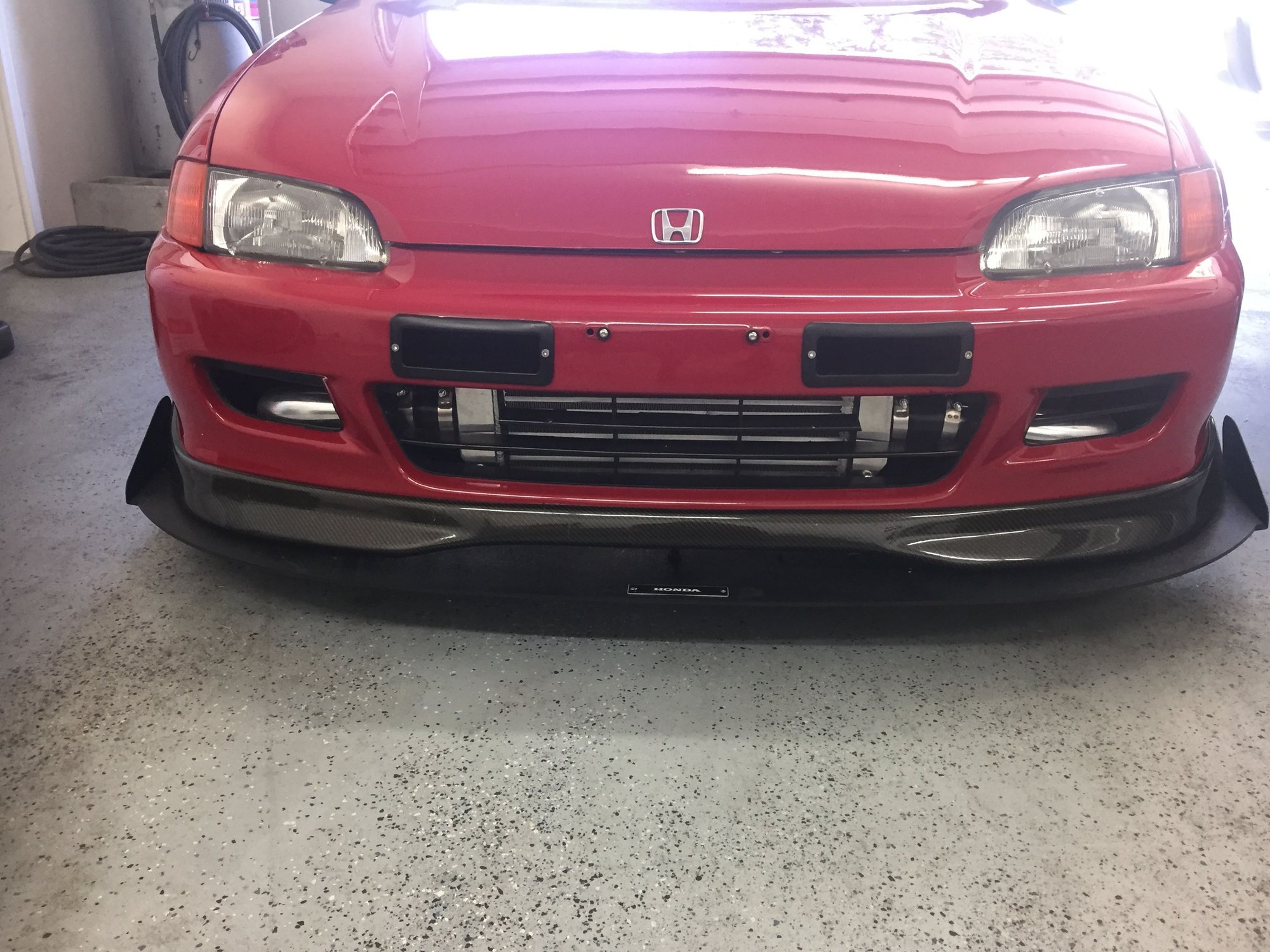

Definitely have it all covered for insurance. And it stays locked up. The front lip is Dev Sport and carbon fiber type r style. With custom air vents that are directly on the turbo and radiator. The side skirts are CCC Racing out of New York I believe. I really like those and they’re relatively inexpensive at $110. I really enjoyed my N/A setup. I made 230 whp 155tq it was super fun. I’m building a Del Sol for my wife that will have a similar setup.

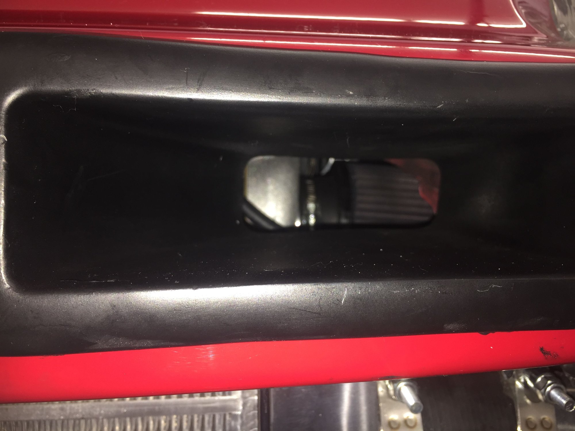

I bought these air vents off eBay. They were an awesome mod to cool everything down. It’s been about 40 degrees out on average lately and I haven’t got over 200 ECT. My IAT on the freeway is hangs around 60 degrees. Cooled me down a lot.

Cool use of the air vents. If you don't have an air dam/block off for the empty space caused by no full sized rad/AC condenser I'd recommend putting one in there, it will force quite a lot more air to the radiator. Could even integrate it with the inlet you already have, make a tunnel through for the turbo inlet.

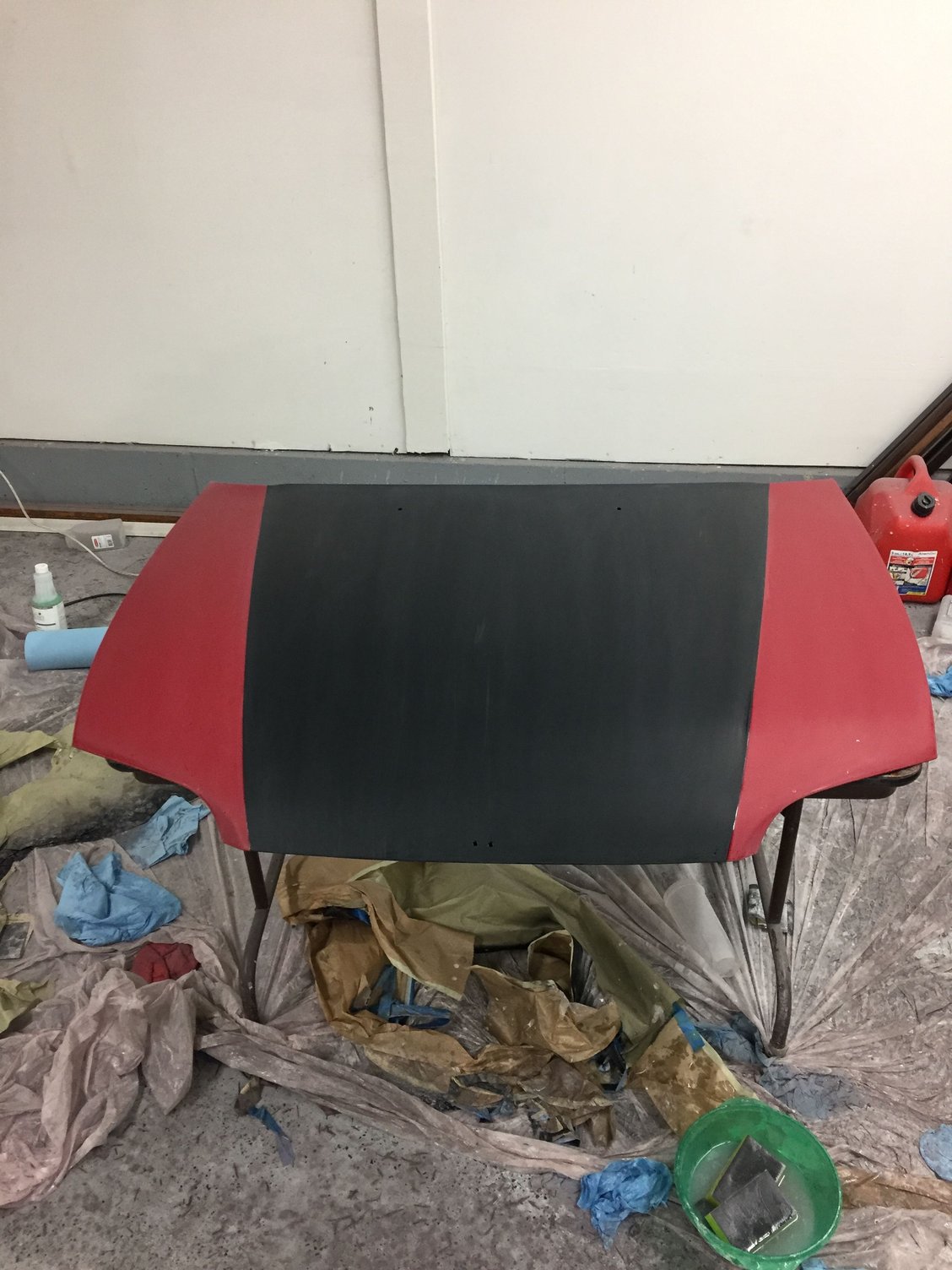

My hood was pretty messed up lots of clear coat peeling and dents in the middle. I didn’t really want a carbon fiber hood and I knew I wouldn’t be able to match my red very good. So I decided to learn how to paint haha! Well my friend talked me into giving it a whirl. The black down the middle allowed me to do some body work and re-spray. I’m happy with the results even with some imperfections it turned out fairly good.
