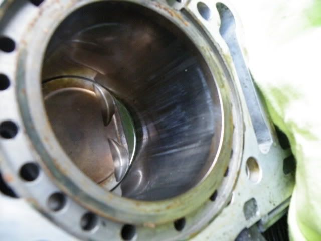

Blue94Accord Jul 27, 2010 11:39 AM
Re: Melted piston...again
Before ;D
http://img.photobucket.com/albums/v6...2/DSCF2763.jpg
After
http://img.photobucket.com/albums/v6...2/DSCF2782.jpg
http://img.photobucket.com/albums/v6...2/DSCF2783.jpg
http://img.photobucket.com/albums/v6...2/DSCF2787.jpg
http://img.photobucket.com/albums/v6...2/DSCF2786.jpg
http://img.photobucket.com/albums/v6...2/DSCF2784.jpg
http://img.photobucket.com/albums/v6...2/DSCF2788.jpg
http://img.photobucket.com/albums/v6...2/DSCF2790.jpg
cylinder 4 valves
http://img.photobucket.com/albums/v6...2/DSCF2793.jpg
HiProfile Jul 27, 2010 12:07 PM
Originally Posted by Blue94Accord (Post 43140444)
Chipped p28 chrome....another friend of mine already told me that a chipped ecu cant keep up with the timing and I should have gotten a standalone comp. i dont have the money for that tho. Anything else I could get?
A p28 using CROME can't keep up with ignition retard on small-bore D16's. Everything other motor, or using S300/eCtune/Neptune, or using the CROME code that removes hidden timing advance, and a P28 will be fine.
Now to the pictures: can you tell if those deposits are 100% aluminum, or mostly crusties from burning oil? On motors that burn oil, you'll find a very thick layer of that stuff on the valves and sometimes the head material too.
Blue94Accord Jul 27, 2010 02:22 PM
Im pretty sure its all aluminum. None of it is magnetic.

No idea on what the gap is. A shop in California built the block. not sure on any specs. besides being 87mm. You can def see that the piston skirts were rubbing on the sleeve. Could have been a bad build from the start. Its just weird that the motor was real healthy and ran so good before I started poppin vtec
The plan for tomorrow is to pull the block and take it up to a local shop and see what they think they can do. Im probably going to bore out to 88mm and get a set of pistons again and start fresh. take the head up to another shop and get it resurfaced. Hopefully the valves are still good.
