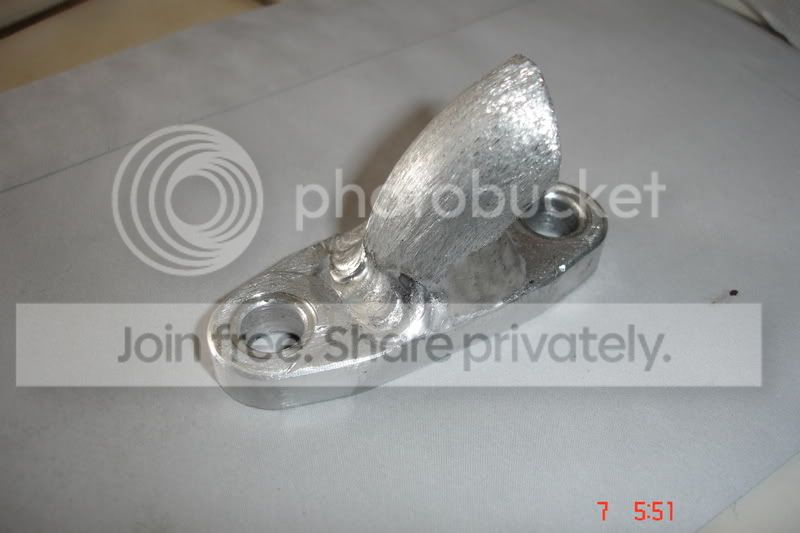

Here's another pic of the flange I had the pipe welded to. I just have some plain 5/8" rubber hose on for now but I have some high temp rubber/silicon hose coming from ATP. http://www.atpturbo.com/Mercha...-OIL1

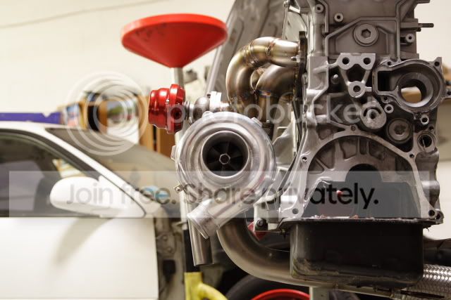

Losers, don't you know if you accellerate fast enough with an angled Holset, the oil gets sucked out due to the G forces?
Most turbos can deal with ~30 degrees off center (both side/side & front/back). Holsets are overbuilt as far turbos Hondas are used to, so you could even get away with restricting the oil a tad more than you should - if absolutely needed.
Otherwise scavenge pumps can be purchased for ~$70, and is usually the bulk of a scavenge setup's price (if not using lots of hose like a rear mount).

A restrictor doesn't help with his true problem: proper drain back. Hondas have good oil pressure from the jump start. If tapped from the oil sending unit, you'll have plenty of oil to lubricate the turbo if using a -3an line. The major concern is the way the turbo drain is set to the pan.
