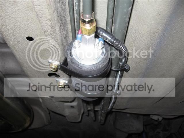

is the one in line the same "in-tank" style pump? Excuse my ignorance I havent seen someone do this... Doesnt the pump require to be submerged in gasoline to cool the pump? Are you afraid of the pump overheating if not in gas or a cool environment.....
Just a thought

<TABLE WIDTH="90%" CELLSPACING=0 CELLPADDING=0 ALIGN=CENTER><TR><TD>Quote, originally posted by Danny_EJ &raquo;</TD></TR><TR><TD CLASS="quote">is the one in line the same "in-tank" style pump? Excuse my ignorance I havent seen someone do this... Doesnt the pump require to be submerged in gasoline to cool the pump? Are you afraid of the pump overheating if not in gas or a cool environment.....
Just a thought</TD></TR></TABLE>
I'm doing the same thing. It's not just an "intank" pump that's run inline. It's a different pump. Here's a pic for reference:
