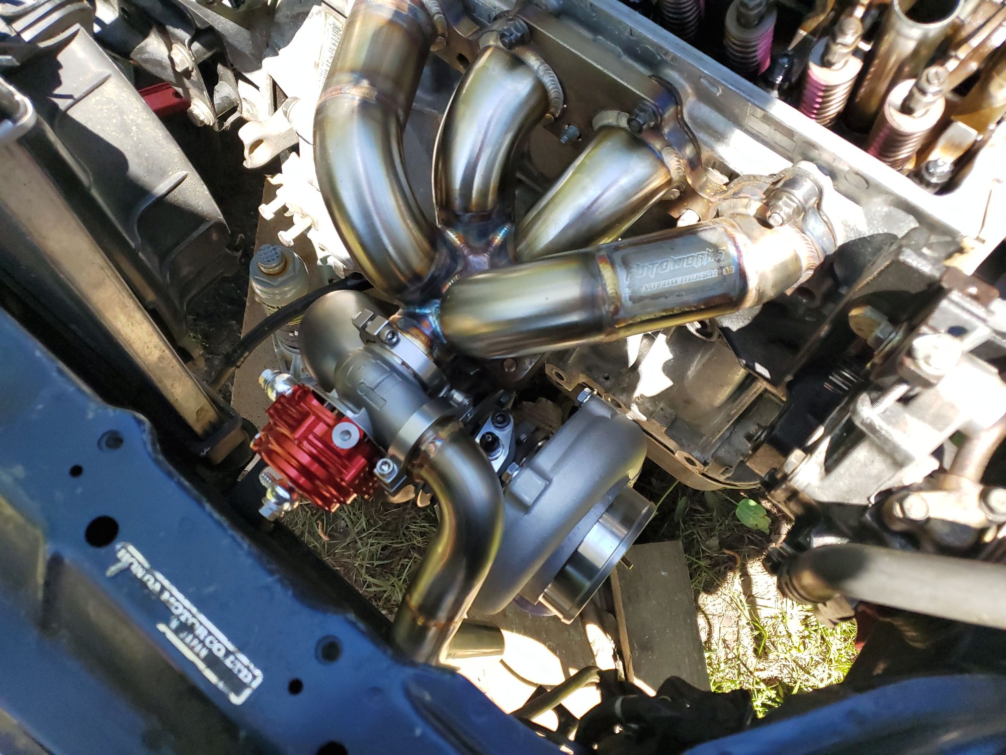

Running a miniram myself, I have no fear of dunking the turbo at all. It stays in a comfortable position.

Thanks for the pics, yea that looks fine. Somehow in my mind I envisioned it sitting much lower than that due to the turbo draining issues people tend to run into.

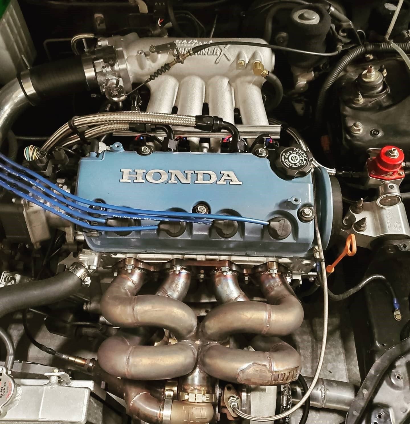

Ramhorn manifolds usually place the turbo higher than mini ram types. Well, at least mine does...lol
Is that an EGT sensor in your dump tube? I wouldn't imagine it's an O2 sensor.

Thats his downpipe

It's a Bosch wideband sensor....DP. The dump tube overlaps the DP, downwards in front of the block/oil pan.
Picture trickery! Or, my eyes are getting old.. Looked like a sensor in the dump tube. Lol!
