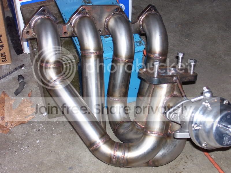

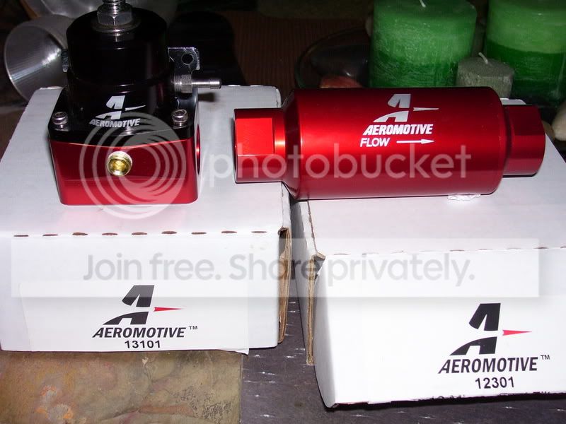

new pics and more parts from aeromotive

That does not look like a full-race manifold to me....

Default Re: B18C1 500whp Build... more parts and PICS galore!!!! (gsrhb7)
<TABLE WIDTH="90%" CELLSPACING=0 CELLPADDING=0 ALIGN=CENTER><TR><TD>Quote, originally posted by gsrhb7 &raquo;</TD></TR><TR><TD CLASS="quote">That does not look like a full-race manifold to me....</TD></TR></TABLE>
Its definitely not a Full-Race manifold.

Default Re: B18C1 500whp Build... more parts and PICS galore!!!! (daveG)
<TABLE WIDTH="90%" CELLSPACING=0 CELLPADDING=0 ALIGN=CENTER><TR><TD>Quote, originally posted by daveG &raquo;</TD></TR><TR><TD CLASS="quote">Its definitely not a Full-Race manifold.</TD></TR></TABLE>
x2

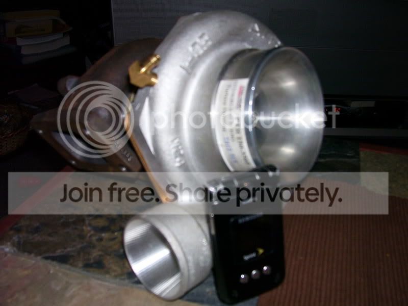

I would Definitely go with a bigger WG. What are the specs on that turbo? A/R size?

Default Re: B18C1 500whp Build... more parts and PICS galore!!!! (Da K00l Aid Mayun)
<TABLE WIDTH="90%" CELLSPACING=0 CELLPADDING=0 ALIGN=CENTER><TR><TD>Quote, originally posted by Da K00l Aid Mayun &raquo;</TD></TR><TR><TD CLASS="quote">
I would Definitely go with a bigger WG. What are the specs on that turbo? A/R size?</TD></TR></TABLE>
the turbo specs are .70 ar cold side with a .63 ar hotside the tag on it from precision reads GT3582RLS-05 TURBO turbine Housing THF3-35R
Old Dec 3, 2006 | 09:57 PM
morgan@synapse motorsport's Avatar
Posts: 2,278
From: upstate, ny
38mm gate is going to boost creep make sure have boost cut set. send it somewhere to get a 44mm(likely creep too), maybe just add another 38mm gate?
