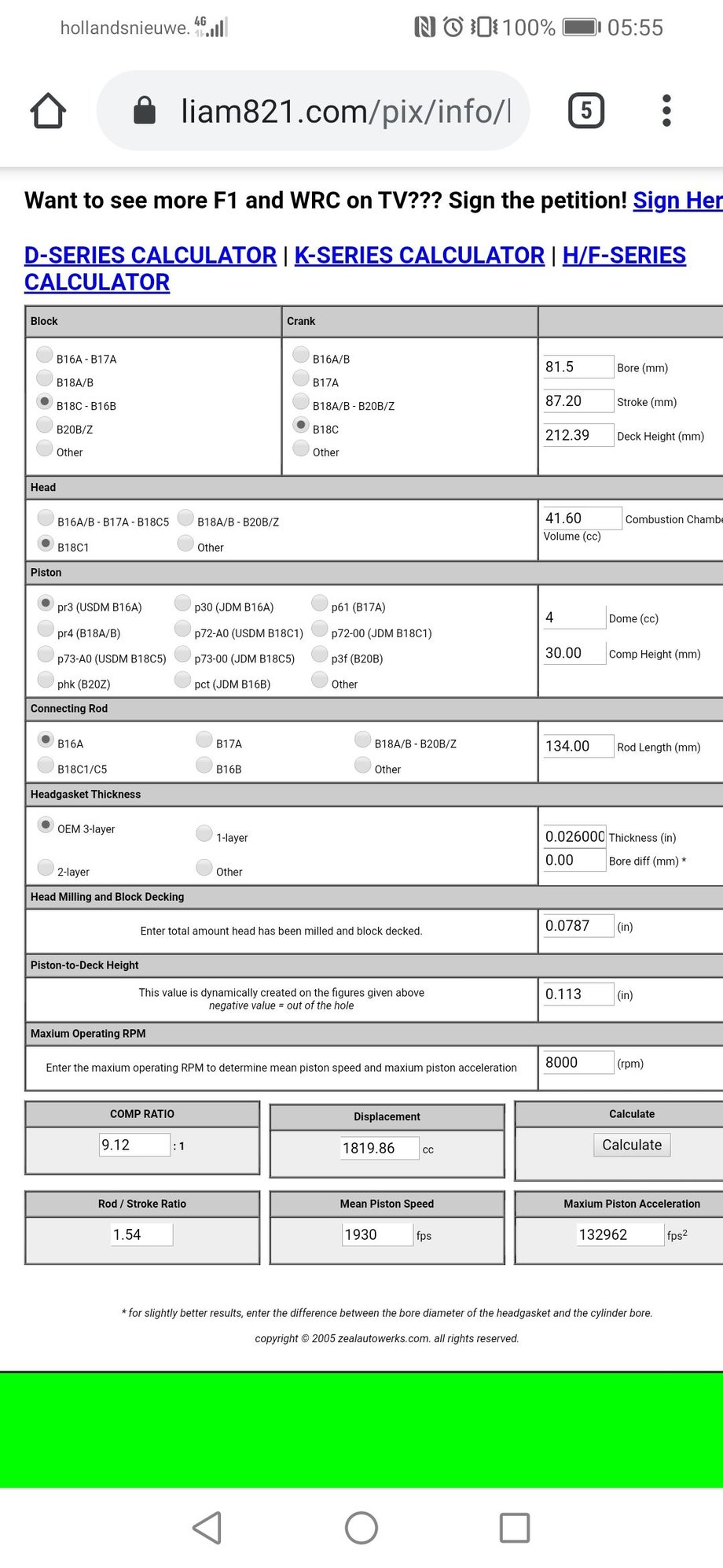

Hello I have made a calculation on this website https://liam821.com/pix/info/bseries.html
Is a bit accurate? I want about 600hp on pump gas rond98
​​​​​​My tuner is saying that the compression ratio must by 9. How can I fix this with the b16 pistons a have?

You cannot get to 9:1 compression with B16A pistons... nor can you reach 600 HP on cast pistons in a "B" series engine... and that power level using pump gas is really pushing it. You really need to start being realistic about your goals and what components are really needed to reach these goals safely.

Hello
I understand OK 500 HP is also OK with pump.
The pistons what I have from the b16 are from wiseco and the rods from eagly.
I have put the b16 rods in the b18 and milled 2 mm of the blok. 0.0787inch.
The compression ratio seems now good.
I want to do it like this, Wil it work like this?
Regard
Antoni
