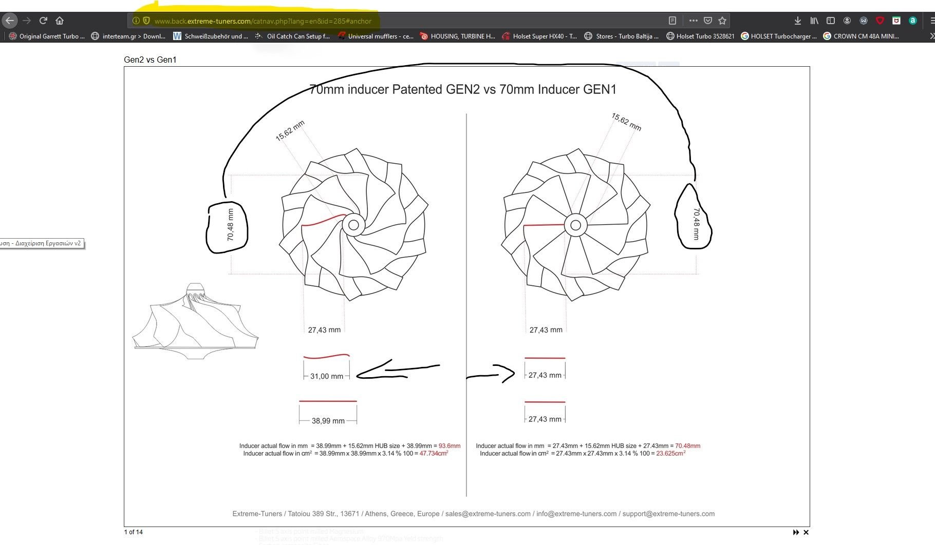

To be fair youll allways have numbers advantage when you trade realiability for it.
Also the use or "air curve" or "snake curve" point miling compressor wheels will allways flow more for their size.
Until the mm categories get modernised it will allways help the curve bladed turbo because of the bigger overal lengh...
Garret and BW use straight blades.
Look at the extreme tuner explanation.
But "curve" bladed compressor wheels take ALOT Of time machining and shoot the overal final cost of the turbo very high.
I asked a designer/cnc company about this and he told me maybe 2 or 3 times the time to cut the wheel...
Old style billet wheel 100-150. Point miling wheel 200-250, point miling air curve - snake curve wheels 400++ That was his quote...

It's more than just about being "curved" vs. "straight" exudcer transient energy wheels. If you want to know the real differences and point-counterpoints of wheel design.PM me an e-mail and I'll gladly send you a PDF white paper and link to books that explain that a lot more as a whole.
This is the technical stuff. The white paper has a more simplified explanation
