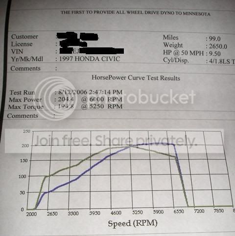

well, i got my car dyno tuned at RS motors in MN.
the results 204.5 hp and 194.8 tq
problem is, im boosting 10psi, and ive seen LS motors running more power..
I rebuilt the engine with new honda OEM bearings, Eagle rods, wiseco pistons (8.8:1 compression), RC 550cc injectors, drop in block guard, the head has crower valvetrain, new water pump, oil pump, etc. the car has the DRAG III turbo kit on it.. my entire exhaust is kteller 3" piping, but my DP is only 2.5" which i think is my problem.. my computer management is hondata S200 w/boost, MSD 3bar MAP sensor.. i got everything for the car to be tuned well, just dont know why my power is so low??
anyone have any ideas why im only putting down only 204 hp?? the torque is looking good tho..

dyno graph would help significantly. can you post yours?

Post up the dyno graph w/ the A/F ratio. That'll tell us wether or not it's your tuner.

should be making about 230-250whp and 200-220wtq so yea i think something is wrong. post the graph and find out what kind of timing advance the motor is running

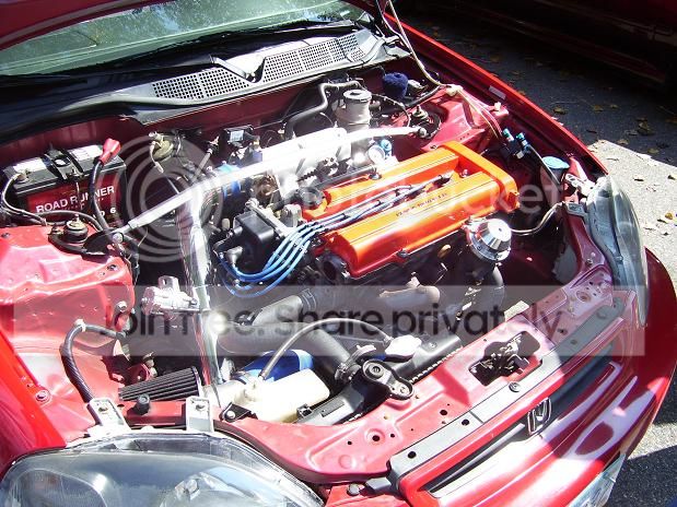

how is ur dump tube exiting? is it under the oil pan?

my dumptube for my waste gate goes into my DP right at the ridge of the oil pan..

peak hp at 6000rpm? you should be pulling strong till 7000rpm at least......

i would bet the timing needs help. with low comp. you should be able to get away with some timing. nail down afr then add timing till you see peak hp, then pull a deg or two to be safe.

<TABLE WIDTH="90%" CELLSPACING=0 CELLPADDING=0 ALIGN=CENTER><TR><TD>Quote, originally posted by under_psi &raquo;</TD></TR><TR><TD CLASS="quote">peak hp at 6000rpm? you should be pulling strong till 7000rpm at least......</TD></TR></TABLE>
na, its a stock cam and stock intake manifold ls, 6kish is right for peak power, and around 5k for peak tq

Stock NA LS's torque drops like a rock after 4500, so bear that in mind. My guess is there is a leak somewhere. If its small enough, you'll still be making Xpsi, but a lot of air will be leaking, and power used to push it out there. Spray starter fluid (for cars, not grills) around every possible leak point, see if it changes the idle.
The turbo is probably a t3/t04b. The fuel maps on my D16 with the s-trim t3/t04b show enough fuel used to make a good 220whp, 10psi at 4k rpm. Yours should spool much quicker, but the graph is doesn't have a peak where you reach full boost. Either that, or the peak at 5200 is where it hit 10psi, and its leaking bad.

<TABLE WIDTH="90%" CELLSPACING=0 CELLPADDING=0 ALIGN=CENTER><TR><TD>Quote, originally posted by cxhatch02 &raquo;</TD></TR><TR><TD CLASS="quote">my dumptube for my waste gate goes into my DP right at the ridge of the oil pan..
[IMG][/IMG]</TD></TR></TABLE>
that is the old mustang dyno software and it was supposed to not be used after august first i believe, the new software we got from them is called "power dyne" and has many more features and is more inline with other dynos, as it offers a built in correction factor HP as well, via the built in weather station on the side of the computer
