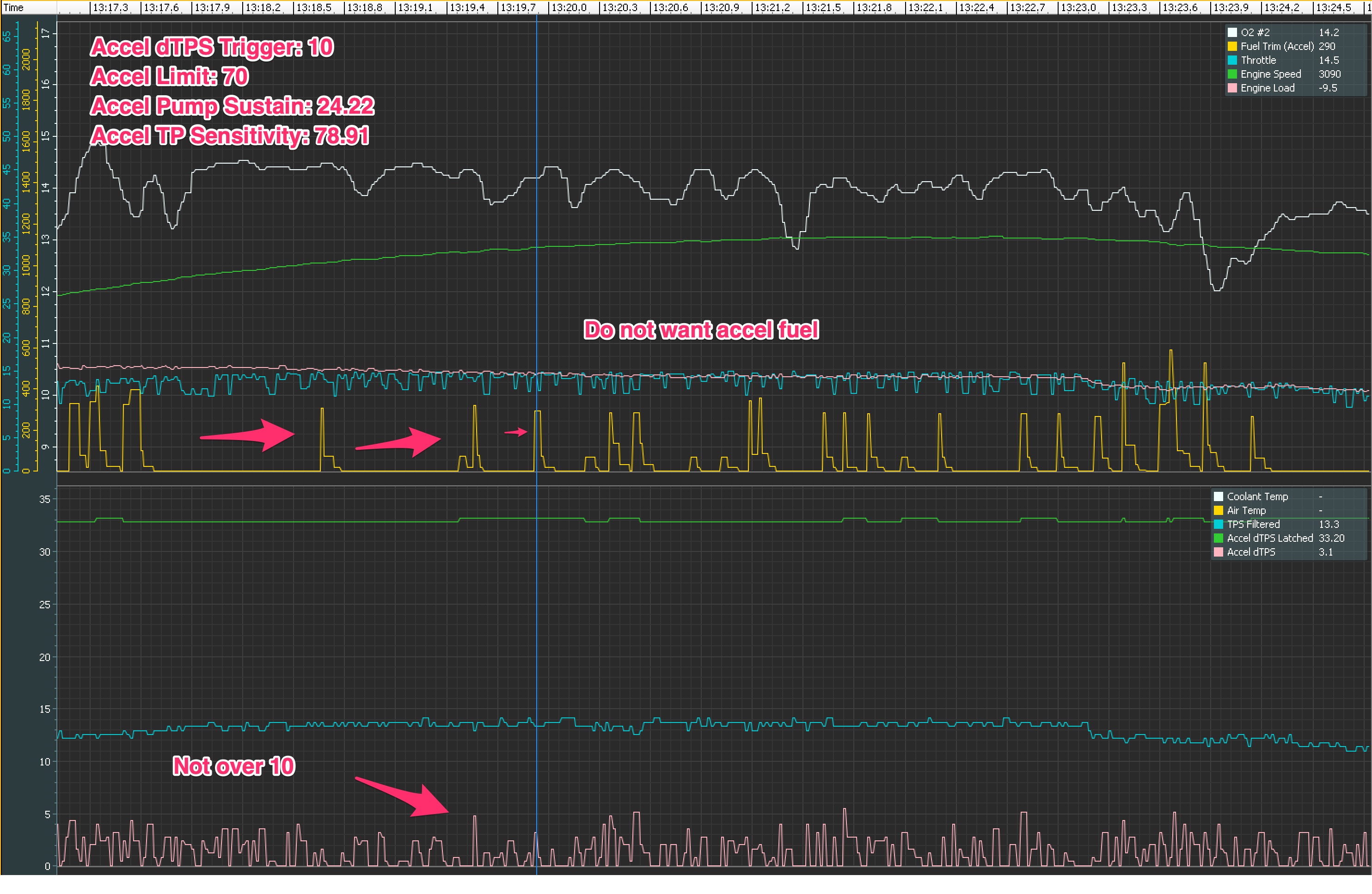

Hey all, I'm tuning accel / tip-in fuel on my NSX with an AEM Series 1 (though likely similar to Series 2). I originally started messing with it because there was a slight lean condition with a quick TPS change. Generally, it'd go lean for a sec, then go rich; it felt late to correct, then when it did it'd overcorrect. Seemed like an easy fix: increase the TPS sensitivity, pull some fuel from the tables.

I did some experimentation with these settings + adjusted the "TPS Accel Factor" table. I was able to get the AFR close to what I wanted on a large TPS change, but still cant get it to chill out when cruising.

My assumption is not what I'm seeing. Here Accel dTPS Trigger is 10, Accel dTPS is like 3 or 4, but Accel Fuel (also "Fuel Trim (Accel)") is non-zero and affecting the AFR.
In this case I want it to correct at the actual throttle change (see big arrow toward the right), but not when the cruising.
The cruising dTPS vals are less than 5, and the actual change is > 5. It _seems_ like I should be able to set the Accel dTPS Trigger to 5 and have it pick up the changes I want. But right now, it seems like the 10 trigger value is being compared against something larger than Accel dTPS.
