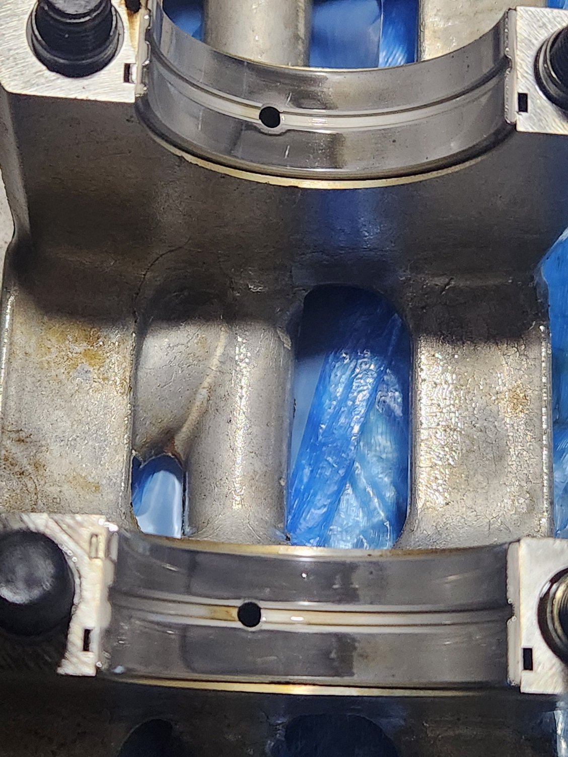

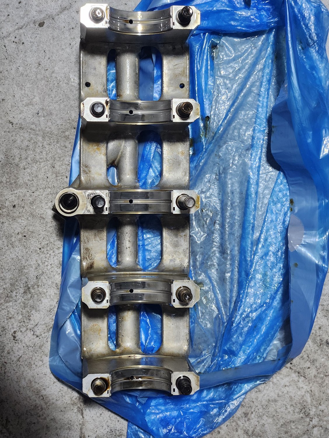

Also, can anyone look at my mains and tell me how likely it is that my crank is still okay.

They look alright. Measuring is key tho.
Honda is discontinuing a lot of them. You have a few options...
  1. Buy slightly thicker oem bearings and lightly sand the back of the bearing till you get your desired clearance.
  2. Buy aftermarket bearings and hope they fit. And if not lightly sand the back to get your desired clearance.
  3. If you need more clearance you can micropolish the crank or hone the journal.
