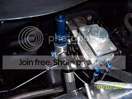

This is all in my 1995 240sx, but a you get the idea...
My adapter
Master cylinder
modded factory "horseshoe" thing lol
completed assembly
installed
