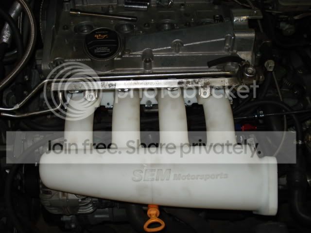

Here's an example of a tapered plenum cast VW 1.8T intake our design engineer had designed for us.
Our 3D printer made it possible for us to make a prototype so we can test fit before going into full production.
Modified by ruftwinturbo at 3:51 PM 1/8/2008
