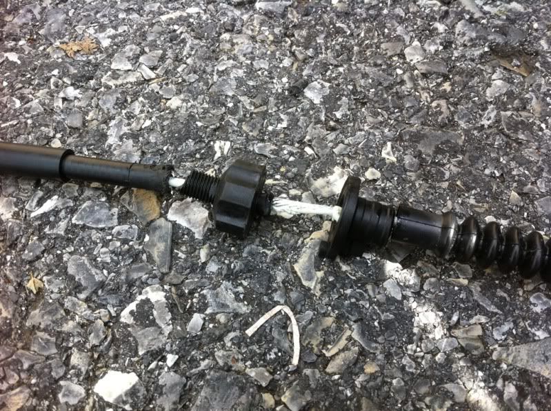

This is my problem with the cables. This is a brand new oem one after 15 miles. The 20 year old plastic just isn't good anymore. Even after being opened from a sealed package.

thats crazy was this in the stock tranny or a b16/gsr tranny???? with the hassport mounts???

This was a completely stock S4C with Hasport cable to hydro conversion and stage 3 Action clutch using Innovative solid mounts(mounts shouldnt matter).
The clutch pedal was ungodly stiff, and I was not really surprised this happened. Btw this happened getting on the highway driving normally. Shifted into third, went for fourth and the pedal was on the floor.

I am sorry you had a problem with your car, let me know if I can help.
Hasport does not reccomend our MECHANICAL "cable to hydro" conversion (part no. EFBHCL) for anything other than a stock clutch. We have literally sold thousands of them and they work really well with a stock clutch and okay with some mild performance clutches. The EFBHCL solution uses no hydraulics, only the stock clutch cable and a billet aluminum linkage to operate the stock clutch fork.
We have a HYDRAULIC "cable to hydro" conversion (part no. CMA) that works well with ANY clutch intended for your Honda car.
With the CMA the stock cable is used to actuate a clutch master cylinder which in turn actuates the stock slave cylinder.
I hope this post clears up any confusion when referring to Hasport "cable to hydro" conversions.
