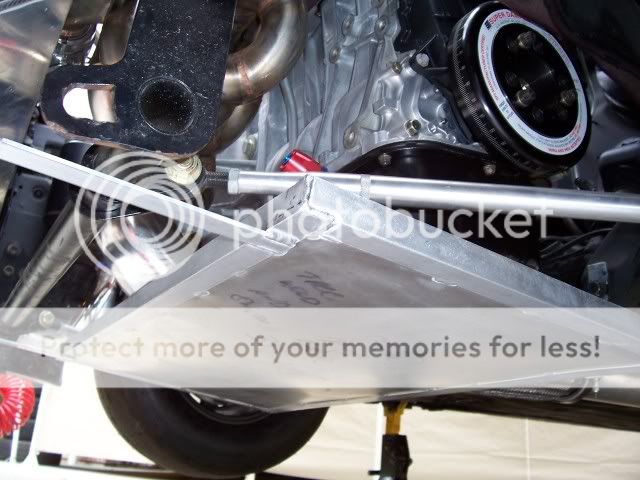

sorry to raise this thread but that ATI 7" race version looks kinda huge. Does the motor have to be out to install it?

It can be installed with the engine in the car.
