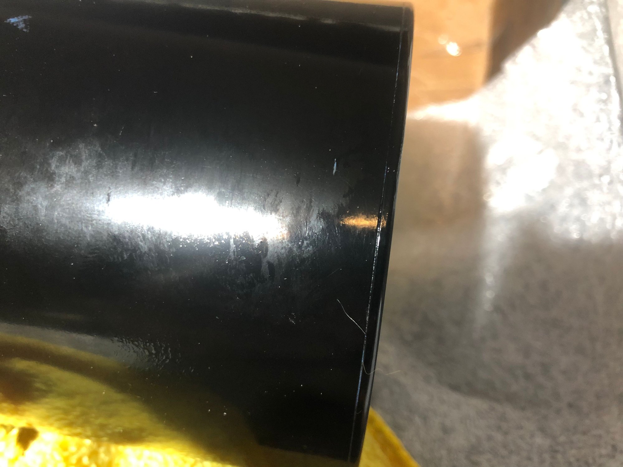

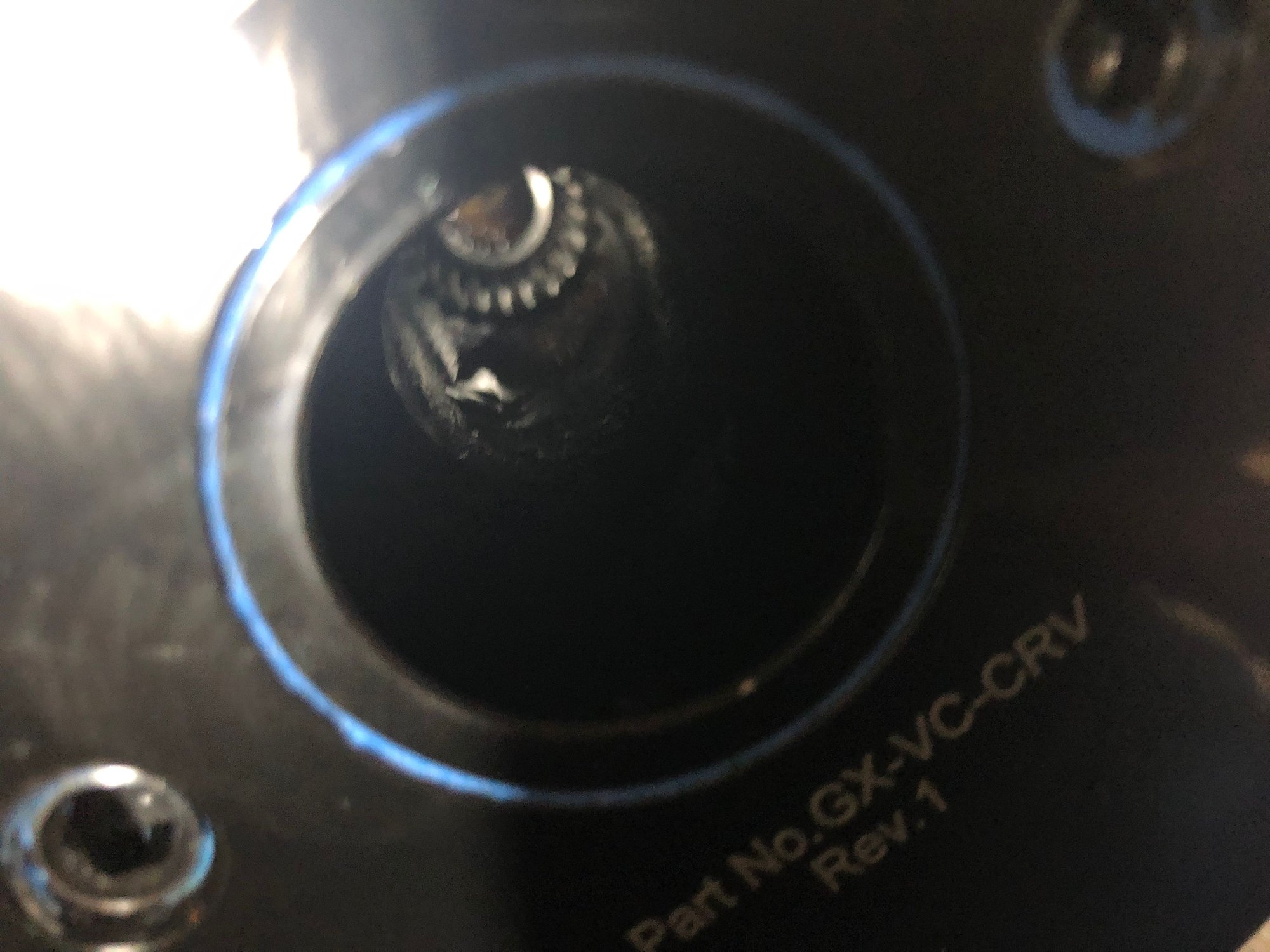

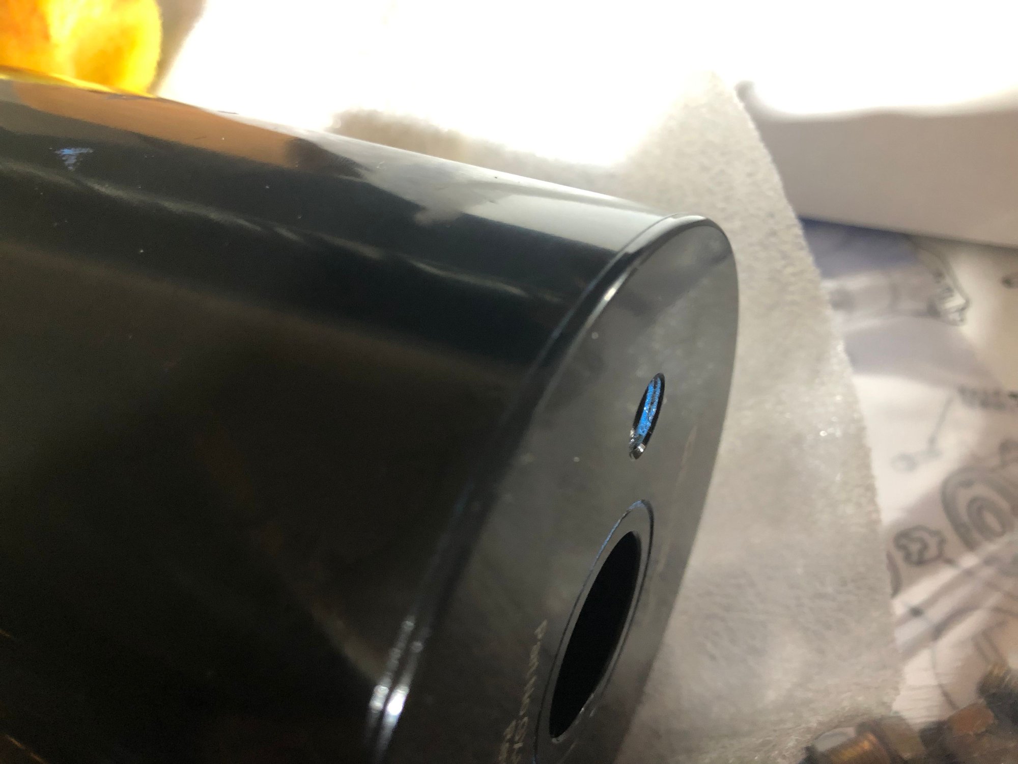

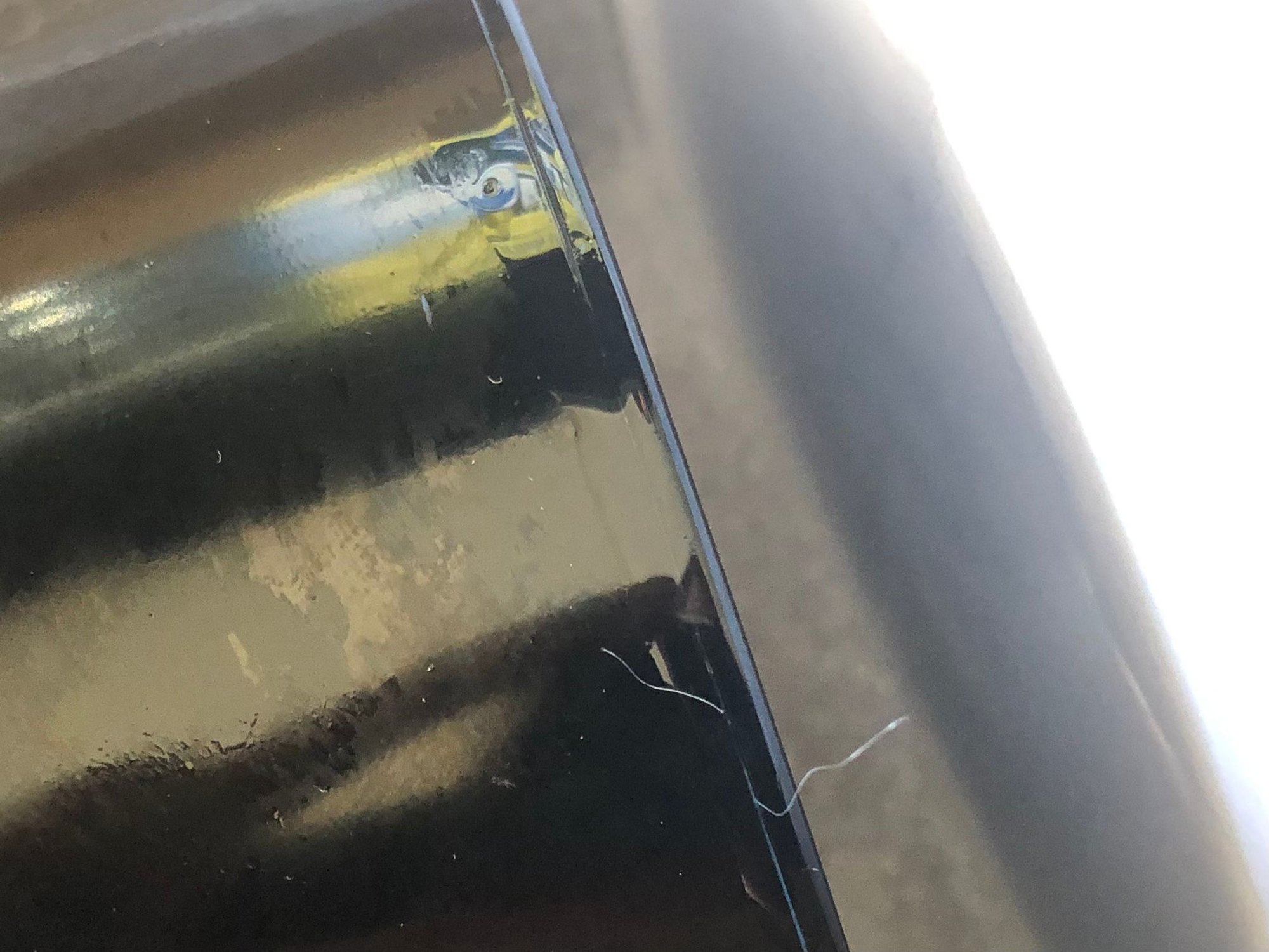

I wanted to get a post going on here to warn people of some issues I personally had and issues I have seen from others using the Gear X Viscous Coupler, so you can at least do some additional research before making a purchase with Gear X.
Besides HT, I am on some Facebook Groups, one being Honda Acura AWD Conversions created by Josh Robbins. This is the same guy who goes by pirate garage or something like that who has done videos reviews for a bunch of products but ALOT for Gear X products.
One thing I noticed about this group is that if you have any negative reviews about Gear X the thread is automatically deleted. Besides having my own issues with Gear X, my particular problem was resolved with me getting refunded my money and returning their JUNK.

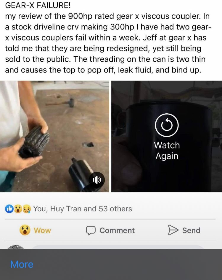

Anyways, I noticed a thread created on the AWD group page with a dude who had a Gear X failure with his viscous coupler leaking fluid and breaking. Now these Viscous Couplers are $2600 bucks, so they are F ing expensive. Anyway I responded to the thread that I had a similar issue with mine leaking on my original and the replacement they sent me but I caught it in time. Literally 5 minutes later the thread was closed out and I am assuming it was by Josh or some moderator but I don't know.
Anyway I wanted to post up what another dude screenshot and sent over to me before this thread got deleted and I will also post up pictures I had of my Gear X viscous failure. Anyway I thought this would be a good time to post something up so if anyone out there is doing some AWD research comes across this thread and thinks twice.
