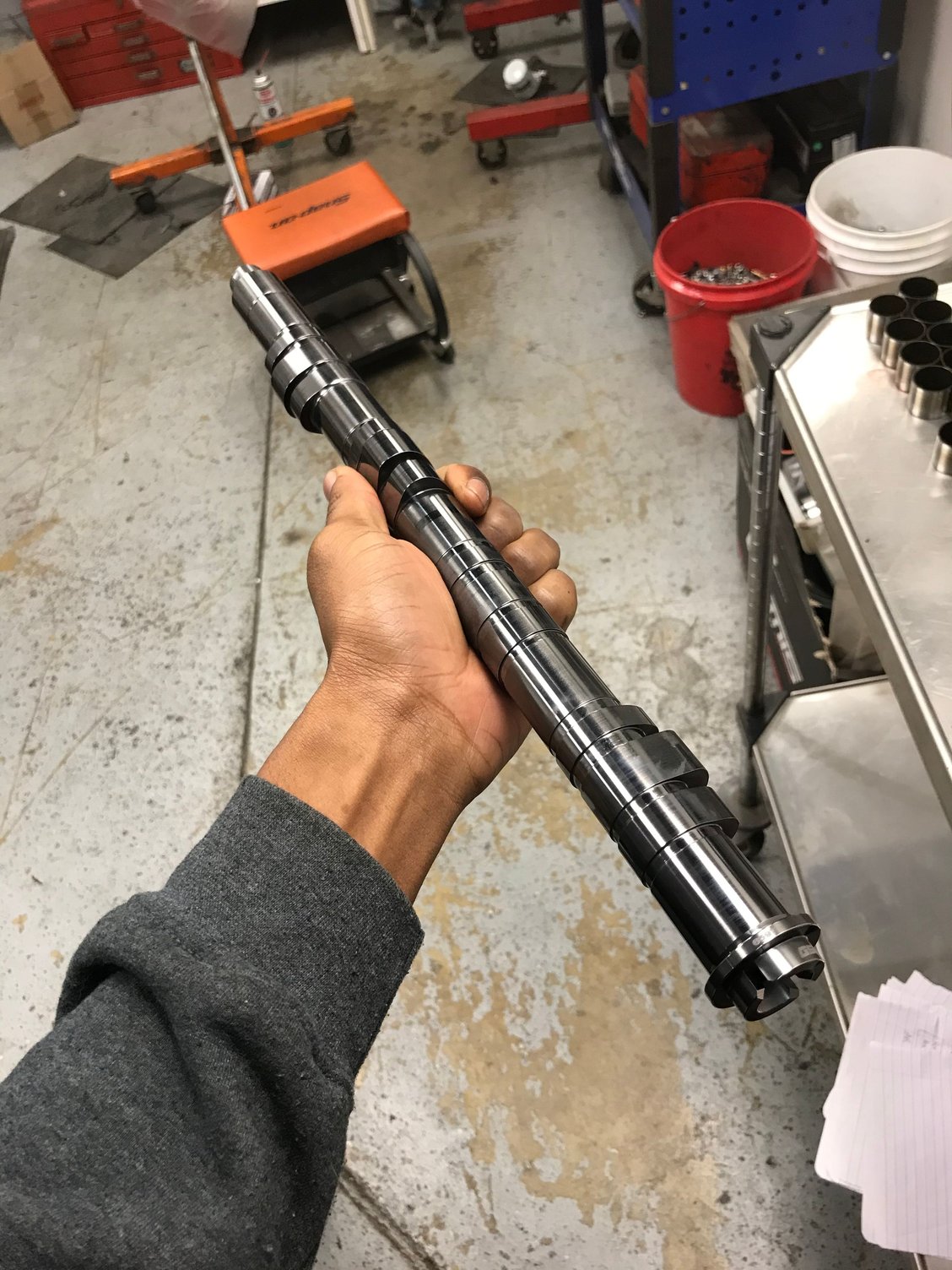

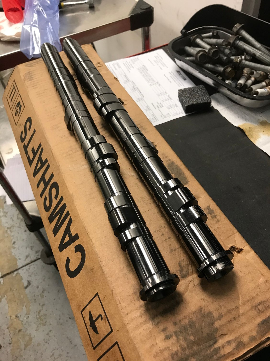

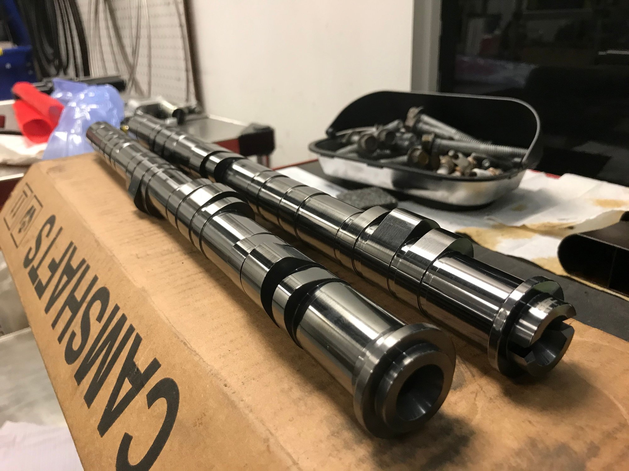

I am not. I had to pull the head twice with the old T1s for rocker arm problems.
Went as far as swapping over to all GSC Matching valvetrain, same rocker and cam wear problems. My cams were replaced with a newer version. I’m going to go with an oem cam for the time being so I can confirm that the head is okay. I was told the new t1s have a new finishing process for this is concern.
They do look badass though

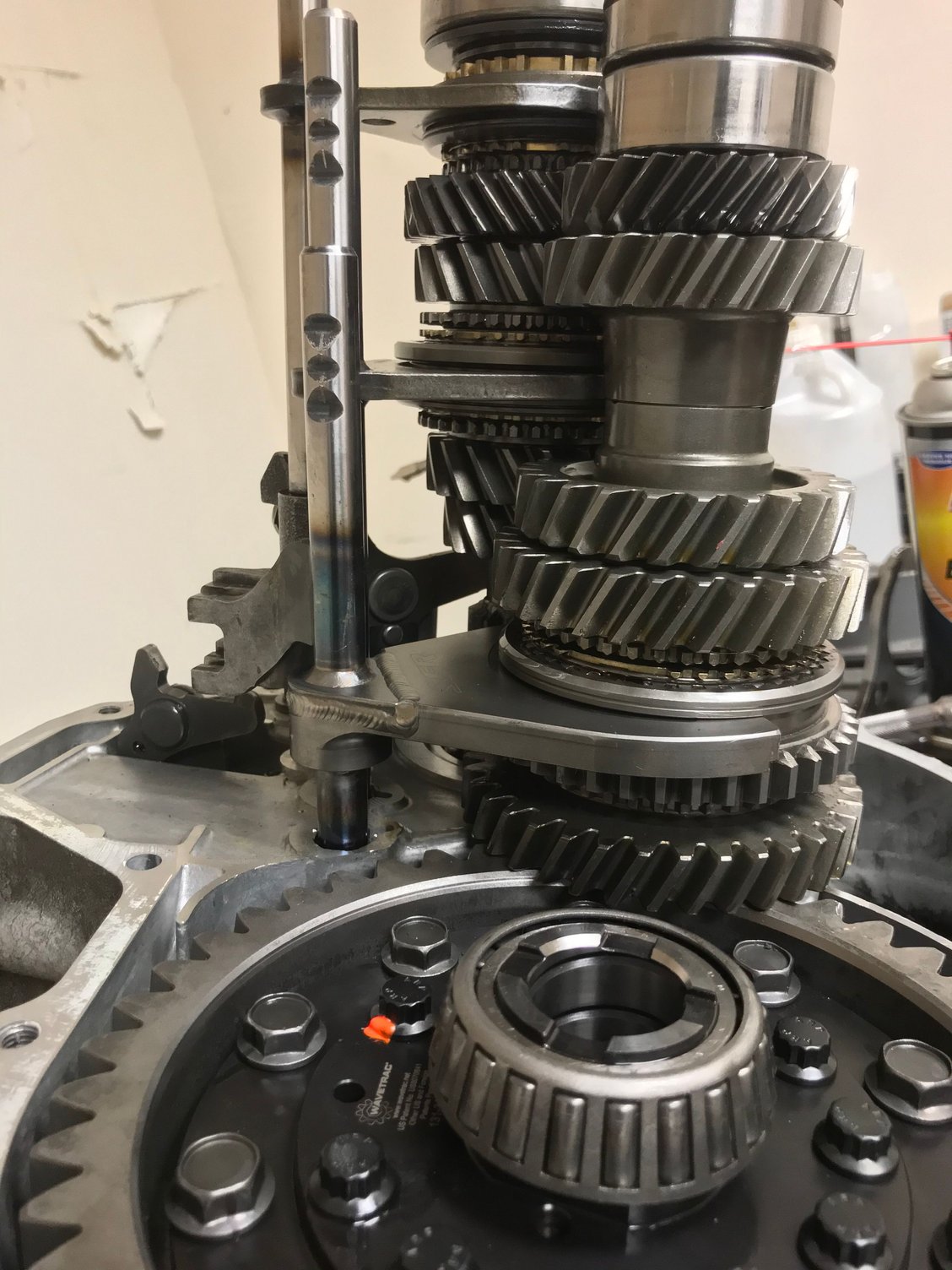

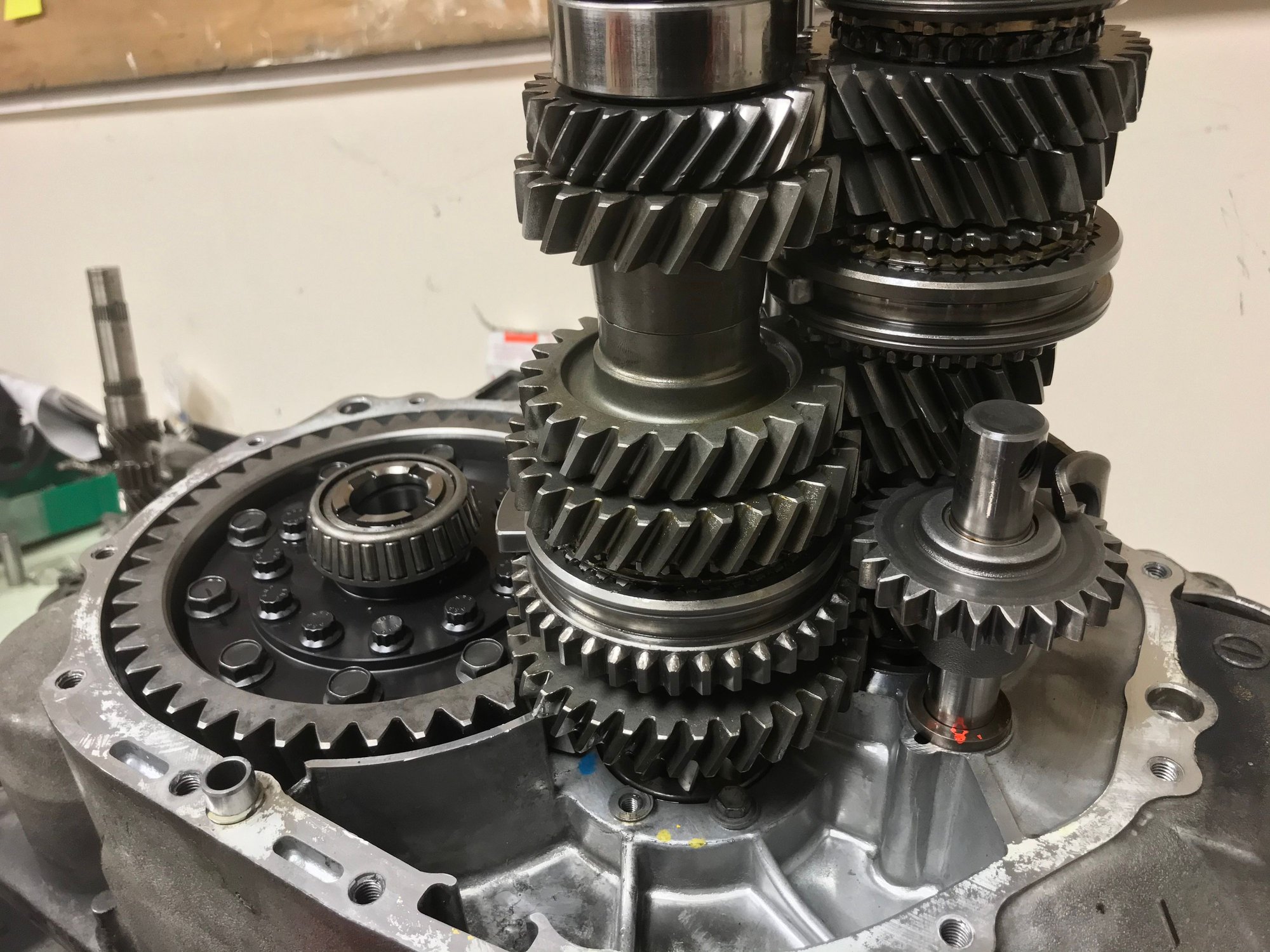

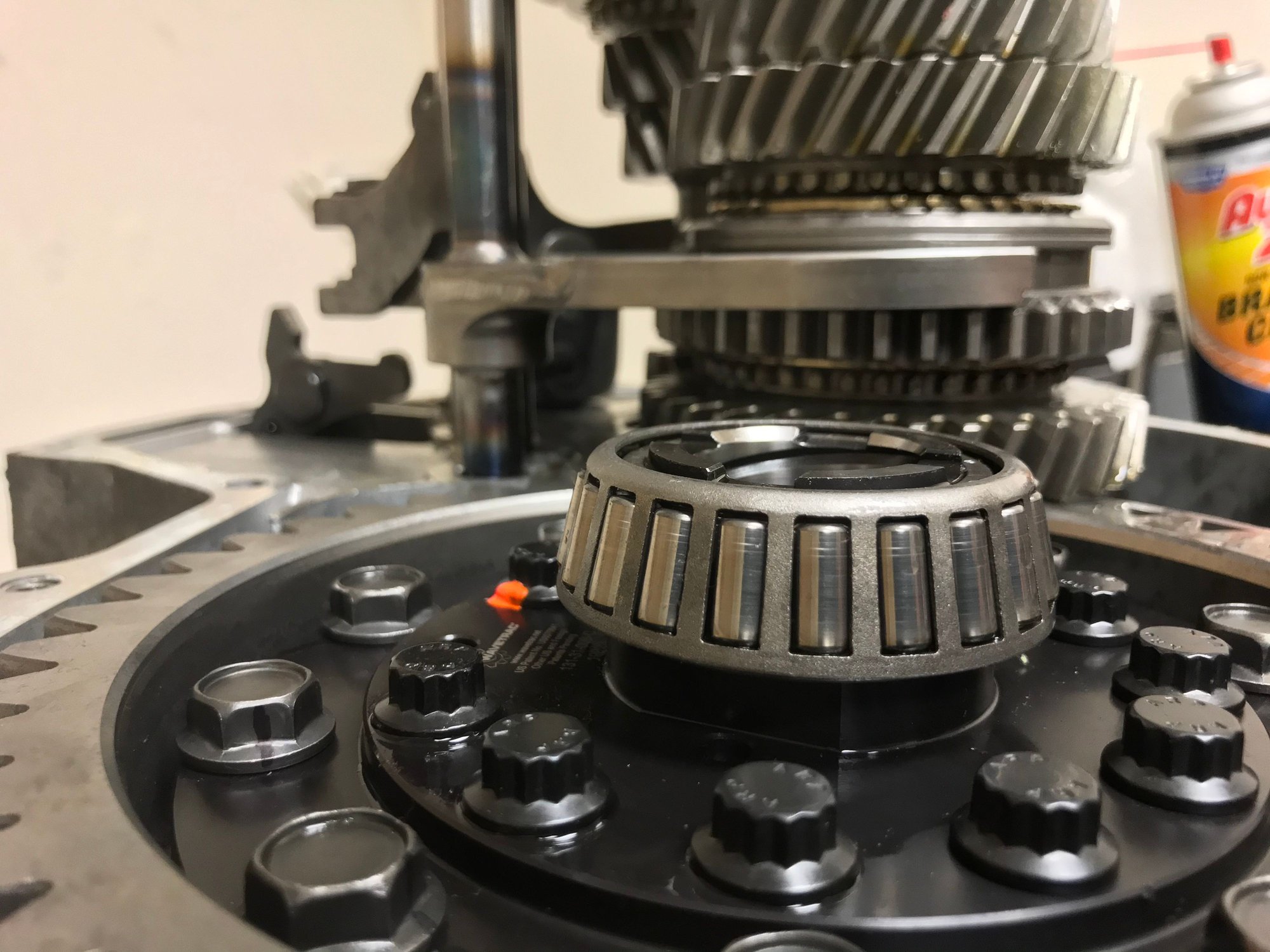

Do you have anymore pics of the albin's gear set? Just some pics of the transmission before the the case was closed up
Old Sep 19, 2021 | 12:33 PM
  #380
dannydos's Avatar
Posts: 1,391
Default Re: DA-NINE's PTE6870 AWD Integra build thread - updated for 2019
Thank you!

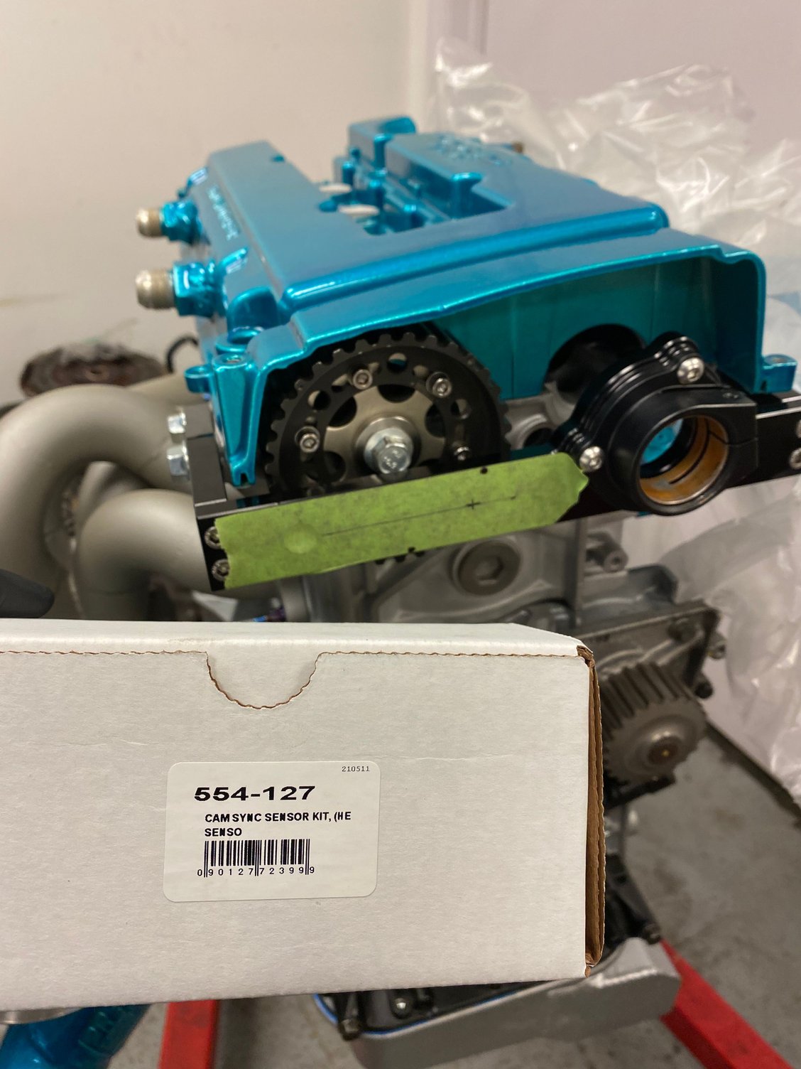

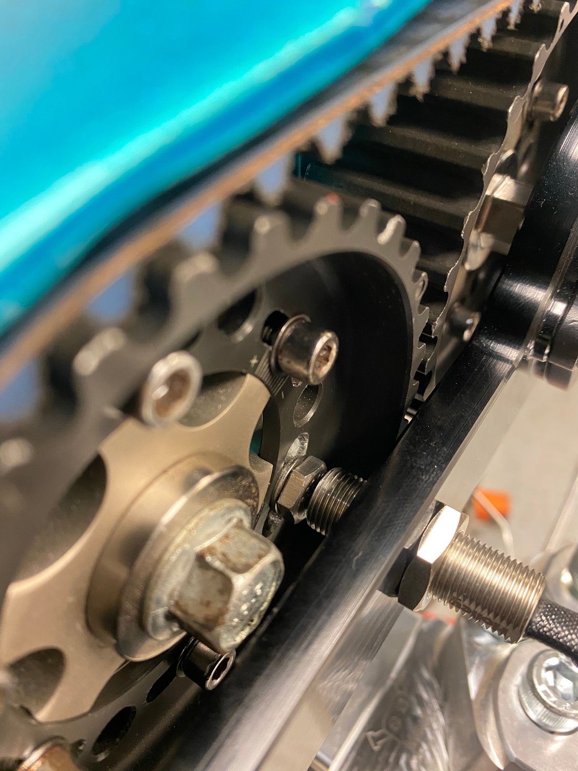

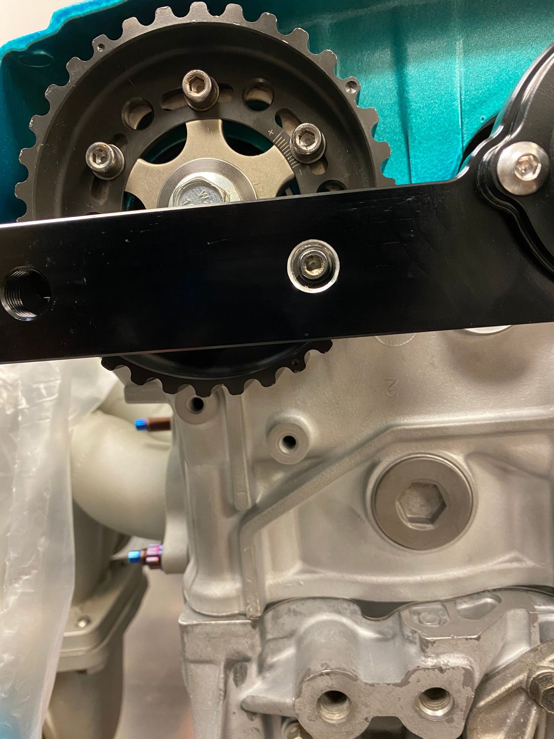

Also got my cam and crank position sensors done.
Holley efi cam sync, Honeywell sensor on an Obd2 timing gear. SpeedFactory fuel pump drilled and tapped for the Holley sensor. Drilled and tapped skunk2 cam gear for the magnet bolt. Just about ready to go in the car.

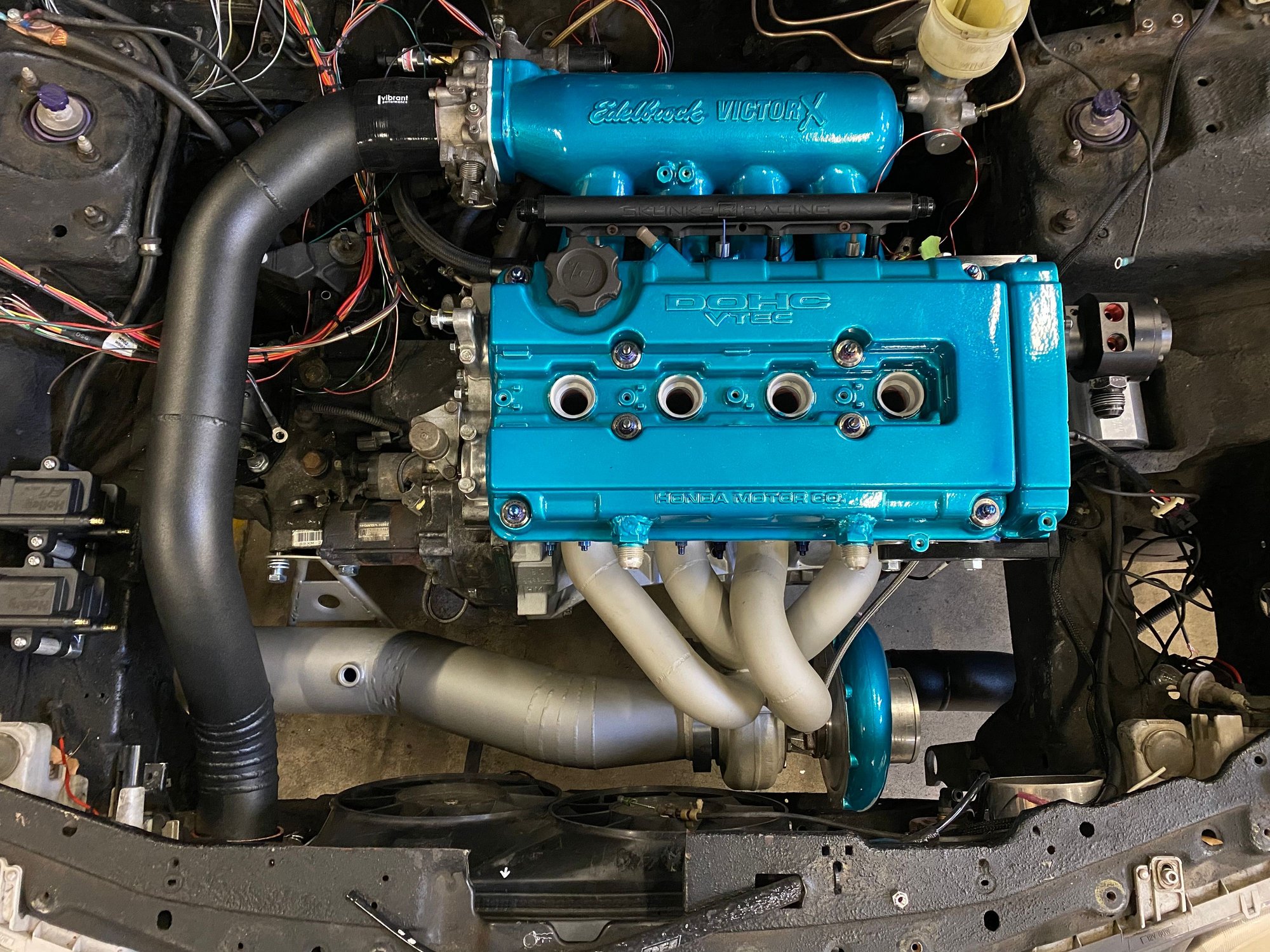

Old Nov 13, 2021 | 11:46 PM
  #382
DA-NINE's Avatar
Joined: Jul 2011
Posts: 529
Likes: 11
From: Westampton ,Nj

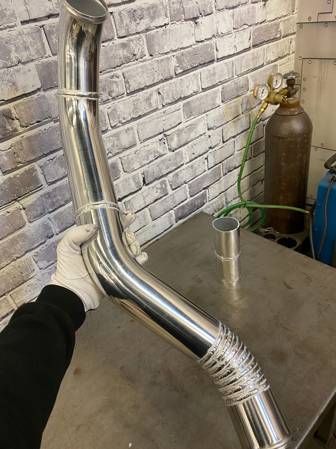

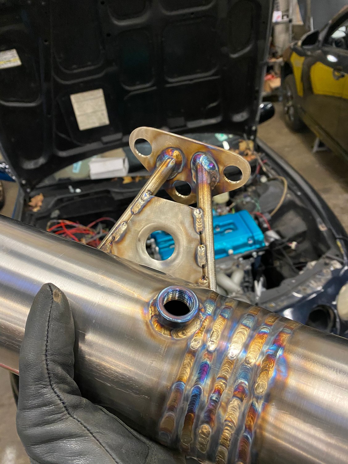

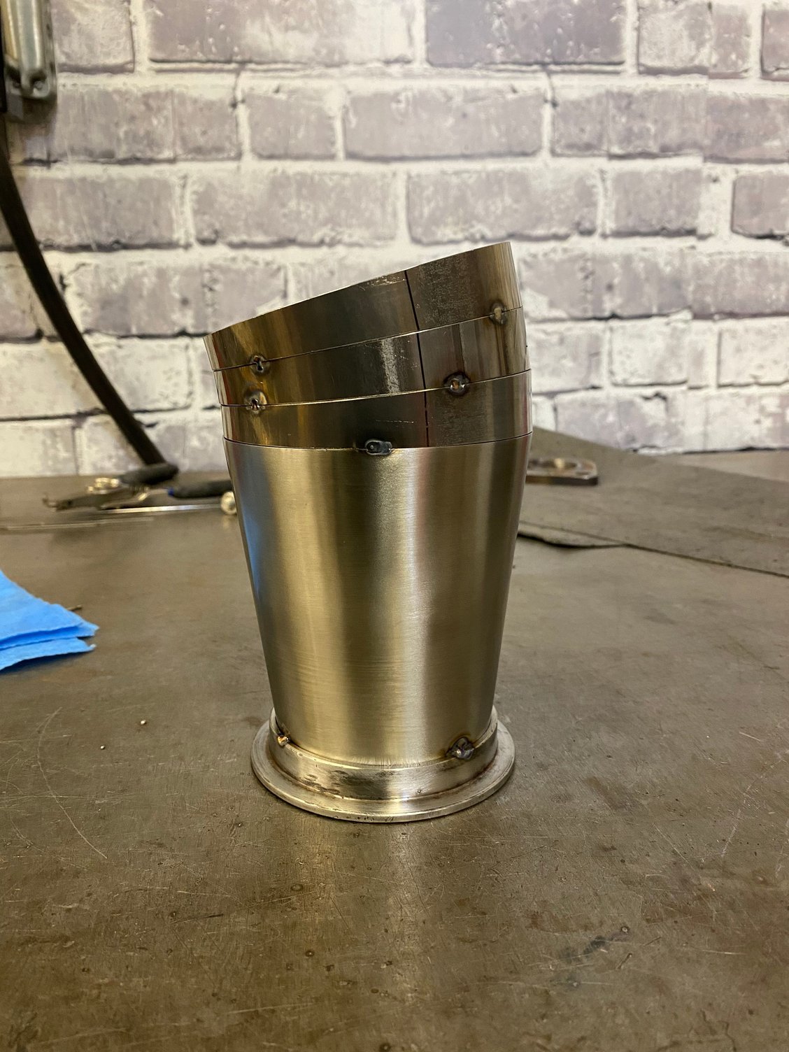

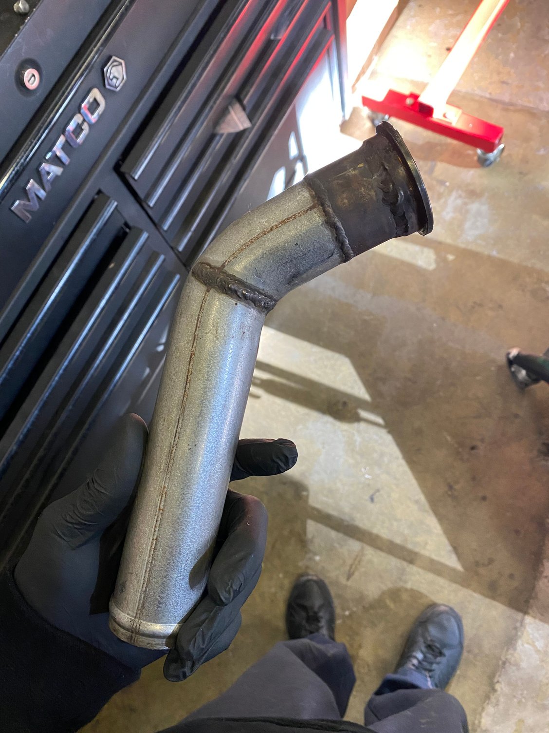

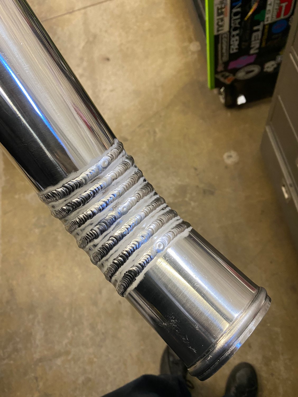

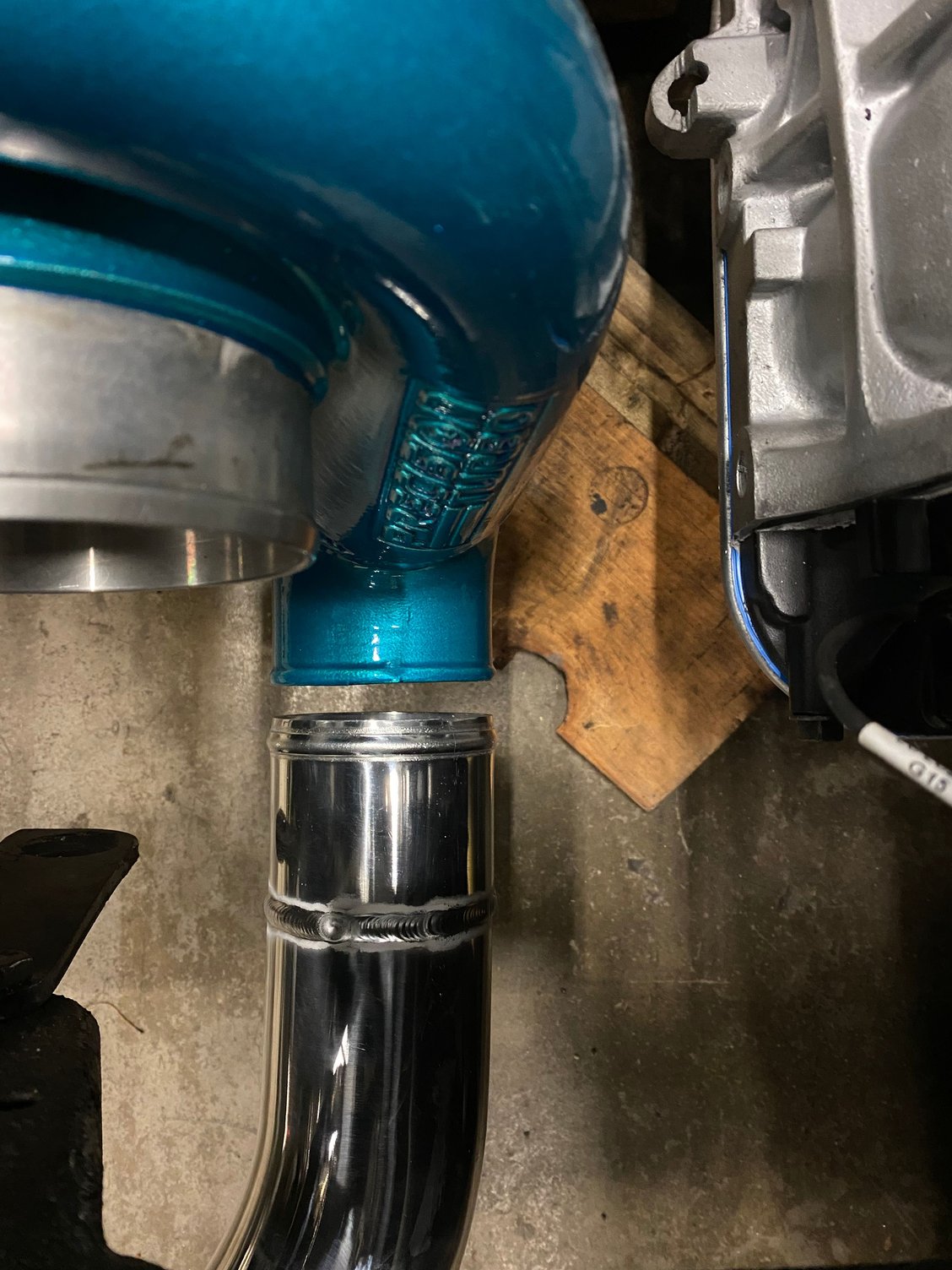

Been chipping away at the car. Got a big chunk of my fab work done.
Old Nov 14, 2021 | 12:01 AM
  #383
DA-NINE's Avatar
Joined: Jul 2011
Posts: 529
Likes: 11

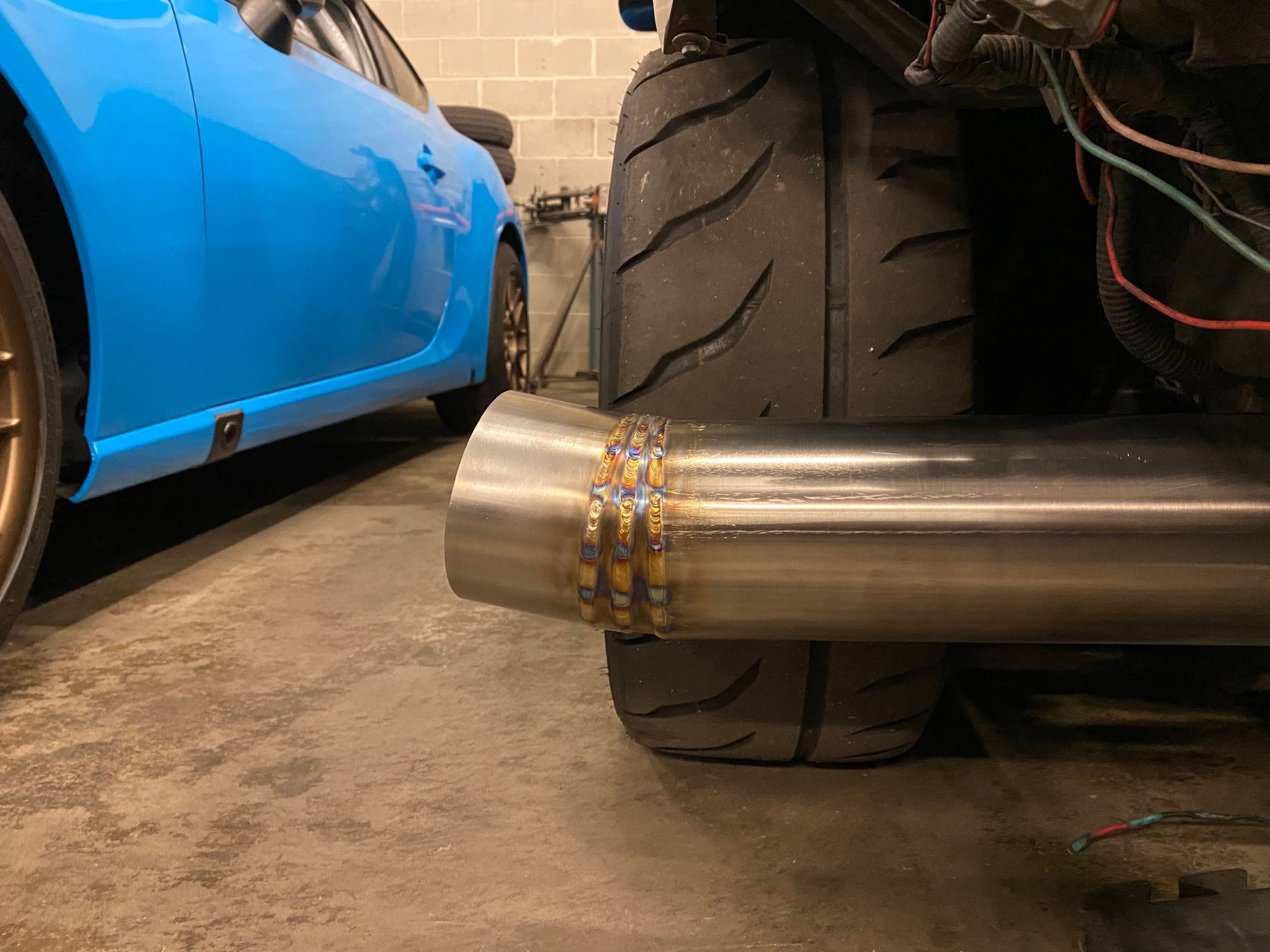

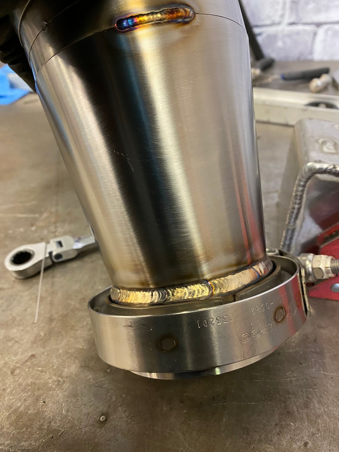

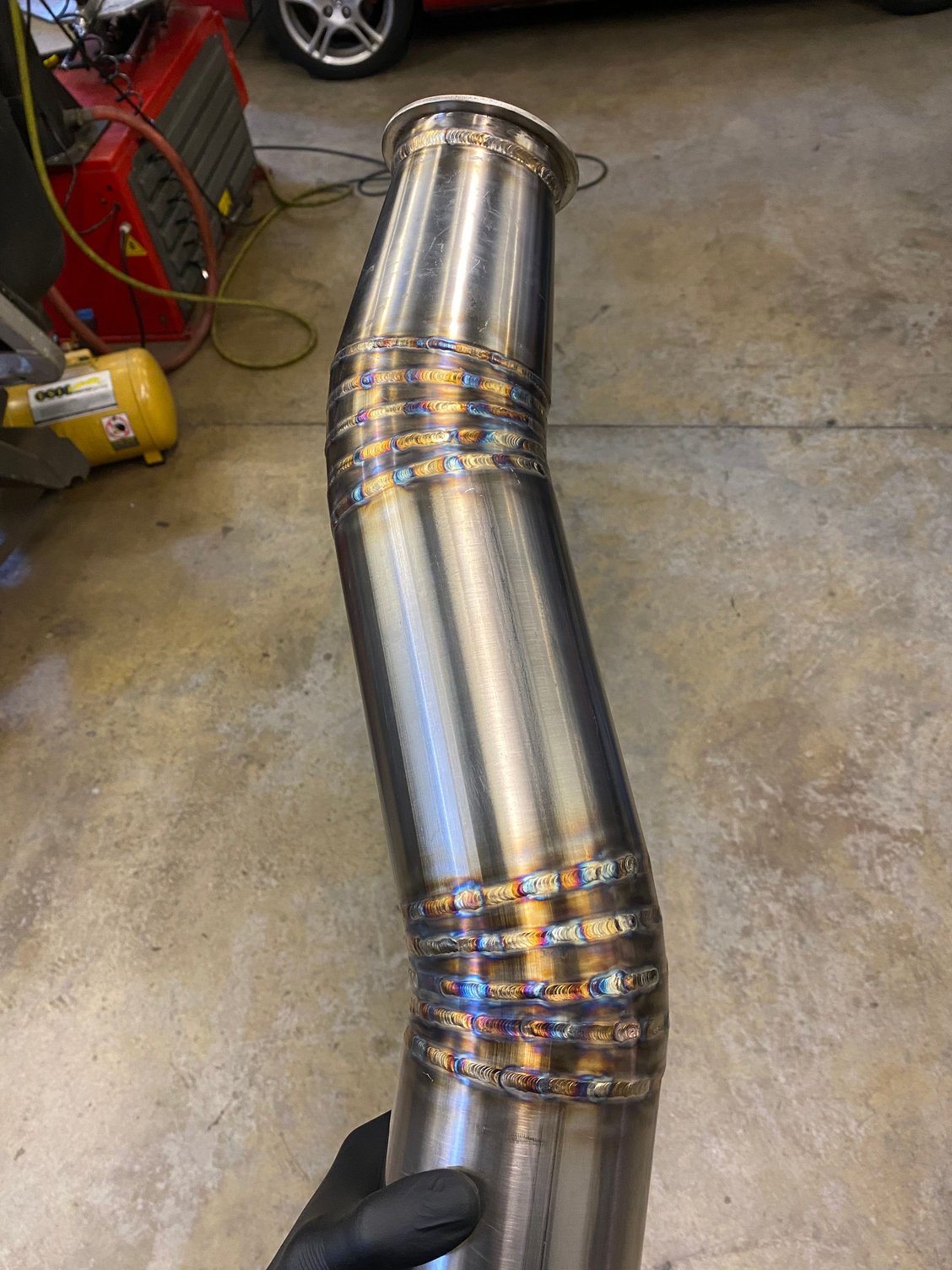

4in exhaust.

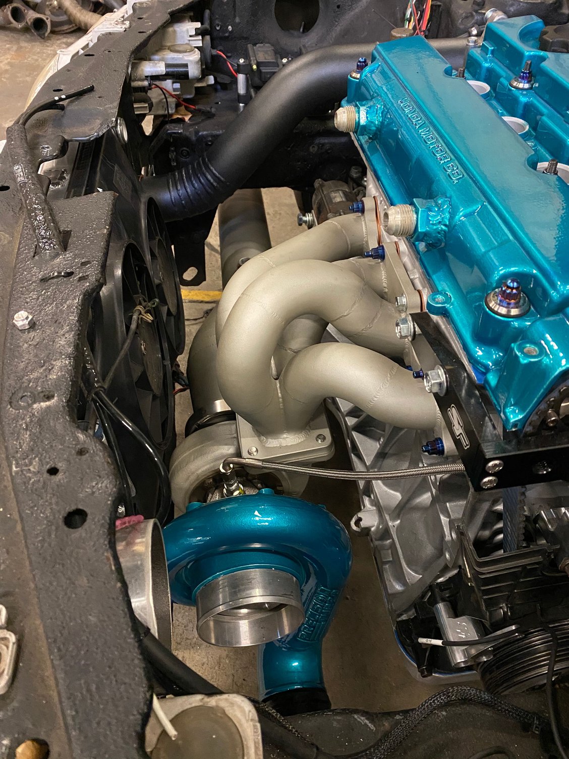

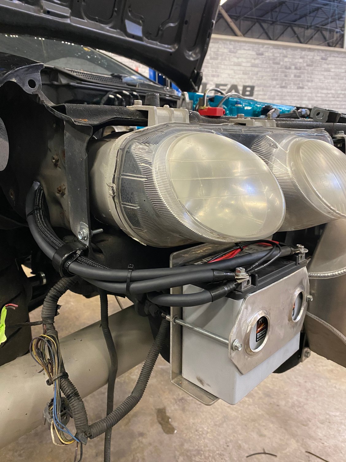

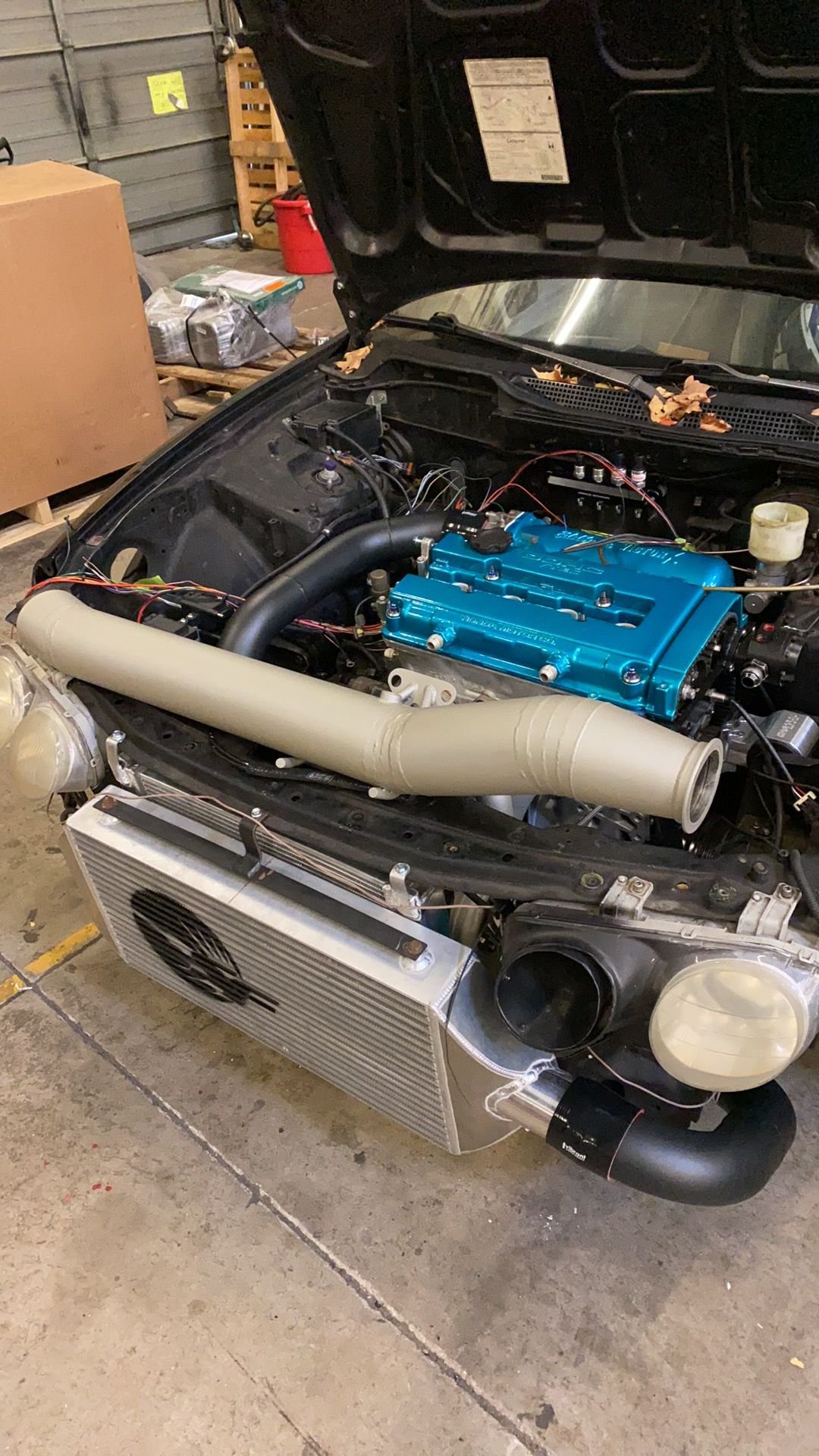

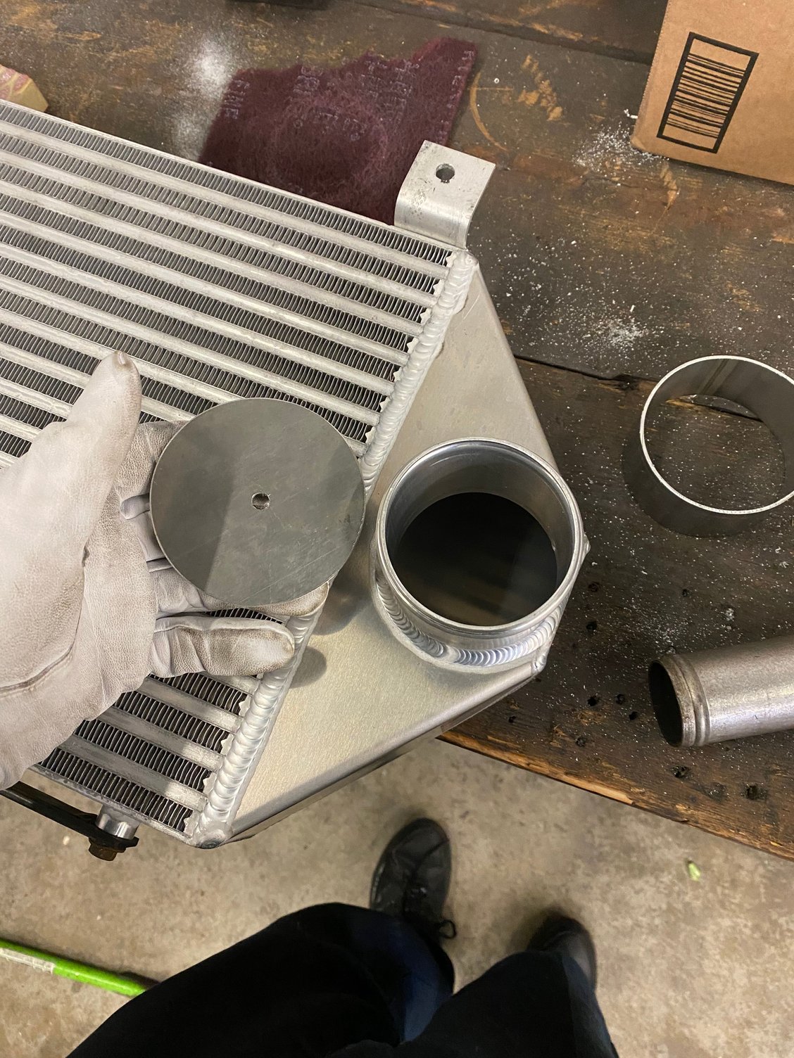

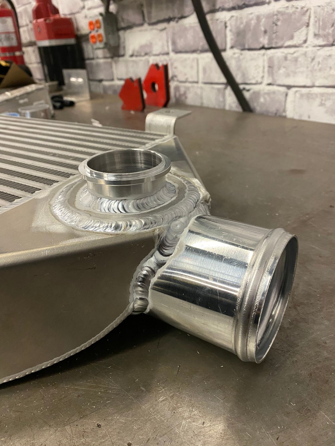

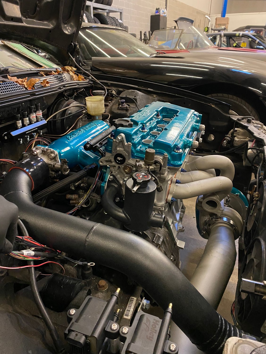

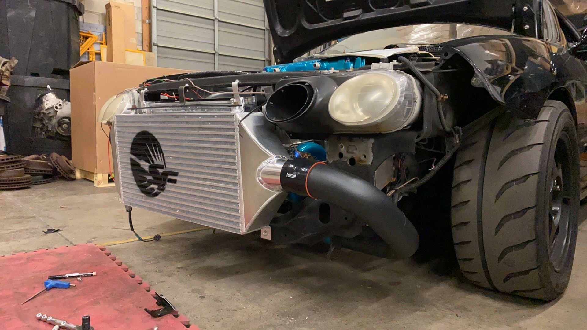

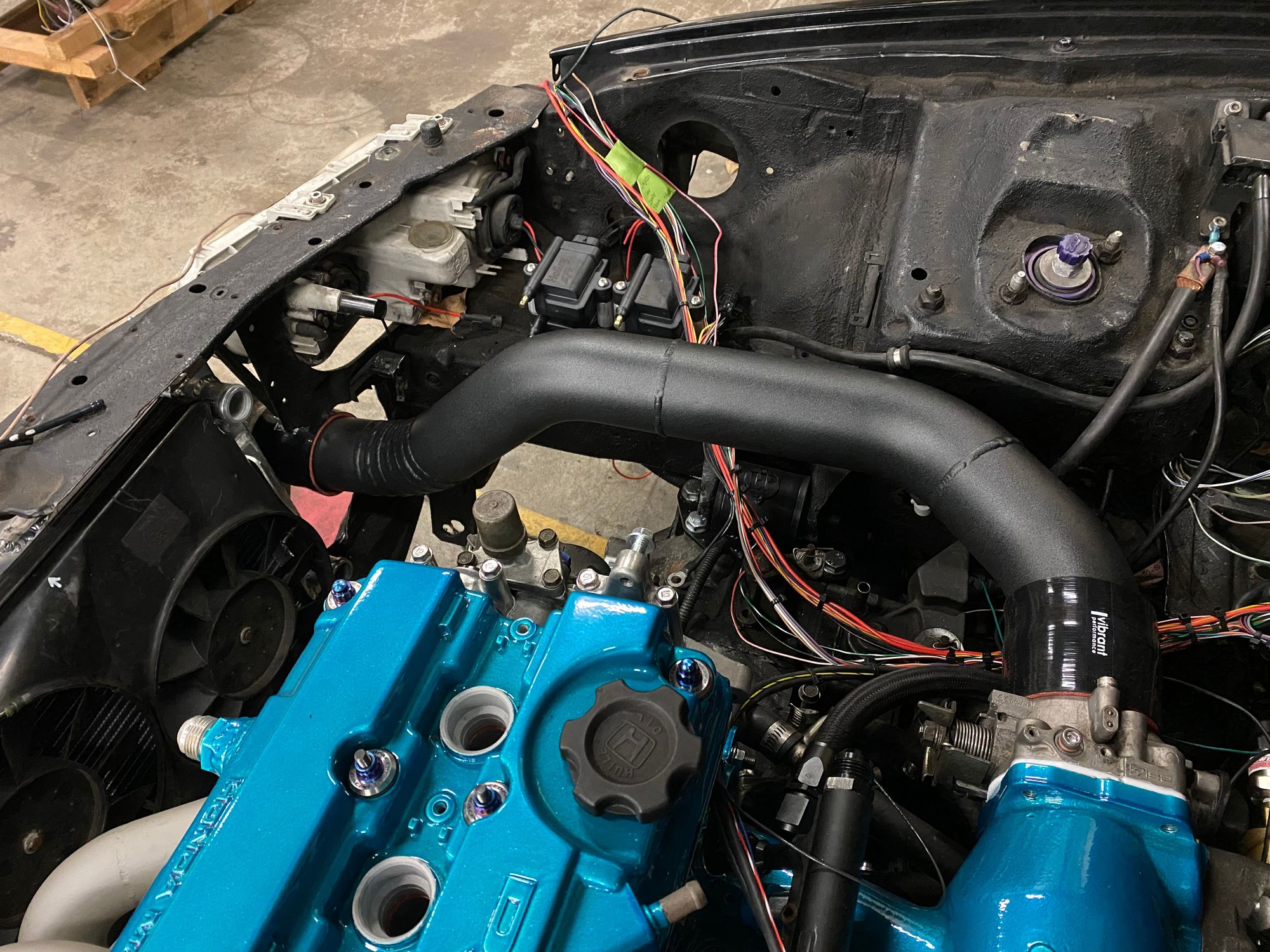

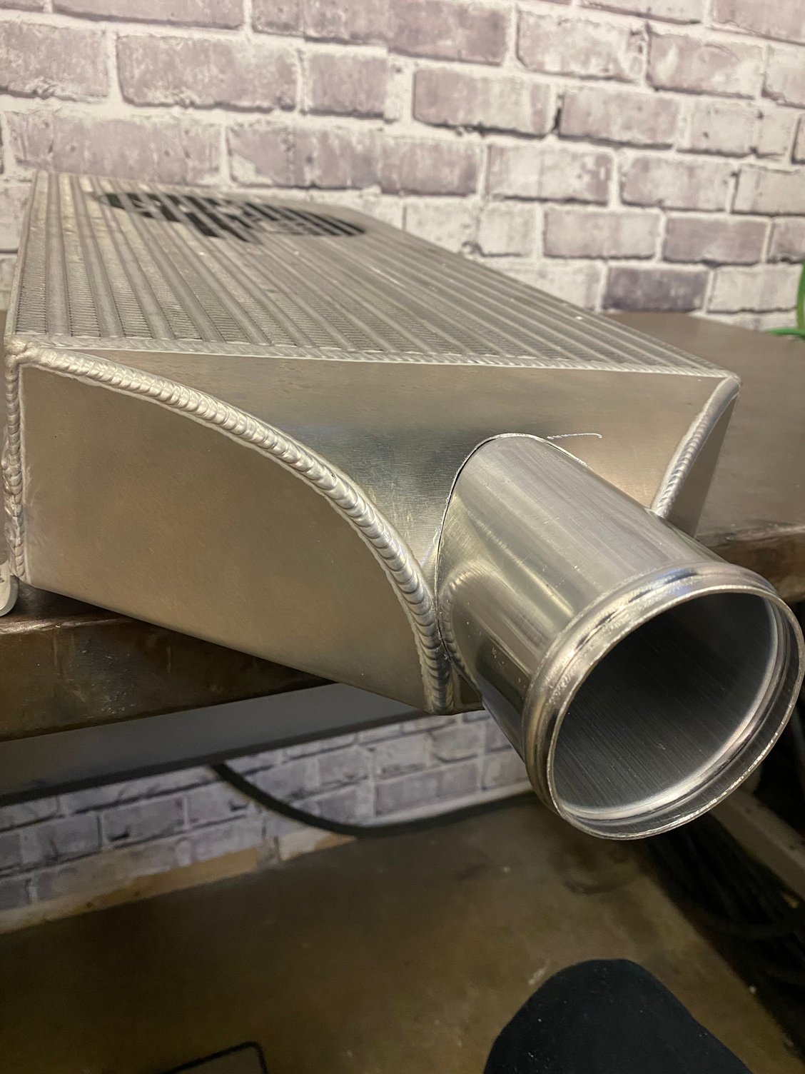

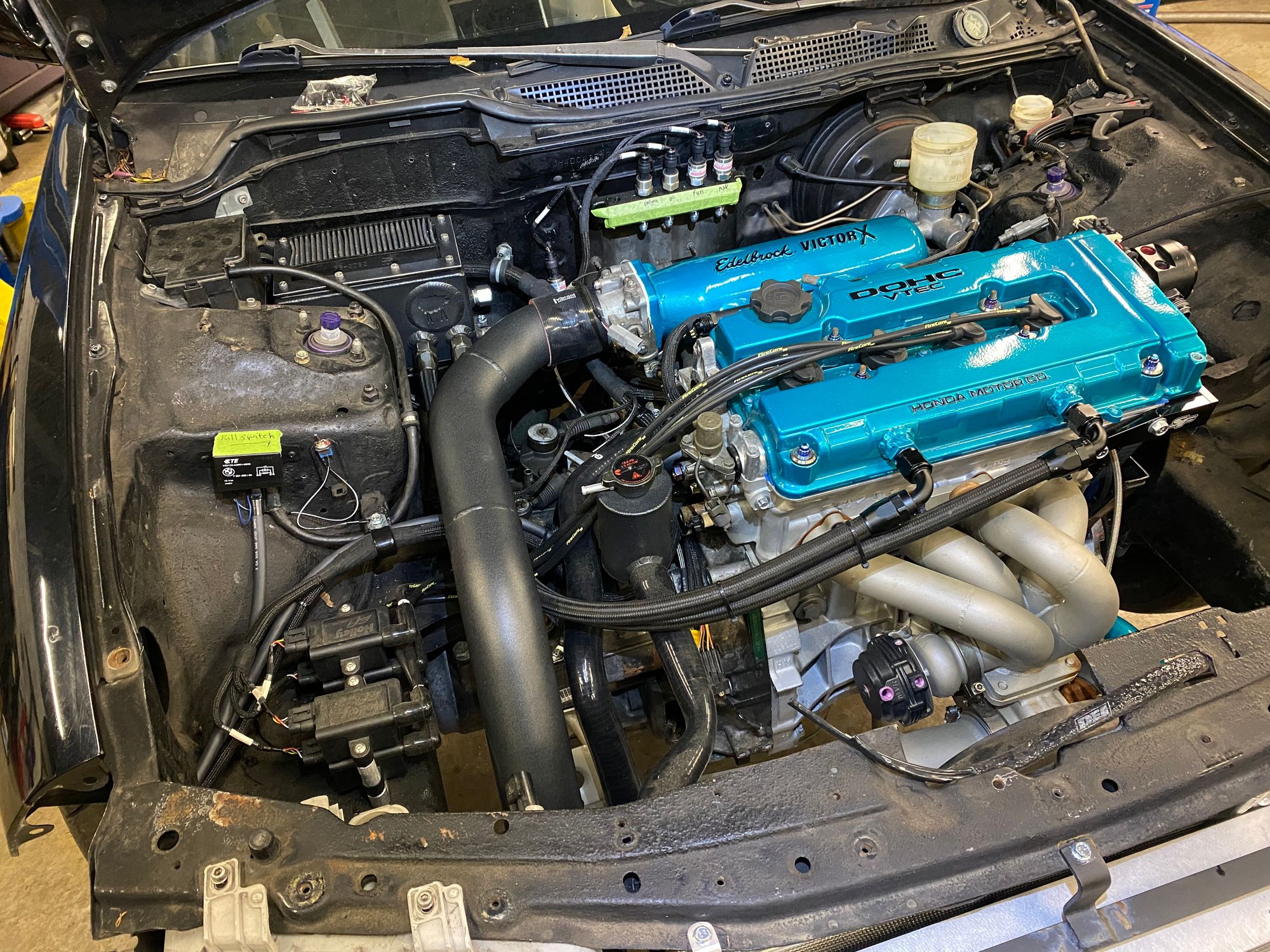

Everything is back from coating and looks killer!

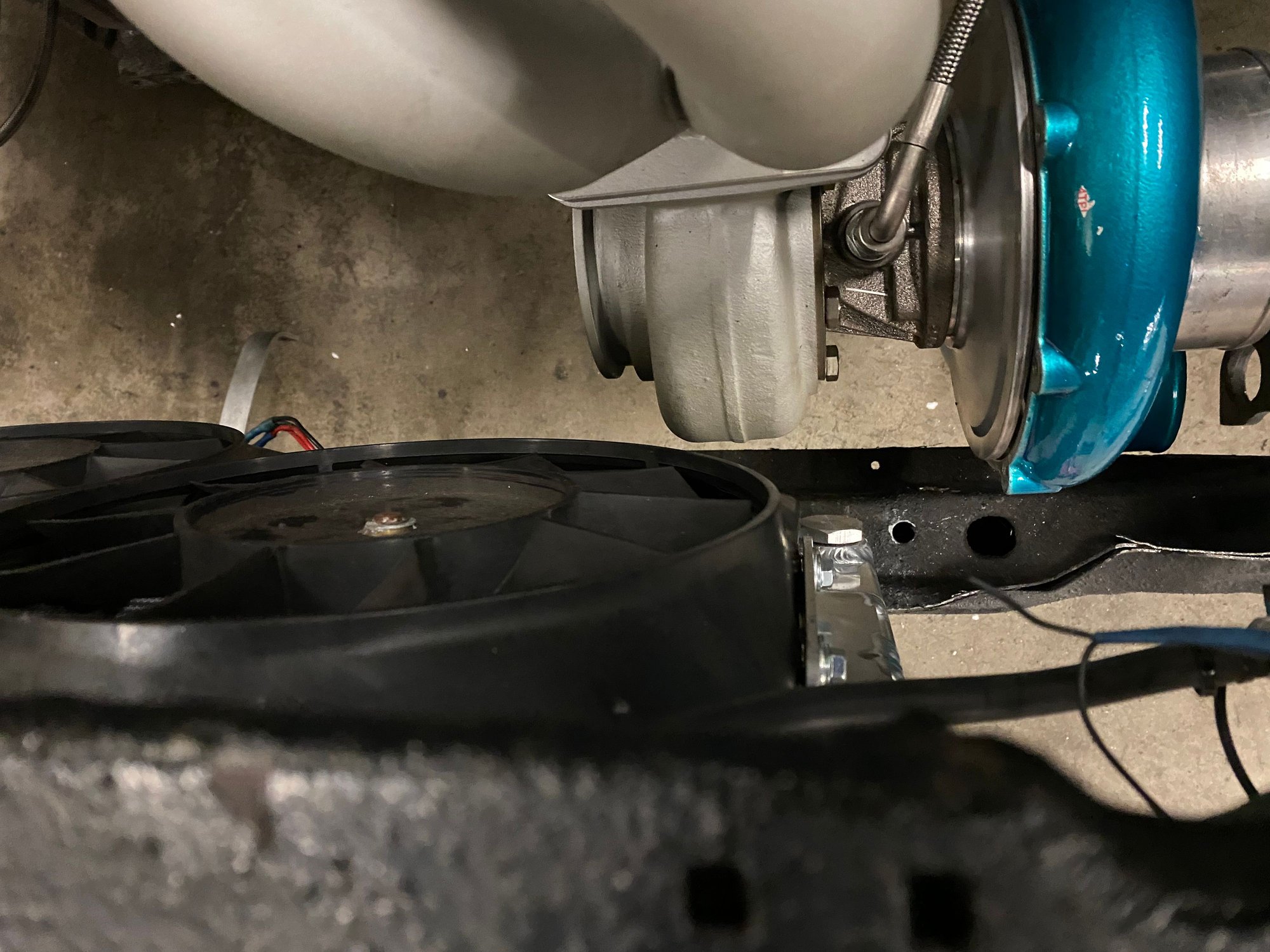

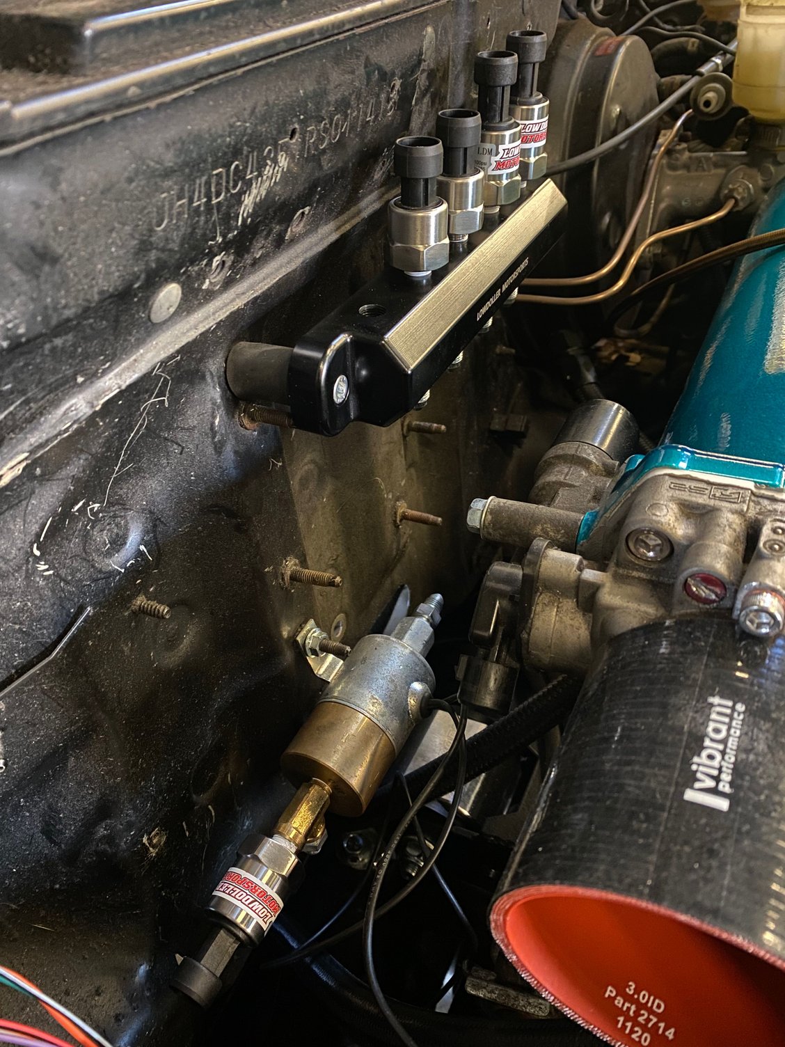

Intercooler and radiator are in, made mounting brackets for my Flexalite fan, blow off valve mounted, Sensor block assembled and mounted, clutch solenoid and pressure sensor mounted. Up next is tackling the harness.

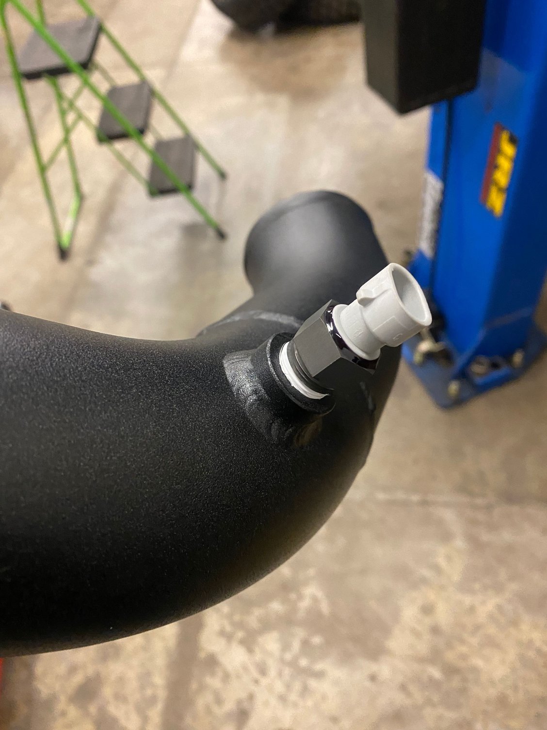

Nice - I like the block that consolidates the pressure sensors.

Originally Posted by scottcraft
That coating looks really good.
thanks! Medium wrinkle charcoal and cerakoted hot parts
made by Low Doller Motorsports. Running their block and sensors.

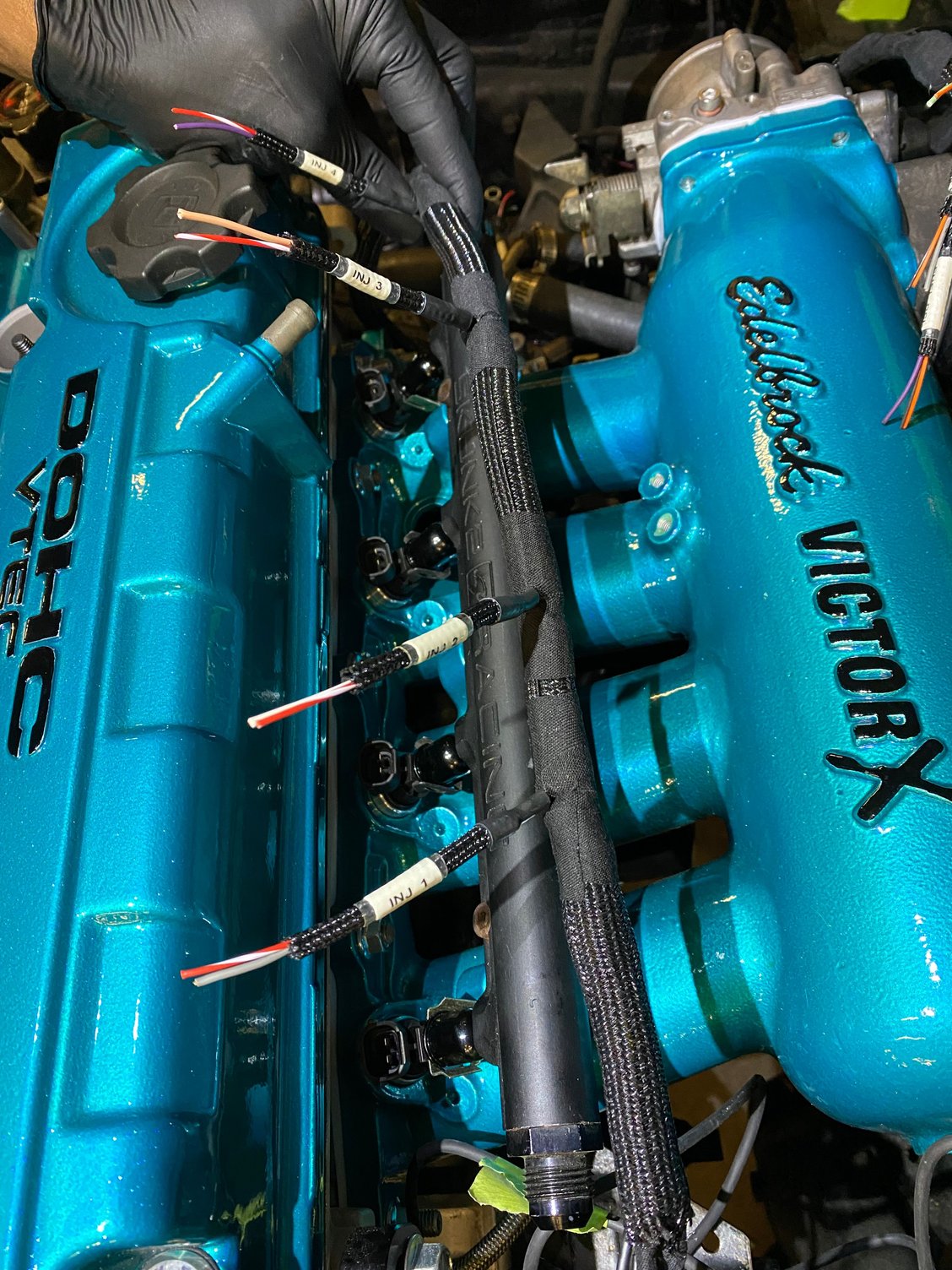

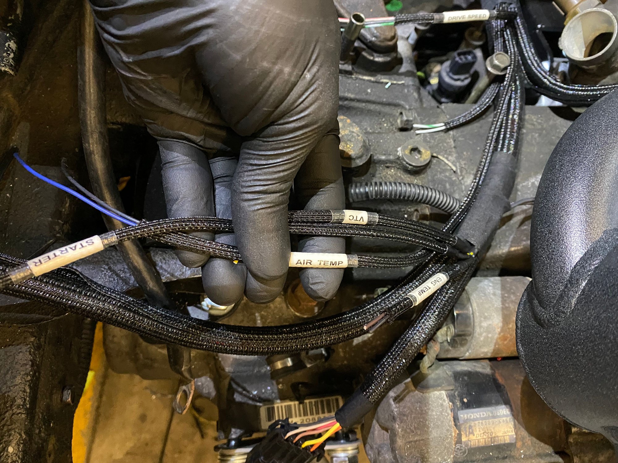

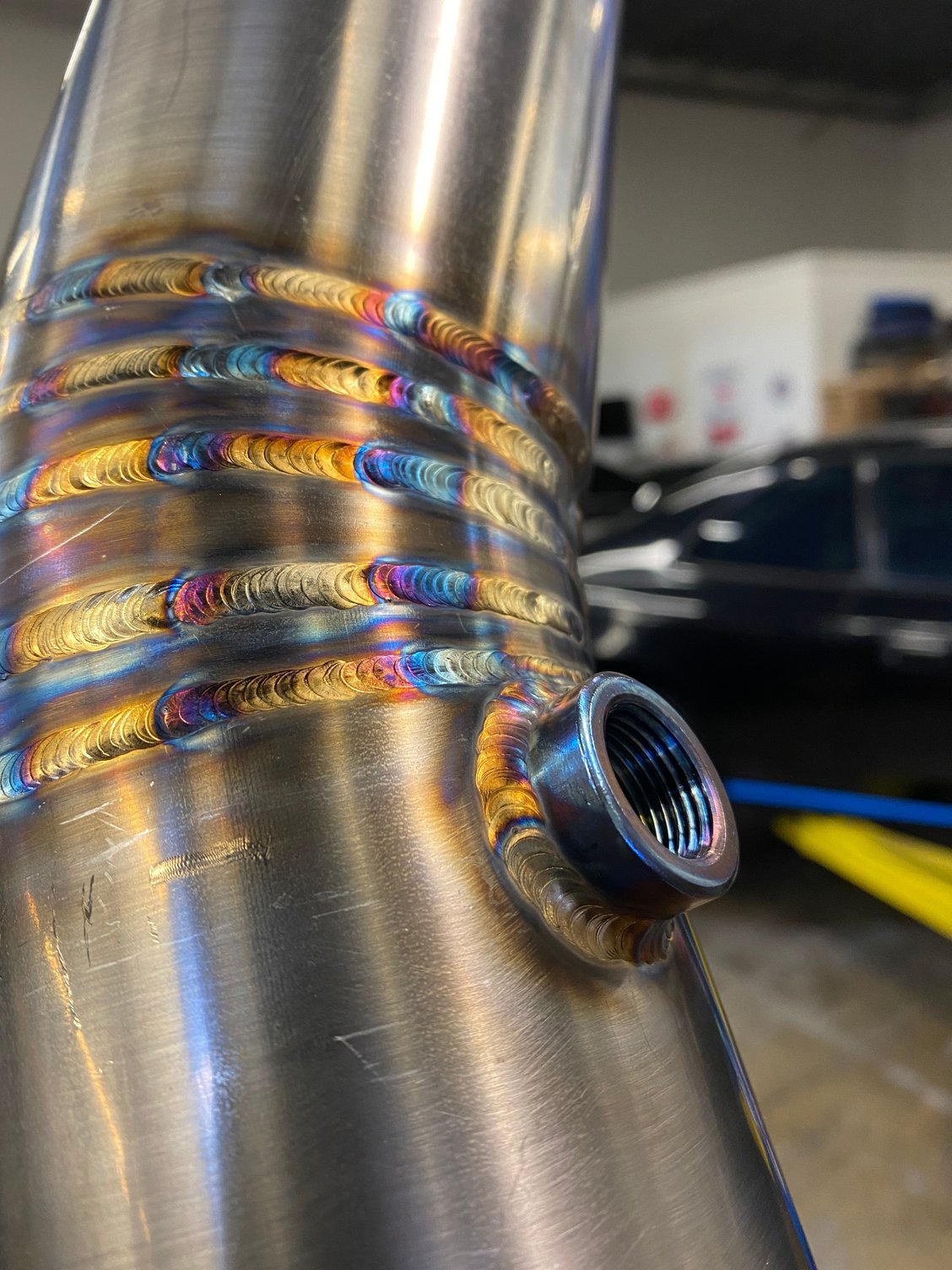

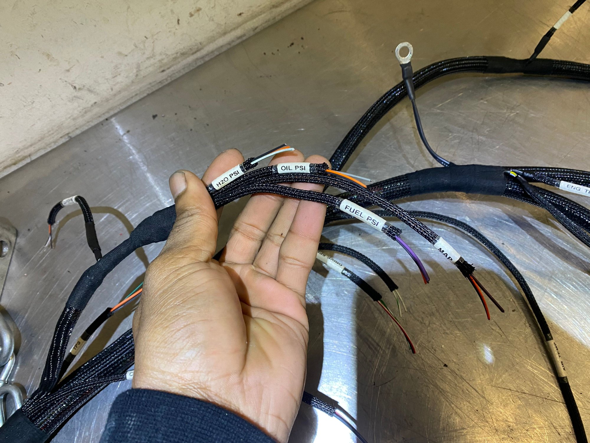

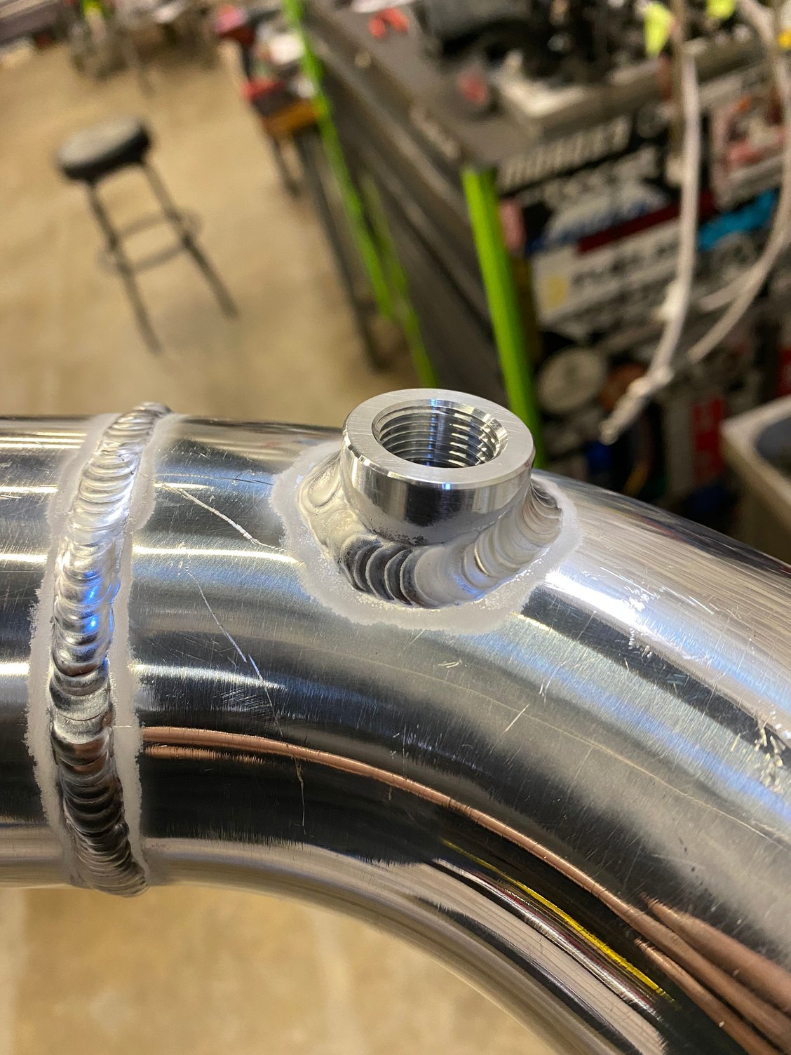

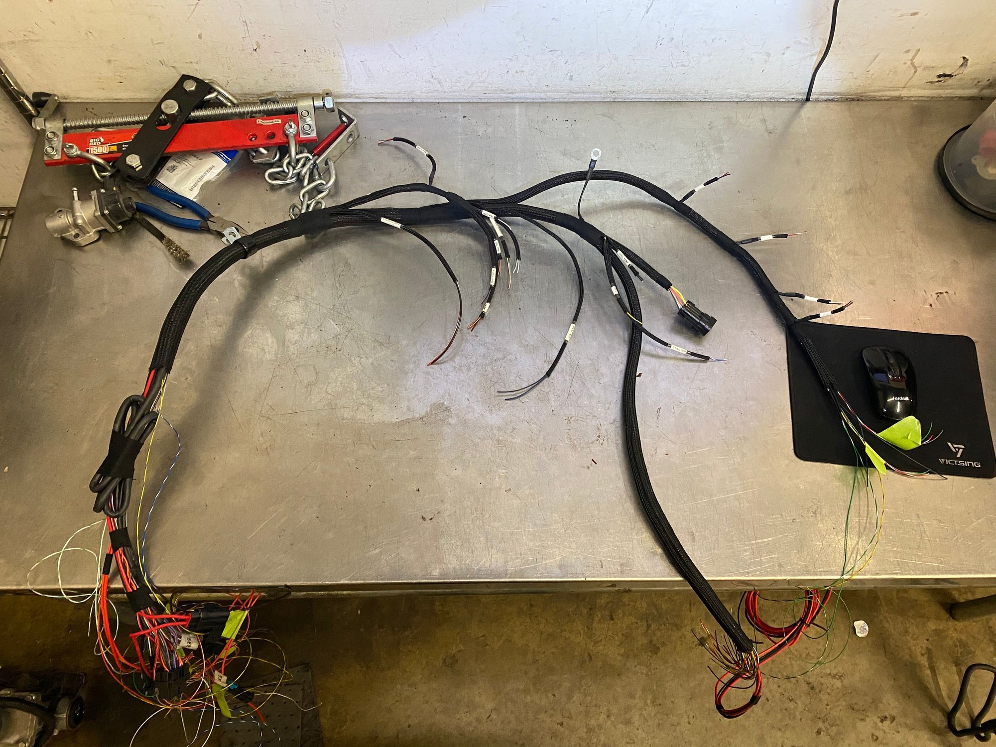

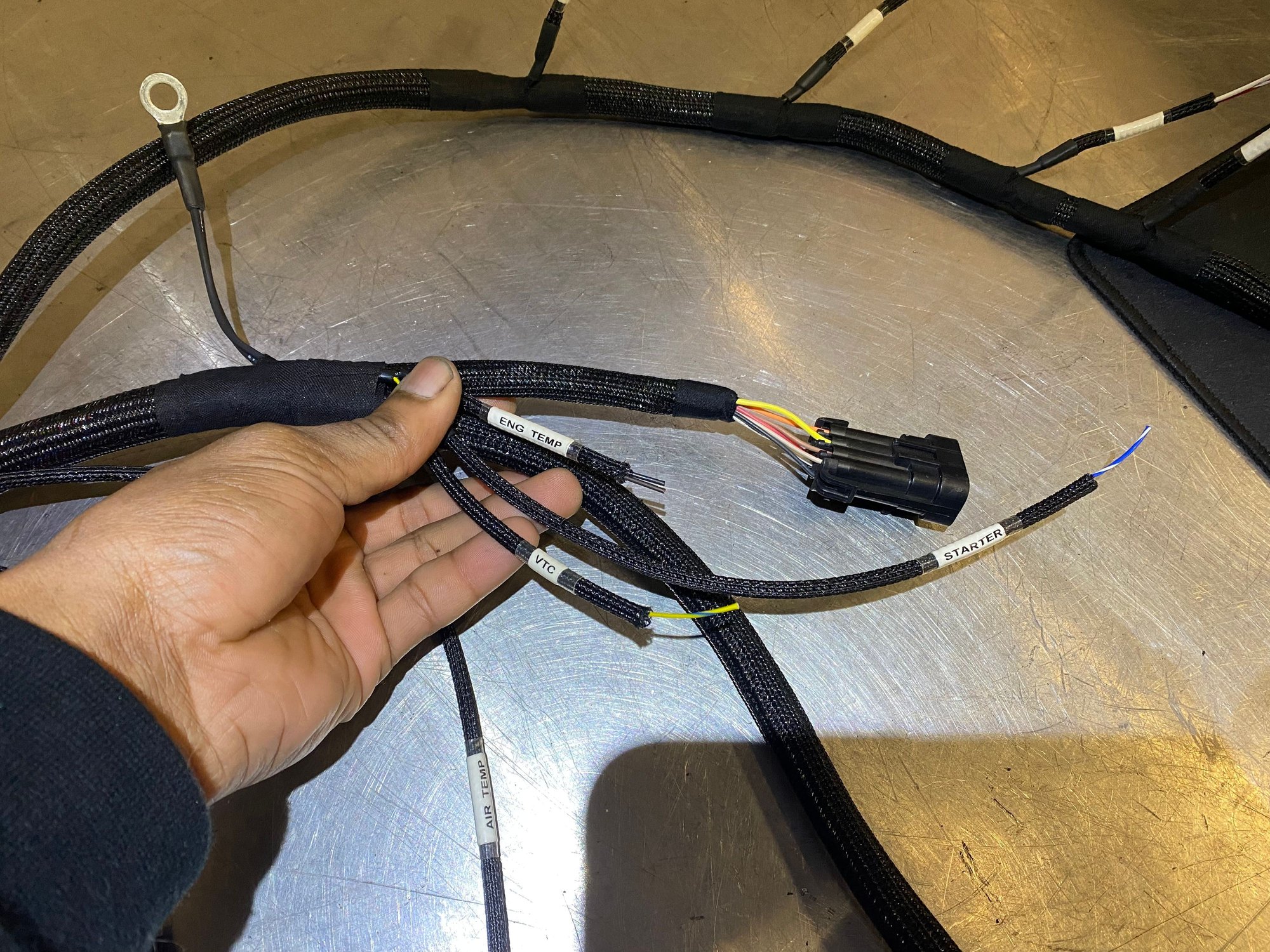

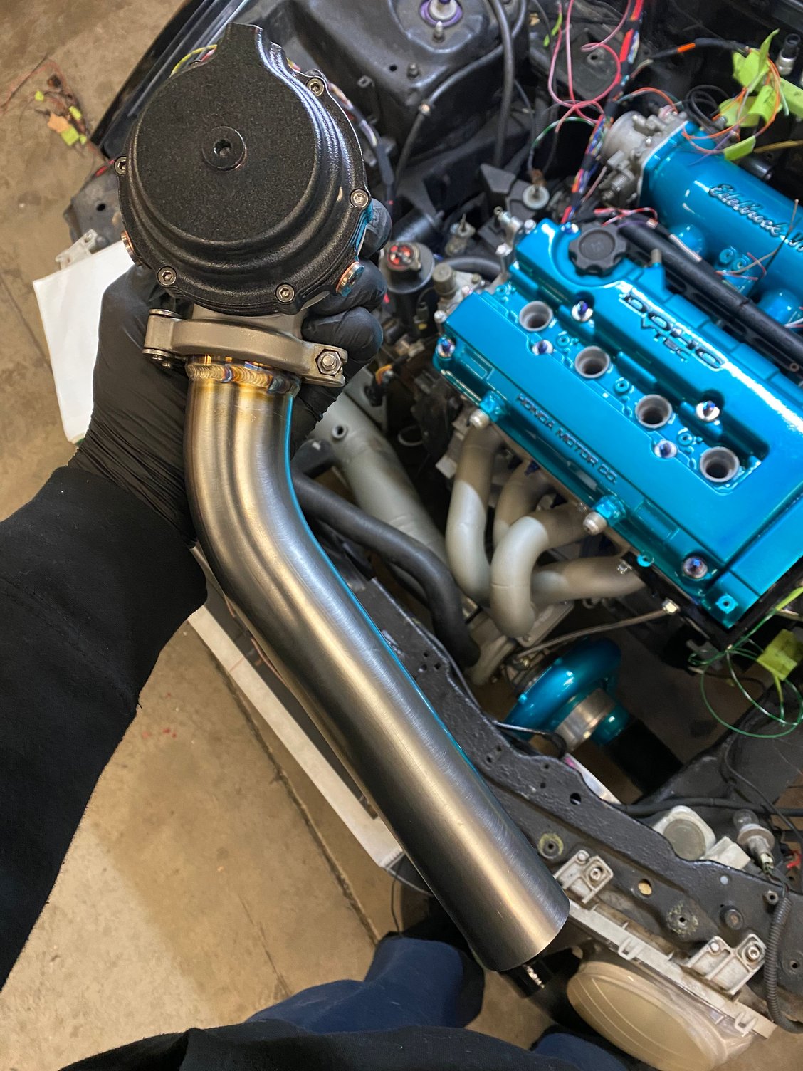

Been working on my engine harness.
Originally started as a universal v8 mpfi harness. Stripped down l, added everything for smart coils, extra sensors etc.

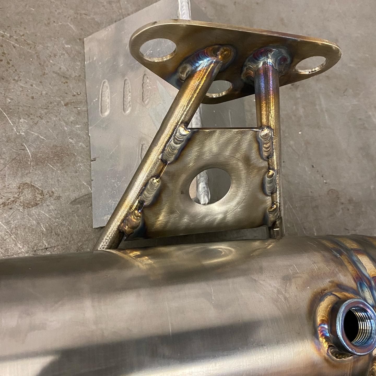

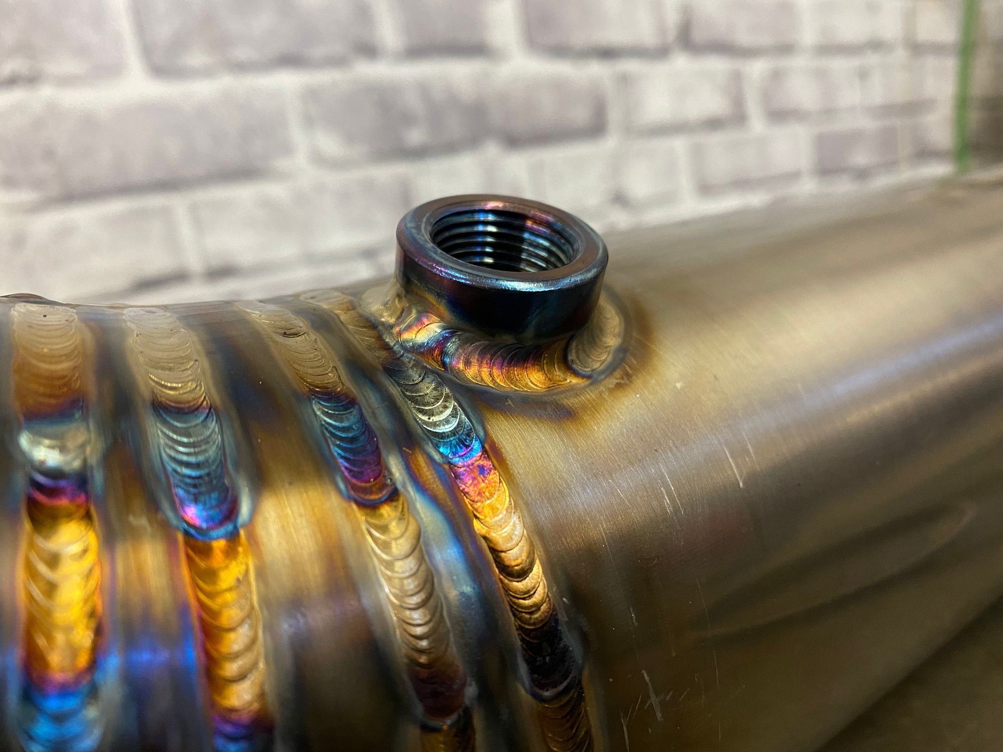

also remade my wastegate dump.

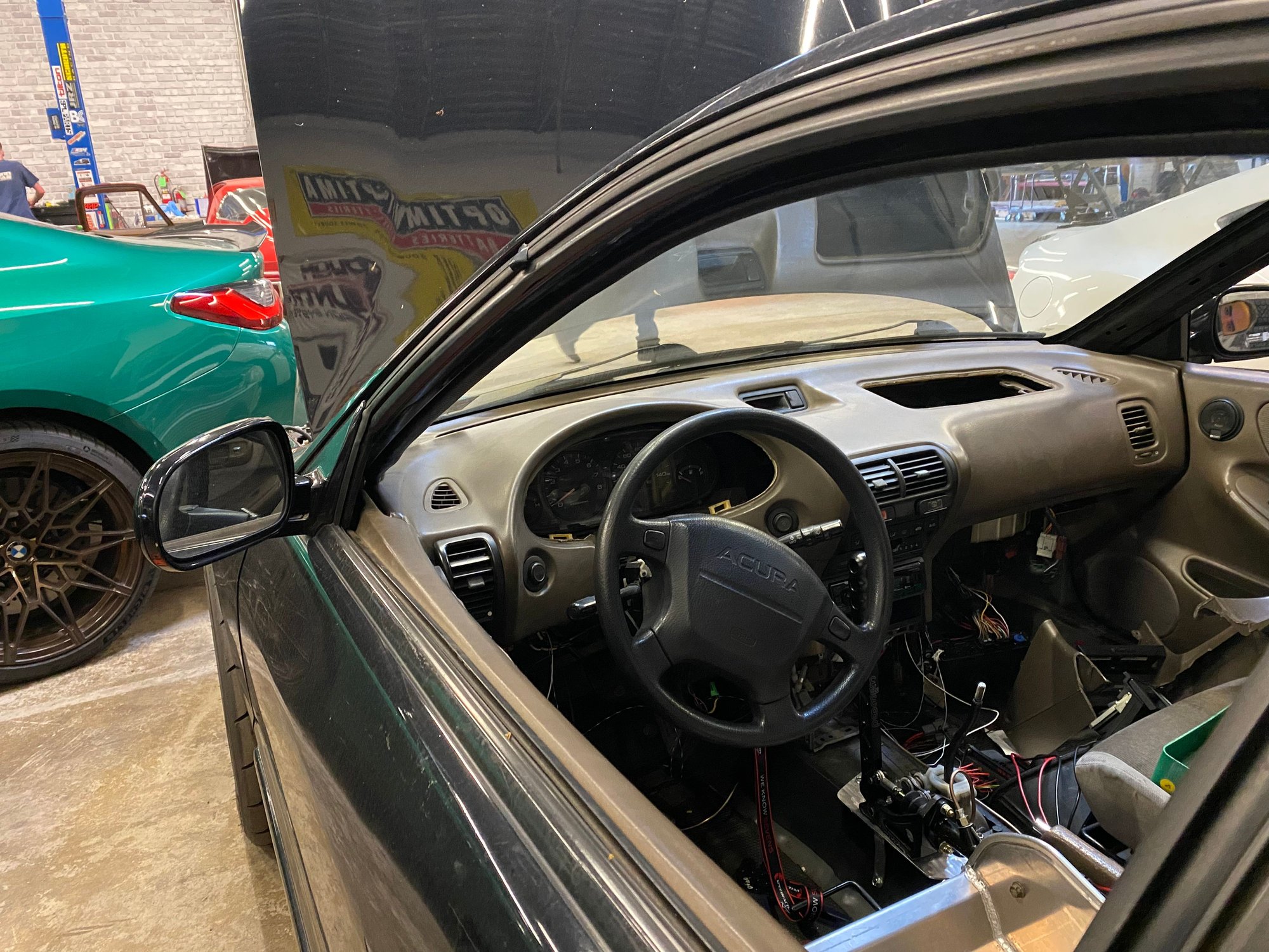

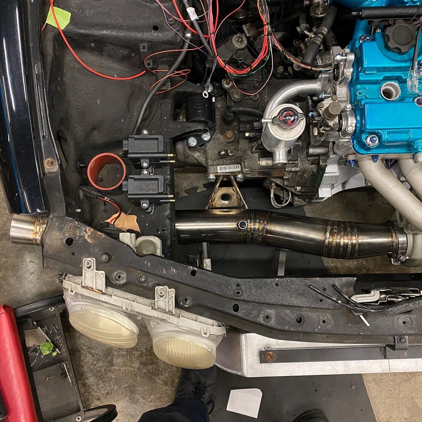

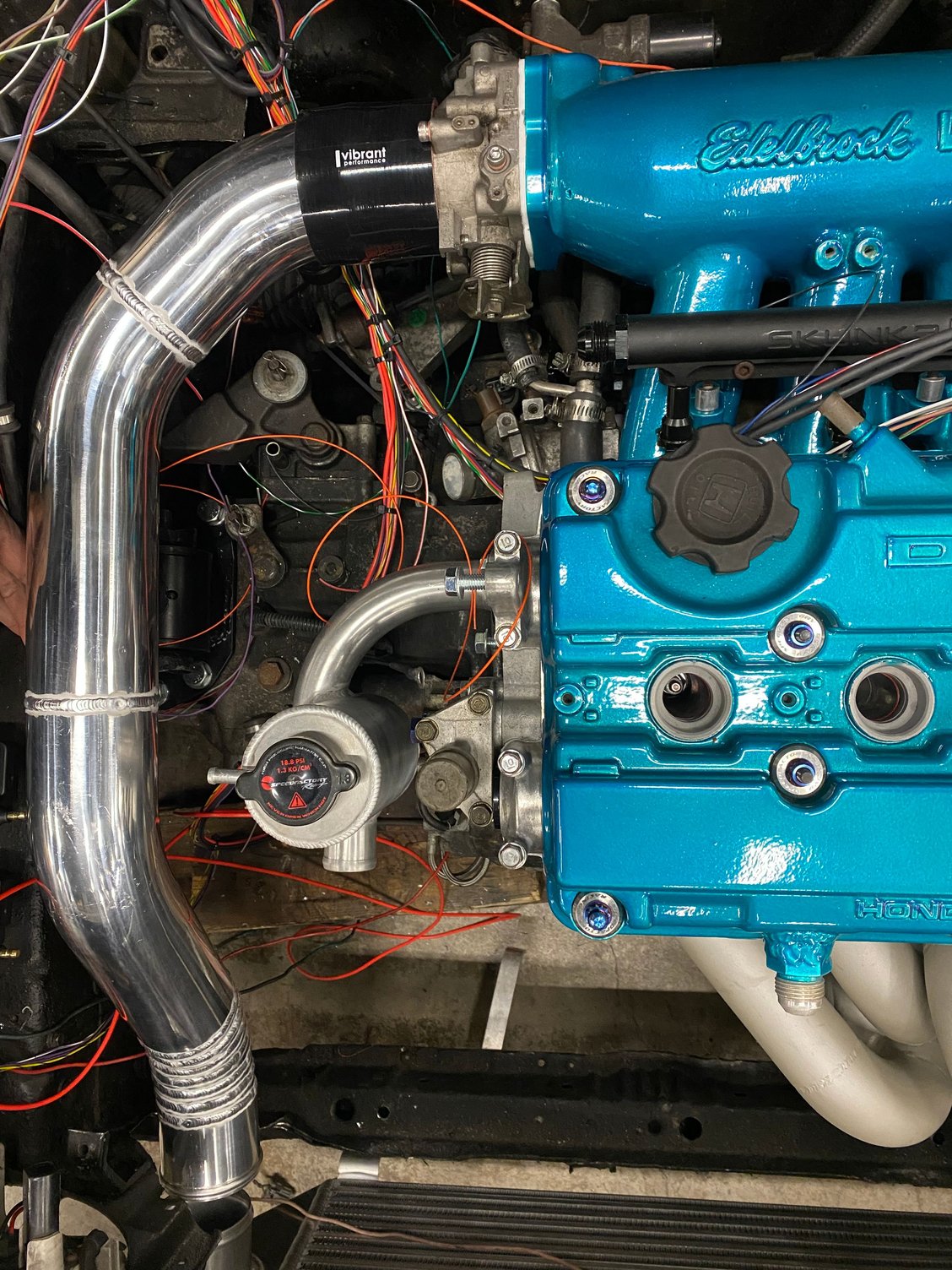

Got some wiring done, verifying sensors and testing the harness. Have to make up a surge tank for the mechanical pump and plumb the rest of the car. First time the dash has been back in the car in 2-3 years🥲
