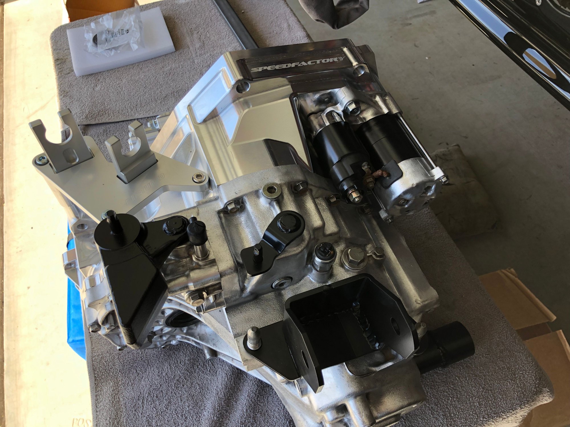

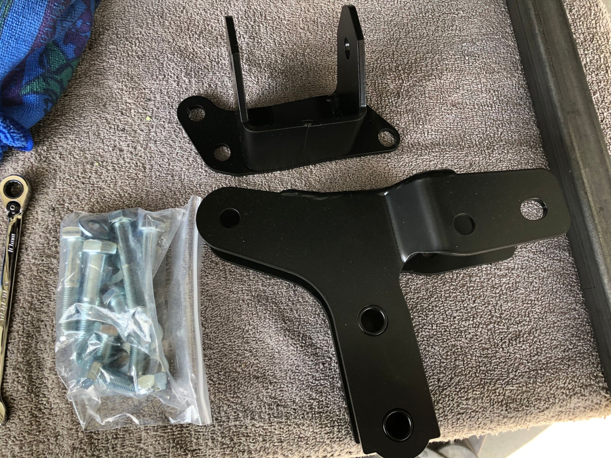

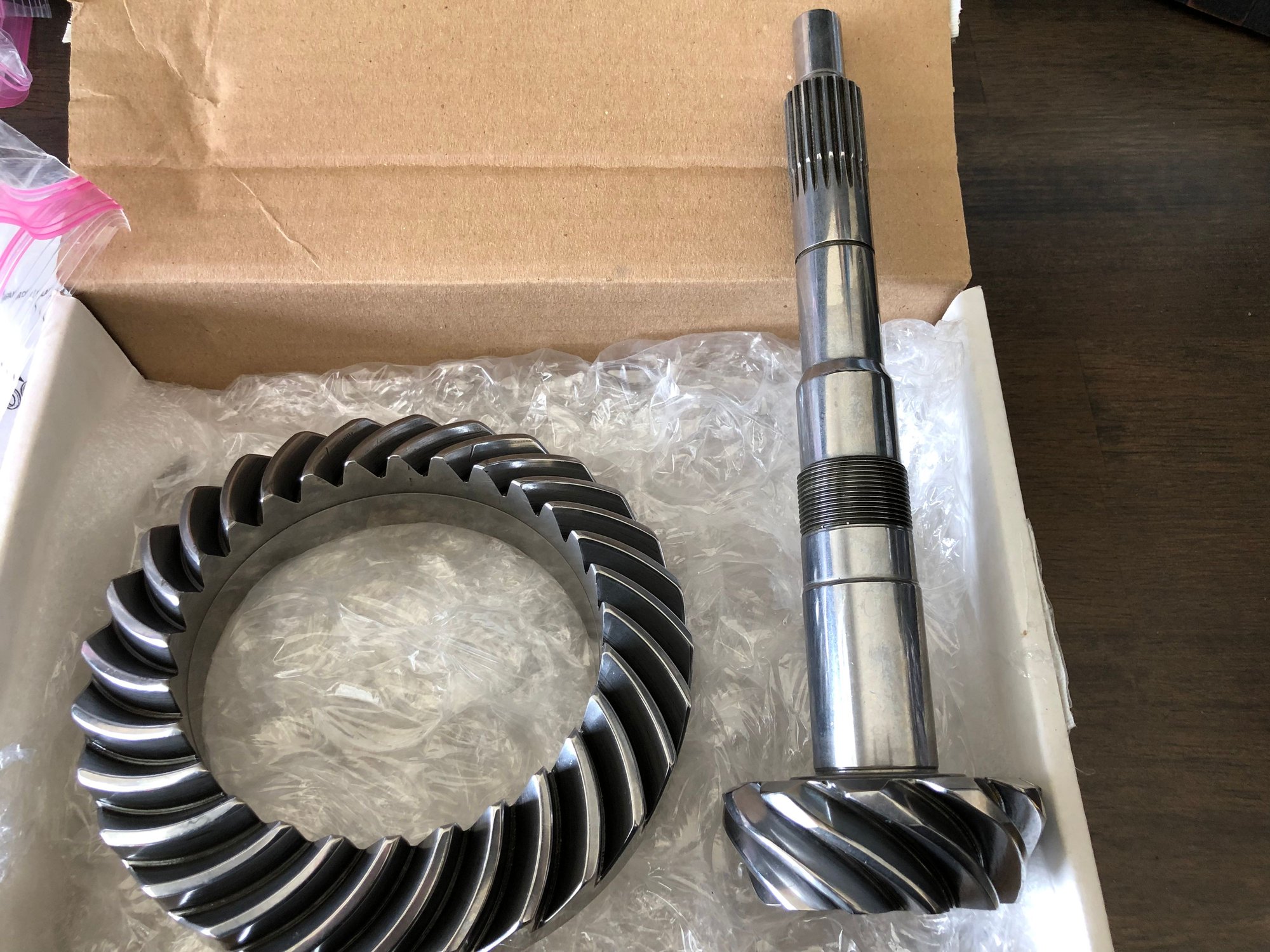

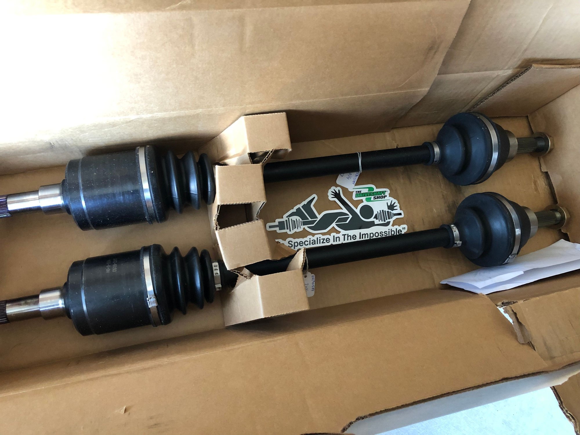

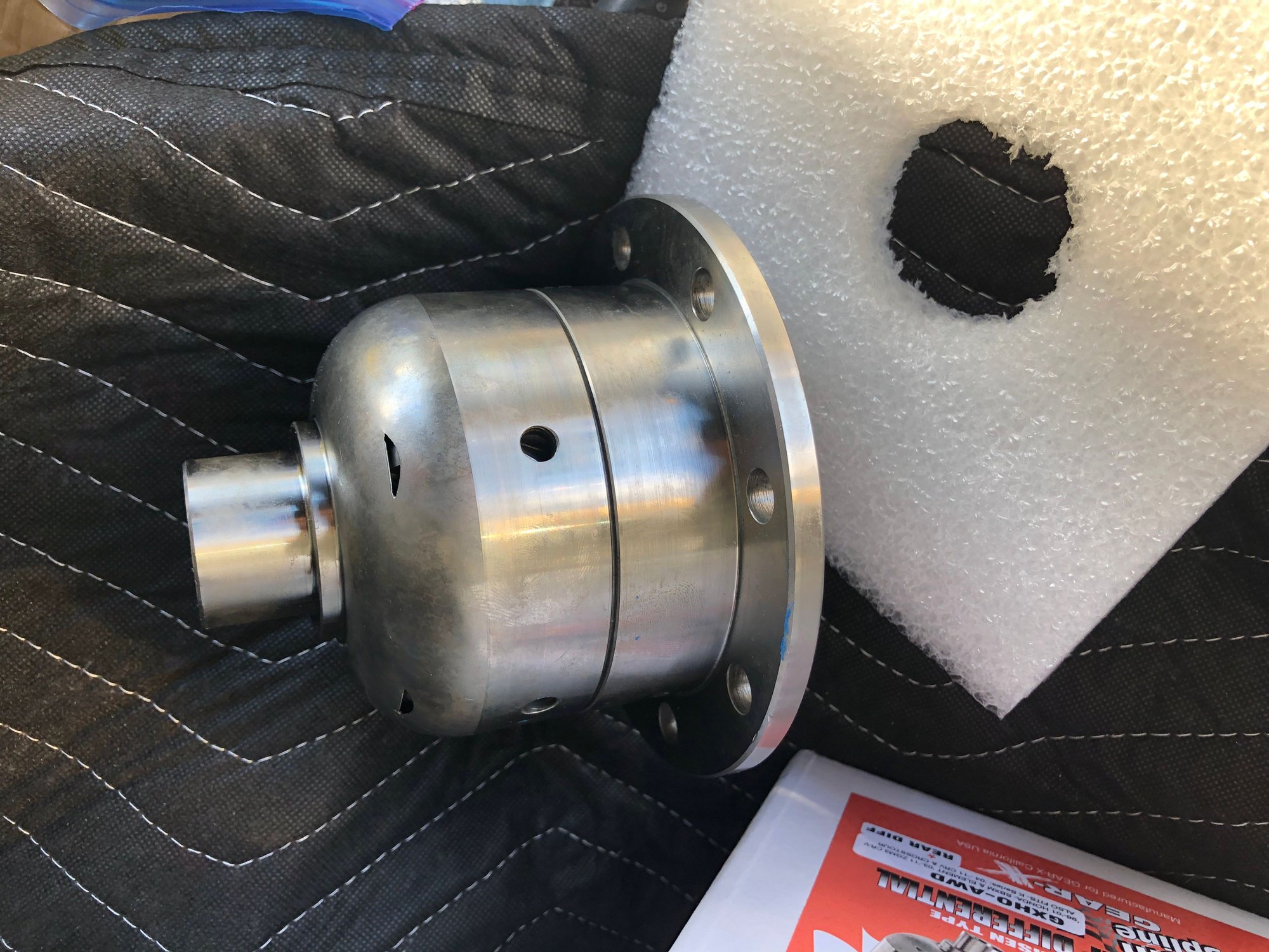

A couple more parts came in, the GearX rear 25 spline LSD came in and my new DSS level 4 rear axles came in.

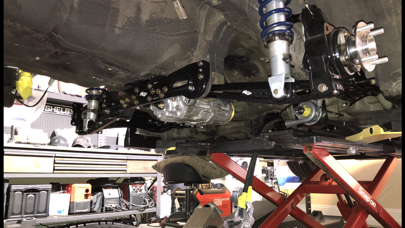

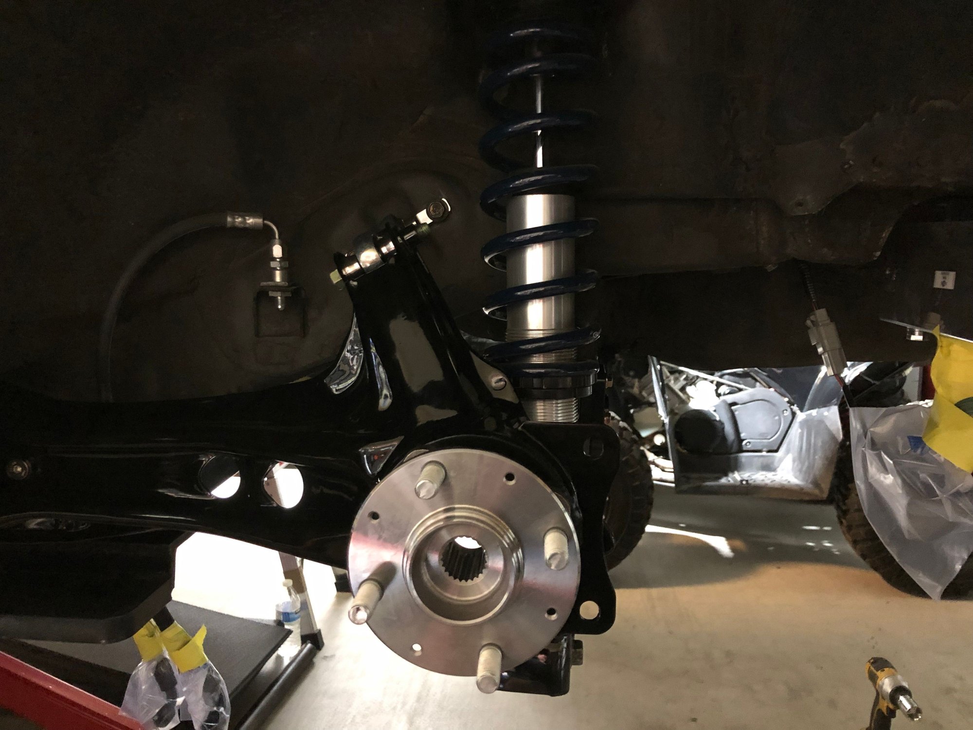

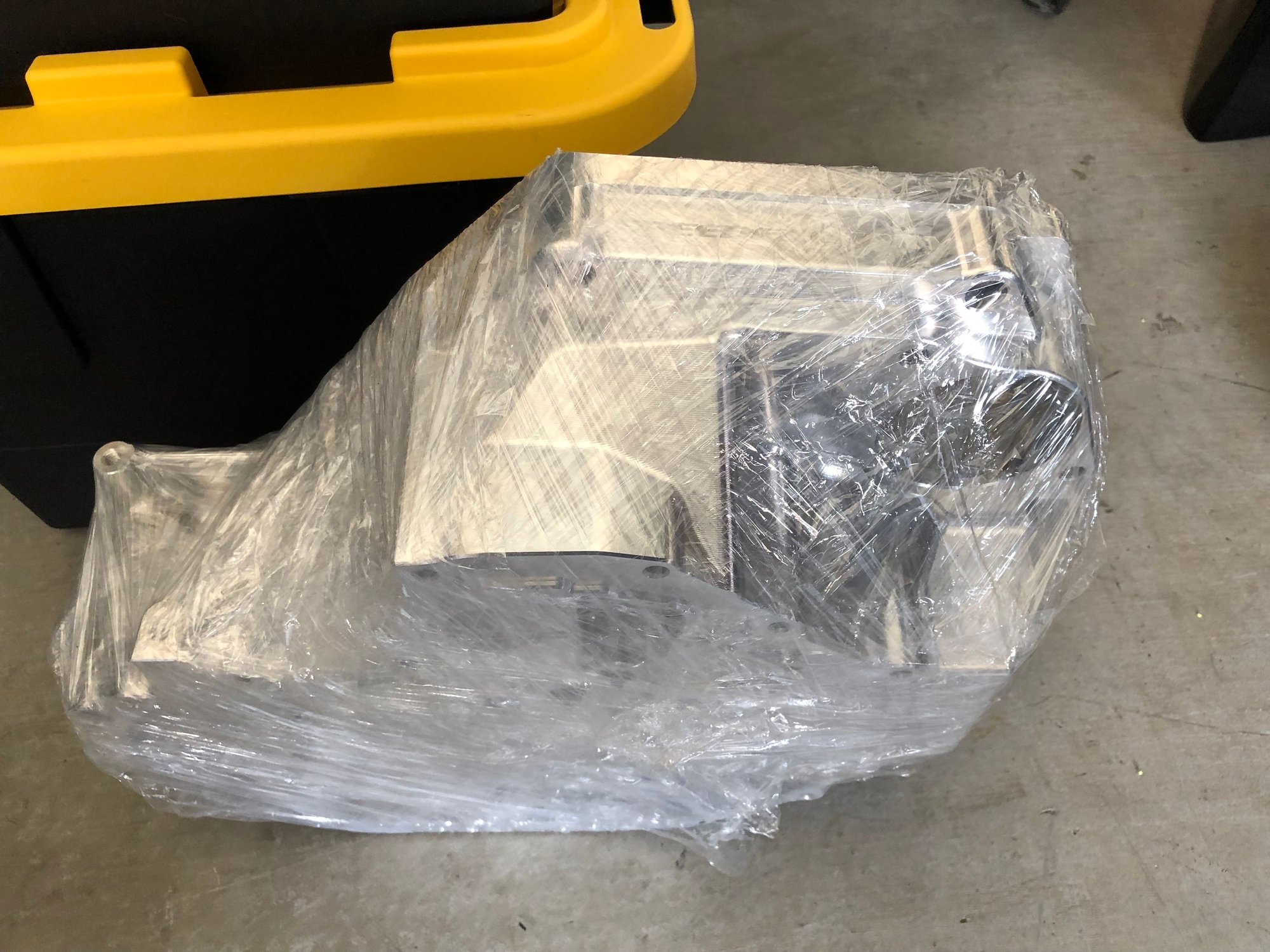

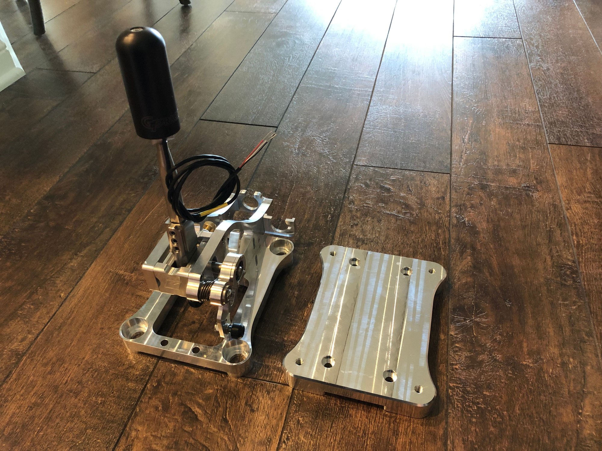

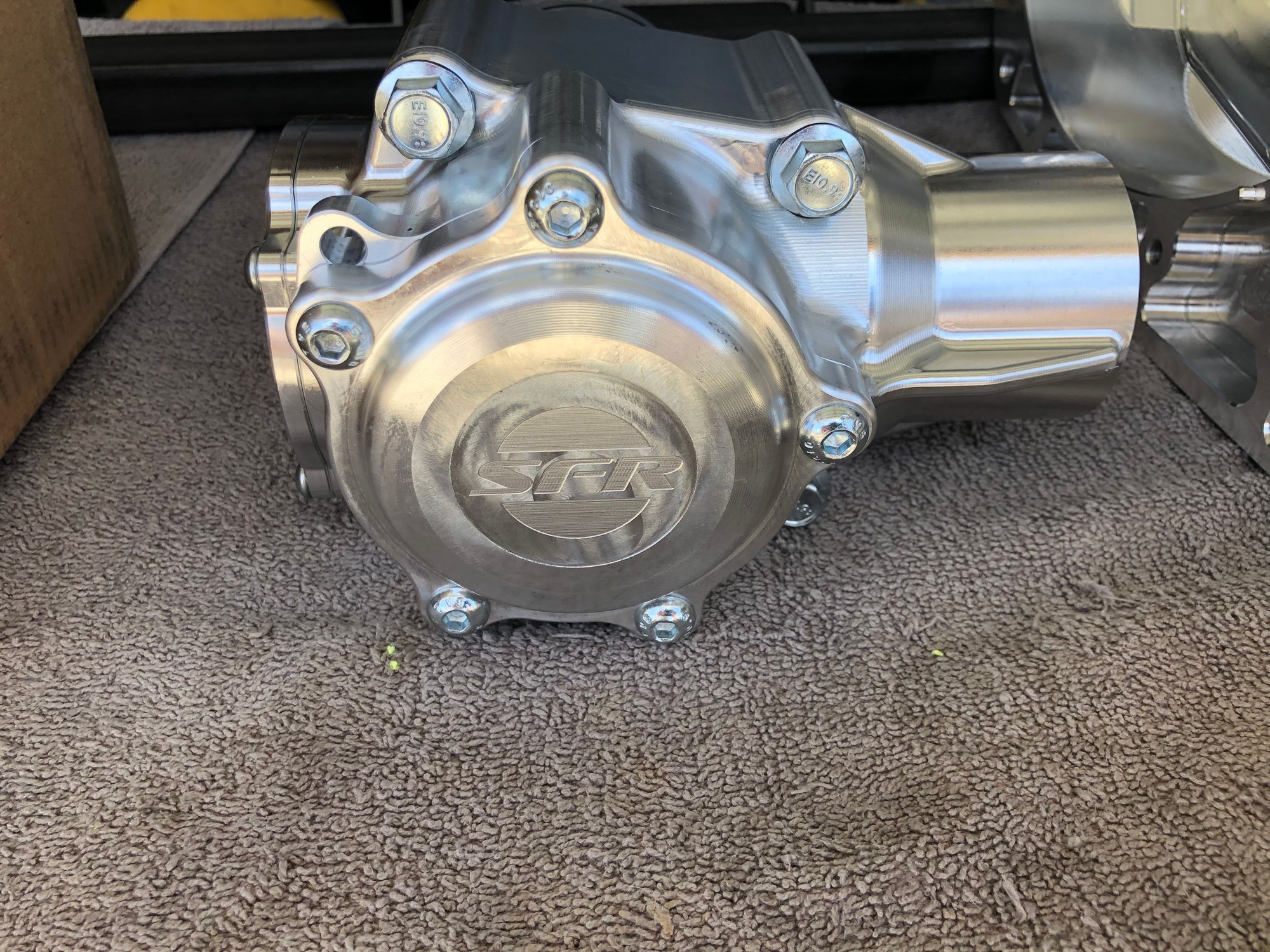

Have some updates: I’ve been working on the car here and there just waiting on parts to show up. Almost every place you order stuff from is out a month or more on parts. Hell I ordered slicks from Summit and they are two months out, my Welds are 10 weeks out, my SpeedFactory rear brakes I ordered a month and a half ago are still out and who knows when they’ll arrive LOL.

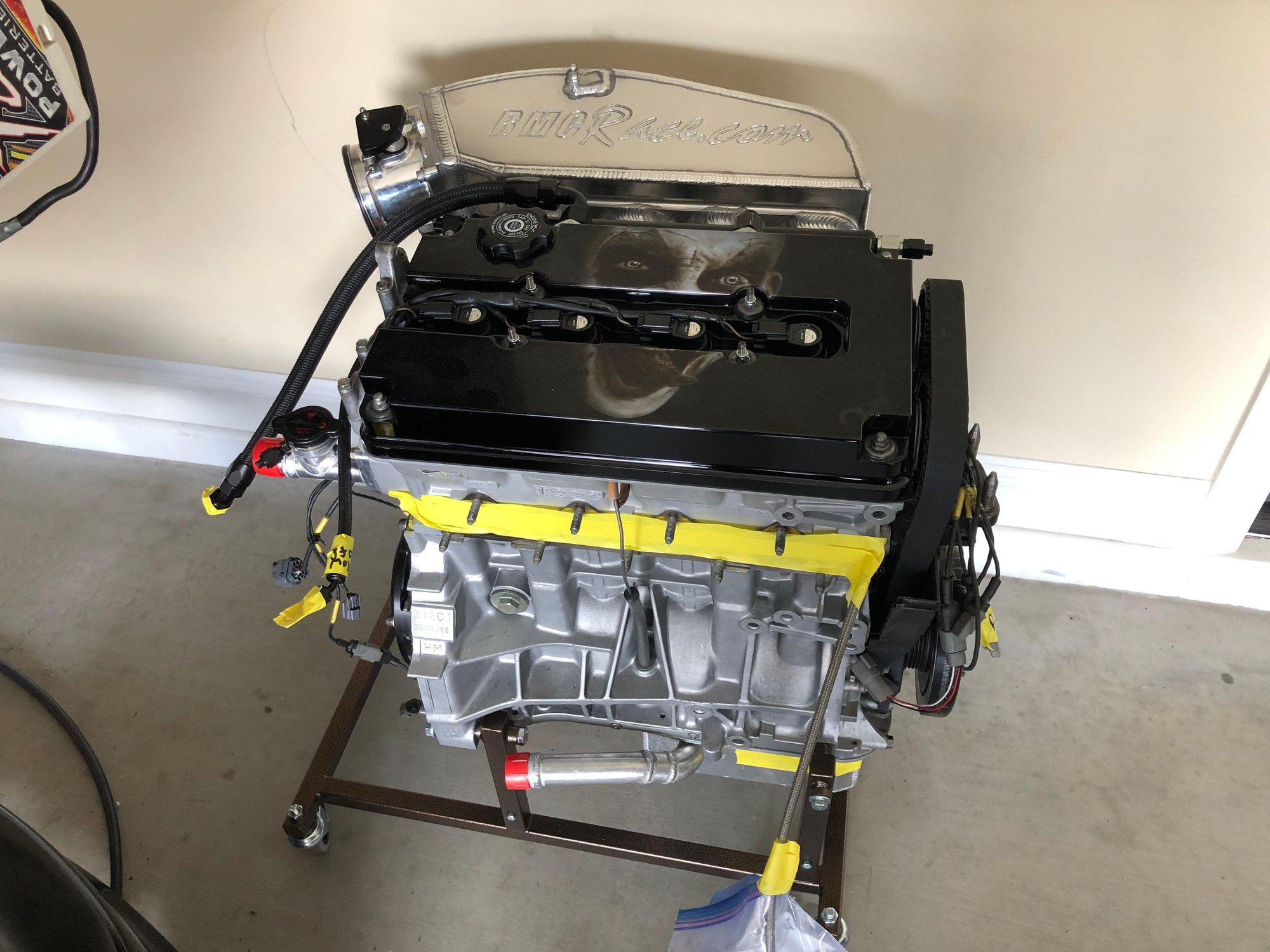

Well I pulled my motor out last week so I can get my trans up for sale. Had it sold in 12 hours LOL. Finally got the GearX ring and pinion but am also waiting on bearings. Got the Ktuned Accord shifter, base plate and GPracing strain gauge ****. Waiting on the new race spec cables. Also stopped in the o Hasport and got the two brackets I needed and got in the new Speedfactory AWD billet bellhousing.

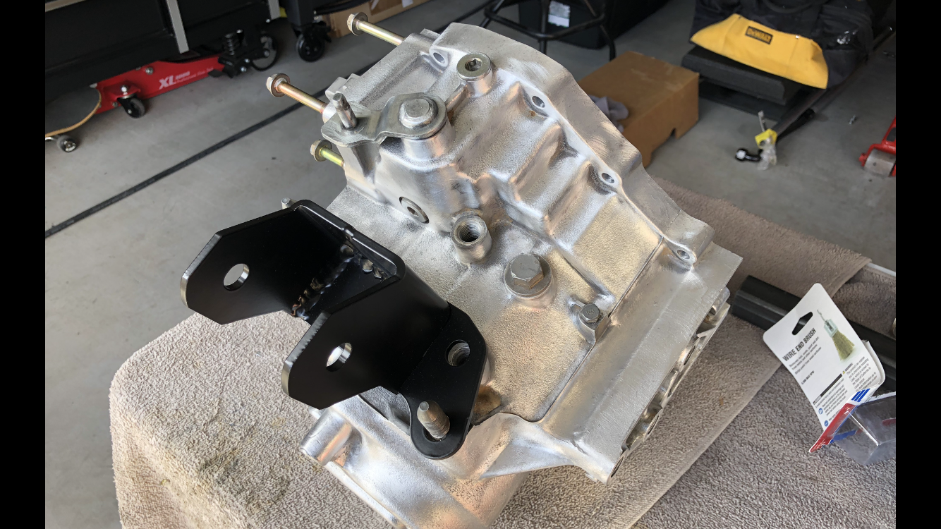

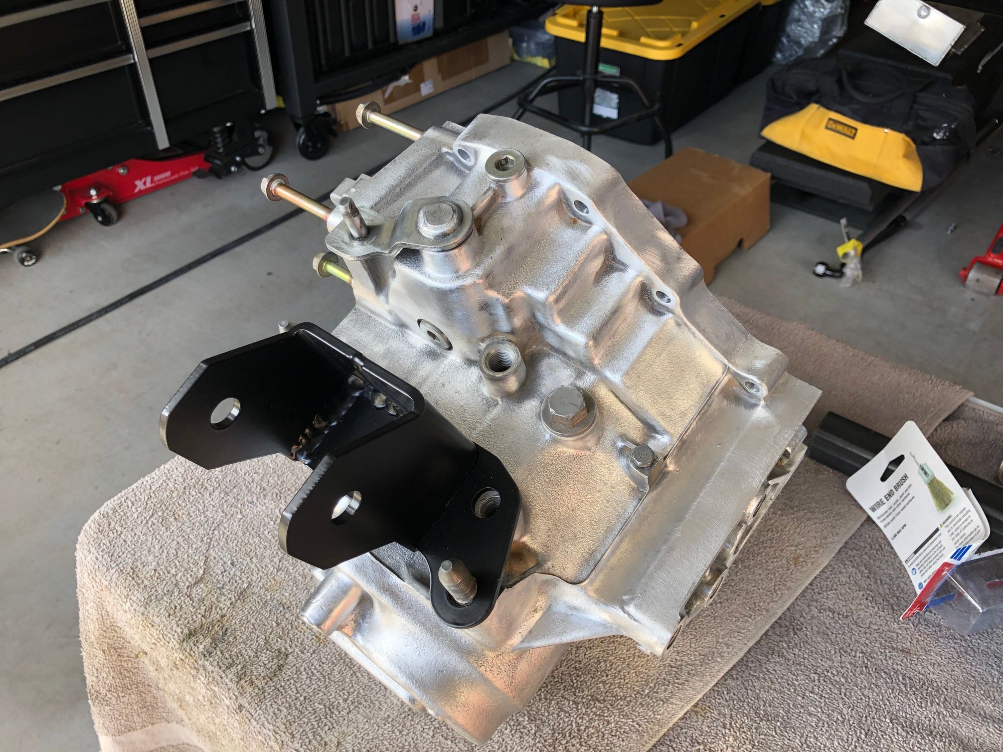

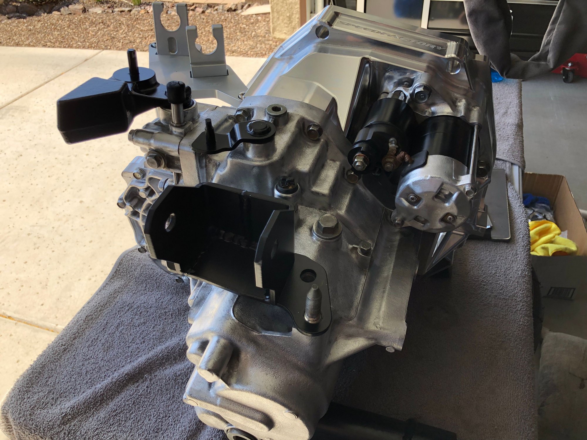

This is my second round of cleaning the trans case, it’s starting to look like brand new. Just need something small to get in the really good right spots.

Originally Posted by Caoboy
DIY baking soda blaster!
Actually the first round was purple power and a pressure washer which basically got the grease off but didn't really make a dent. So I started to use a small wire brush and it was working but broke so I ended up going to Lowes and getting a couple small drill wire brush and those really worked well and made it look like the pictures.
On another part I tried glass bead blasting with a harbor freight gun and it did okay but you run through tons of glass bead and don't get that great of a result.

Well got the trans all cleaned up, had the starter tested and it passed so I pulled it apart and cleaned it and recoated it. Also got the Speedfactory billet transfer case and am going to order all PPG components for it.
