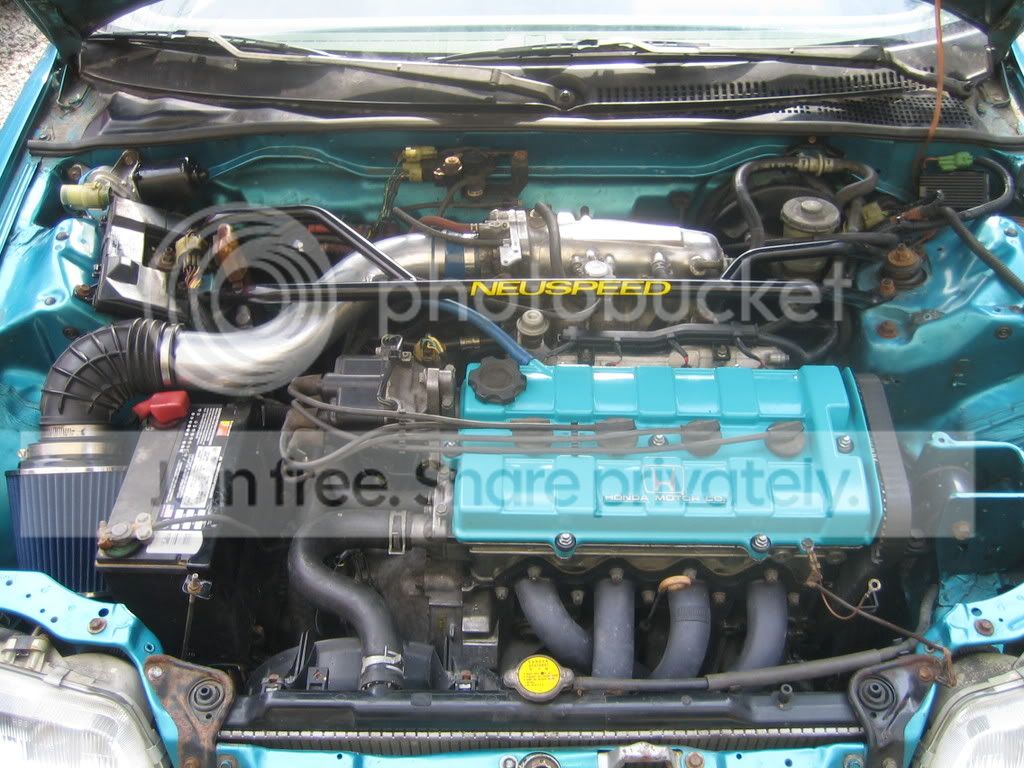

Last week I put an OBX LSD in the trans. This weekend I finally got to put the engine in the car (with the help of my dad and a friend)
It looks so sweet!
So this is where I'm at in the project. Just have to get the wiring done, the axles, and the shift linkage. The immediate plans are to get it running OBD-0, switch to OBD-1, then fabricate a turbo setup. I have pretty much everything needed for that. Any suggestions you guys have would be great. Hope you all like it so far!

Thanks, pops! I've FINALLY taken some more pictures and by now the swap is completed.

Oh! The car now has a wet N2O system running just a 50 shot right now with plans to work up to 100.
