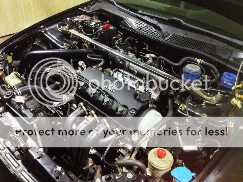

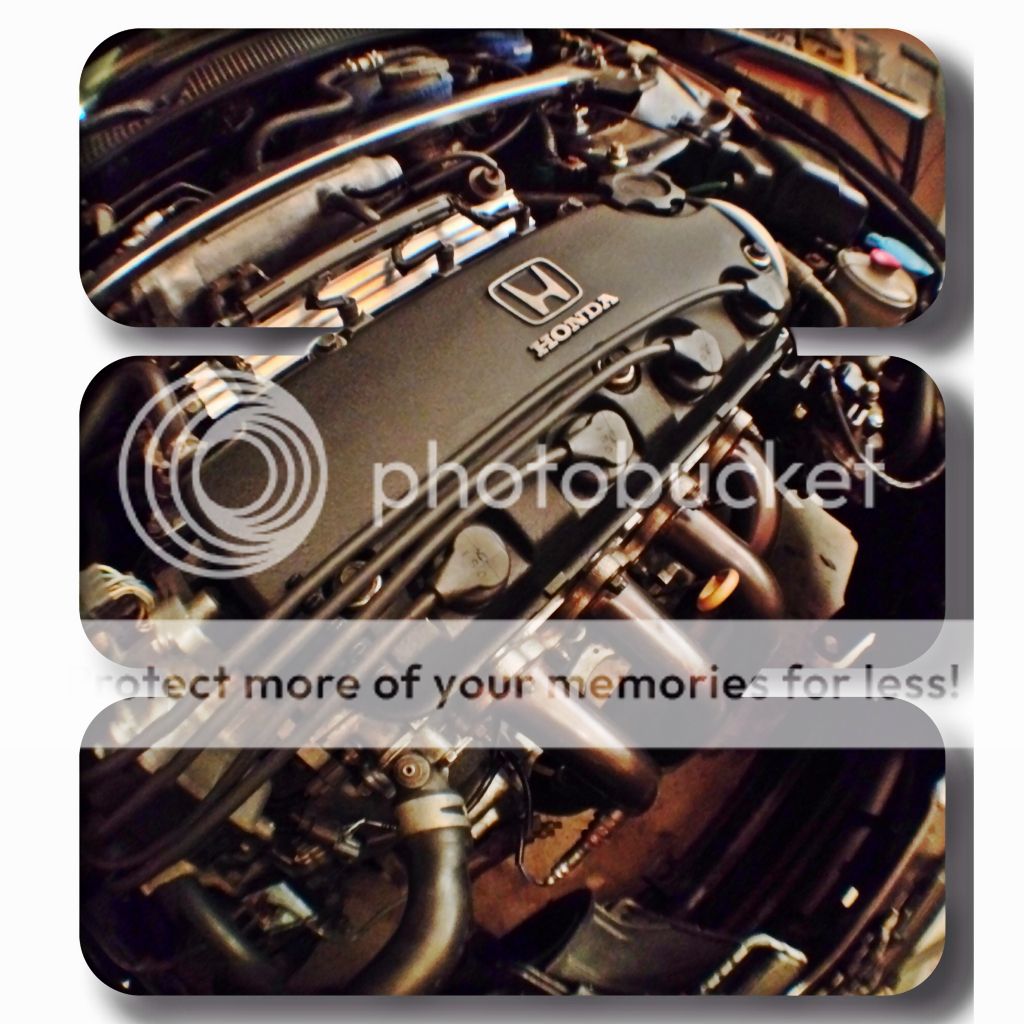

Finished putting the car back together this Wednesday and she started right up on the 4th spin. Bled the coolant system, checked for leaks and adjusted the idle.
SHG_Mike came over when the clutch arrived and we got down to work replacing the flywheel/clutch/pressure plate and getting the motor back in the bay from underneath.
The next day I spent a lot of time replacing the oil pan. Sealant was everywhere and scraping it off the engine surface was a pain as I didn't want to scratch it. I used a blade and a steal wool pad. Some holes have studs and others have bolts so I took some time to figure out which goes where and had to rearrange almost most of them in the correct spots. Then I removed my oil pan, cleaned it up of all the bearing shavings/sealant and mated it up to the motor. I made sure to apply Hondabond in the 4 edges per the helms below and above the gasket and followed the torque sequence in 2 steps. It isn't leaking so I'm relieved. Typically the old gasket will leave behind some metal rings so be sure to remove those from the studs. With all the dirt and grease I chose not to take pictures of the process as I didn't want to have the camera laying around while doing all that final work.
There are still some minor things to be done and changed like the air filter and header but the motor seems to be quite healthy. No CELs and the transmission shifts just as smooth. For now I'm just taking it easy and breaking in the clutch which works well. Winter tires will be going in pretty soon but we've been having good 50* weather so I'm taking advantage.
Mike recently got a hardtop for his S2K and so he brought my Spoon duckbill along to spray the top with some new clearcoat.
Finally I took some quick shots as the sun was coming down. Enjoy!

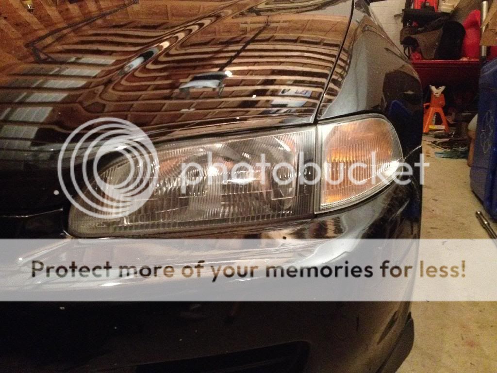

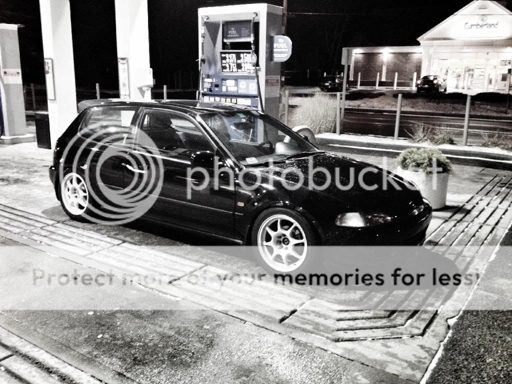

Since the last update, I just enjoyed using the summer wheel setup for about 3 weeks as we were having nicer weather than expected and once there was a light snowfall I switched over to the winter wheel setup.
I also installed the JDM OEM headlights that I picked up in the summer. They are much lighter than the OEM USDM glass ones, by a lot. Even with all the adjustments I had made on my old headlights, they still pale in comparison in terms of lighting to the JDM ones. Now I can actually see the road decently and while driving is comparable to cars along side. It's not to say JDM are better, but because my USDM ones were so hazy/faded the lighting just wasn't good. The JDM ones are made for rhd roads so hopefully I'm not blinding oncoming drivers but I don't think I am. They also have city lights which I have the sockets for but need to get the wire harness to hook it up. The fitment is also much tighter which is a big plus.
This is the current state, daily driven all year round
Driven through it all, just as it would be if it was stock or any other regular car.

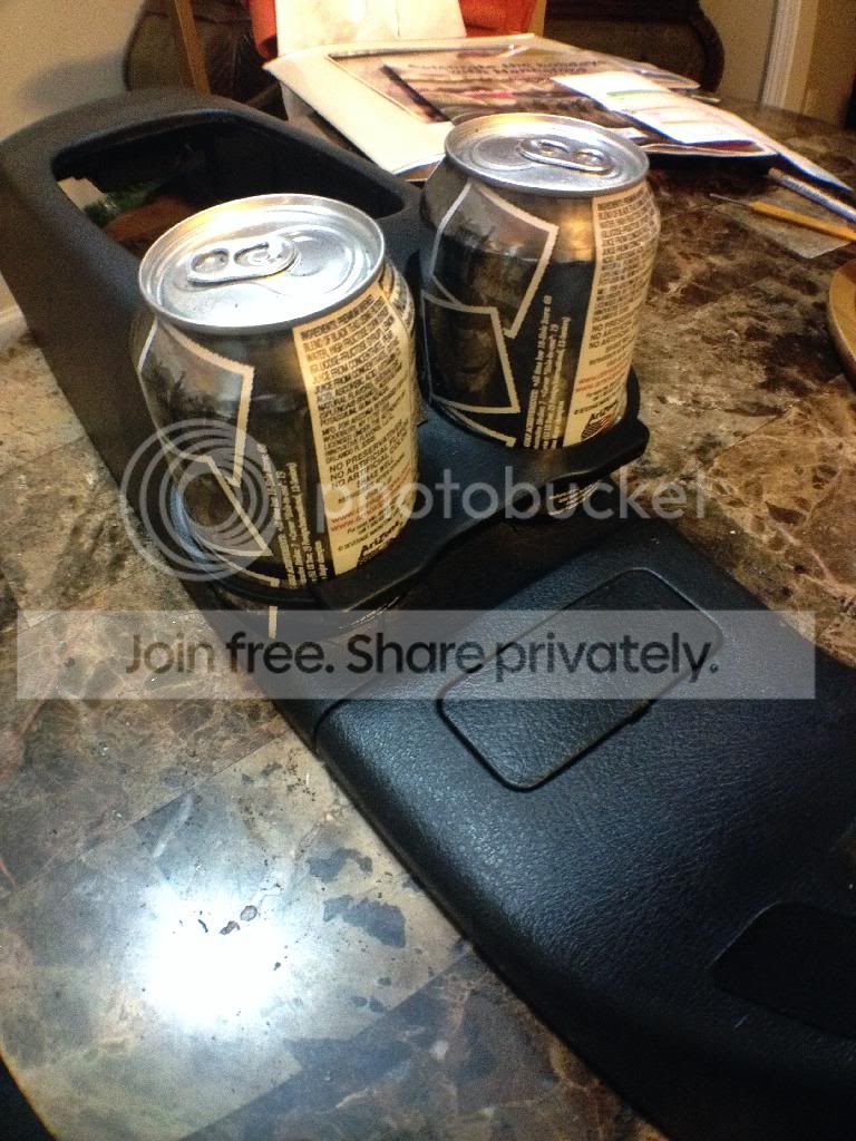

I also started working on a cupholder relocation mod on a spare console that I had. I haven't given much time to it but it will be a side thing. It needs to work like OEM so the standards are high but hopefully it comes to fruition.

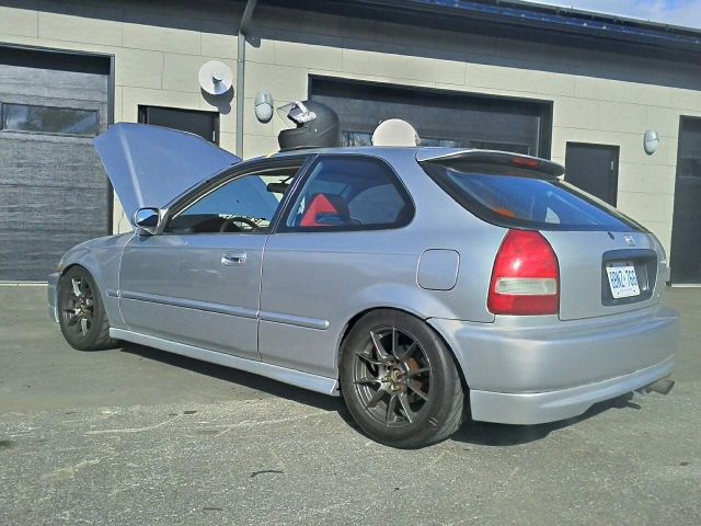

99 VSM hatch. It's mainly a track car now, rarely drive it to work.
Still powered by the single cam. its a strong, reliable lump. I'm building a B18C1 for next season tho. I'm happy with the suspension settings so a little more power wont unbalance the car. The Mfactory d-series ratios are basically perfect for my home track, thankfully they make an identical 3-4-5+FD for the GSR trans.

Originally Posted by Loganej8
Nice update, I wish honda would have made a glass option for car instead of cheap plastic. May I ask what header you are using?
The OEM headlights are glass and have nipples, the JDM are plastic and no nipples. The EDM are glass but have no nipples. I'm using an eBay header.
