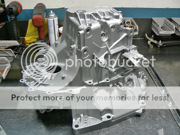

I see your Rustoleum and raise you Eastwood Alumi-Blast

Not blacked out/polished doe. I think I'm going to break down and paint my engine and trans instead of trying to make it look perfect with a wire wheel/sandpaper/elbowgrease/frustration. Alumi-Blast the stuff I need to get to make it look OEMish?

Were two peas in a pod arent we? lol
I made the same decision. Reason being longevity. When you restore an aluminum block and trans to bare surface its going to corrode at the first sign of moisture. I used Duplicolor engine enamel "cast coat aluminum" on my transmission case and I think it resembles stock a little better than the alumiblast. Its a bit darker so it doesnt have that bright silver monotone finish you know?
Old Jul 31, 2012 | 11:11 AM
  #1681
WhiteSlips's Avatar
Posts: 6,808
From: OKC,OK
Default Re: SHG_Felliphe's EG Hatch Build Thread
Thanks for the tip. I can get that cheap locally too which is always a plus. My clappers are painted with that same brand/color and it looks pretty much like bare sandblasted aluminum.

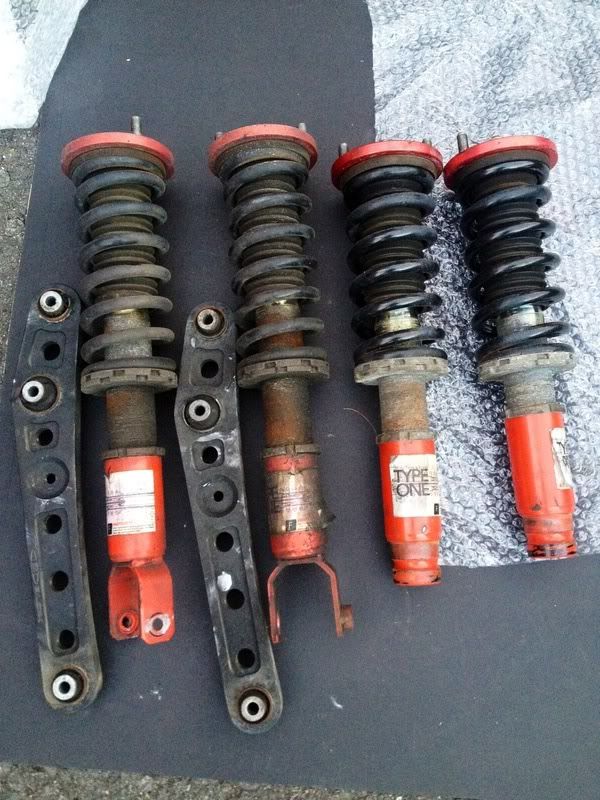

Update:
It rained last Saturday but not Sunday! A 30-40% chance of rain had me worried but I went ahead and started installing my Buddy Club N+ coilovers. I'm glad the weather held up and it was nice and cool too
Here we go! One of these caramel lattes to get me going haha.
One last shot on the Function and Form Type Is. I'm surprised how clean the car looks in this picture because it really wasn't and also how good the iPhone 4S' camera is when the lighting is good!

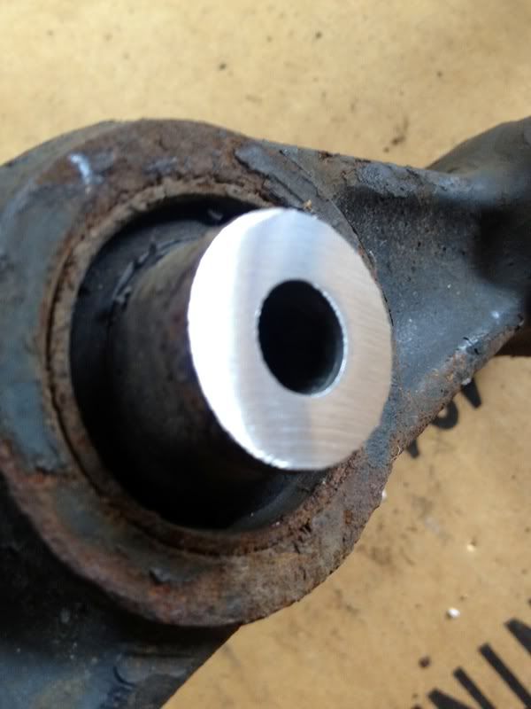

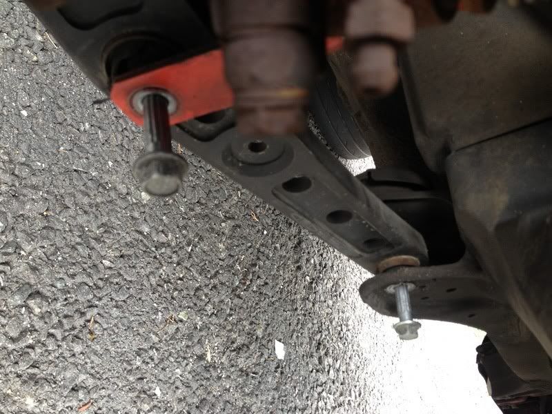

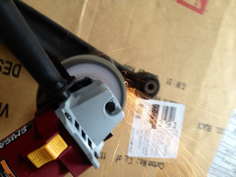

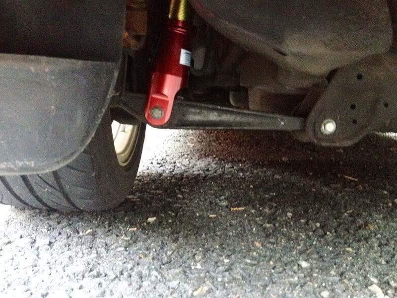

It turns out the spacers were just a tiny tiny bit too big so off I went to Harbor Freight and bought me an angle grinder with a 60 grit flapper wheel all for $26 lol. Solid grinder too, worked great and I didn't find it to be loud like some reviews said. Thanks for the suggestion E! Worked perfect!
I grinded the LCA bushing just a tiny bit and it fit.

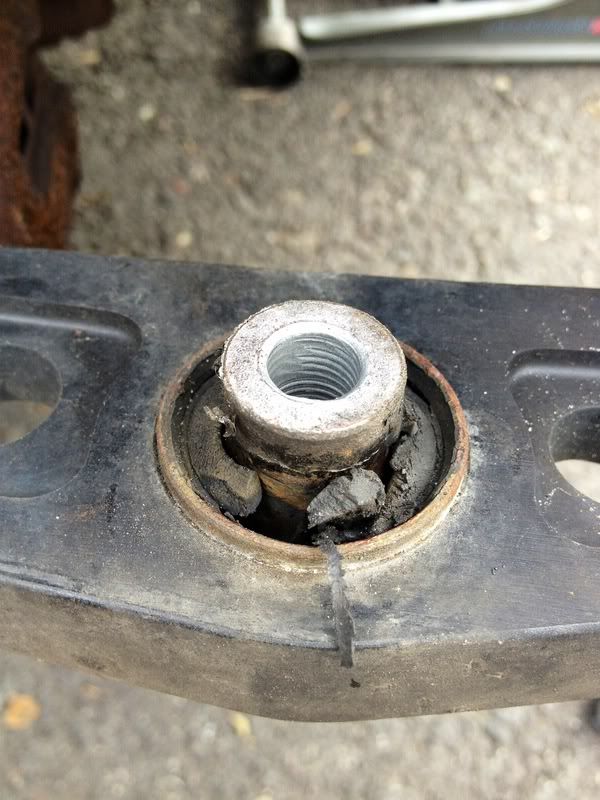

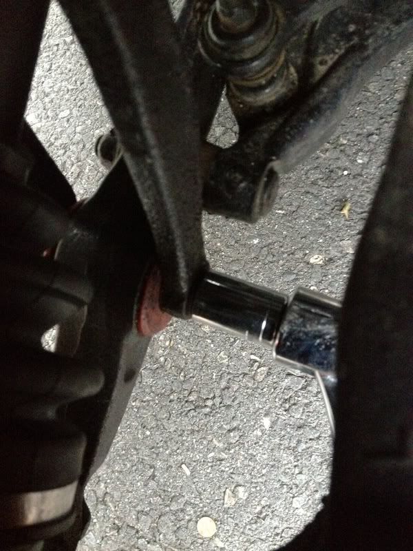

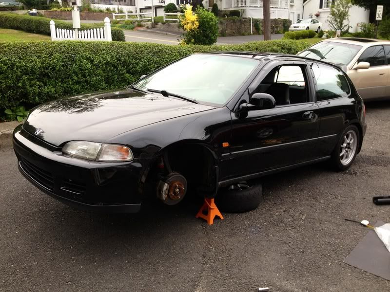

I started by jacking the rear tow hook and putting the rear on jackstands and then removing the rear LCAs. No issues there thanks to the anti-seize and new OEM bolts I got when I installed the F&F which I recommend everyone to do when installing coilovers in an older chassis like this. They are costly at about $8 each but worth it IMO.
A closer look at how trashed the blox bushings were. I could actually see through the other end too

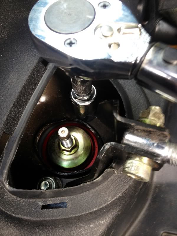

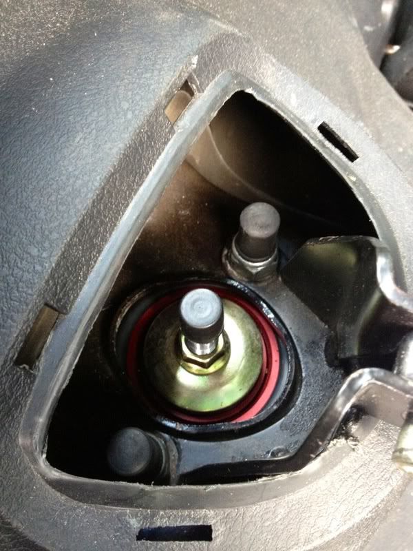

Removed the 2 shock tower nuts inside the trunk area in each side and off the Functions came.

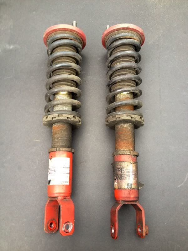

They are quite dirty but I will be refreshing them so that when winter comes I can swap them back in and keep the N+ mint. 2 years of daily driving and no leaks/noises and they ride just as good as when I got them!

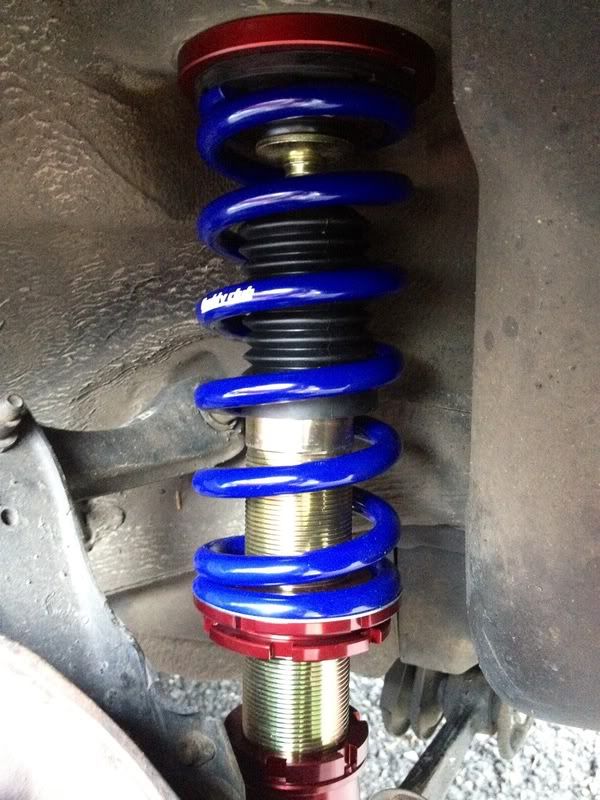

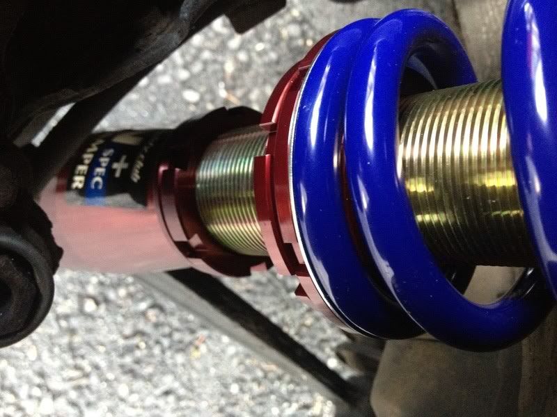

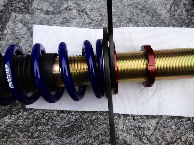

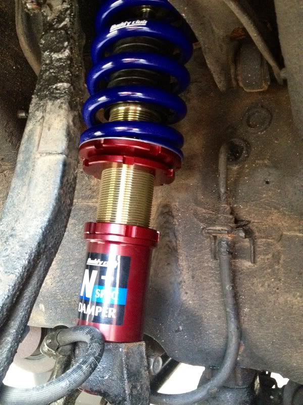

Unboxed the N+ and locked the upper perches together. Then adjusted the height by comparing it to the Functions and set them a little lower.
I also set the damping on them to the softest setting of 1 using the provided allen key. This is done by counting the clicks. They have a total of 15 settings but it is not unusual to have 16 but you can feel that setting 16 gets tight so back off and count down the numbers or just set turn it down until it doesn't click and then turn it up until it clicks once and that will be setting 1.

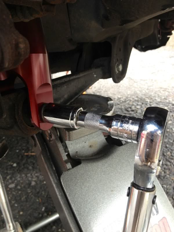

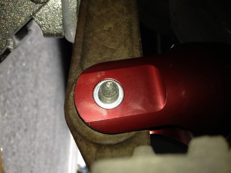

Jacked up the LCA to preload the suspension and tightened the bolts to spec. This is done so that the bushing isn't under rotational tension when its set on the ground which would cause premature bushing wear.
Here you can see that the spacer keeps the bolt centered in the middle without any play and the bolt is long enough for the nut.

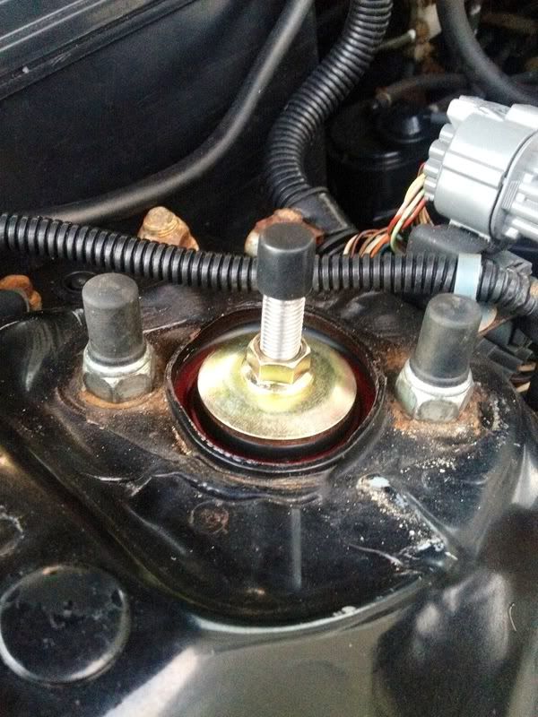

Tightened these 2 nuts up here...
And put the supplied caps on them.
Put the wheels back on and started doing the fronts which were even easier.

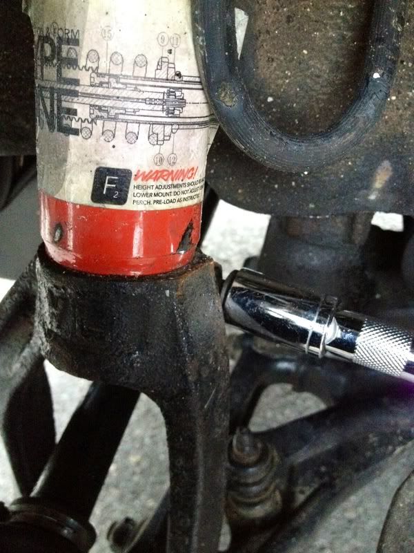

Started with the upper fork bolt.
And the lower fork bolt.
Shock tower nuts too.

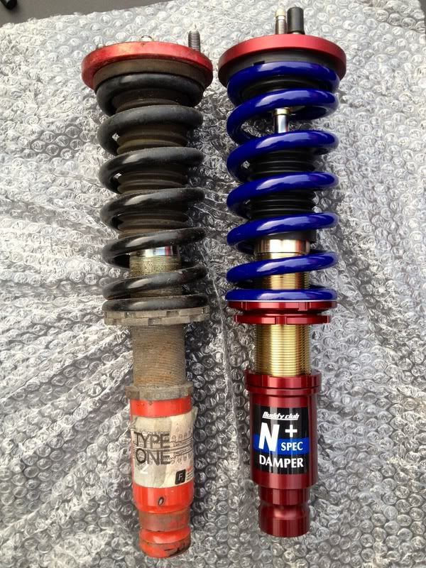

Comparison of the old and new. You can notice here that the N+ has a shorter lower mount which means that I can't go as low as the Function and Forms.
In they went tightened to spec too.

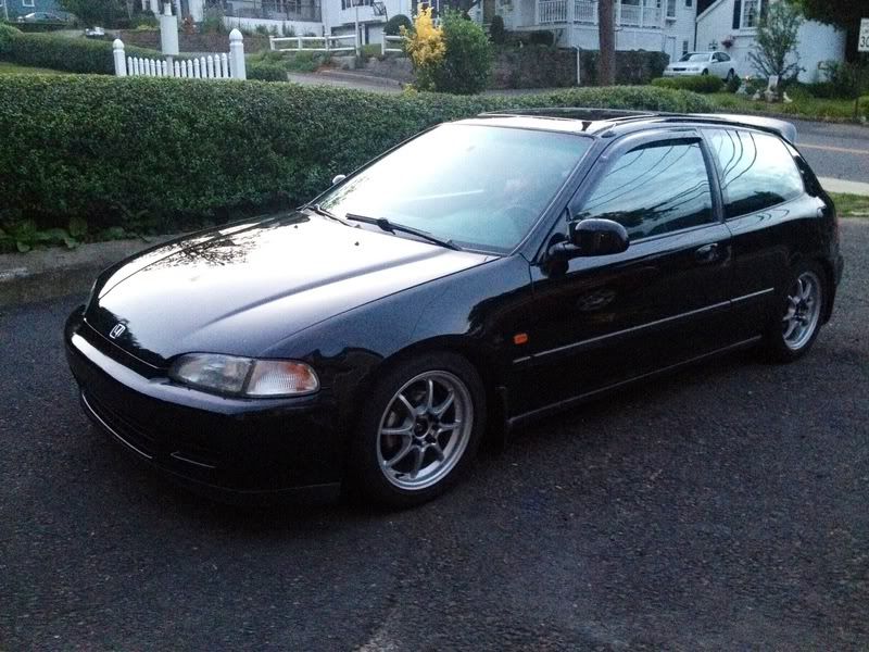

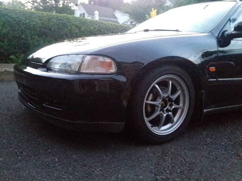

I took my front strut bar out a few weeks ago to clean it up and sell it. I want to get an OEM bar to replace it.

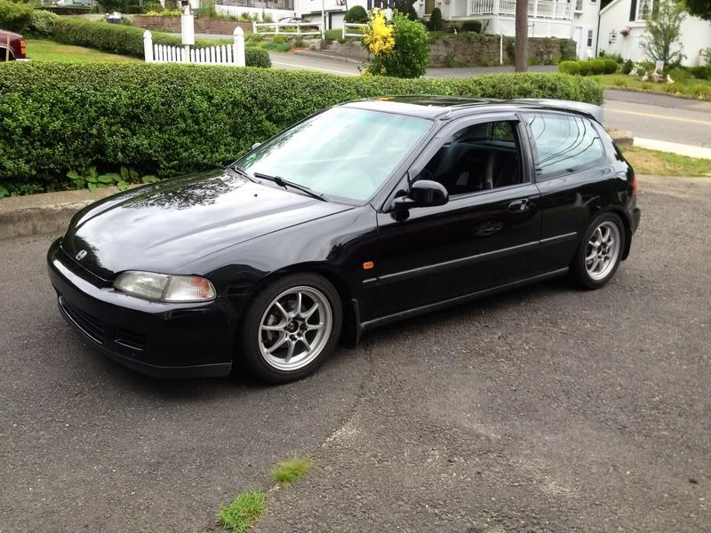

It was getting dark by the time I finished so this is all that came out decent. Some shots will be taken soon.
I have the fronts maxed out and can only maybe go 1cm or 2cm lower but I wanted to have the N+ logo facing out so it cost me about a full turn which isn't much. I am a little higher in the front now but its more even and honestly it looks just fine and it doesn't bother me much. After all its basically the same height I was at before anyways. My driveway is uneven too so its lower on flat ground than in the pictures. Anyways, hope you enjoyed it!
I will have to comment on them later but after a week of driving on them I am happy.

Yeah no doubt about it. Buddy Club has a lot of racing experience and with that knowledge they built a nice intermediate coilover for the track/street. The anodized finish on them will last a very long time and it's nice having great support stateside even though it's a Japanese company. BuddyClub USA even offers different springs and rebuild/revalving.
I like that the spanner wrenches fit the perches unlike the Function and Form where only the bigger spanner fit. The upper perch having a chamfered design goes to show the effort they put into the design. Certainly happy with what I got for my money.
Originally Posted by Kaksht
You can make logos facing outside without sacrificing hight. Just hold the upper two nuts, that go into stur tower, and turn the tightened bottom part. It requires a bit of force, but not too much. The spring will turn together with the bottom part and you will place it like you want. Would be unreasonable, from engineering point of view, to not be able to do this. Also you can do this easily if the coilover is already in place, but you just need to loosen the bottom part of it.
Yeah I know I can utilize the full drop without sacrificing the logo facing out. I don't know about your method but you don't have to do that. It's just that I installed them and haven't adjusted the height yet but when I do I'm going to simply turn the upper perch clockwise (looking from above) and that way the shock will thread in the bottom mount. This is how the height adjustment is done, you don't need to remove any bolts or anything. Just have to loosen the bottom mount perch and spin the upper perch clockwise or counterclockwise to get the desired height. This doesn't affect preload because the 2 upper perches are locked together so the only thing that spins is the shock itself. Thanks for the heads up anyways, I should of made myself more clear lol. I was just trying to say that I wasn't at the lowest setting because of that. It didn't matter then because it could be too low so I left it as is.
