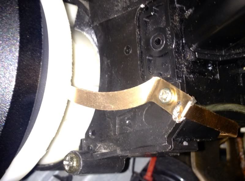

Threw in the horn tab. I'm going to get a proper connector and wire to bolt up to it since it has a bend at the end for it but for now this will work without issues. Just wanted to get my horn working again asap.

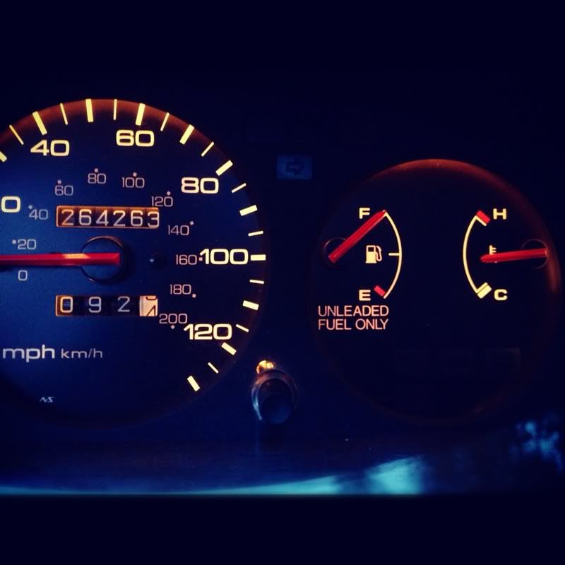

Been getting some sweet MPGs.. More on that later.

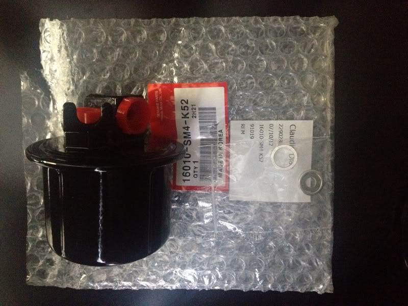

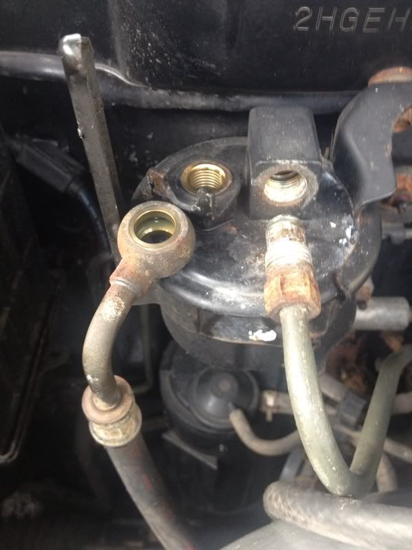

Picked up my OEM fuel filter at Majestic and changed it out. Super easy to do, heres a DIY for all the maintenance. Its for a 6th gen but its basically the same. https://honda-tech.com/forums/honda-civic-del-sol-1992-2000-1/diy-96-00-honda-civic-tune-up-fuel-filter-2872418/

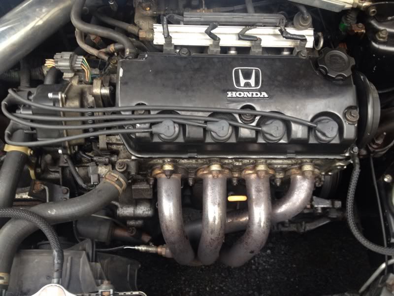

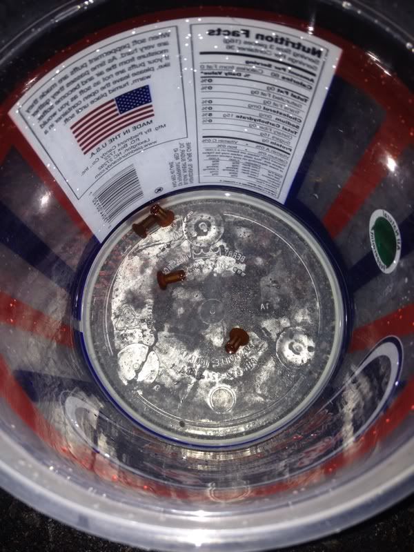

I was hanging with Mike the day after I did my wires and plugs and he aligned them properly. I did what I could when I threw them in but knew something was off. Looks much better now! Just need to get some OEM clips that keeps them spaced so for now I'm using just 1 that was on my old wire set.

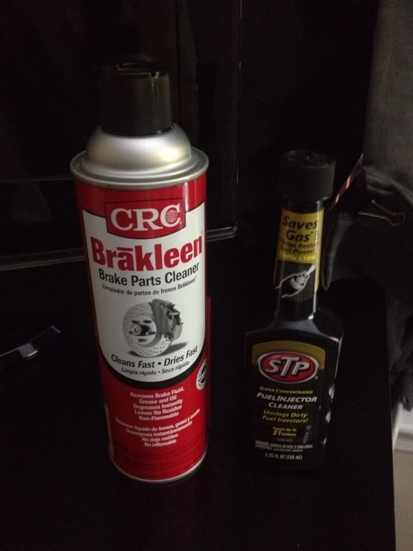

Got a can of Brakleen and STP Fuel Injector Cleaner.
I could now do the trick that Gourley had told me about a year ago.

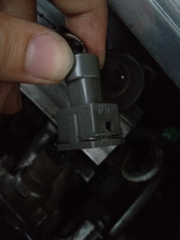

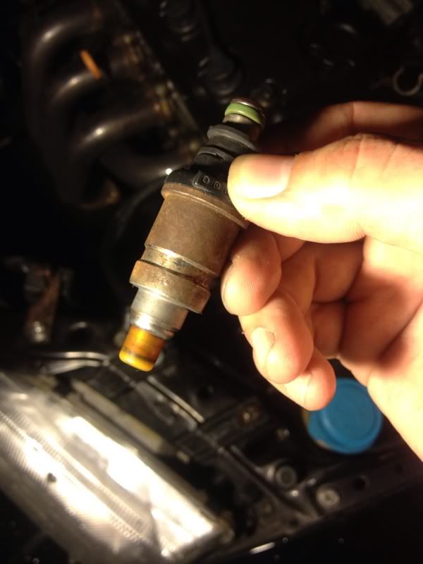

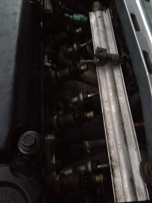

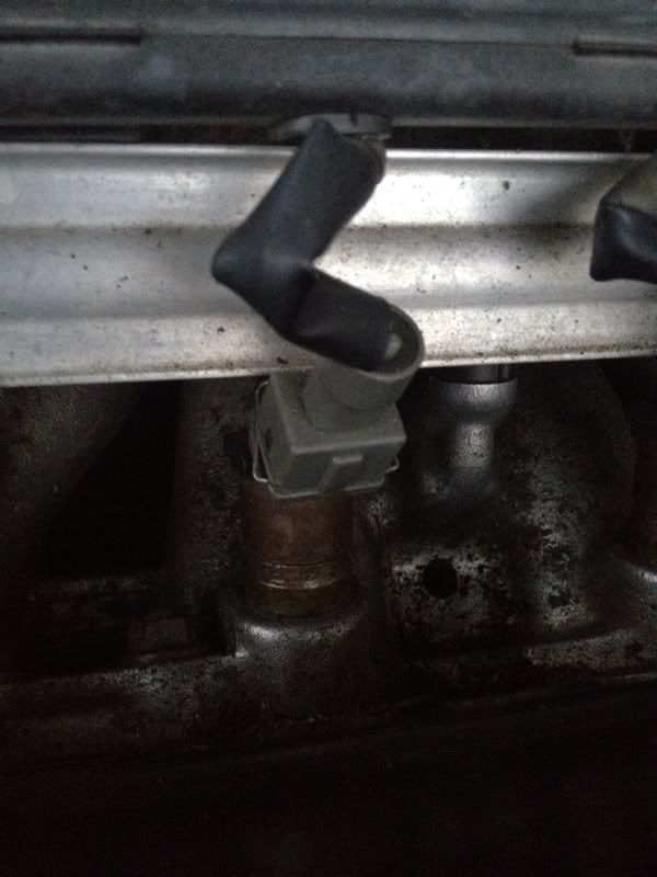

Another DIY tuneup you should consider next is fuel filter and cleaning the injectors. What I usally do is replace fuel filter (if you already havent) then remove the injectors from the fuel rail. Take a small bucket and fill the bottom 3/4 an inch with fuel injector cleaner and brake parts cleaner. Remove the injector top screen and dump them into the cleaner, then take the injectors and place them nozzle side down into the cleaner and let sit for 15 minutes. Take out and pour some brake parts cleaner inside the injector then replace the filter screen on top and reinstall injectors. I've noticed 5mpg difference after cleaning them DIY also smoother idle.
It will look like this.

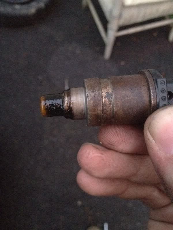

Then just remove the 3 nuts that hold down the fuel rail and the rail comes out and you can pull the injectors out.

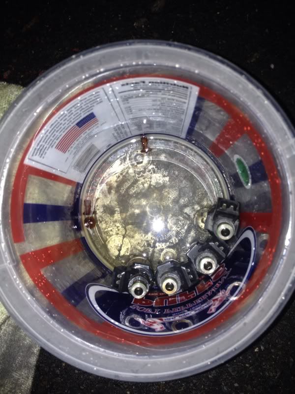

This is what they all looked like.
Pulled the top hats/top screens out and threw them in the 50/50 mix of Brakleen and STP. I let them sit for 20min and blasted each with Brakleen when I took them out.
Injectors too.
Sprayed the top with Brakleen and put the screens back in and wiped the bottoms.
After going for a drive the car feels a bit nicer, felt like the throttle response was crispier and a little more torque. I have to say, it feels really good to get all this maintenance done. VTEC sounds so healthy and I'm finding myself not stepping on the gas as much like before. MPG has gone up a lot so tune in tomorrow for part 2

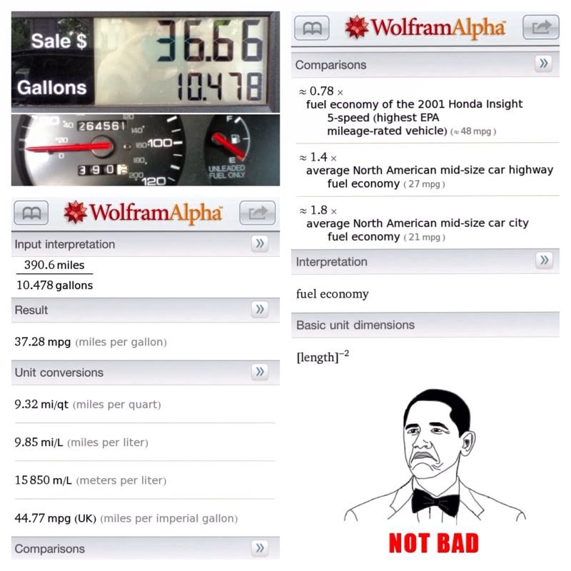

To follow up on that picture of my cluster...
Haha I love it. 37mpg and theres a lot of room for improvement. 42 mixed should be very doable without much effort but I'd like to be at 45mpg mixed with a little work.

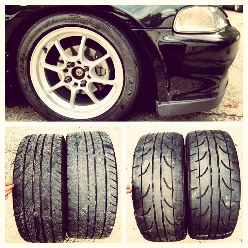

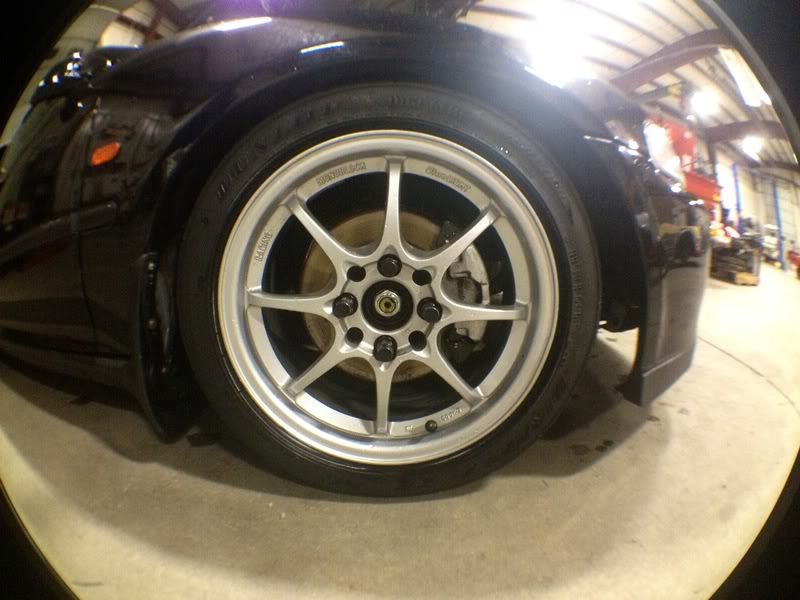

This past Friday me and EasyE were hanging again and he came through once again and mounted my pair of 195/50/15 Star Spec Z1s that I had picked up a few months ago for $20 lol. They are worn but have 1 track day left in them or about 3-4k street miles. My S. Drives lasted about 2 years and I liked them overall, should of lasted twice that if I hadn't driven on them all year round including winter lol and if I had kept the alignment in check so I'm happy with it. Front passenger side was getting pretty bald there...
The rears are still S. Drives but they have more life left. It will hold me over till winter.
I love how the Star Specs look, its amazing how much just the tires can improve the appearance so much. Just beefy, love it.

Initial impressions:
Even being this worn they are ways grippier than my S. Drives if they were new. Ride comfort is about the same and they're even quieter but thats probably because the S.Drives were out of thread.
Turn in response is very sharp and overall they feel solid. Very predictable as to where the grip is even in wet and are very well in braking too. I can brake just right before the turn which is scary for the regular person thats used to all seasons haha but you guys are all familiar with it so you must be thinking its nothing special but for a street car its plenty fun. I don't have enough brakes to be able to lock them up from 50mph or above but the couple of times I did it was very easy to gauge it and recover.
I have driven on Z1s before and its a blast being able to go where you want and make late minute corrections if needed. The only spirited driving I do is on exit ramps so I'm still learning them and I'm just surprised that they are this good even being near the wear bars.
Can't wait to get some tires of this category onto my Weds
However that won't be for a while since I had this guy take a look at my passenger side and gave me a quote to repair the dent which I think makes more sense to fix before. I'd rather have a clean body than dope wheels but it won't happen before the SHG meet and I need to buy myself a laptop for school and I just dropped guap to renew my green card so I'm not going to do either tires nor bodywork from the looks of it. Priorities
I'm cool with that though, the original plan was to get tires next year anyways and Dunlop Star Spec ZIIs are coming then so it makes more sense to wait and get them in time for track days. We'll see how that develops but I'm doing track days next year 100%.

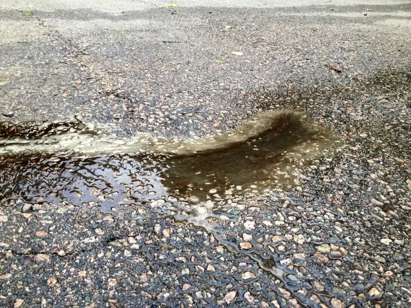

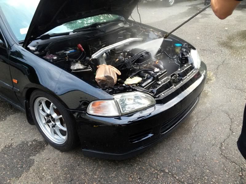

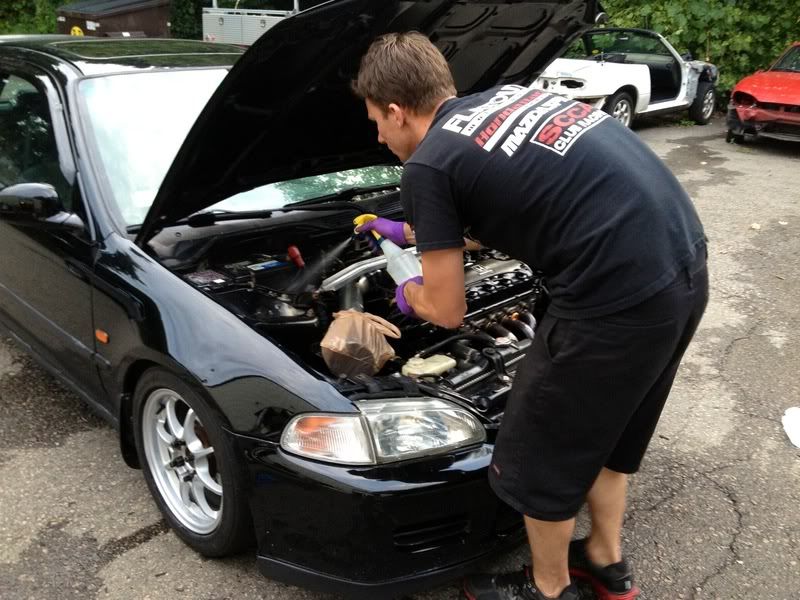

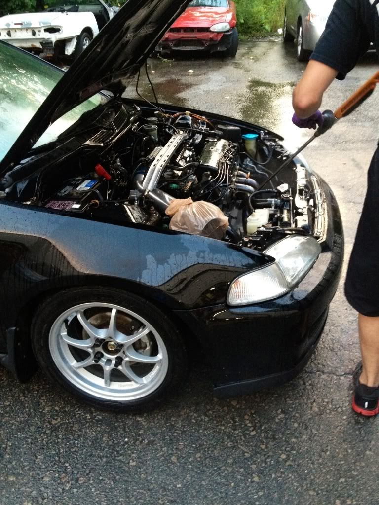

EasyE asked if I wanted to powerwash my engine bay and I said hell yeah! Here he is spraying the bay with some sort of degreaser, not sure what it is exactly.
Let it soak for 10 minutes and washed err down.
Repeated the process another 2 times and then I jacked up the front and sprayed everything underneath, let it soak and washed it all down. Everything is so much cleaner now and my block is actually silver ha. The only downside is that all the rusty hardware really pops now lol. Something to start working on soon I suppose.

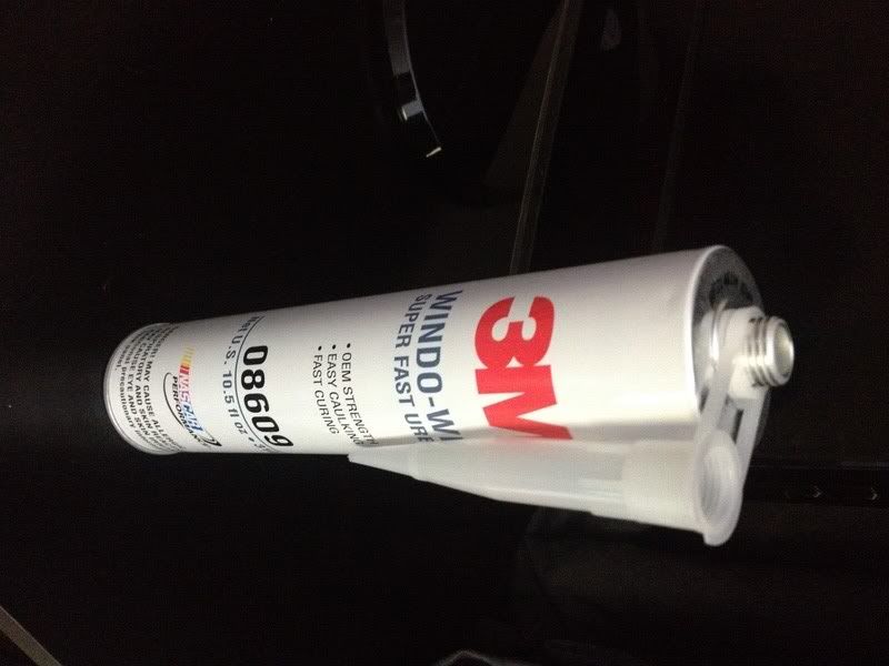

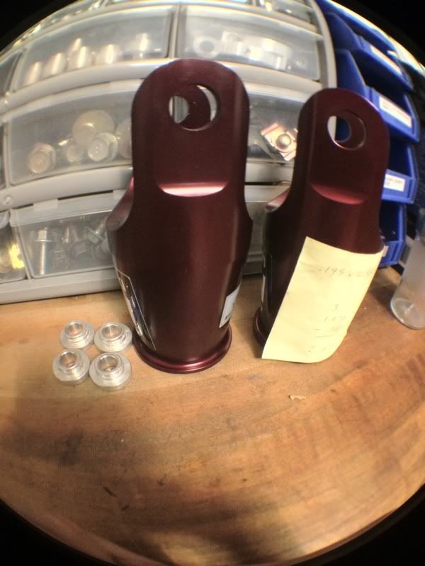

Placed an order at Amazon for 3M Windo-Weld urethane so that I can fill my engine mounts because they buck like a damn horse! Between that and the soft OEM worn clutch stop and go traffic is annoying.
Just need to get a caulking gun and find the right day to do it since it needs about 24hrs to cure.

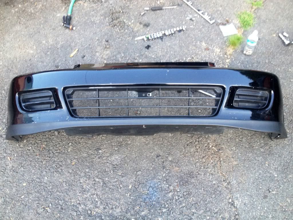

I wasn't happy with the hardware I got for my lip recently since the bolt heads were too fat so I ended up not throwing them on and got these instead but the design of them doesn't allow it to sit flush all the way down so there was a gap so they didn't work either. The part where a wrench could fit is the issue, it would work if that wasn't there.
The OEM lip doesn't sit nice even with OEM Honda hardware (which is not listed for sale but if you have the part numbers and its still available it would run you $70
so that's not an option)
I was sick of really crappy fitment so I did something about it. I drilled tiny holes and pushed down on the lip for a good fitment and tightened screws down where I felt it was needed on the tabs.
Came out epic and I honestly feel that you can't get this fitment with OEM hardware. I might paint the screws black though haha.
Something else I did was improve the fitment of the front end and learned a few tricks but thats something for the next update
I can't emphasize enough how important the front end fitment of these cars are. It makes the car IMO much cleaner looking. Like Evan said, manufacturers back then weren't so worried about panel fitment like they are today so its nice to improve upon the original design
