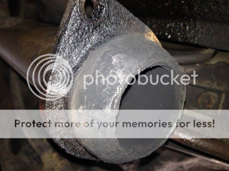

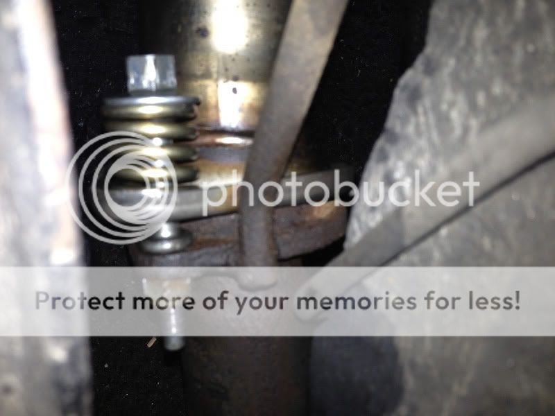

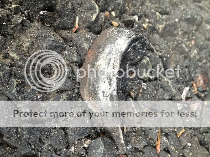

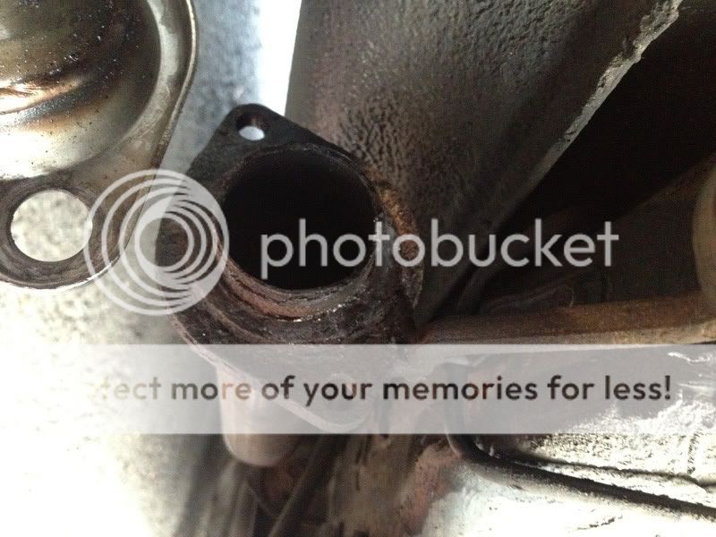

Update:
The day that I installed my N1 I was in a rush since I had to be at work so my time was short and I finished it up just in time. However the old gasket was caked on there and I ended up not throwing my new gasket. It had been leaking a good bit and I finally got around to addressing that issue.
I thought it was going to be super hard to remove but with a little PB blaster, a flathead screwdriver and a hammer it broke it off little by little.
Now I had the opportunity to measure my B pipe width. It bottle necks like the N1 so the piping itself is 2'' but the flange is at 1.74'' (OEM). The gasket is a bit loose in there but it fits the N1 perfect. When I upgrade to a nicer B pipe it will be the right size but I'll still have to get a new one but now I know for sure it will be the EM1 donut gasket. So in hindsight I should of gone with a OEM donut but I didn't think it was the 1.74 but either way, not a big deal.
Nice and tight now!
While I was at it, I decided to also check the header/cat bolts and turns out that one bolt wasn't tightening or loosening so it seems that the threads are stripped even though its not visible with the nut being on it. Its leaking a little so I'll get a new bolt/nut sometime and cut the old one off (replaced them last year so not that old) and it will be leak free hopefully.
Took it for a spin and its nicer for sure, got some power back (or response as some of you like to call it haha) and it feels good and sounds better.
