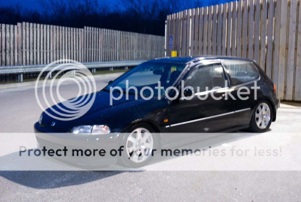

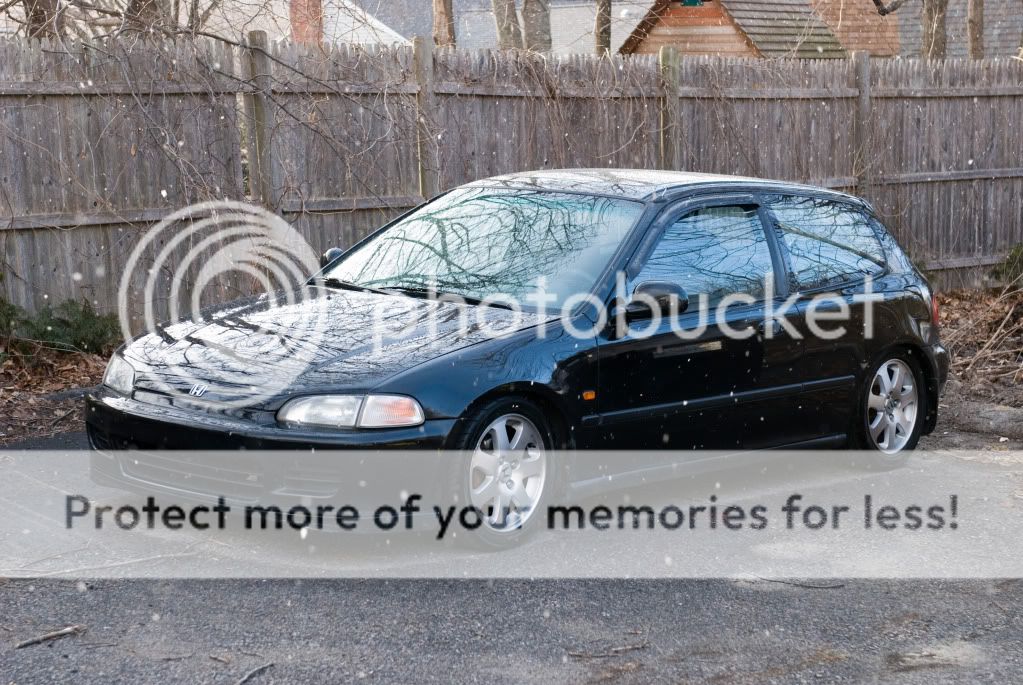

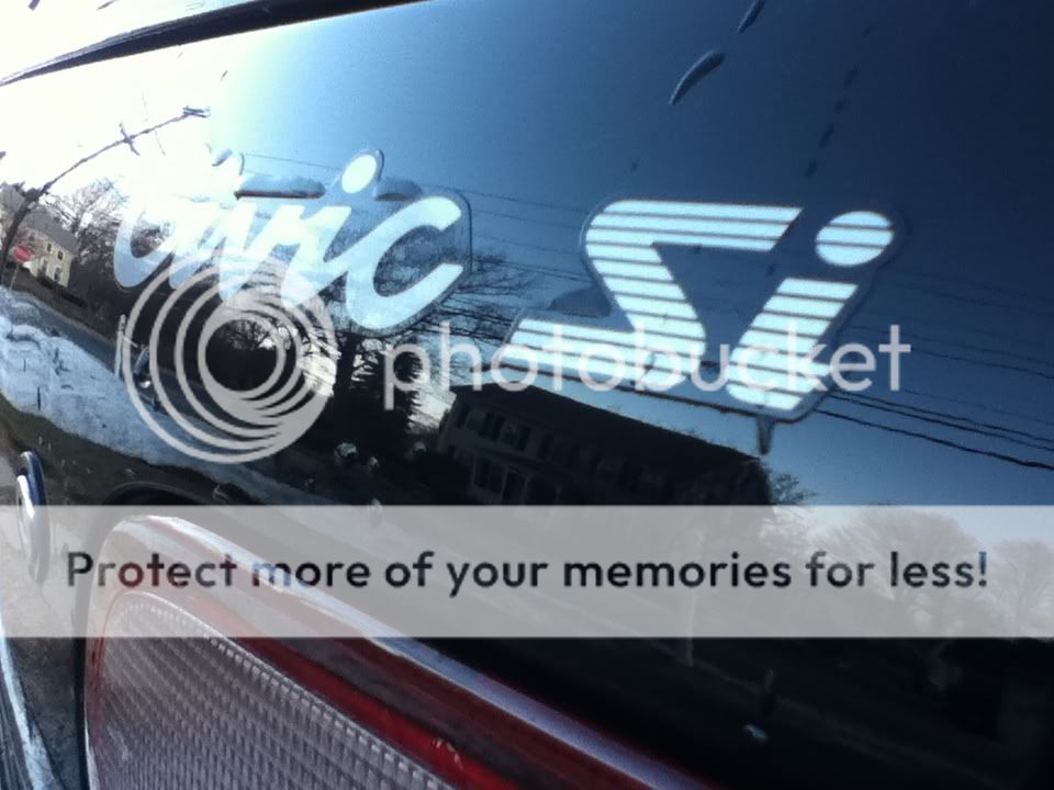

I did take a few pictures 2 weeks ago so heres a couple of em!

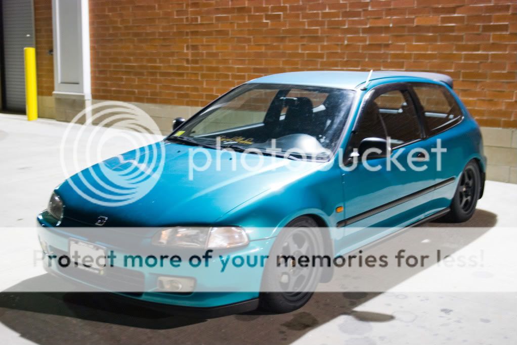

Heres Jesses hatch too, rocking JDM interior

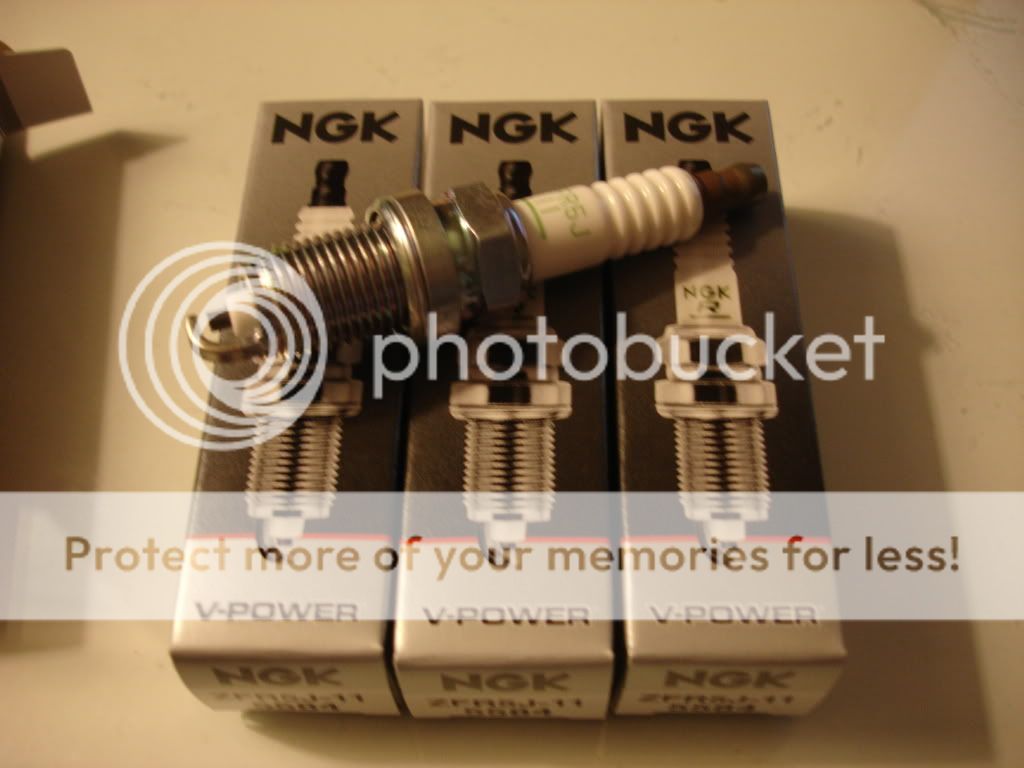

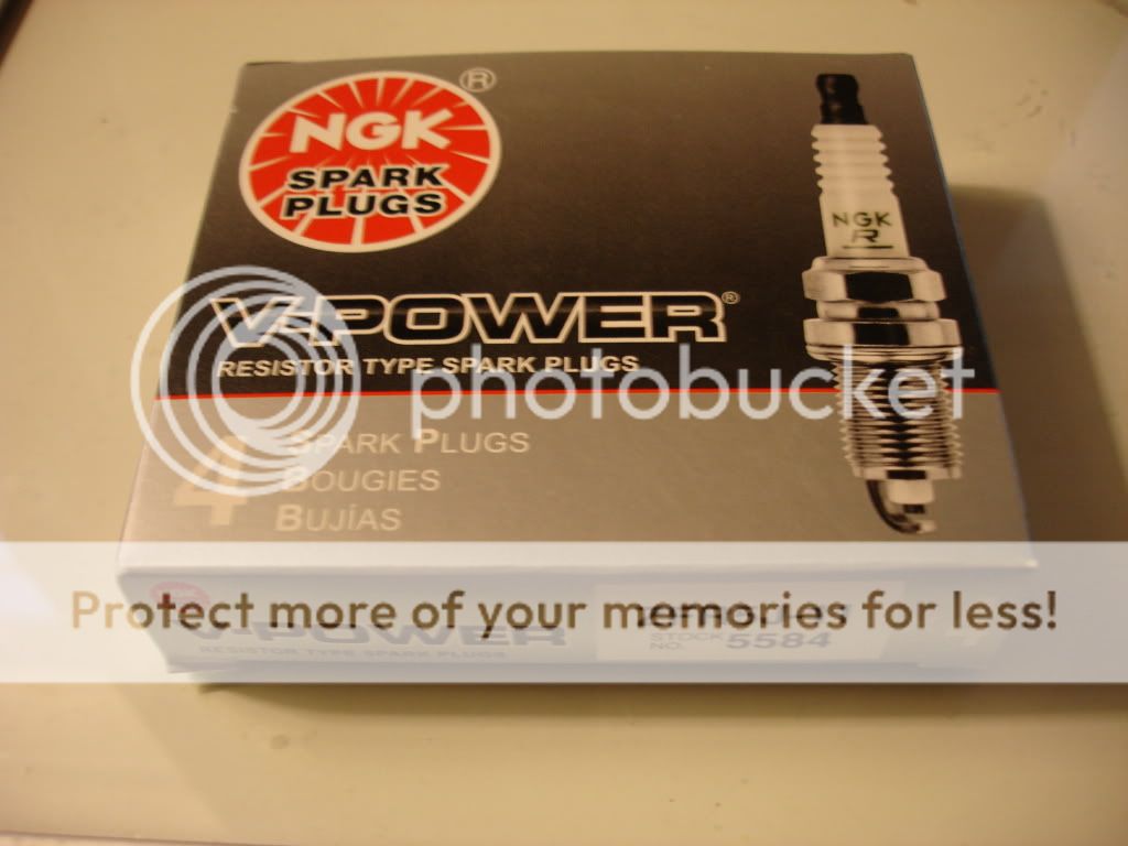

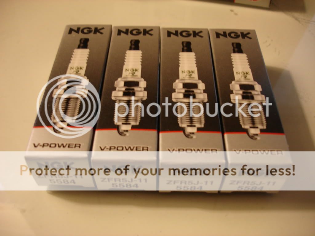

Got my spark plugs in today along with my Super Street+Honda tuning mags. They never get here this early lol. I'm stoked!
Miguel will be coming down this weekend and were going to seafoam the EH3/DA9, change the plugs and do an oil change. Wish my tune up would be better than this but it will do for now!
They are NGK V-Power ZFR5J-11 which is the best plug for a single cam thats close to stock. A lot of people go and buy iridiums but the truth is that manufacturers spend a lot of time finding out what is the best plug to use so theres no need to upgrade here. Its nice that theyre regular because they only ran $11 anyways and $22 shipped.
Theres a colder spark version available of these that you can run if you have some bigger mods done.

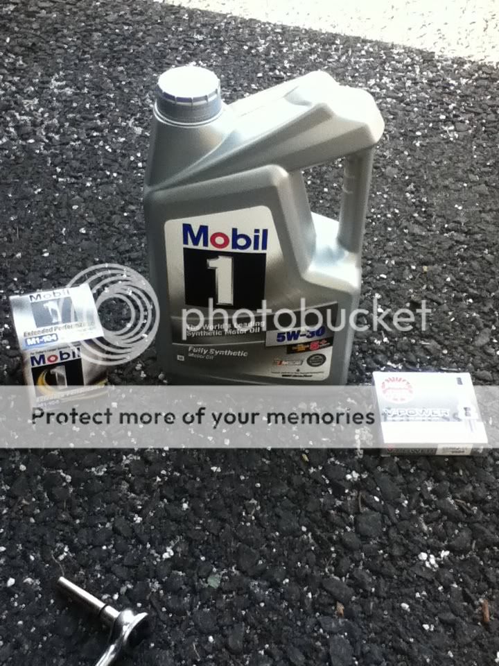

Update:
Had the time to seafoam my motor today. I used 1/3 in the gas, 1/3 in the crankcase and 1/3 through the brake booster hose. Then I revved it for a few minutes around 3k and took it for a spin. Smoked like a chimney for a while, people must of been thinking my car was a huge POS haha. I looked back and could barely see the car behind me. Cracked VTEC until it had stopped smoking completely and then I changed my oil+filter+spark plugs. I made sure they were gapped to .044 even though they came pregapped.
Heres what the smoke looked like after a minute of driving. Click the picture for video.

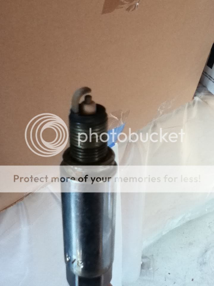

My old spark plugs had a white residue on them but it wasn't caked or anything. After I took it for a drive it felt better. It stopped misfiring completely and doesn't bog anymore (woot woot!) and its quicker because of that. More responsive and it sounds better as well which is a good indication that its running better. Some people say sound is misleading but I know my motor and I can tell that its igniting properly. Anyone here with a VTEC engine knows what I'm talking about That raw power sound.

I looked it up but I wasn't sure if white was good. It means it's running good/hot right? Yeah all were pretty even so that must be a good indication of the combustion.
