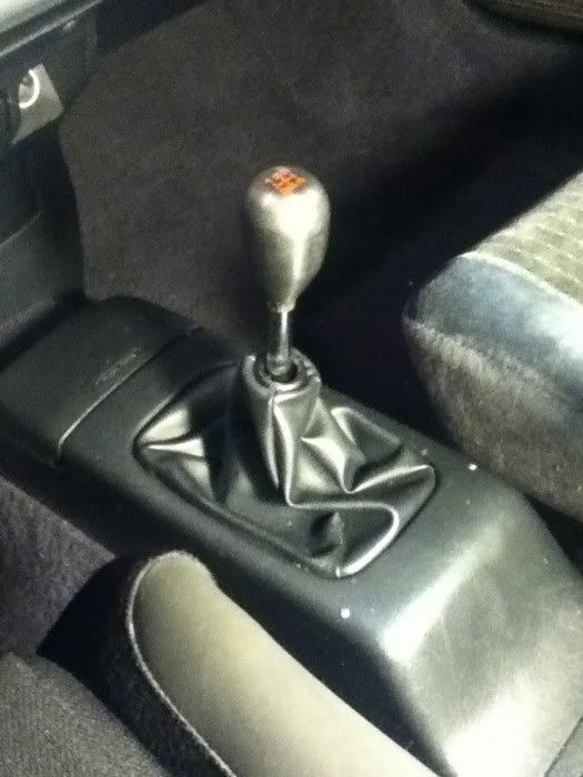

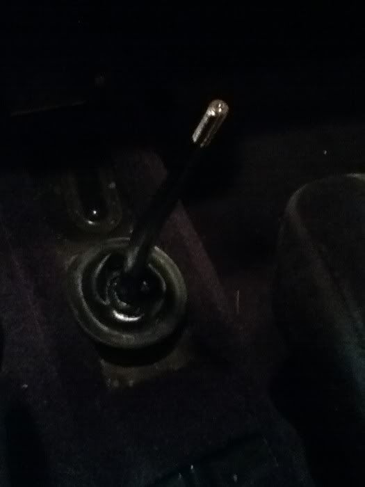

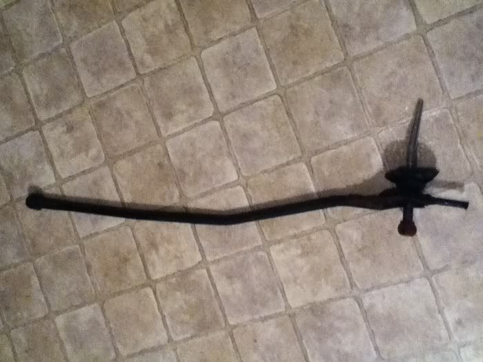

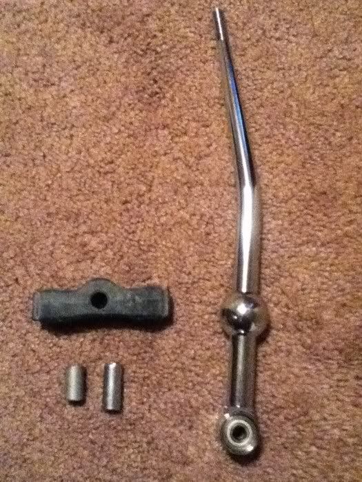

Updates:

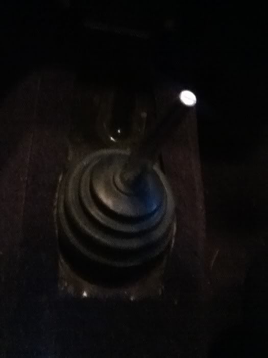

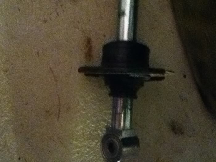

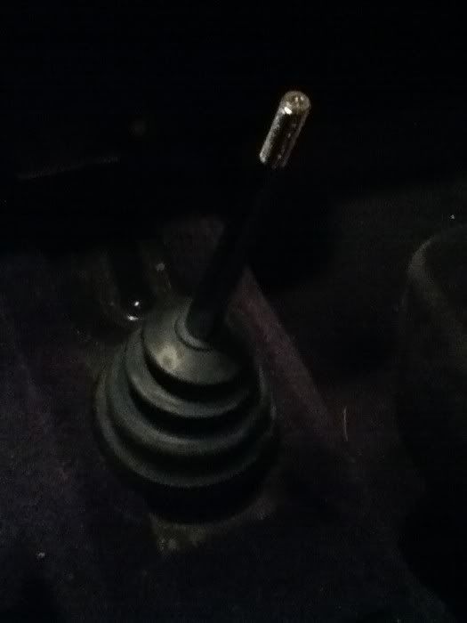

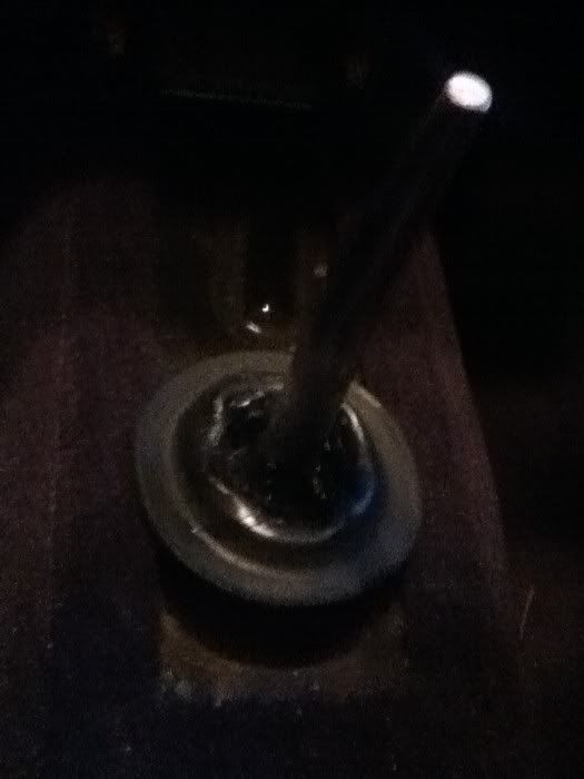

So lets pick up where I left off. Here are the pictures I took from when I changed my short shifter. Its more or less a DIY too haha. It was pretty simple to do, just took some time, maybe 1 hr if you work quick but I took my time and took 2 including setting it up and jacking it up. I'd say its a 4/10 in difficulty/effort.

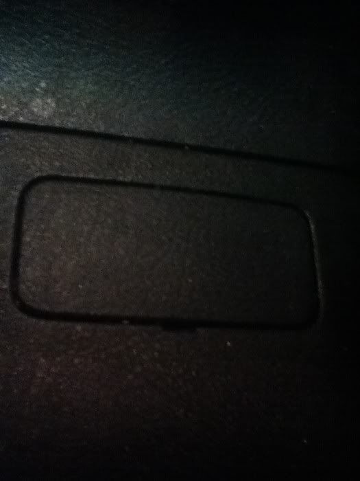

Jack up the car safely on all sides.
Pop this cap off.
Then remove the shifter console and you will see this, remove that.
Then remove that too.

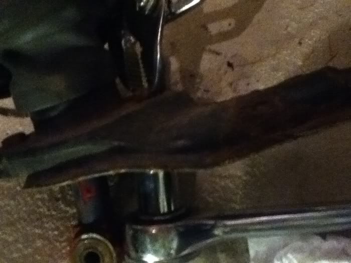

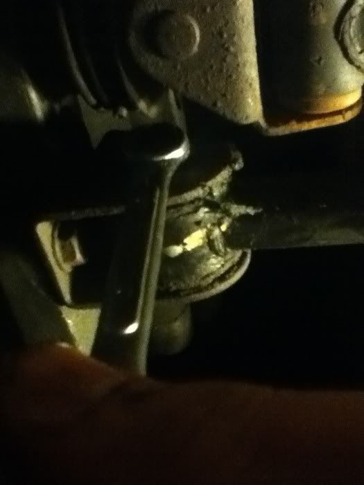

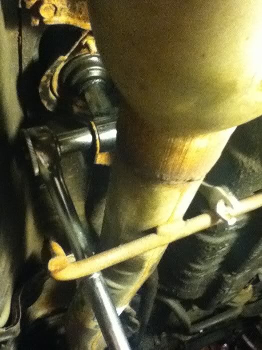

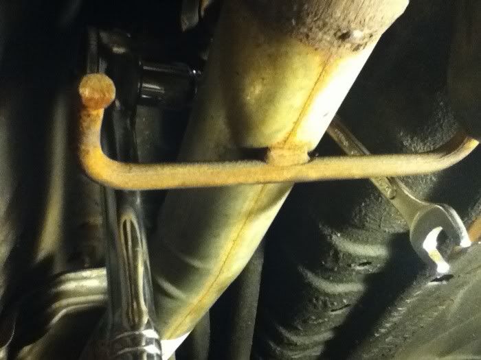

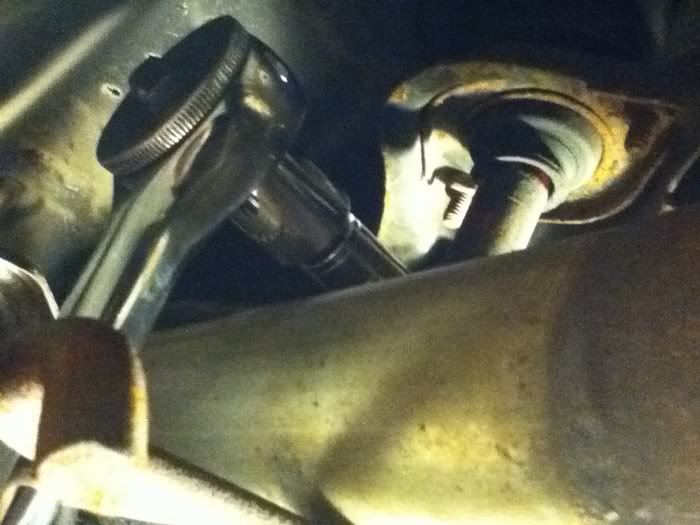

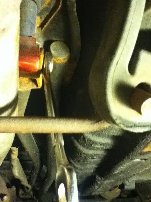

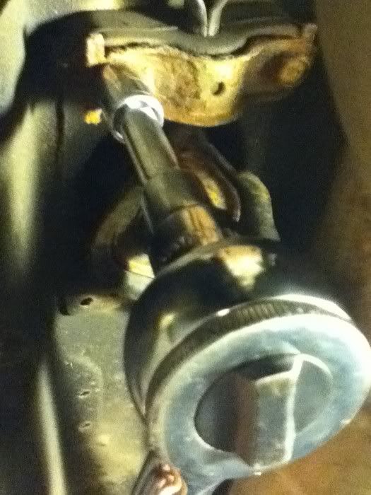

Under the car you need to remove the 2 12mm bolts that hold the shifter bushing.
I then took off the rubber hangers and a stuck the wrench in one side and the ratchet in the other, this held the bolt in place not to spin.
Next you need to drop the shift linkage, otherwise its way to cramped to change it. Its only 1 bolt anyways.
Wiggle it out of there and this is what you get!

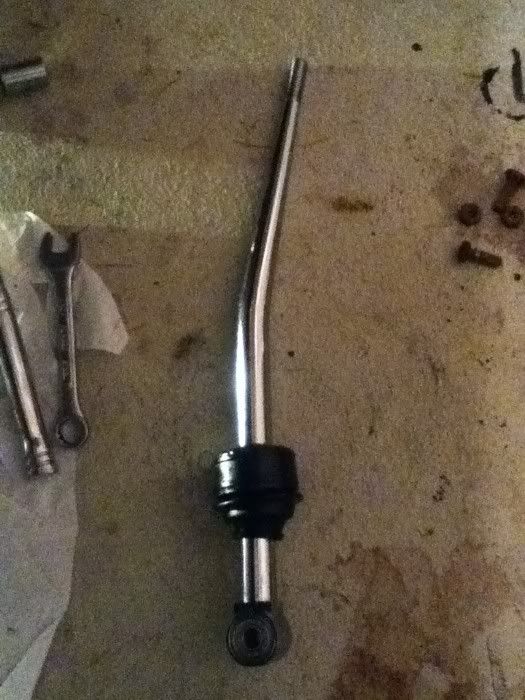

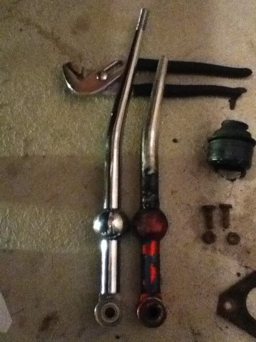

Remove these 2 bolts with a ratchet and vice grips to remove the shifter from the linkage.
Side by side.
Next lube up the shifter ball part and slide the dust seal up in the shifter. Make sure it goes up the right way.
Tighten it back up.
Then get the linkage tighten up at the front too.
Replace the 2 bolts at the back too and preferably with a new shifter bushing.
Then from there just put the boots back on and the shifter console and thats it, pretty straightforward.

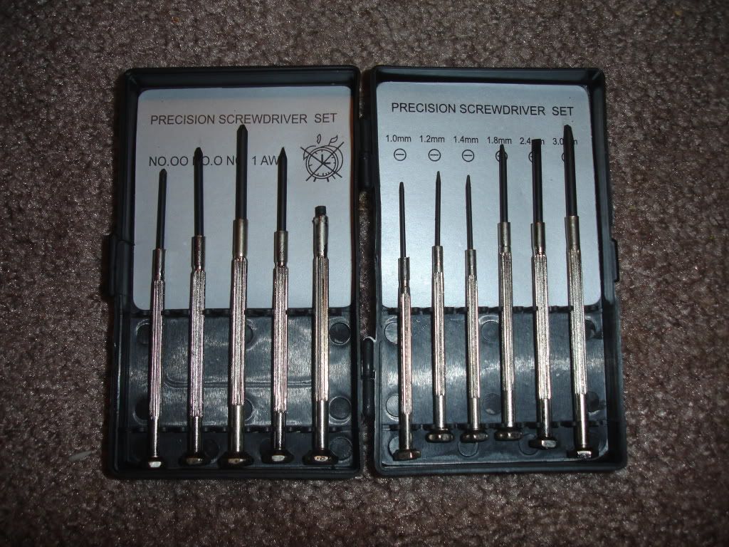

Got a new camera charger so I can now continue to using my camera and not have to resort to using the iPod's camera.

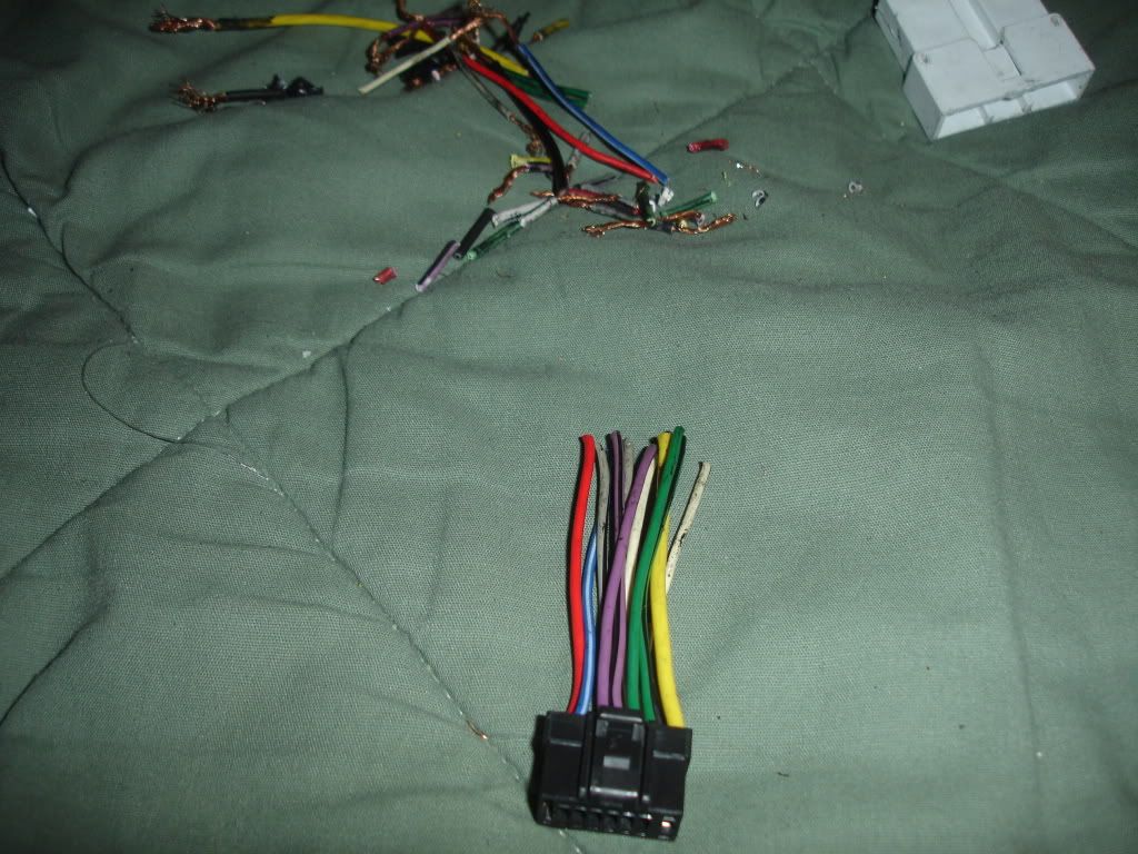

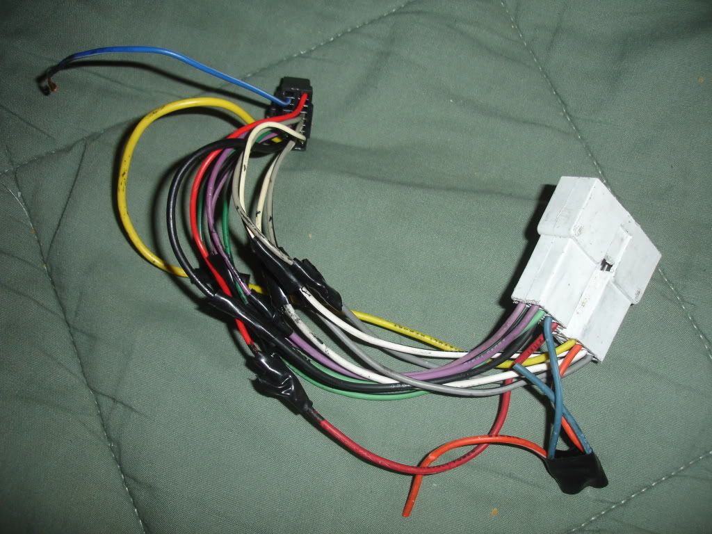

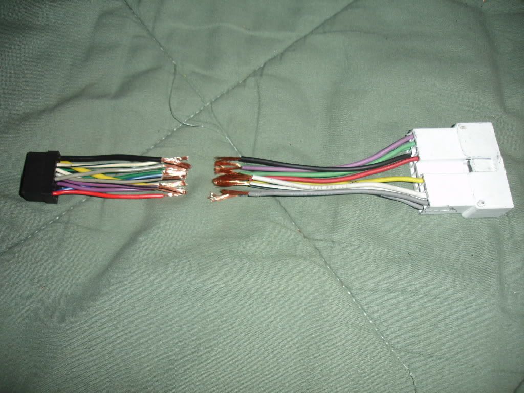

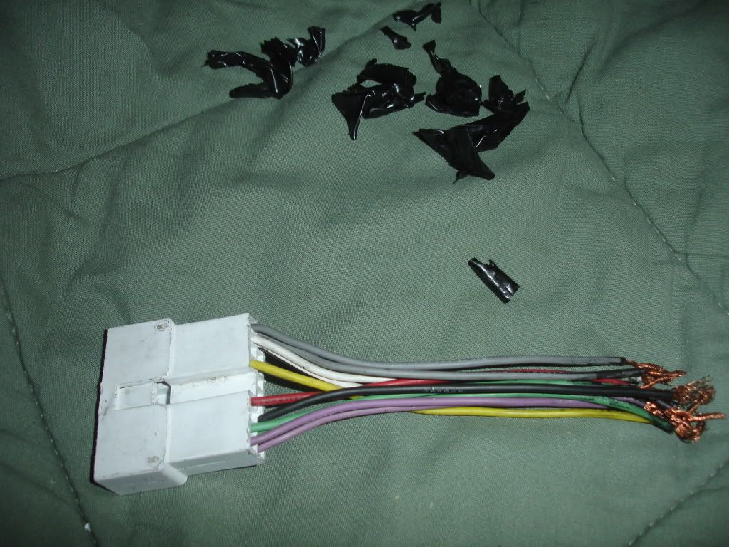

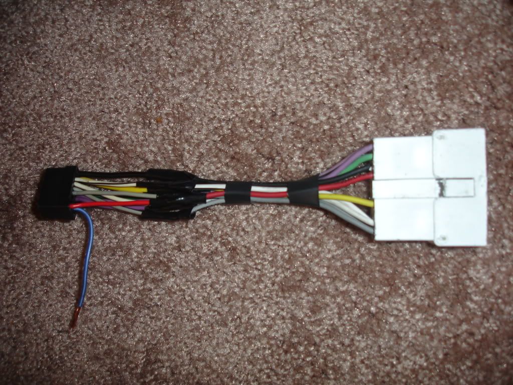

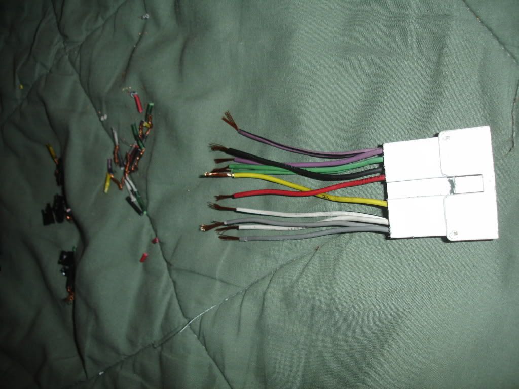

Next up was the radio harness, I wanted to clean it up a bit.
Got this too, came in handy!
Finished product, I would of heat shrinked the connections but my tubing wasn't small enough but not big deal.

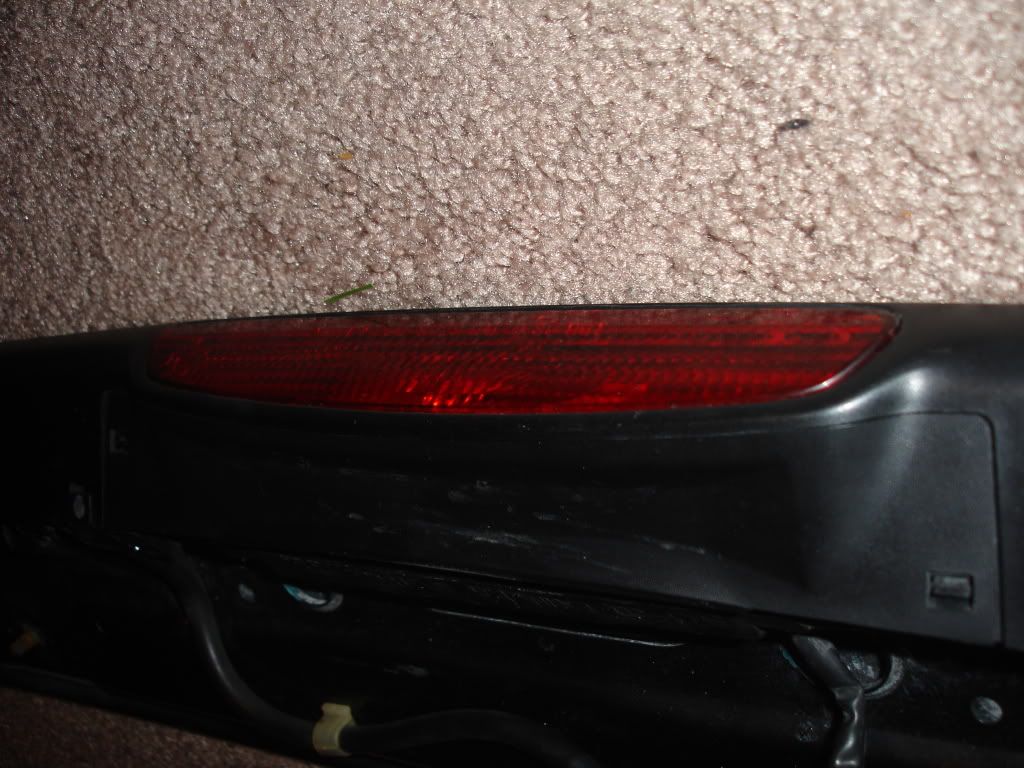

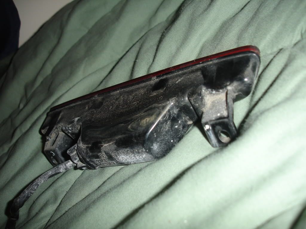

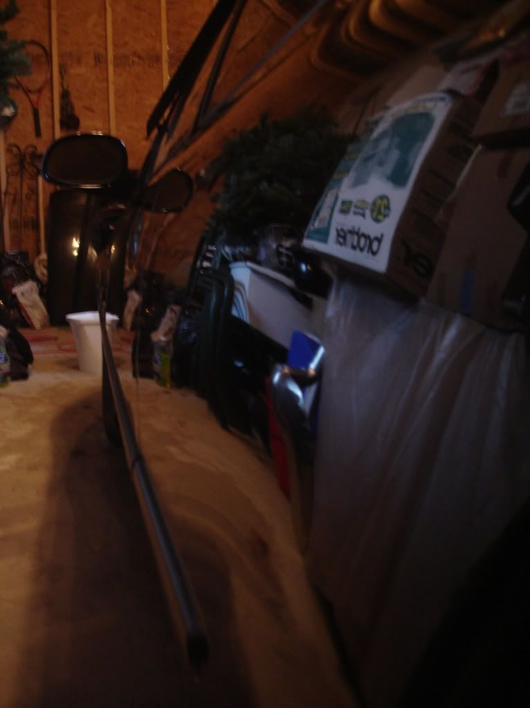

Took my spoiler out as well, wanted to clean it up a bit, it was quite filthy with wax compound. The other thing I did was use the heat gun to bend the right side down; it always stuck out too much out of the body lines. I was able to get it to curve more and fit the body nicer.
Also managed to get the brake light cover to sit flush! It didnt quite attach right before.
Also cleaned up the wires the same way as the harness.

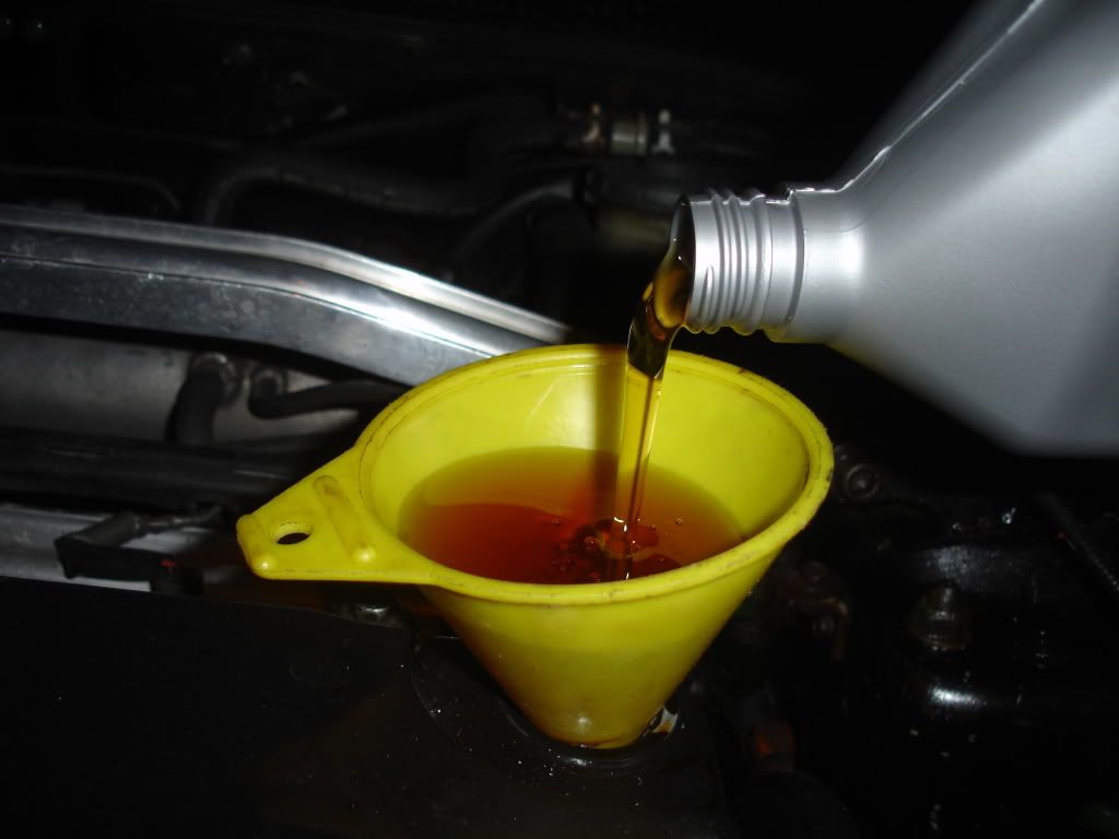

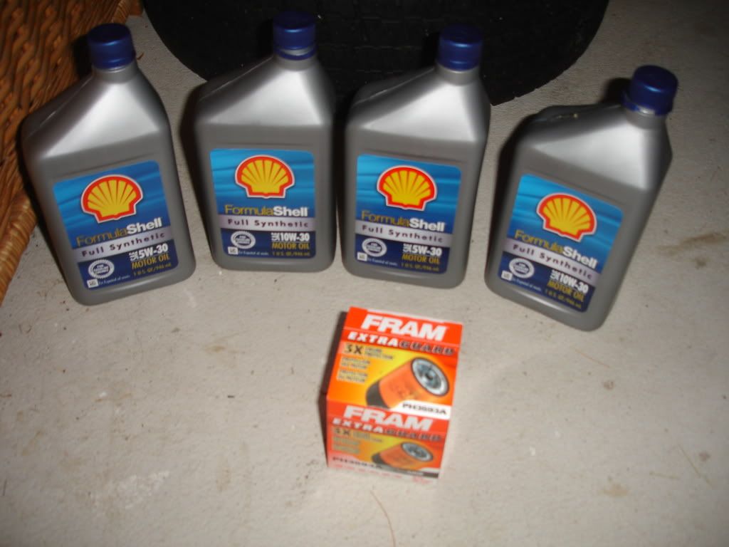

Tonight I was actually able to change the oil as well, which reminds me that I never posted the last time I had done it lol 242,998 now

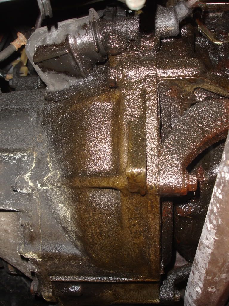

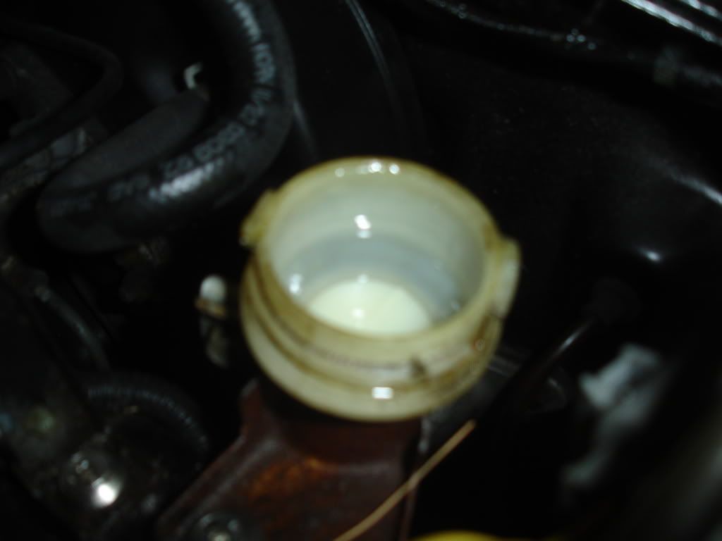

Noticed my clutch reservoir was empty again....so this is where its going huh?
So its the slave cylinder thats leaking, I'll have to replace it soon, its only like 15 bux or so and easy to replace. Phew! A lot of dirt and purple stuff came out . I cleaned it up and then bled the system again. Should last me a few weeks.

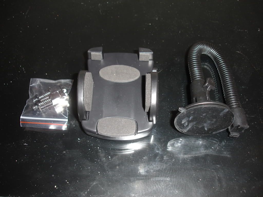

Also got a suction cup mount for my iPod touch so I can record some driving in HD. I'll take a video soon. Not bad for $5 shipped lol.

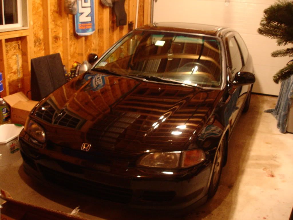

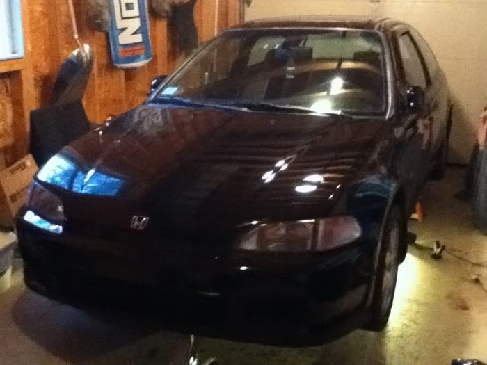

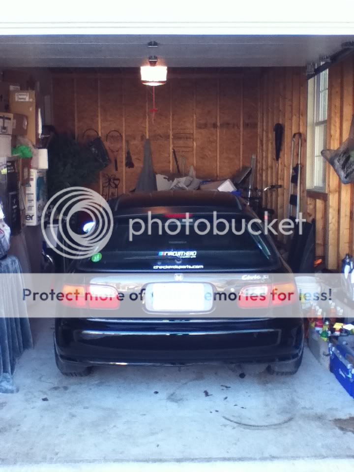

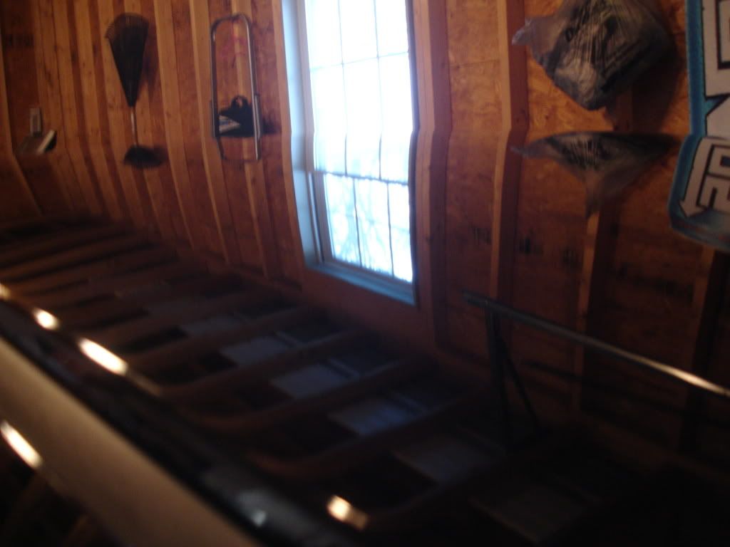

Oh and a shot of the garage. Looks a bit cramped but I've since cleaned it up a bit. I'd like to move a lot of stuff out of there but the basement needs to be cleaned up and most of that stuff isn't mine so I can't touch it otherwise I'd move it there :-/
Its alright to work on though!

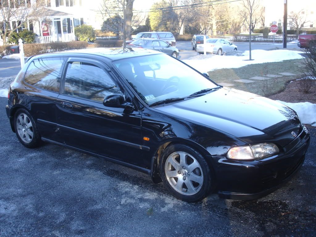

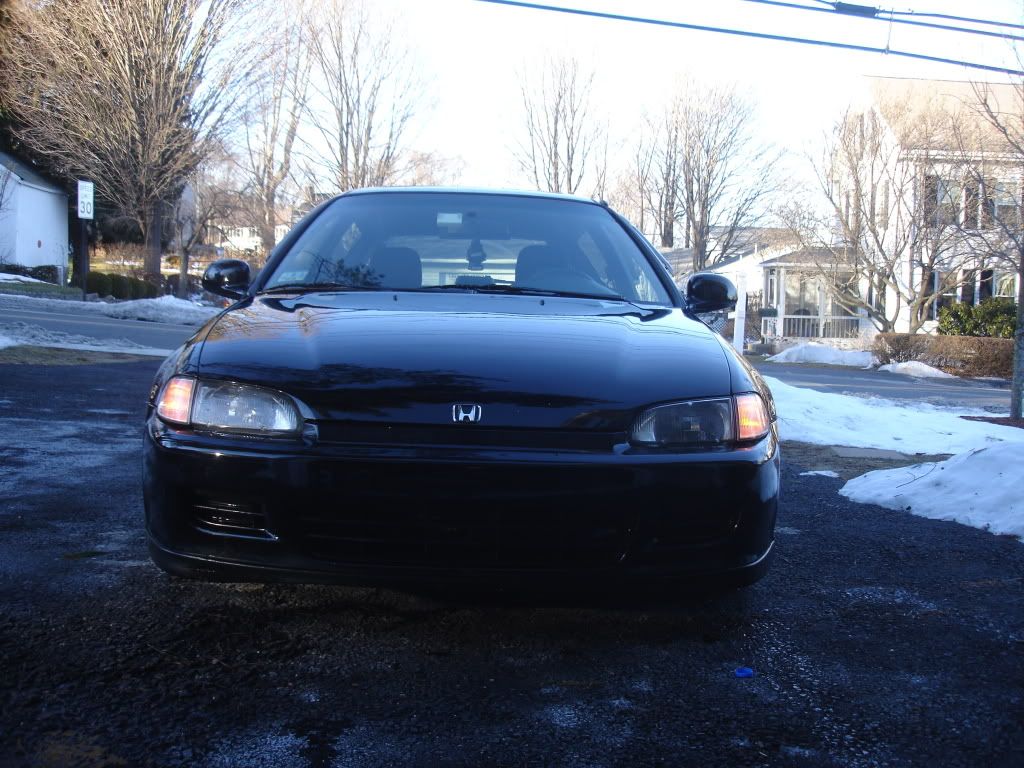

I found some super nice pictures from when I picked up my car from the bodyshop. It was on a friends camera, I'll post them later tonight!
