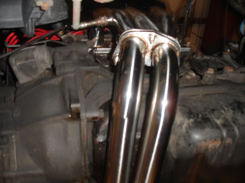

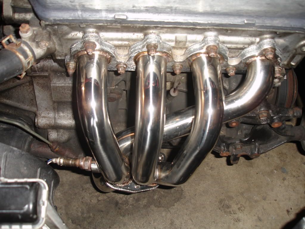

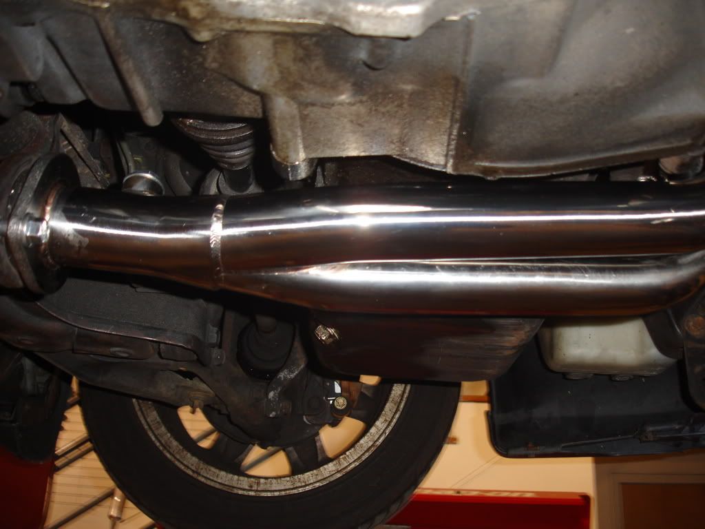

The next day I went back to install my header and the bucket seat
Sprayed simple green to try to clean it a bit but it didnt do much.

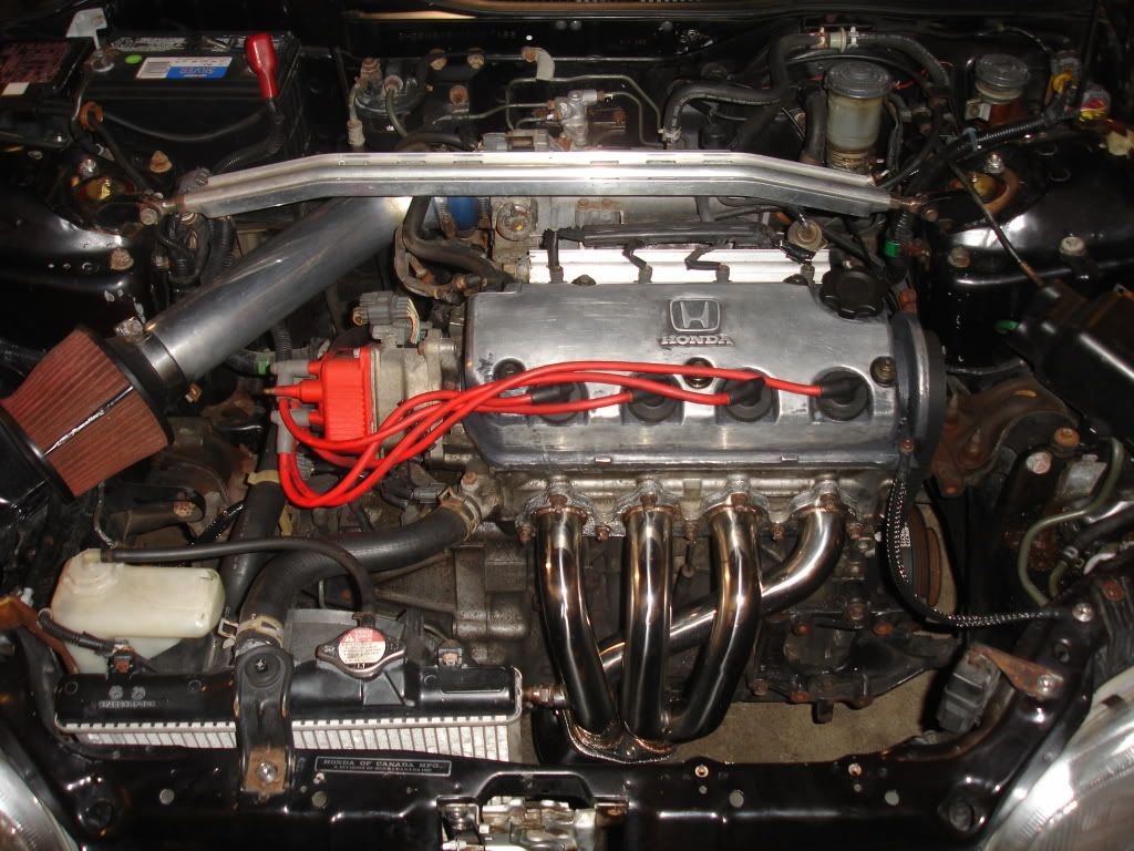

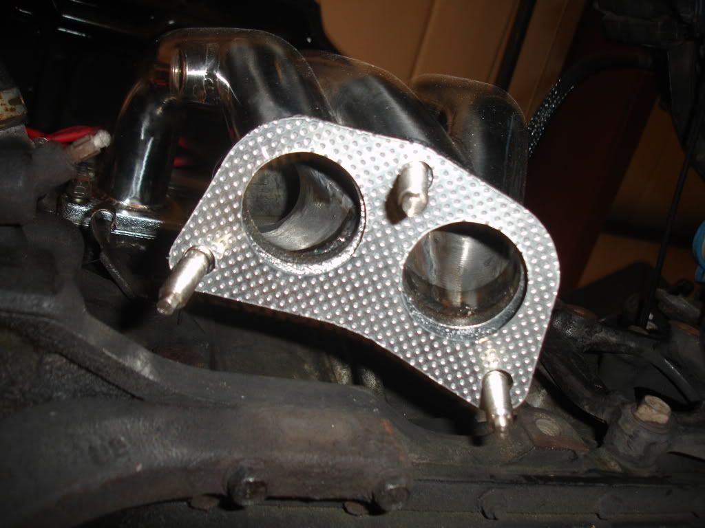

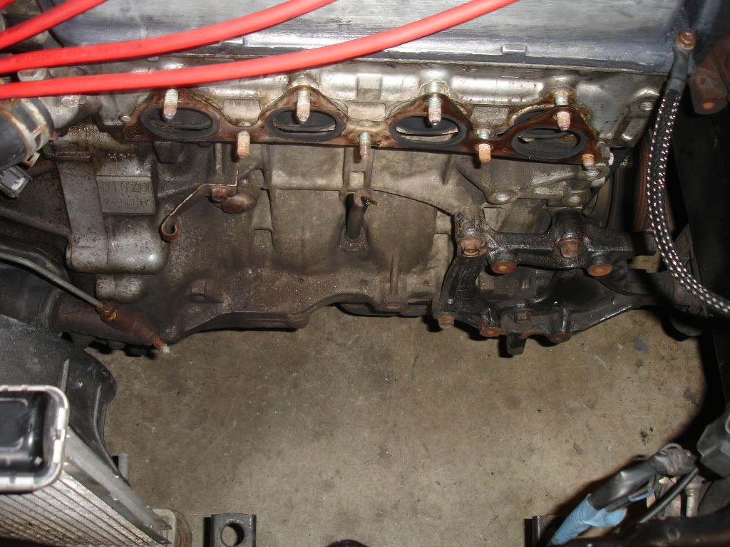

Stupid header was 2 inches short like someone mentioned that it might. Had to pull the exhaust forward and bolt it up. Then the axleback was touching the chassis so it was vibrating the car when near idle and whatnot.

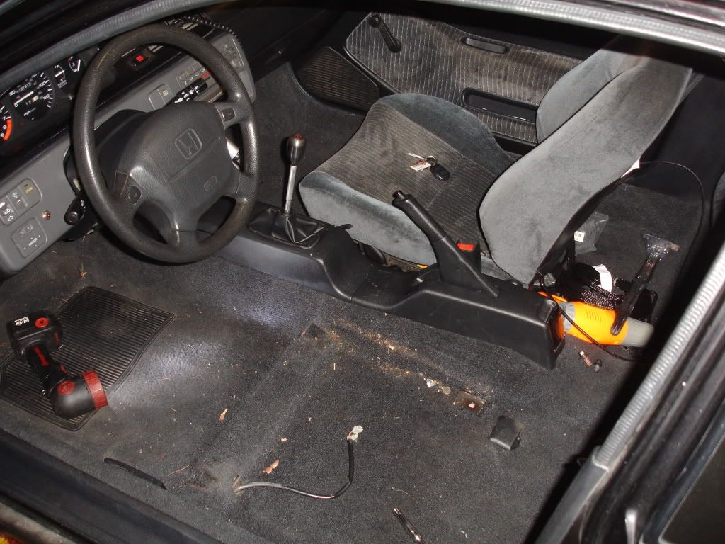

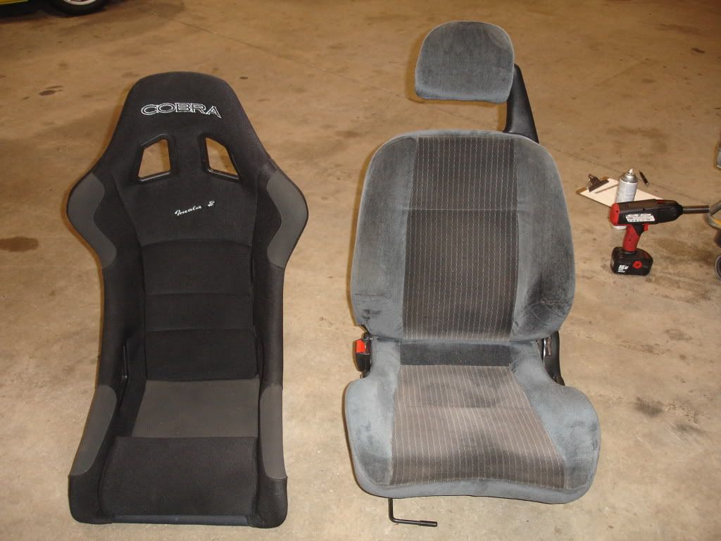

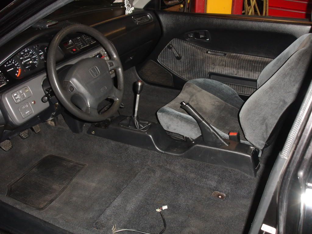

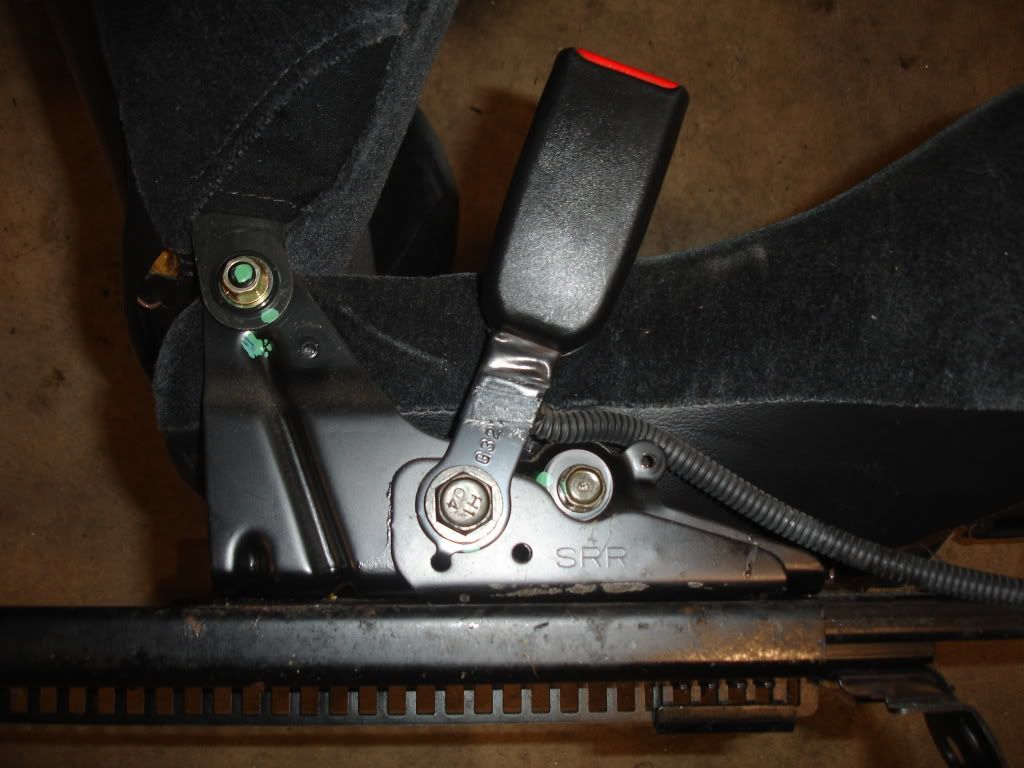

Once that was done I started to tackle the seat, first remove all 4 bolts that holds the stock seat. 2 in front of it and 2 behind.
Seat out, I was surprised by how heavy it was. Saving some pounds here for sure.
Comparison
Remove this bolt to carry the buckle over to the new seat.
All vacuumed up ready to go.

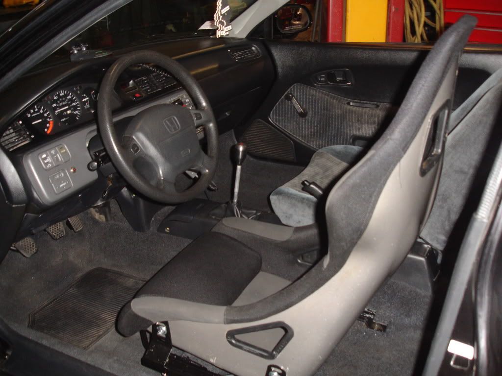

Buddy Club seat rail in. It needed 3 washers to be put in, the bolts were just threading though the holes The rail also didn't include the bolts that go in the seat but maybe seats come with them when you buy them new. I was expecting bolt on quality but putting 3 washers isn't that big a deal, they should of at least came with instructions though.
Seat installed, credits to Evan on this one, I would of had a hard time figuring it out myself
Overall the seat feels really good, nice and snug and its pretty comfortable. After having it for a few weeks I still like it. Looking forward to taking some turns at the track or auto-x to really feel the seat hold me in place bc I have yet to feel my legs move left or right

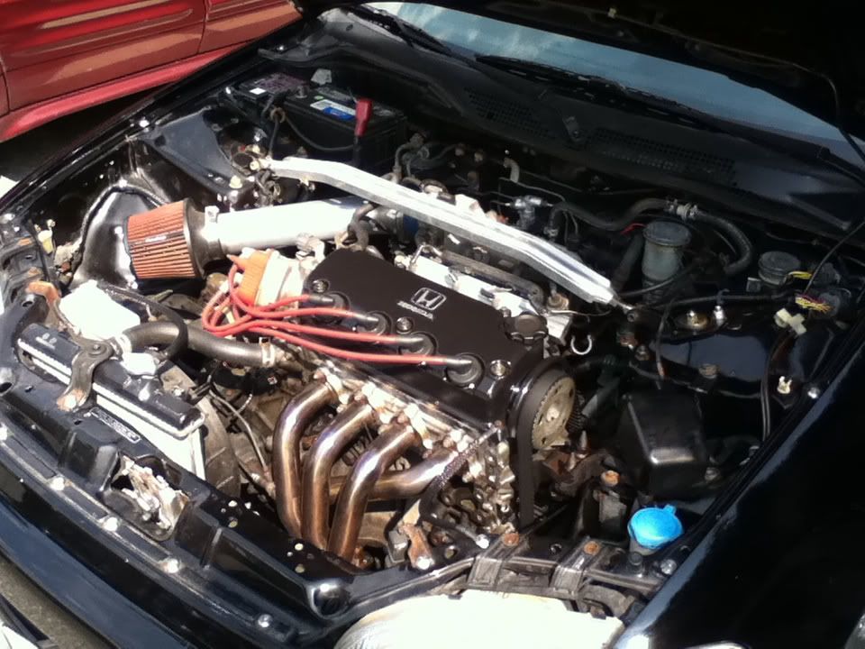

Tubed/sleeved the coolant overflow hose lol!

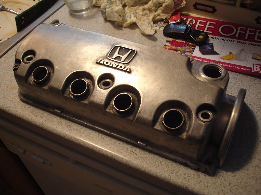

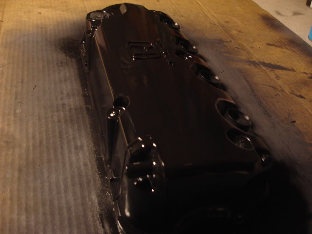

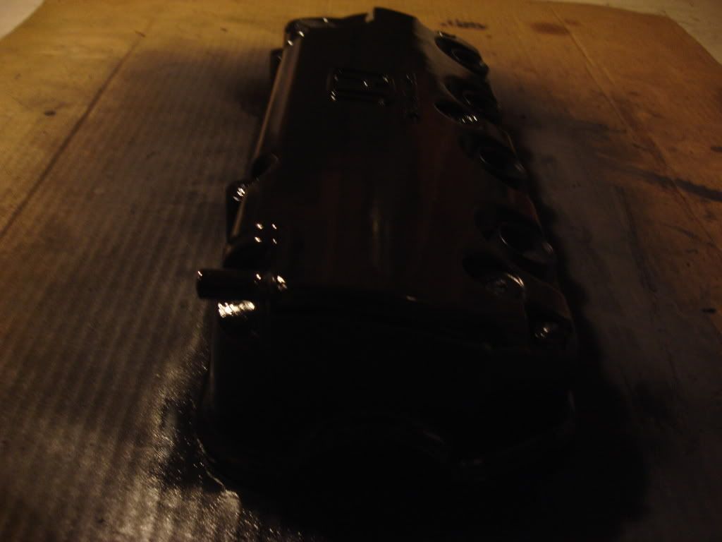

Got off my *** and spent an hour stripping the VC fully.
Petroleum jelly on the parts where I didn't want paint such as the H logo and HONDA and around where the bolts go.

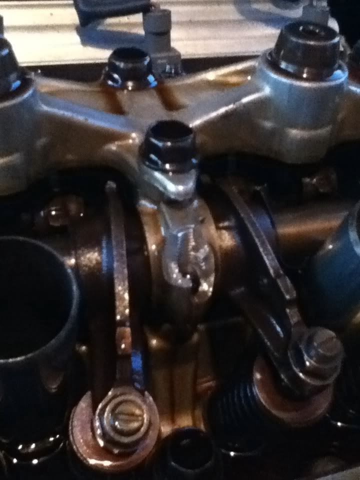

I'll take a pic of the VC installed too. Not entirely sure why but its leaking oil. There will be oil on the bay. I'm hoping I can stop it completely. So annoying!

Default Re: HBKFanatic's EG Hatch Build Thread
Could be the valve cover gasket?
I mean I know what's causing it, just don't know the fix lol.
Two of these. Previous owner had overtighned the bolts and so there's 2 bolts that can't thread in. It was fine before though, I even took it out to make sure everything was seated right.

With that no name head does the collector gasket fit up correctly? I bought one and the fit was horrible. I heard some of those things are hit or miss when it comes to quality.
The collector gasket fit no problem. I'm not exactly sure how it's supposed to fit but it seemed to be on point. The header itself is of great quality. I picked up some torque over my old header. It was the same header but this one was slightly redesigned so the hardware is better, the welds are pretty clean and the material used is good too. Fitment was great too except it was a bit too short where it meets the cat. Its the same size as my old header.
I went over a manhole and it the o2 bung plug bolt got loose and came out. Luckily I still had the spare so I put that on yesterday. Sounds good now and the axleback vibration is almost nonexistent. For 50 bucks though you can't go wrong with that header lol.

Engine bay is looking good
Hopefully the metal pieces that broke off there aren't in the head still

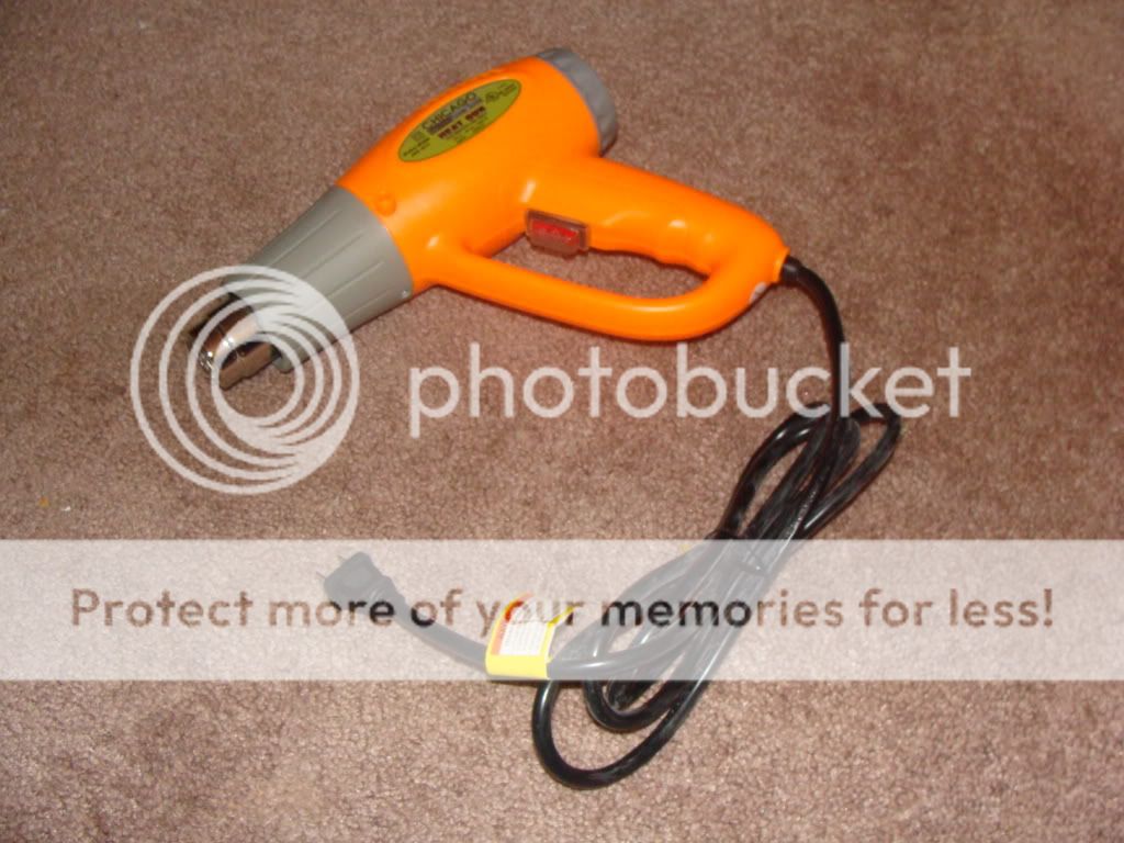

Heat gun to do the heat shrink tubing! Works excellent, gets quite hot.

Fixed my exhaust leak thursday, I went over a manhole and it hit the header. While driving home I hear a bolt drop and it was the secondary o2 bung plug bolt that got spit out. Replaced it and the good thing that came out of this is that my axleback stopped vibrating at near idle

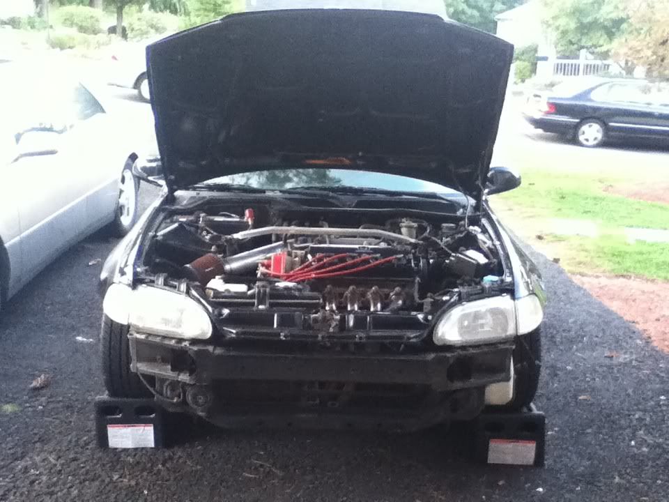

Had to take the bumper off to go up my ramps, oem jack sucks so had to use the ramps. Bumper doesn't clear it

Engine bay needs a lot of work. The metal pieces that broke off aren't there. Plus if it was to take a **** it would of happened already

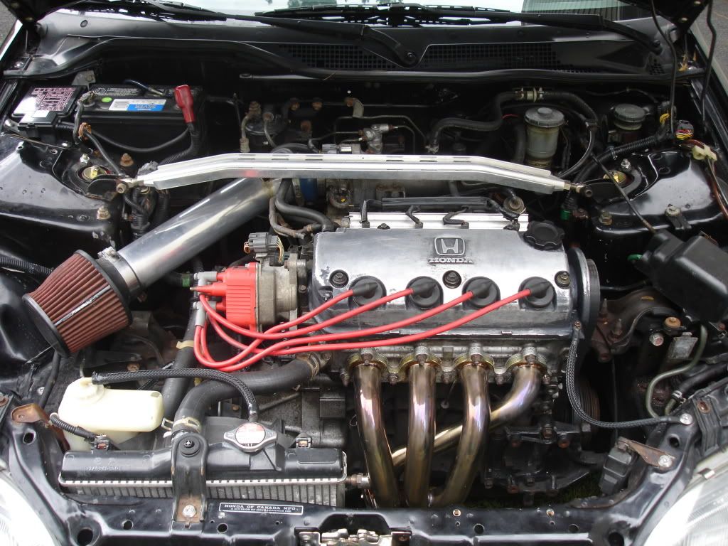

Spent 5 hrs working on it today. Did some wiring work and removed some wires from the bay that as well. After I got everything put back together I turned on the car but it stayed at around 2,500rpm even after it was up to temp. So I turned it off, adjusted the idle air screw on the TB all the way in, turned the car back on and voila it was back to a very stable 1,000rpm idle. I have a feeling something is up with it. I need to try to clean my FITV, never really got around to doing that. (Bolts are pretty seized)
I also hear an air leak noise from behind the motor by the intake manifold. I wasn't able to pinpoint where it is since it was dark but maybe if that leak was fixed my idle would be at 500-800? More to come :-)
