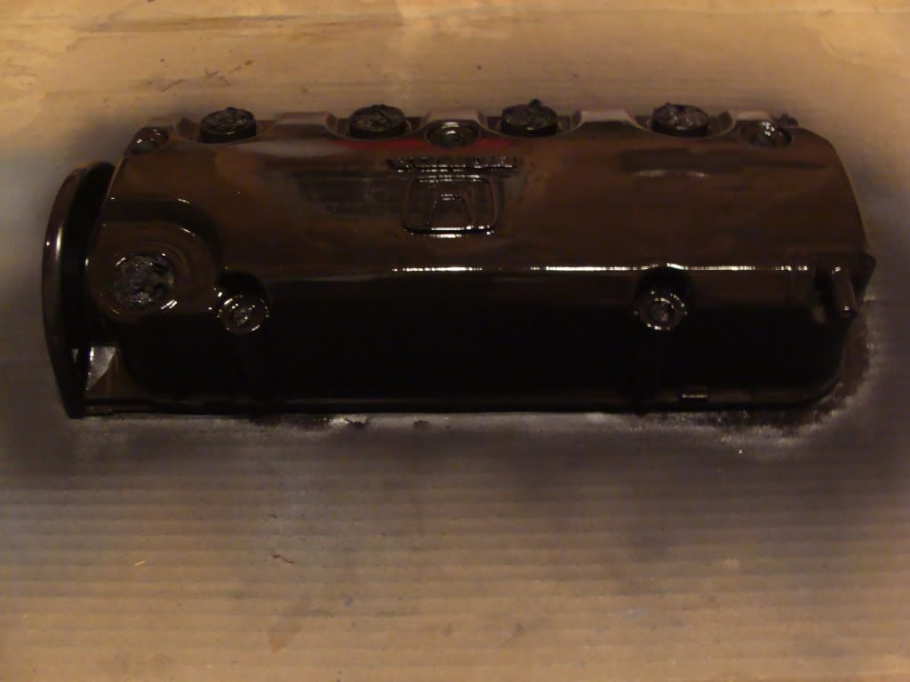

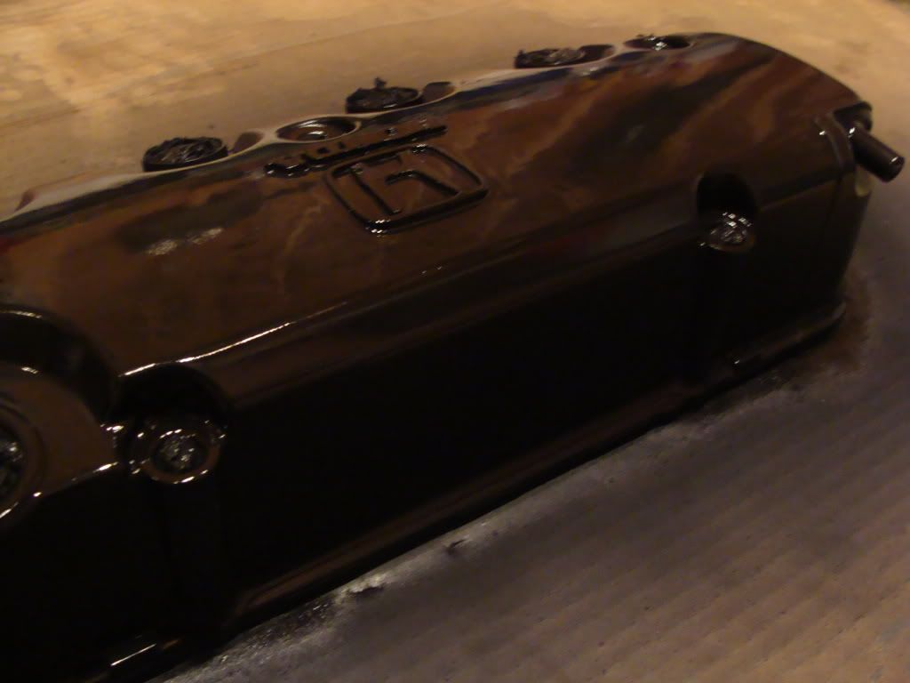

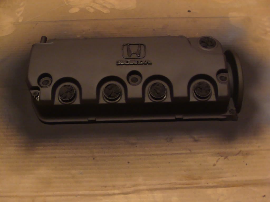

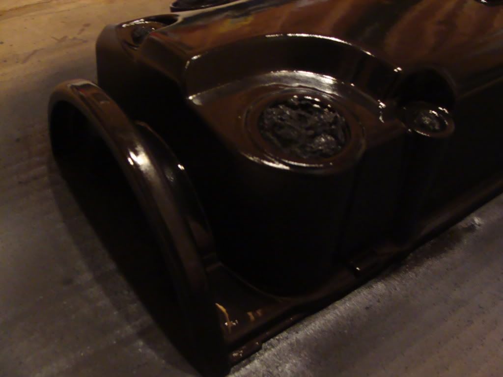

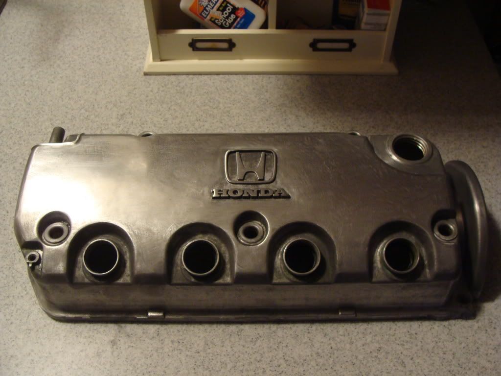

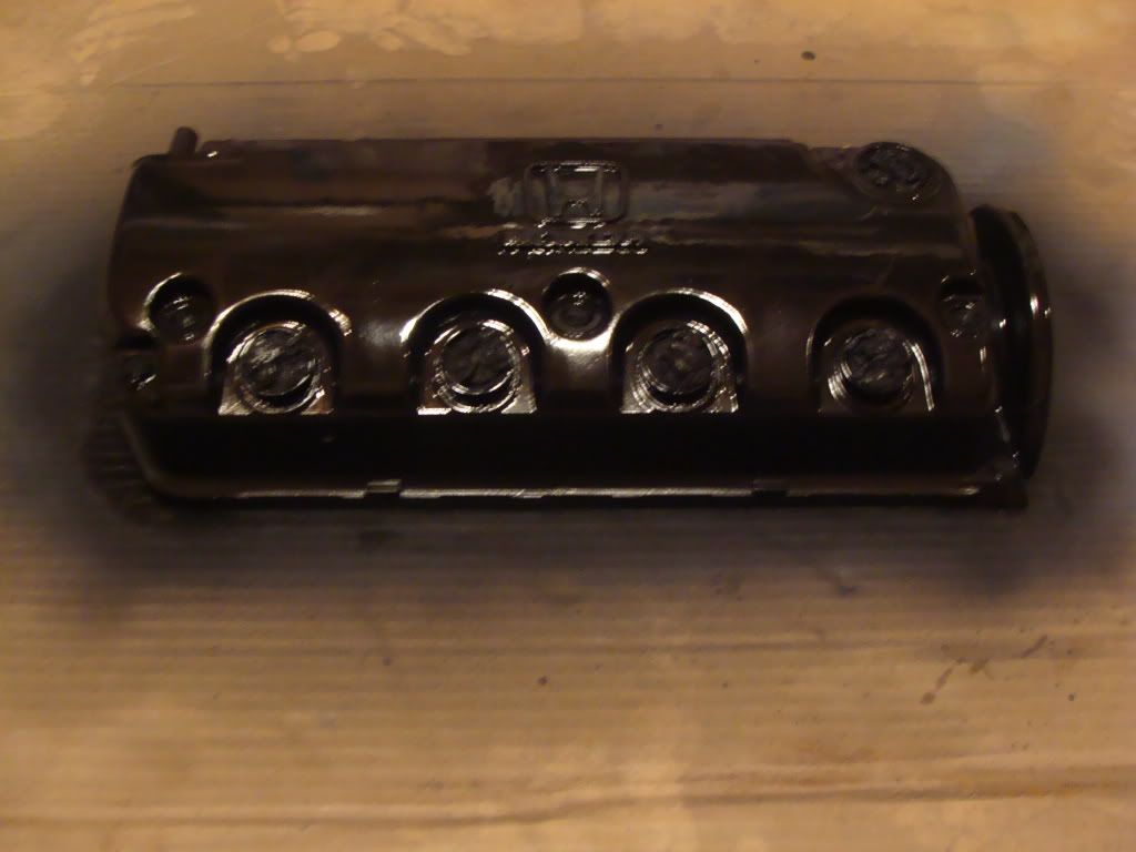

So this is where I had started at:
Fully stripped and sanded to 1000 grit:
Fully prepped:
Paint used:
I applied petroleum jelly on the H logo and letters so that I can easily get it out. Works better than taping it and is very easy to remove.
Primered:
Painted black:
Cleared:
Unfortunately I messed it up so I stripped it again. I'll work on it tomorrow for sure. It had came out pretty good too. Just needed more coats of clear.

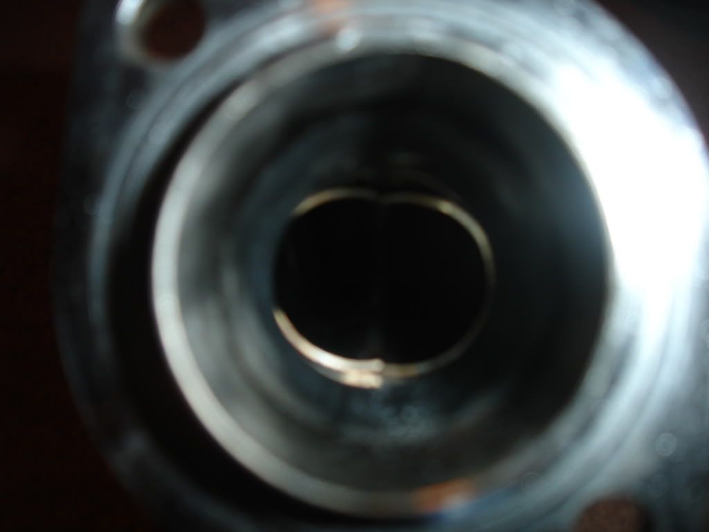

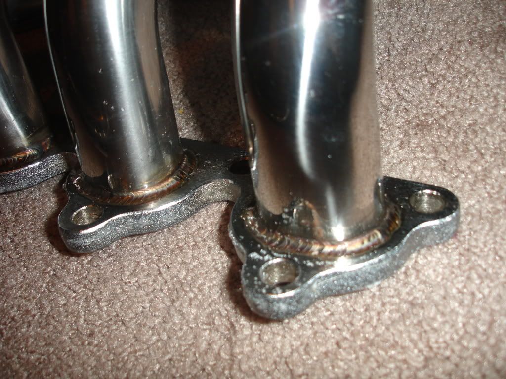

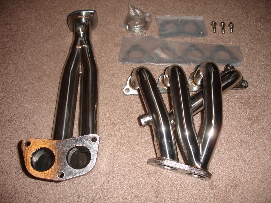

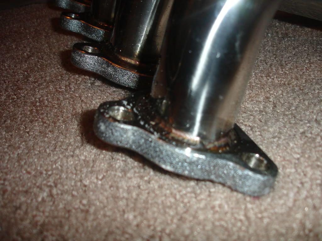

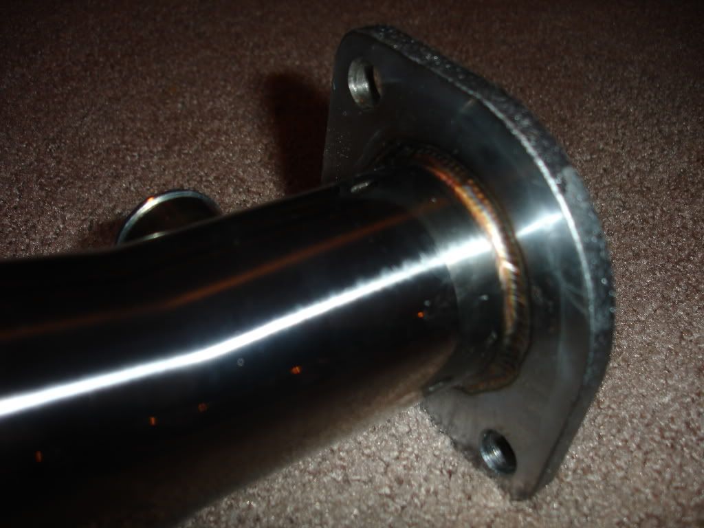

I hit a raised manhole about 3 weeks ago and it hit my header and caused the gasket to break so I have a 3 inch leak on my header. It sounds pretty bad and I'm loosing power. The bolts are seized so replacing the gasket wasn't doable so I just said the hell with this header and got me another one Plus even after I had polished it there was still rust there.
The new one is pretty nice, the welds are really high quality for an eBay header. Its the same header but the construction has been improved. The hardware is better and for $50 bucks I'm really pleased.
I also got me some 1/2'' heat shrink tubing and 5/8th sleeving to start doing my harness and to help clean the bay. It was under $30 shipped too, not bad I just need a heat gun to get started. Thanks to dapek for the idea. Good **** homie!
More updates tomorrow since I have pictures on another camera.

Nice man that header seems to be pretty good quality considering the price

be careful on the measurements of the header. my brother got one for his del sol and has cause nothing but trouble for us cause its like 4 inches too short
Yeah, the welds are clean and it looks nice. Think you could help me throw it on? I tried to do it but the bolt that holds it to the cat wouldn't come off. It spins inside the whole but it won't loosen up. I'm not sure but it looks like the nut its either rusted or welded??? Might need some power tools
Really? I'll have to compare it. I know the 4-2 is the same size but its possible the 2-1 section isn't the right size. It looks about right though. Thanks for the heads up.

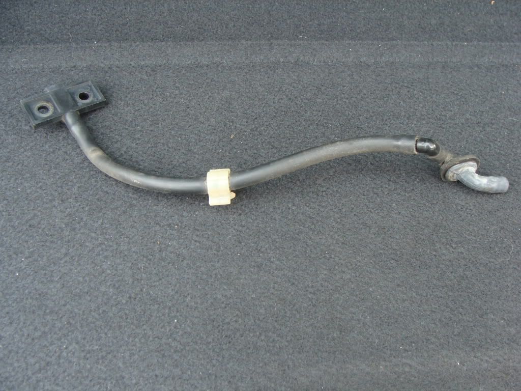

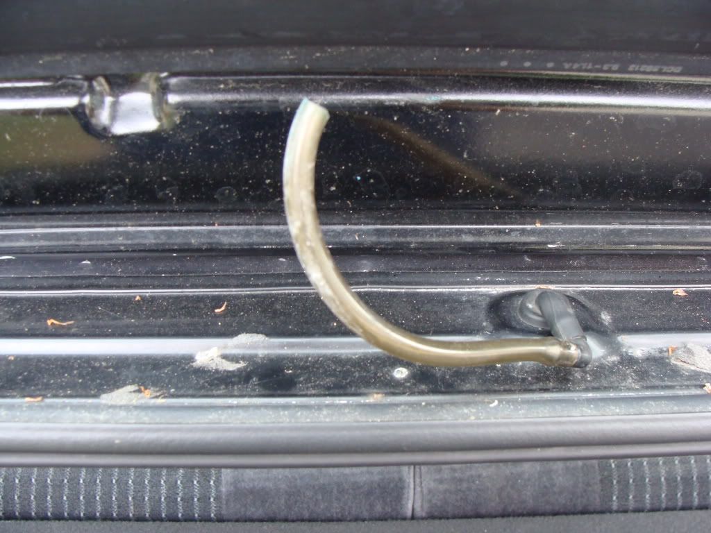

Last week I went to the junkyard and picked up a clip to hold the windshield washer fluid hose for the hood that I was missing and also got this hose with the nozzle at the end. Now when I spray washer fluid in the rear it doesn't keep dripping after
Before:
After:

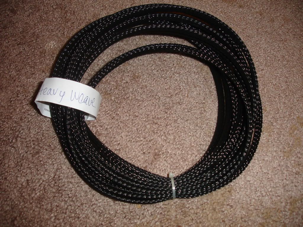

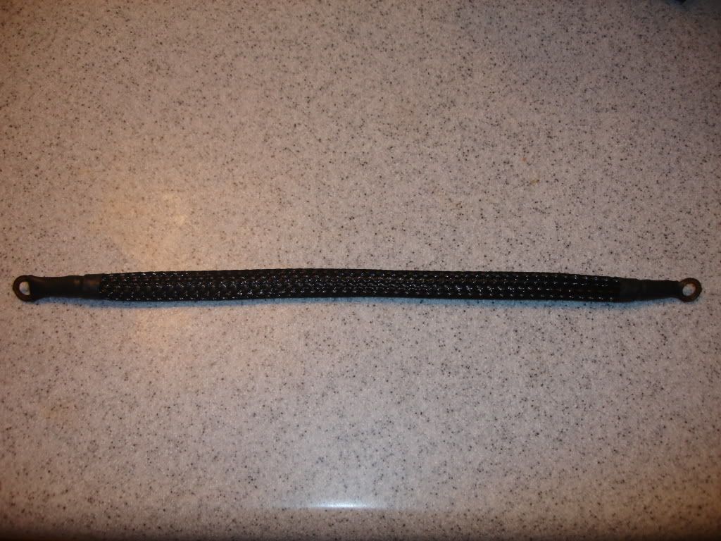

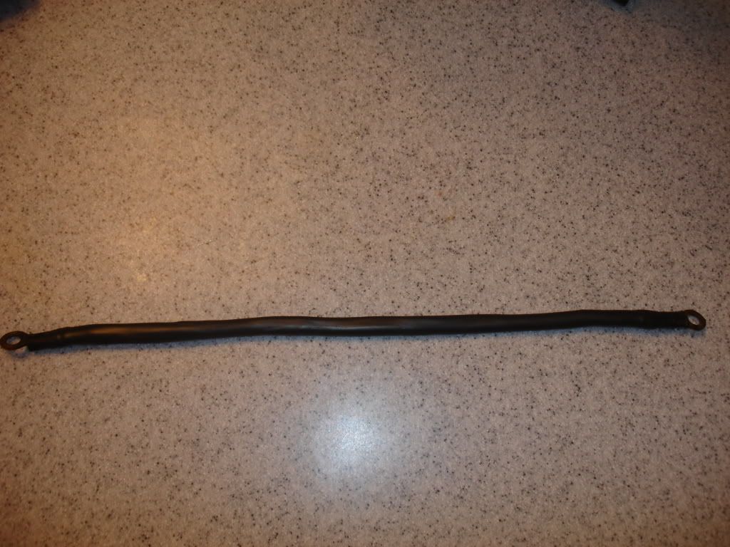

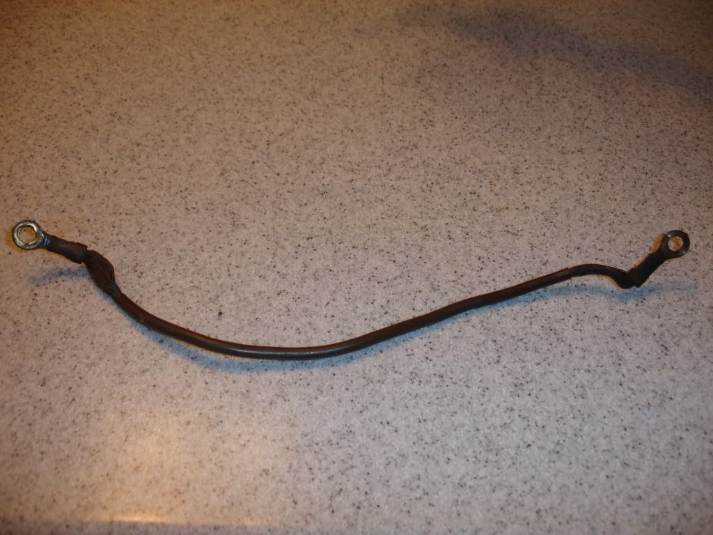

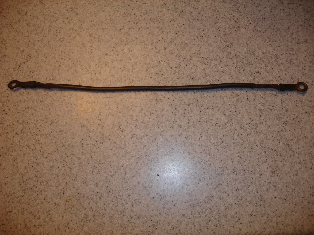

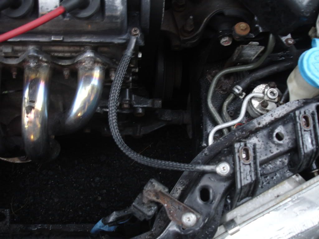

It rained all day so I just chilled and worked on my ground cable. Too bad I couldn't find a heat gun locally so I used a lighter. Did the trick but I'll get a heat gun for the next time. It came out decent though.
Started like this:
Then I straightened it out:
Heat shrink tubed it, it could of been tighter but I didn't want to burn it:
Sleeved it and added a piece of tubing on each end, once again, not real tight either:
Final result:
Not bad IMO! I'll re do it when I get better at it. That's it for this week folks

that ground looks worlds better i like that. where did you get the shink and tubing? i gonna get in on this too
