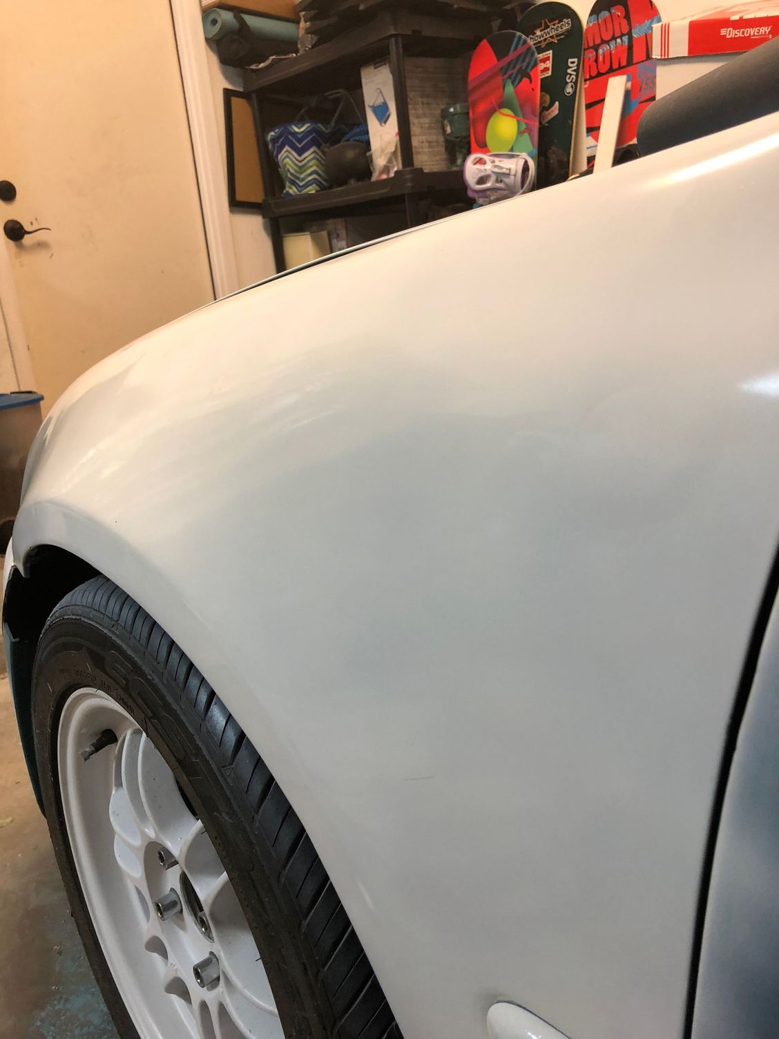

https://cimg6.ibsrv.net/gimg/honda-t...9a2de8d26.jpegTest painted the fender. Rattle can white. I think this will do. Also note the piece MIA off the bumper. This will stay. I can always paint a replacement easily.
Only concern with the “spray bomb” is the lack of UV longevity. But I can’t pass up a $20 paint job. And this thing will be garaged most of the time with my primary vehicle. Perks of a company daily! Going to need to re sand a few areas and lay high build primer. But this will work for a while.

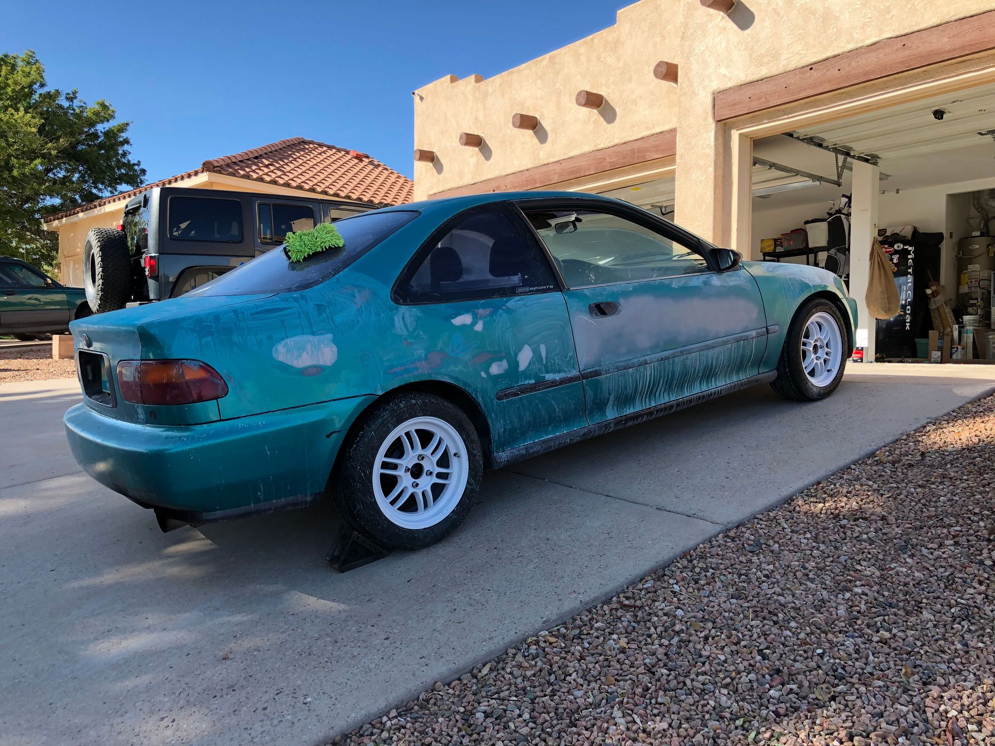

https://cimg5.ibsrv.net/gimg/honda-t...4eb5b4b25.jpegNeed sanding and primer... again
Been working the body a lot more recently. That test fender opened my eyes a little on minimizing sanding and blending within sandable primer. Re working the test fender itself opened up my eyes to oil based paints biggest drawback of never really drying. Pruning over exposed “cracks” of paint clashed between the primer and white paint underneath. Easiest removal without gumming sand paper was to heat it up with a heat gun and, for lack of a better description, smear it off. Fun. So glad I didn’t do the rest of the car! Not that i still wouldn’t think about it completely, just feel like I’ve personally have too much elbow grease into this already to risk having to strip it all over again. So for now, rattle can is out.

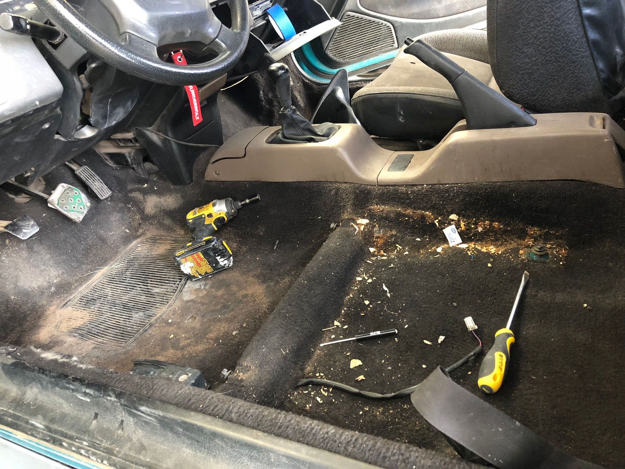

https://cimg7.ibsrv.net/gimg/honda-t...cbc58fa25.jpegGross
https://cimg1.ibsrv.net/gimg/honda-t...97d4b4fe0.jpegPretty bad too

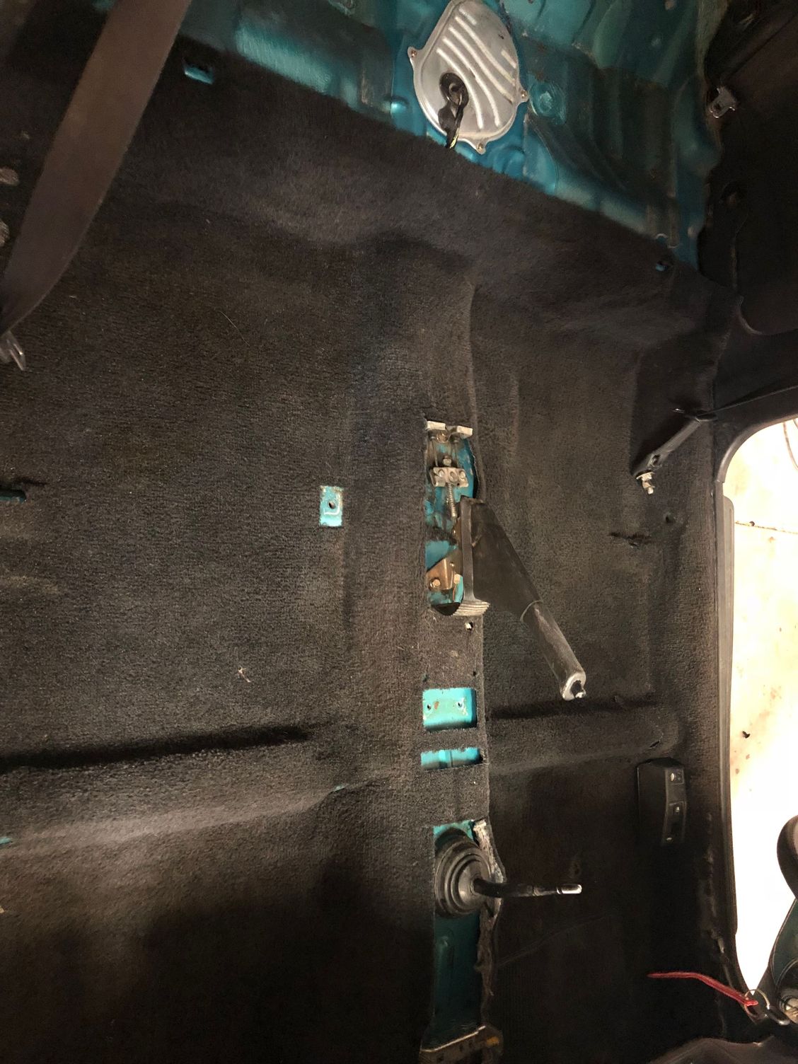

https://cimg0.ibsrv.net/gimg/honda-t...31222f687.jpegFreshened up the carpet well enough for me. Took a few days for everything to dry after a good pressure wash. It’s been cold in Albuquerque

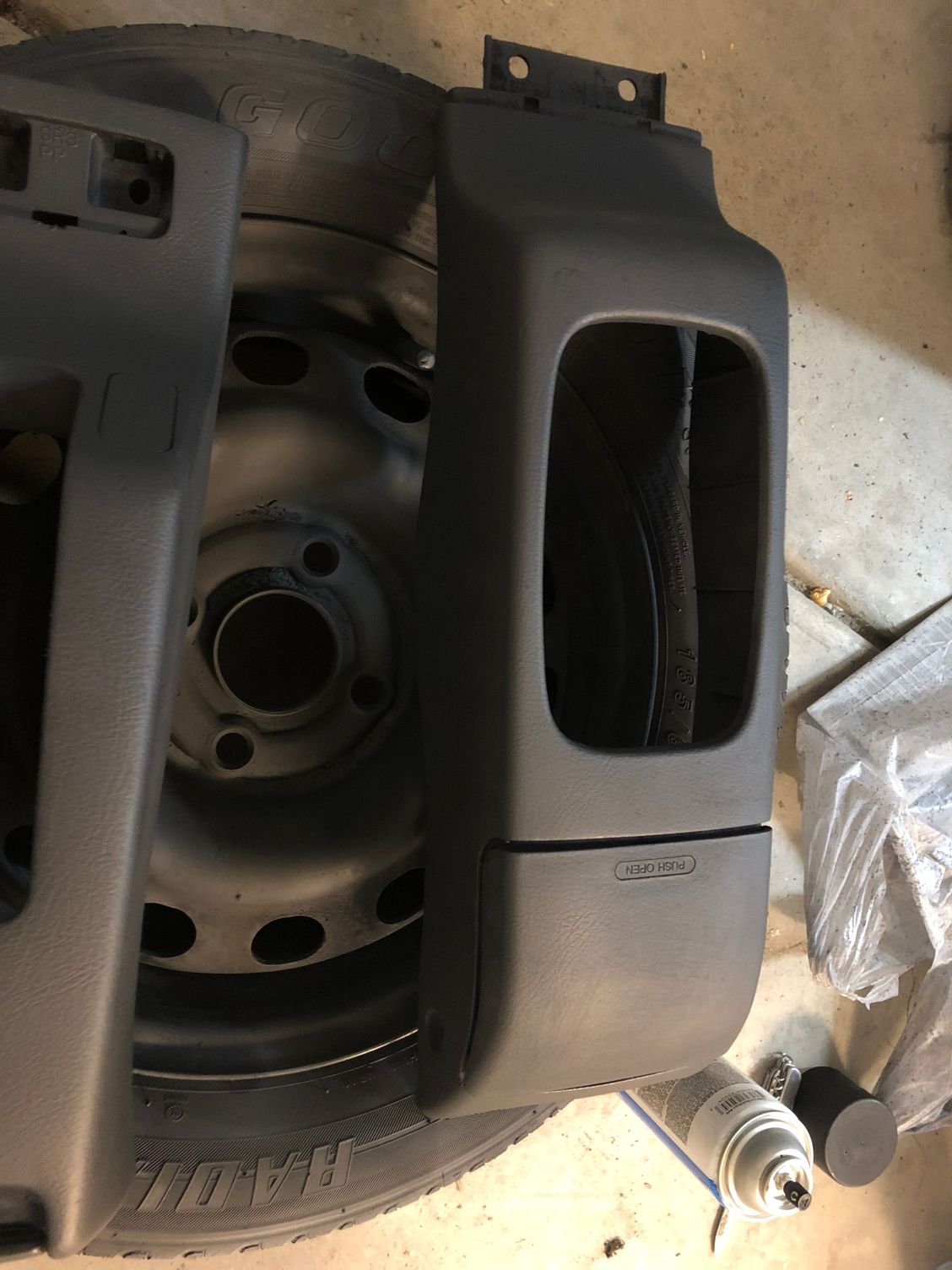

https://cimg3.ibsrv.net/gimg/honda-t...26d69c993.jpeg

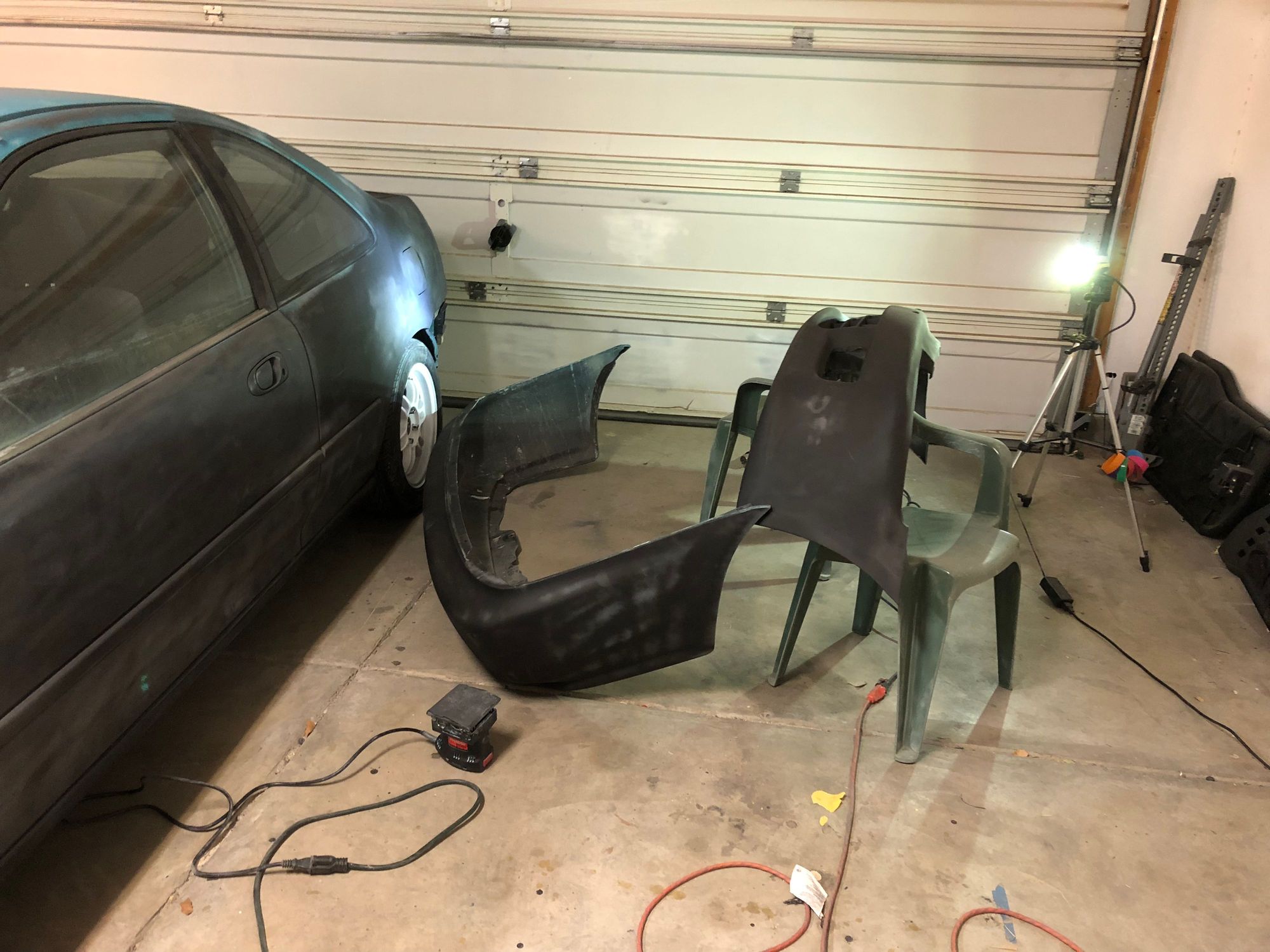

https://cimg9.ibsrv.net/gimg/honda-t...85567a33c.jpegPicked up a little steam today. Sanding down the primer I just layed. Whole car will be done and ready for paint tomorrow.
https://cimg4.ibsrv.net/gimg/honda-t...edfe416fa.jpegBumpers will be done too. Home stretch
