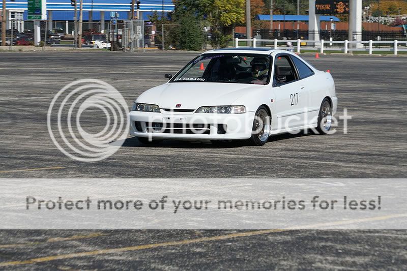

Thanks for the compliments. It also drags, shows, and auto-x's too:

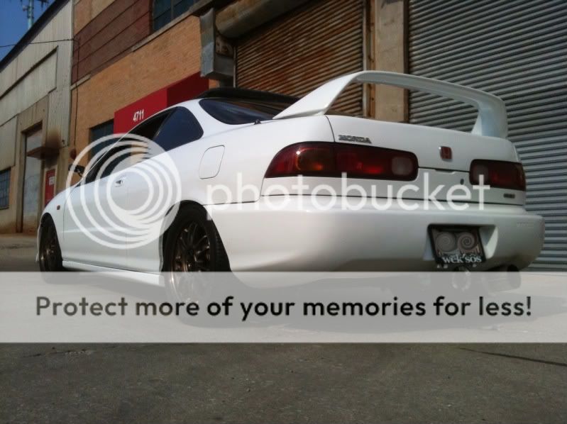

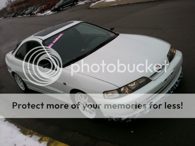

Updates:
Blew the motor at 11lbs. of boost Nov. of 08. The car was down for almost a yr. Finally saved enough for the rebuild and got it back on the road late Oct. of 09 w/ some upgrades.
Here how it sits as of today:
More to come in a couple of weeks...it never ends.

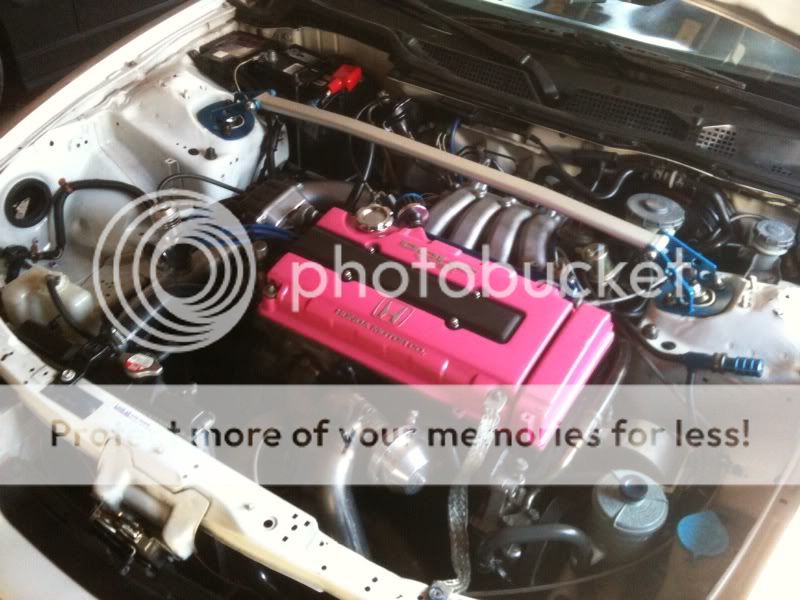

whats the motor rebuild?
Old Mar 22, 2010 | 06:08 AM
  #39
gsl_05's Avatar
Posts: 1,059
From: Tornado Alley, IL, USA
Default Re: My "Uncle Ben's" DC2 rebuild
Manley standard bore 81.5mm 9:1 piston set
Eagle H Beam Connecting Rods for Honda B18c
ACL Bearings
Bore, hone, jet wash
Cylinder head 3 angle
Honda/Acura Head Stud
Cometic B Series head gasket
NGK 7 Heat range plugs
ITR Oil Pump
Honda Water Pump
Honda timing belt
Waiting for the final tune after I install the Skunk2 mani. Right now its putting down close to 300 whp @ 9lbs.

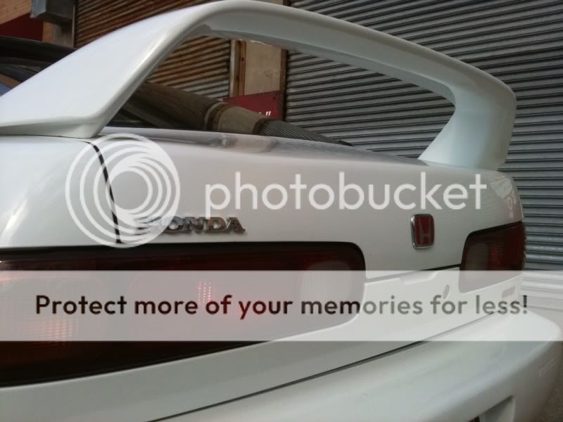

Freshly painted Grand Prix White, ITR spoiler added, shaved moldings, Volk RE30's installed, new badges....
