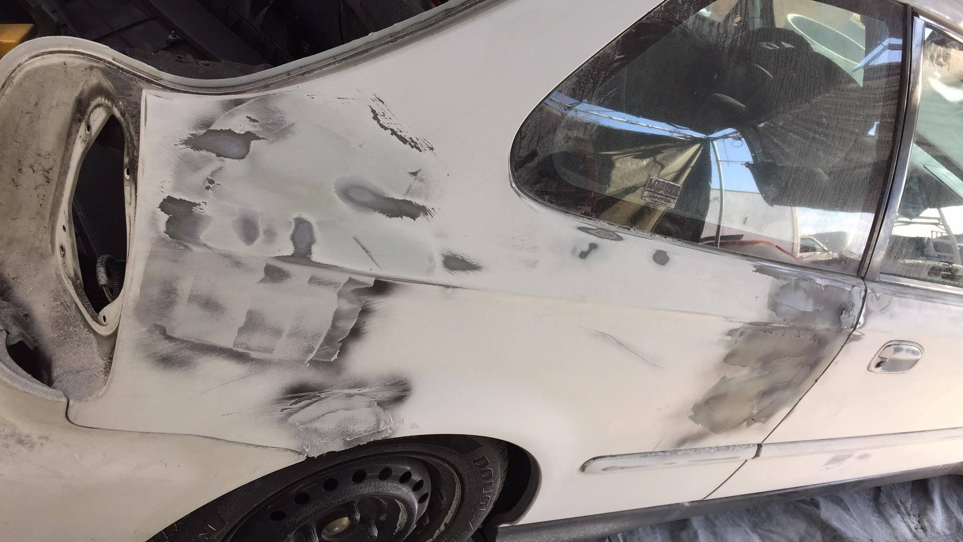

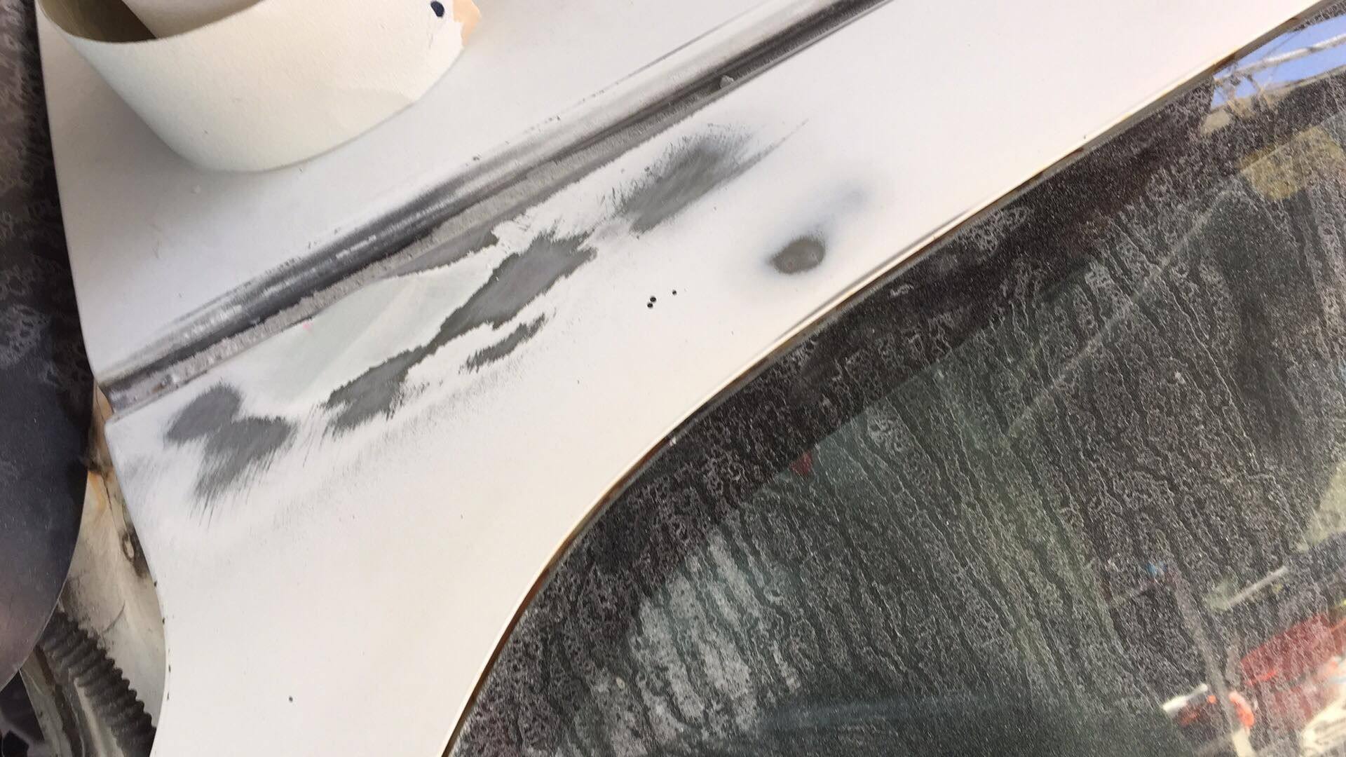

Im at work right now ill come back and add to this about the paint job.
I would recommend the people who did my civic but they were not all that honest with me, I was going to take my car to TJ there's this guy who has good reviews and does real good work for cheap! he quoted me $600 for a 2 stage and quick turn around. But allot of people including me are iffy with taking it to T.J but he offers to meet you at the border near a Wal-Mart or something and can take the car in and back out when its done. I know he does good work cause he always posting his add in the JDM parts page and the work looks solid! I think T.J or this guy is your answer, if I had to do it over again I would of let him paint it in T.J. The price is right with him! or the other option Macco! I had my Red GSR painted there for like 900 I think wasn't that much and it was a real nice job they did, of course the prices have gone up since almost 10 years ago but they are legit and somewhat affordable! but I would just take it to the guy Oscar in T.J! here's his ADD,

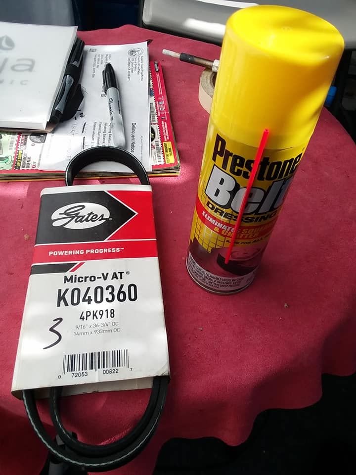

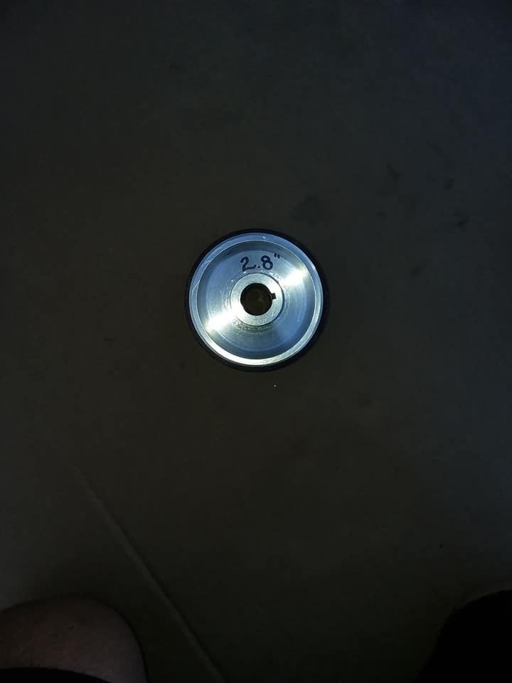

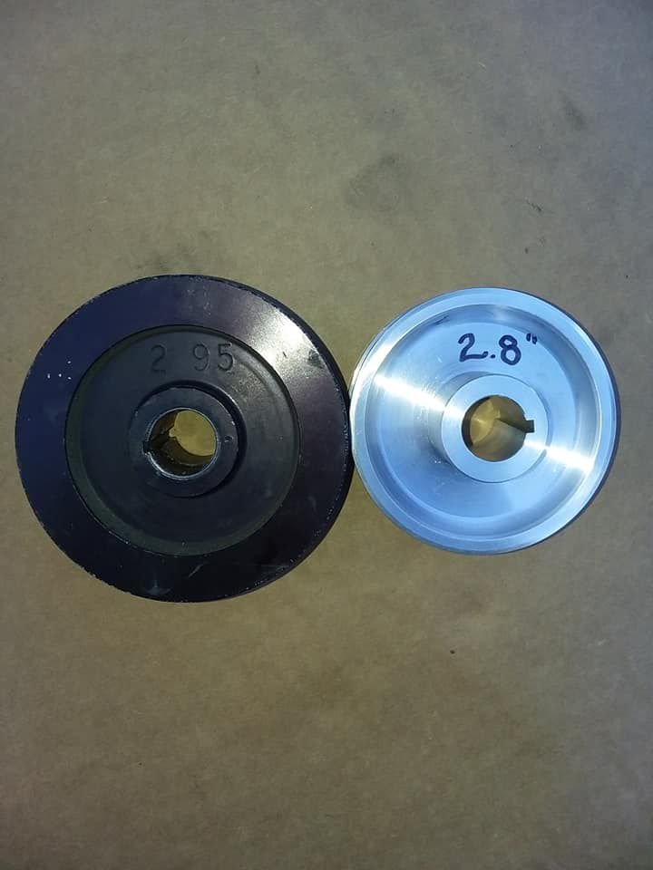

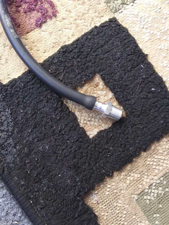

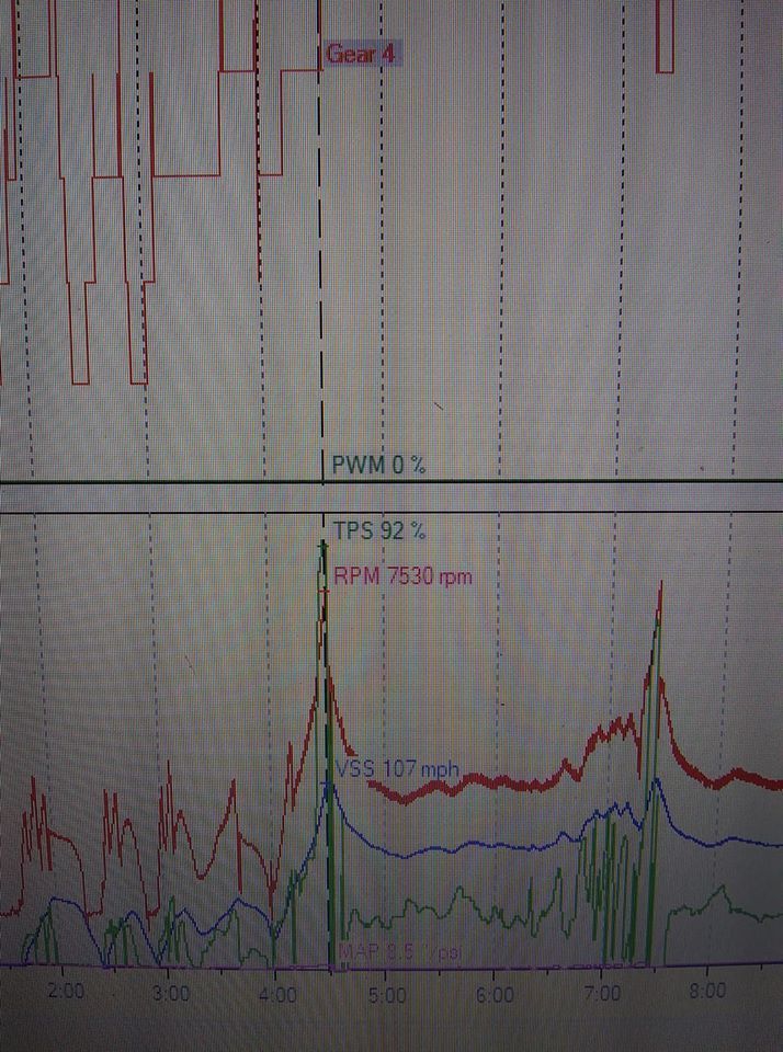

Originally Posted by wunfstgsr
Soooo got the new pulley on and I guess I was expecting a few psi UP TOP but actually it gave me about 1.5 to 2 psi around mid range which makes sense because it wasn't a big drop from 2.95' to the new 2.8' pulley and it is still making the 8.5psi about a few hundred RPM earlier now. I will have to check my datalogs but when my redline was at around 8300 it made 8.5psi now at 7950 rpm it makes the 8.5psi which feels a little better as I step on it and get into boost. I kind of want to pull the pulley off and get it coated with Griptec its a coating they have micro welded to the pulley to eliminate belt slip, although I don't think the belt is slipping its worth a try. After this im over it going to move on so I can get close to trying to get it dyno tuned. I have some suspension things I want to get to then buy a COP kit and get tuned and call it a day.
I grabbed a smaller Gates belt and some belt spray and got the pulley on in about 20 mins.,
Here is the new pulley side by side, it looks much smaller but the next pic ill over lap them to show its not much of a smaller pulley.
Here you can see it on top of the old pulley,

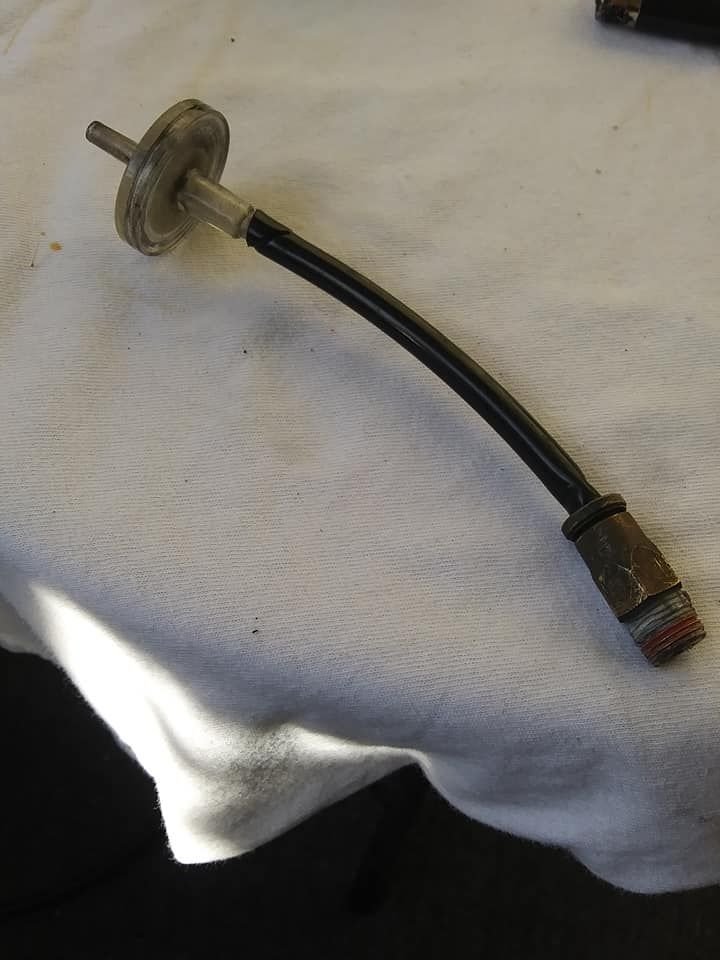

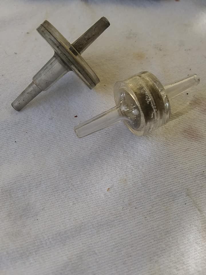

Ok im back with a few good updates! so I noticed I had compressor surge from 3k to 3,500 rpm! I could hear the surge rushing out the blower fliter. So I inspected the vac line to my Procharger surge valve and found some interesting stuff. I guess a long time ago I think when I first got the kit I had a HKS BOV and it came with these vac line filters, well my dumb *** had 2 of them in between the vac line! and they were pretty much clogged! I replaced the fitting as well as the line and BOOM I freed up a bunch of power! now its making 10.2 PSI and I have not reached the redline I set at 7800 rpm, Im going to raise my Redline to 8,000 RPM because the blower is still safe at that RPM and im going to see what it makes at 8k rpm. But so far the car feels much more responsive! I reaaly like how it feels now! deff has the power it was lagging when I put the new custom 2.8" pulley! the whole time I didn't realize my vacume line was causing major boost leaks as well compressor surge!
Here is the old fitting and line and crappy filters I had on smh,
Here is the new line and fitting, I took a pic of my data log to show its making 10 psi now when before it was at 8 to 8.5psi

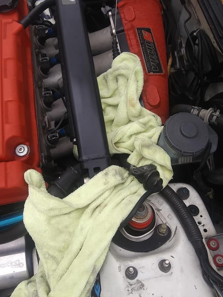

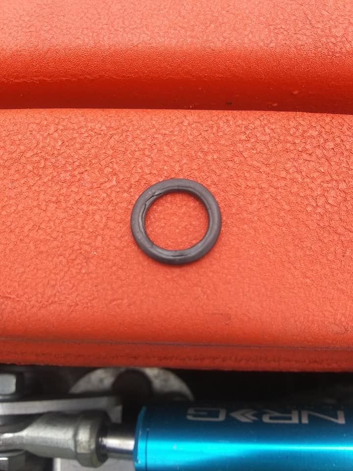

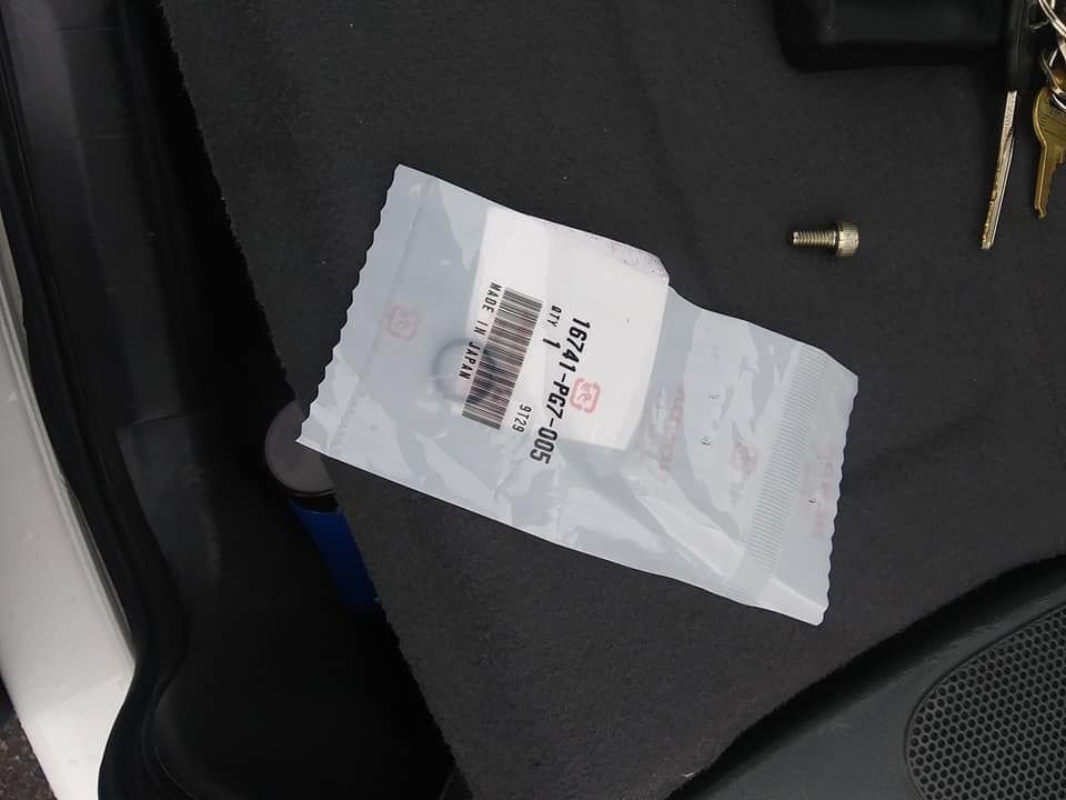

I also noticed my Fuel rail a bit loose~ so I had to take off my FPR and doing that I noticed my O ring was really beet up so I replaced both O rings cause I have a adapter to off set the FPR.

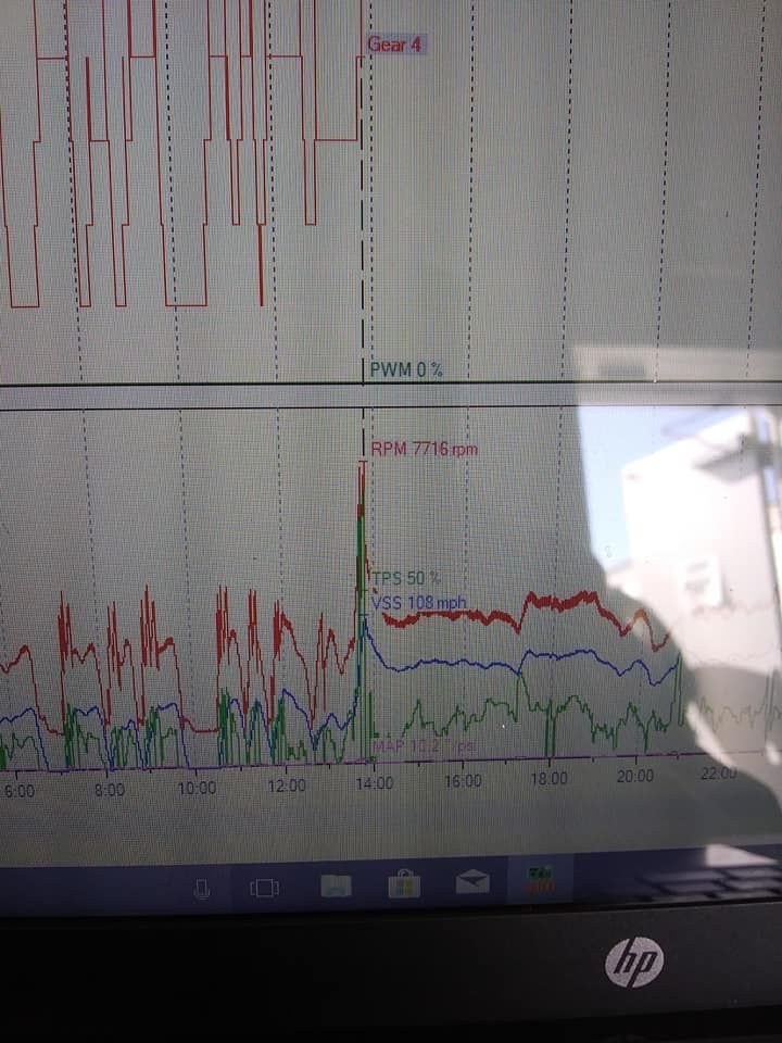

I also realized before when I put the new 2.8" pulley and better Gator brand belt I was testing how much boost it made and on this data log it made 8.5 psi @ 7,530 RPM with TPS at 92%!
Now its making 10.2 psi @ 7,716 RPM but TPS is only at 50% ! I know its going to make much more PSI at WOT! I guess I barely pushed the throttle at 50% and got it to make 10 psi so its got more in her for sure!!

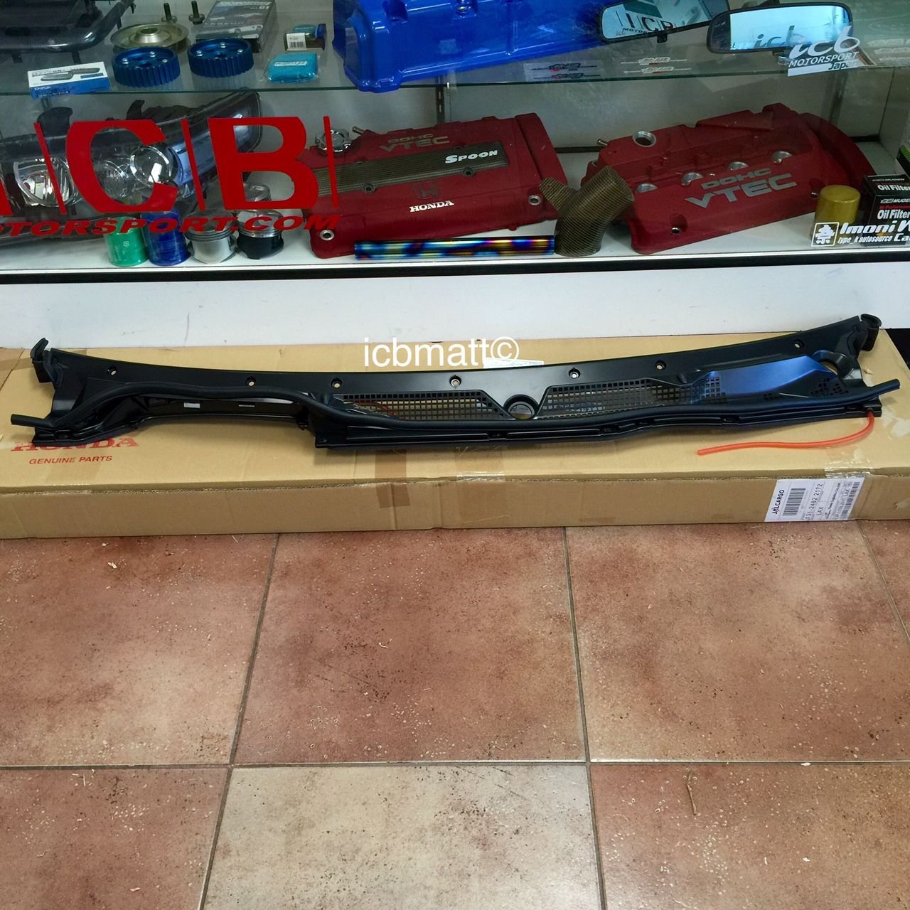

Working on trying to source a OEM window cowl to replace my faded one! it looks so bad and really makes the car look old.
