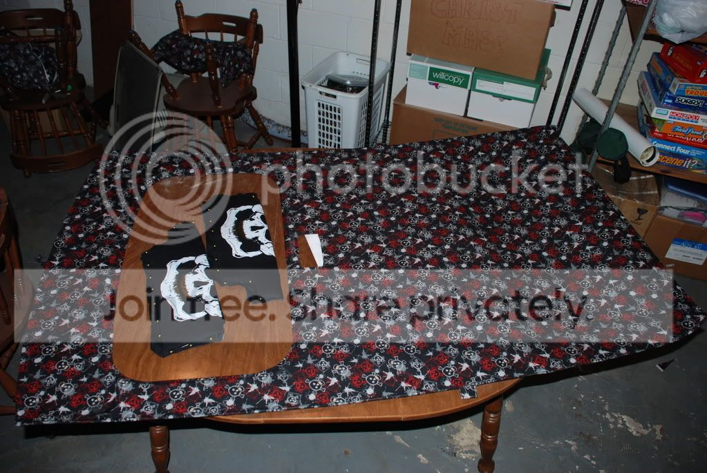

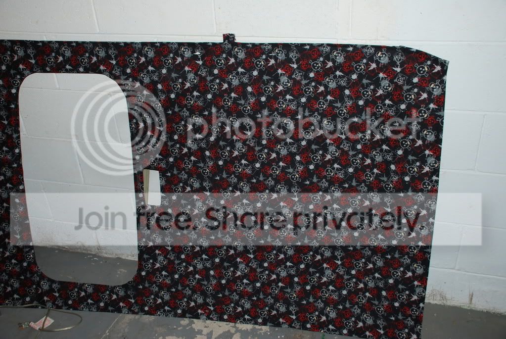

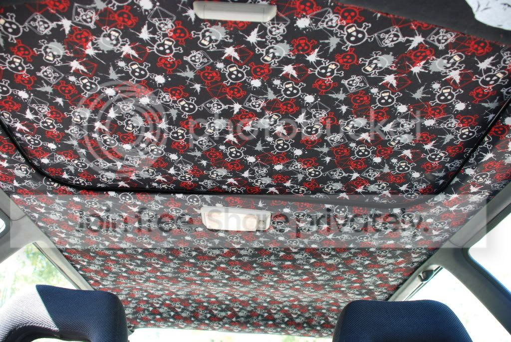

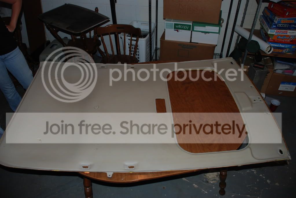

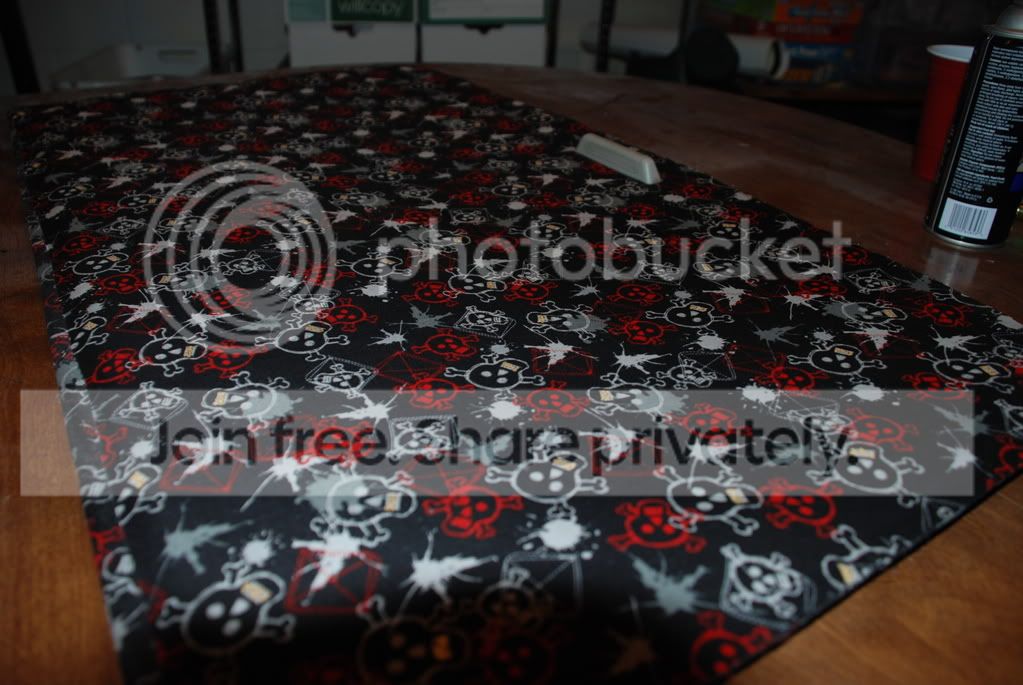

my headliner job....
before..
and now...
my sunroof cover..
sun visors.. still being worked on BTW
and together..

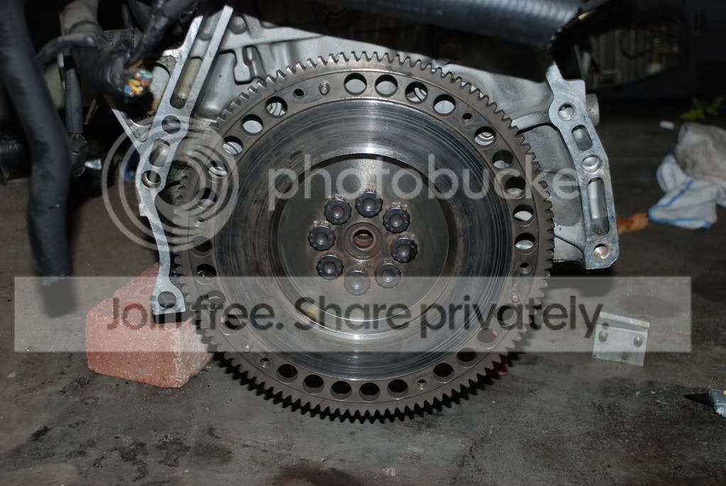

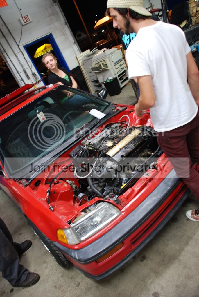

i ended up getting a 8lb fly made by fidanza from a good friend parting out an H2B
h2b plate on
wiring tuck basically done

i ALMOST got that same fabric for my headliner last week
i went with something different
check my build thread here in a few days for my headliner work.
im glad to see it wasnt too thin to work. what adhesive did you use?

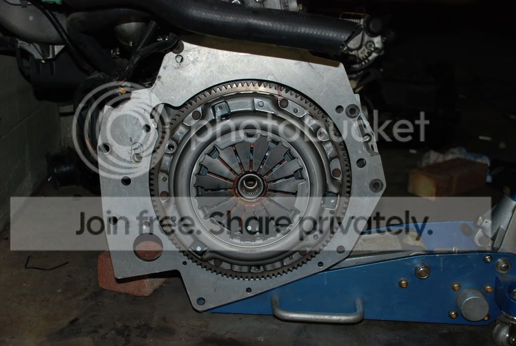

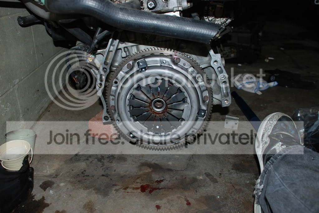

i used the 3m spray and it seems to work really well... as an update my pc is down but the motor is in, car is running but im having throw out bearing problems.. i think the bearing has came off the fork so im pulling the motor AGAIN... ill have a bigger post with pictures of everything... slacking on updates here sry

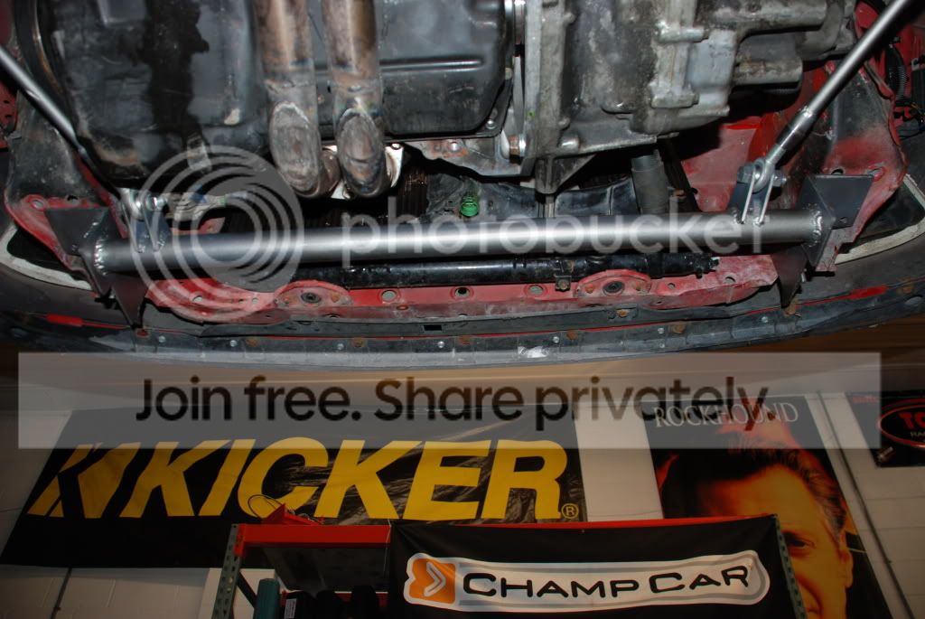

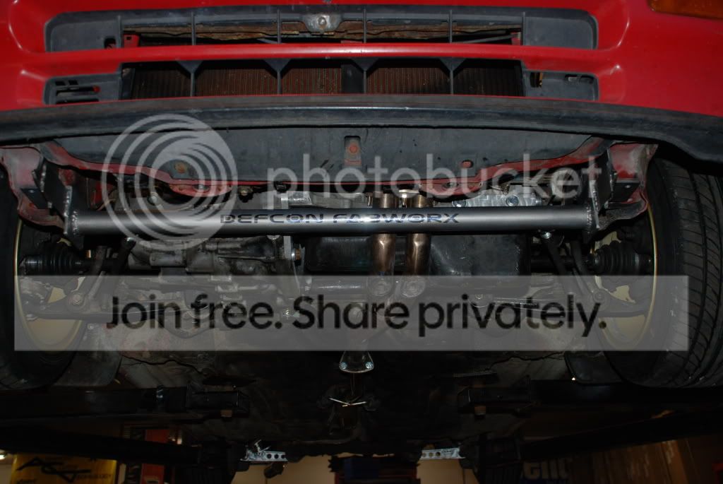

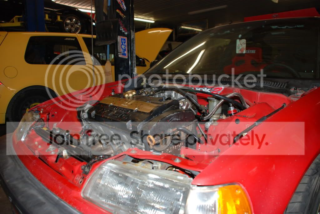

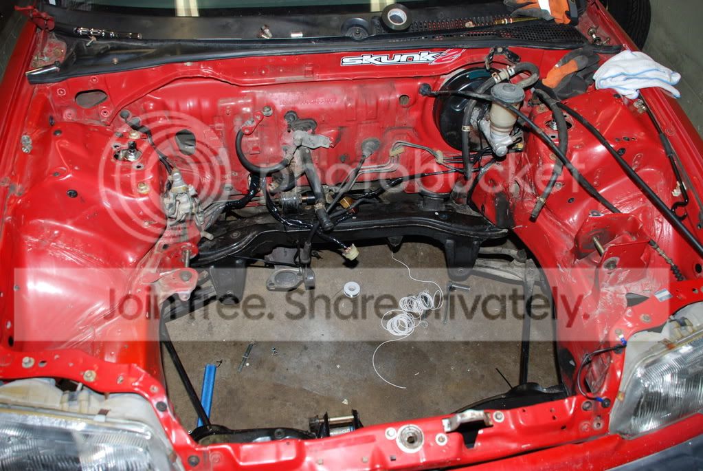

so i had to haul the car out to my friends shop to finish the work and have some things changed and look into my shift problems..
he made me a new bracket for the engine mount to try and help the motor sit a little better (which it did). also why it was there he fabd up an adjustable trac. bar since using the oem was not an option.
after that was all done we put the car back on the ground and i had read something about the clutch pedal braking at the pedal assemly, sure enough mine was destroyed. pulled the dash etc. pulled the assembly banged it around a little put some good welds on it now the clutch pedal is able to fully do its job..
