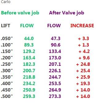

I just finish porting a GSr head. let compar the flow numbers...
Originally Posted by Frankacura
THE VTEC GSR PORTED
Here a stock Si-R pr3 head flow.
Old Jul 2, 2010 | 01:01 PM
  #59
Frankacura's Avatar
Joined: Feb 2009
Posts: 1,180
From: Montréal Qc.
Default Re: B20B P8R nonvtec Ported head flow result
This is the GSr port still ruff 80grit
