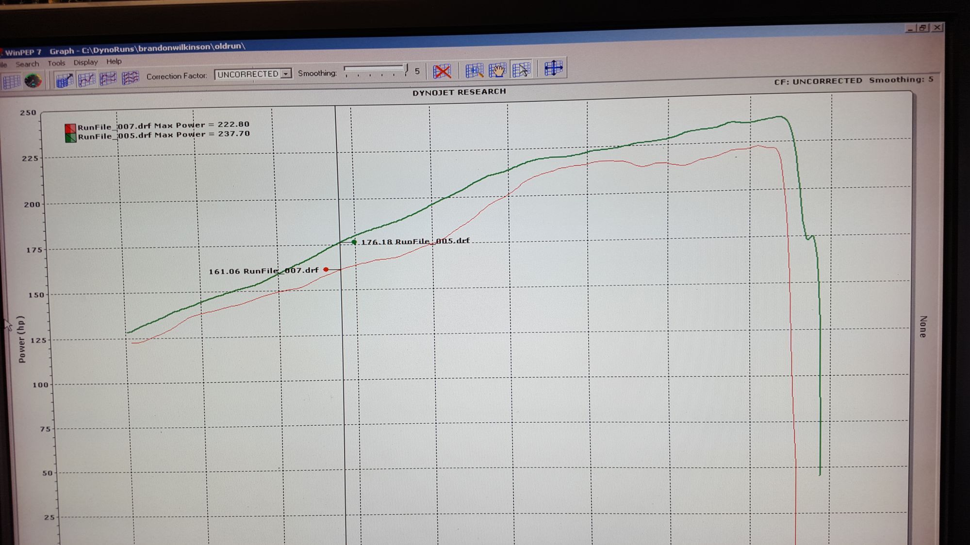

Old Jan 31, 2016 | 03:46 PM
  #44
Wilka's Avatar
Joined: Jun 2011
Posts: 248
From: New Orleans, LA
Default Re: B-Series headers
Said picture of dyno to back up proof.

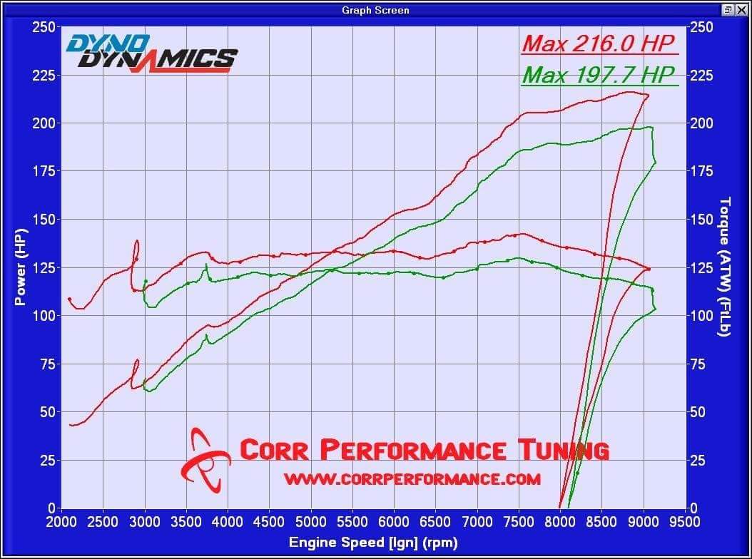

Old Feb 1, 2016 | 08:10 AM
  #48
Wilka's Avatar
Joined: Jun 2011
Posts: 248
I eliminated the dyno variable and used the same dyno as previous owner and put down 197 to his 216 on a dyno dynamics with comparable weather conditions and even had the program take weather out of the equation. The line still speaks for itself in the dip between 5700 and 7000. My PLM had no such characteristics.
Old Feb 1, 2016 | 08:14 AM
  #49
Wilka's Avatar
Joined: Jun 2011
Posts: 248
Dyno graph of
Old Feb 1, 2016 | 08:15 AM
  #50
Wilka's Avatar
Joined: Jun 2011
Posts: 248
Best results of plm vs best results of hytech
