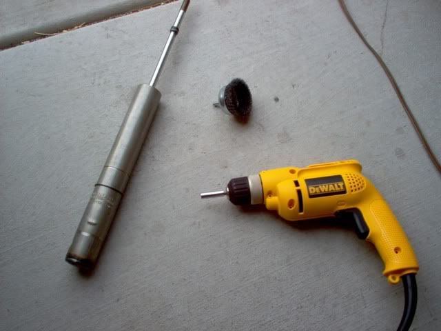

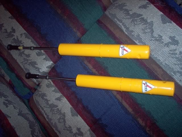

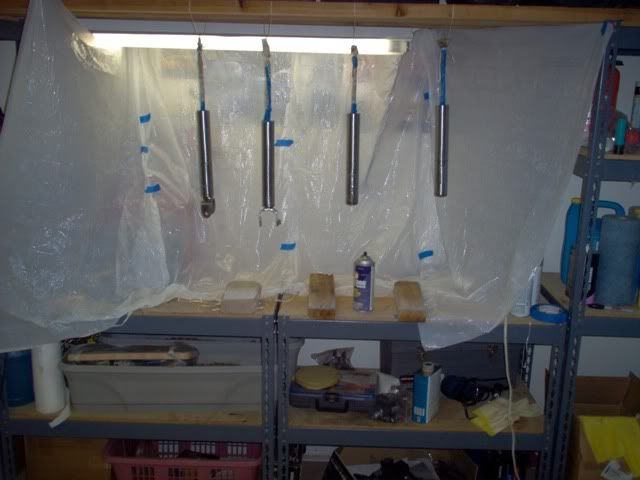

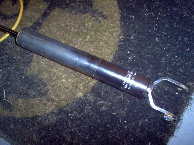

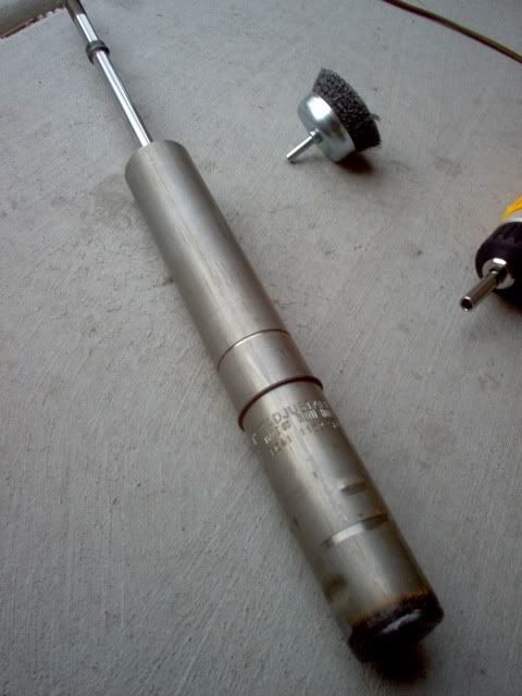

Here is my install on Civic shocks. Notice how the sleeves are small diameter sit right against he shock body.
NEW
Stripped paint:
Wire brushed:
Clear coated:
Assembled:
Installed:
.RJ
