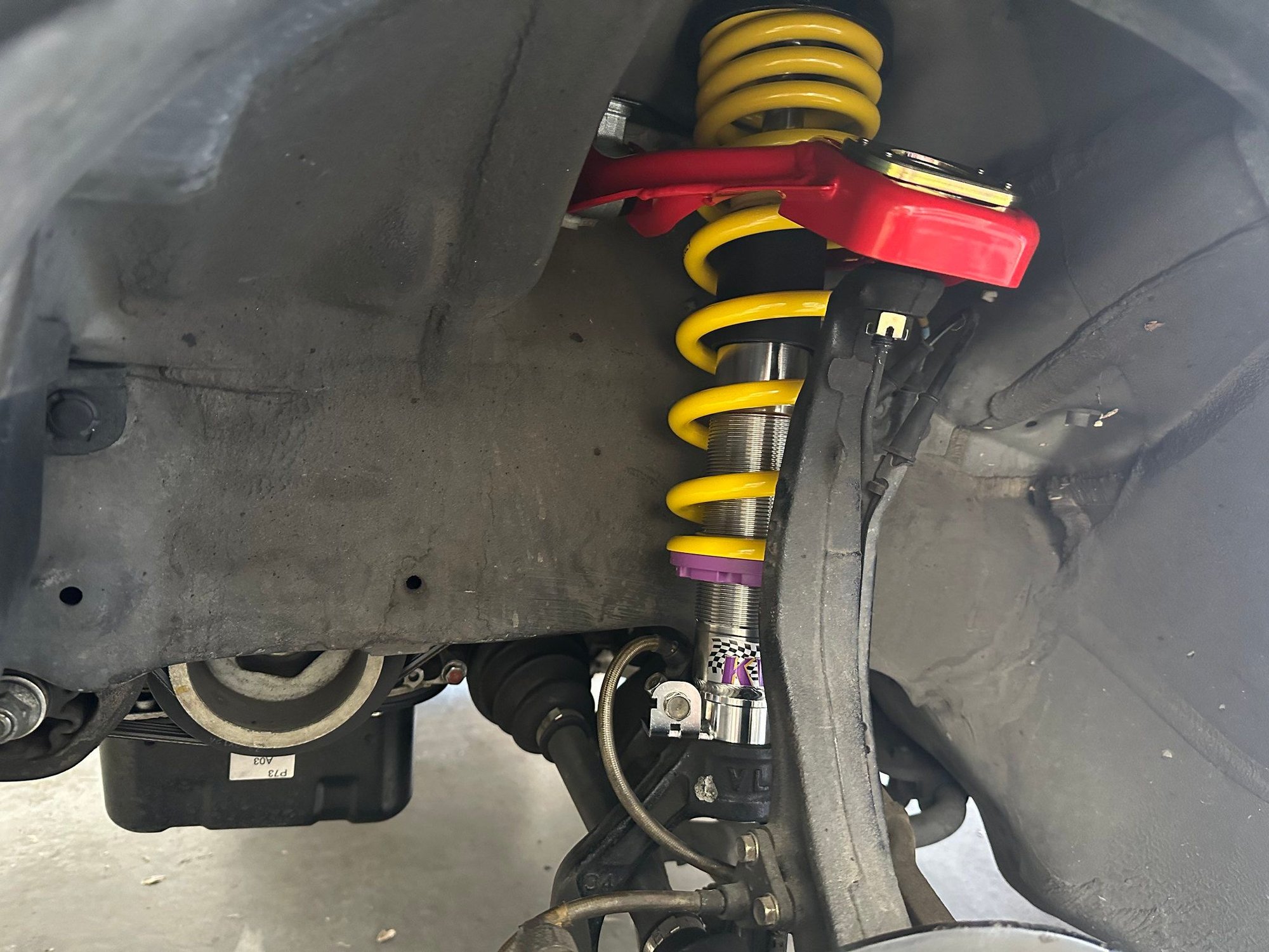

coilover install is going well, lots of work, but the milwaukee m12 makes disassembly a cinch.
one side nearly complete:

oem spring and damper zipped right off:
need some parts from the oem assembly for KWv3s:
assembled:
the controversial skunk2/junk2/skunkpoo:
first time on the ground, just the front is installed, will do rear tomorrow then fine tune the camber and height, not a bad guess for the starting point:

Fine-tuned the front's ride height and camber.
This looked to give me what looks like around -2 degrees of camber. We'll see when I get a custom alignment done.
Just ever so slightly tucks, a parallel finger hits the top of the tire.
It should go 10mm lower when it settles, I'm about 10mm lower than KW recommends.
KW's instructions were very vague, I ended up realizing after I read everything again and connected the dots that I should have put a metal sleeve in place of the one I had to remove from the front upper struct bearing, there is a note at the end of the page about drilling the old one out, that I missed. I did take the old sleeve out since it wouldn't fit otherwise, you don't actually need to drill, just disassemble. So I ended up taking the coils back out to correct that. After all that I felt too worn-out to finish the rear this week, so next week it is. Sucks getting old!

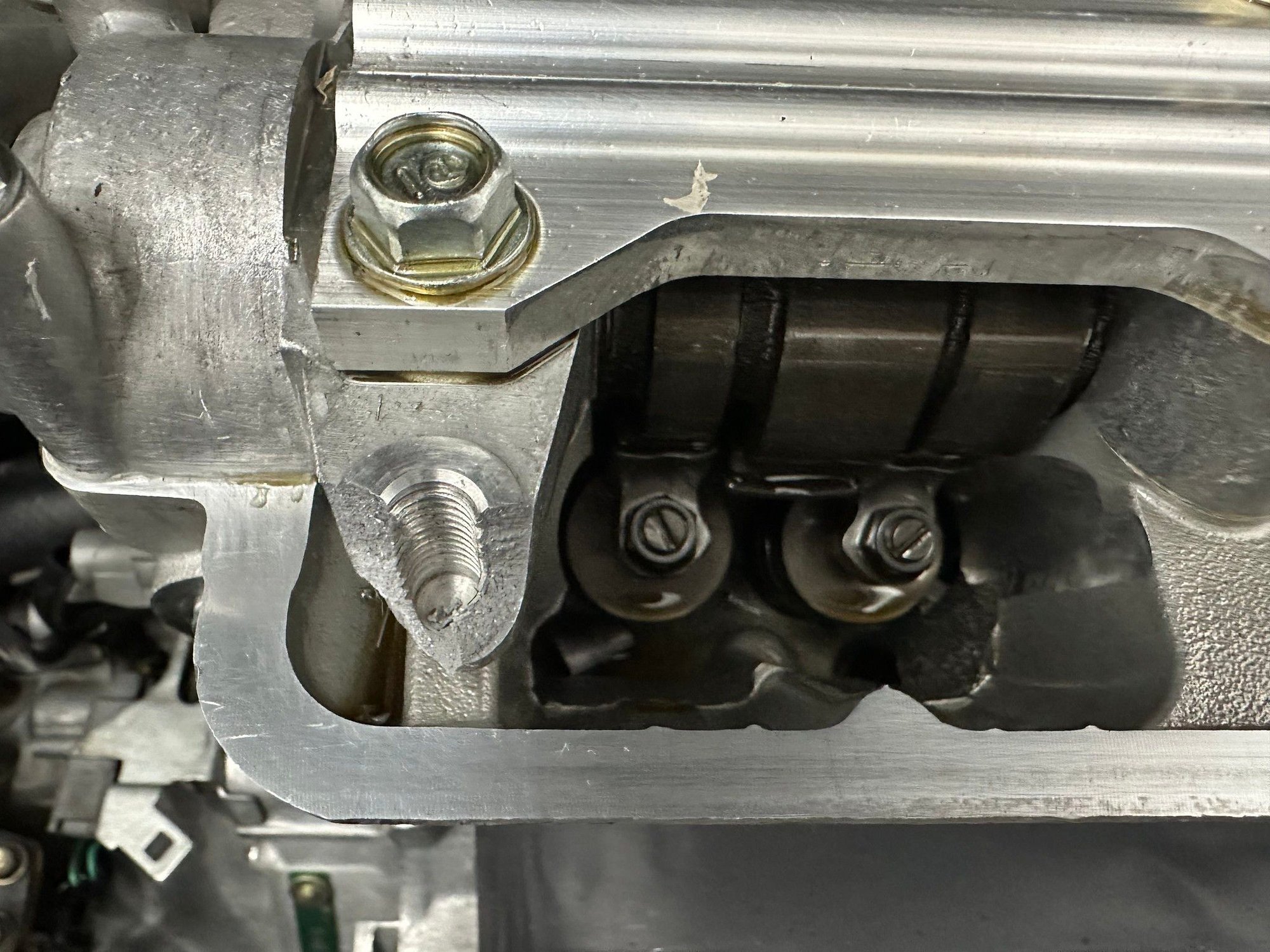

Things were going so well, but then I ran into a setback: one of the head bolt holes stripped, either the install instructions had the incorrect torque spec, the bolt hole was degraded due to age or previous installs, or my torque wrench is wildly out of spec. I think it's an incorrect torque spec, but that's a laymen's estimation.
This is a bolt that connects to an edge cam cap, the one next to the vtec solenoid, E5. Instructions said 20 ft-lbs for torquing the inner and outer bolts to the cam caps and head. You do the inner ones first, which went perfectly, then the outer, which is were disaster struck. Note this step is before the valve cover is installed and the valve cover bolts have a much lower torque spec. The Hayes Repair Manual indicates 20 ft-lbs for the 8mm camshaft holder bolts, which are the inner bolts, but I could not find a torque spec for the outer 8mm bolts in the manaul, I suspect those are 86 in-lbs like the value cover nuts.
Researching a bunch, I'm not going to attempt to fix this myself, but find a shop. Aluminum heads are way too sensitive and deserve precisely calibrated and maintained professional torque wrenches along with skilled professionals. I don't think I'll have the time to properly acquire all the needed knowledge to take off the head, send it to the machine shop, and mainly: install it correctly again first try without messing something else up. I found a spare type-r head to get parts from or use, depending on what the auto shop and/or machine shop recommends. Unfortunately you can't just replace a broken cam cap and send it, it's milled from factory to match the head.
I kept hearing and reading about how careful you need to be with aluminum heads and did my best to hand tighten first, then use the torque wrench, but I'm betting an experience tech would have not have stripped the bolt hole, already having experience and industry knowledge.
What a huge disappointing setback, but I'll get it worked out. While I'm at it, I'll ask about the condition of the cams.

Those specific bolts from Honda are known to be softer than what was sold 10-15 years ago. I think the safe tq spec mentioned in other posts is 16 ft lb but Ive had cam caps off multiple times and used a 3/8 drive wrench and hand tighten by feel with no issues. Theres been more than one instance Ive found those bolts stretched thin at the threads when inspected. What stripped? The threads in the head or did the bolt snap/stretch?

the threads in the bolt hole stripped and it also cracked the cam cap casting at the bolt hole in two places. I was able to easily pull it apart afterwards. Here's the gore:

I warned you and chrisfrom86 warned you junk2 is garbage. I highly doubt you were able to crack that in two spots as you described with an oem bolt and if it was already cracked that piece would have been in your valve train. That junk2 bolt probably wasn’t manufactured within the proper tolerance.
When you do the head do not use those cams. They appear scorched.
