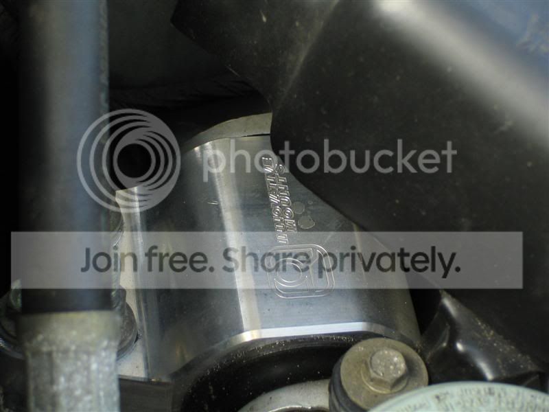

I got the 75A the black ones and i don't think they're bad at all. But i have only installed two of the three mounts so far. I plan on installing the third this weekend.
With the two mounts so far there is a noticeable differece; lot better feel, more vibrations but in my opinion its not bad at all. Better feel for the road and it also feels alot better when shifting as well. As far as the car vibrating the steering wheel does shake more now and its very noticeable with the A/C on and also when the A/C is on the rearview mirror and the side mirrors do shake/vibrate.
Quality and fitment is superb.
Ill try and get you a short vid of what its like in the car if you'd like.
Dave - there is huge difference from when the car is on the sand and on asphalt.
Oh yea, not sure if it matters but this is on my LS, but do plan on getting a set for the R as well. You could also try asking Keith (Rizen) i believe he ordered the 85A for his turbo R, but just not sure if he has gotten around to installing it yet.

To be installed:
On the car:
And as a comparison,
I've sat in Neo_'s car, he has the hasport ones with the Jim Fab lower torque mounts and his car has a bit more vibration.
Rob's R (Bbasso), all Jim Fab mounts, and his will take out your fillings. So i guess these are definetly a step up from stock, but nowhere near as ridiculous as Rob's car.
Ali
