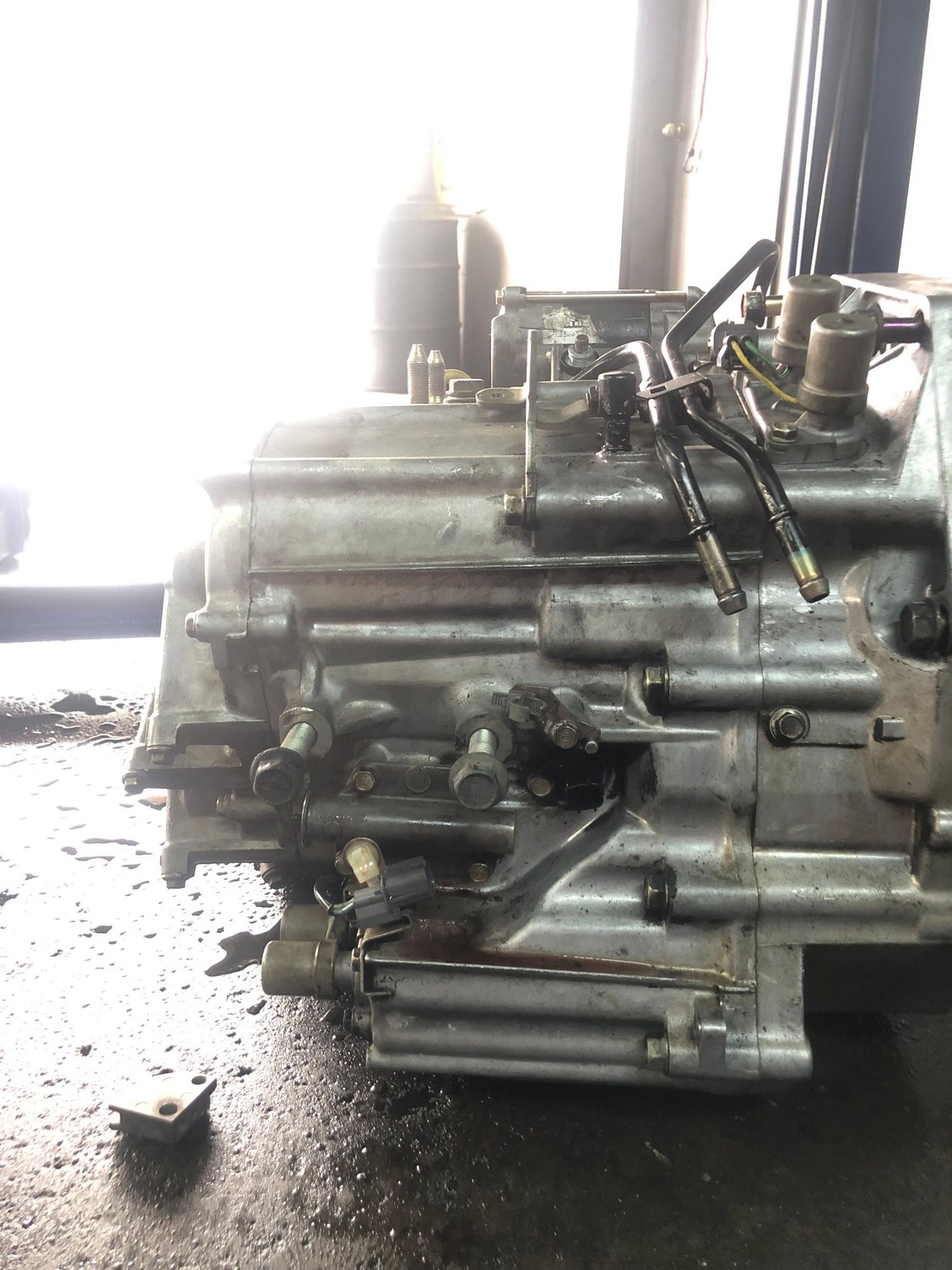

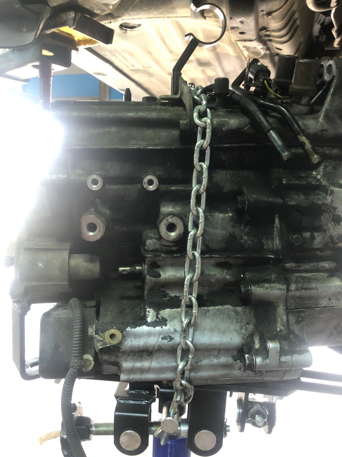

I’m doing a swap on a 94 integra ls transmission
And I’m putting a 99 integra ls transmission, in my 94
but when I took out my 94 transmission it wasn’t the same, and i thought 94 to 99 transmission fit on the integra
This is the 94 integra Ls transmission I’m trying to figure out what the pin is called. And does anyone know what tire of transmission this is ?? Came off a B18B1
This is the 99 integra Ls Transmission If you look at the other picture, there’s that one thing, that is different, what is it ?

It appears that I answered late in your other thread... and since the transmissions DO NOT match... the '99 tranny will NOT work in your '94 car.

No. They function differently. The early transmission has a kick-down cable for downshifting and the newer transmission downshifting is controlled by computer and solenoids.
