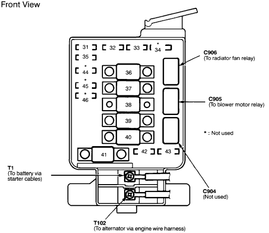

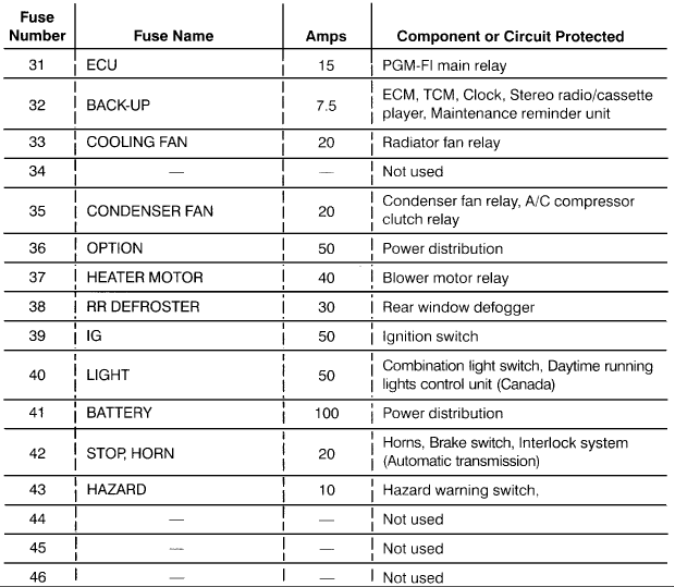

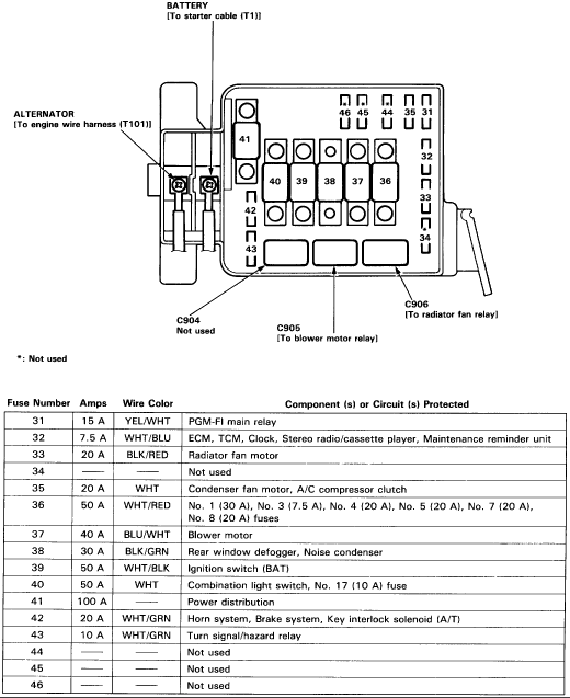

try the 50amp fuse under the hood..in that fuse box... , you need to get a phillips head screw drive to remove it..
this recently happned to my friends integra. and it was that fuse that controls the clock windows etc..
that should help there
possibly the power dist fuse.
EDIT: Wrong fuse picture that was for a 95gsr..
heres the right one:
