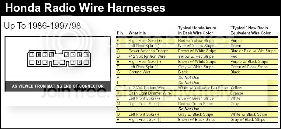

Hi guys, im installing a deck.. I need the stock wiring diagram for the color code / where they go. If anyone would happen to have a link to the diagram it would help alot. thanks

i know it's in my helms manual, but that's at my cousins since he decided to borrow it and not give it back. lol it's pretty basic..all hondas are pretty much the same. here's what i found on the net. it was a pdf file, so i made it into a jpg.
i highly suggest you get a wiring harness just to plug up though. my friend *ahem* thought it'd be cool to save some bucks and do a hack job. it ended up being a complete headache and i didn't even want to wire it up. lol
sometimes paying a bit more is cheaper than paying extra to fix the mistake
