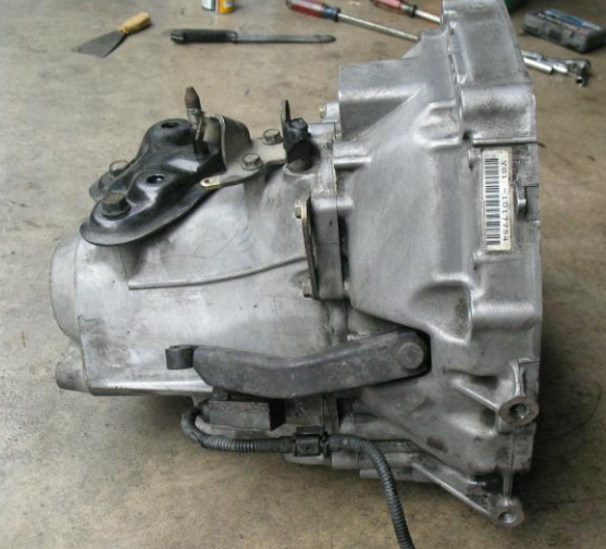

Wooo something I actually know about! Conversion mounts are nice to have but you don't need them. On my 90, I used steel spacer tubes and longer bolts to make the transmission mount taller. The trans mount is two pieces, the image below shows the bottom piece (top of the transmission, left side), which is where I used the longer bolts and spacers to space the mount 1-1/4" off the transmission case. If you don't do this soon, I've read reports that axles fail prematurely due to the angle.
To see what trans you have, JR has some good info above. Take a pic of the front of the transmission. You are looking to see if you have an "arm" down there or a piston. The black piece on the bottom front of the transmission in the below pic is the "arm".
You can also determine what transmission you have by looking for a label, which should be on the flat face with the bolt holes on the right of the transmission (shown below)

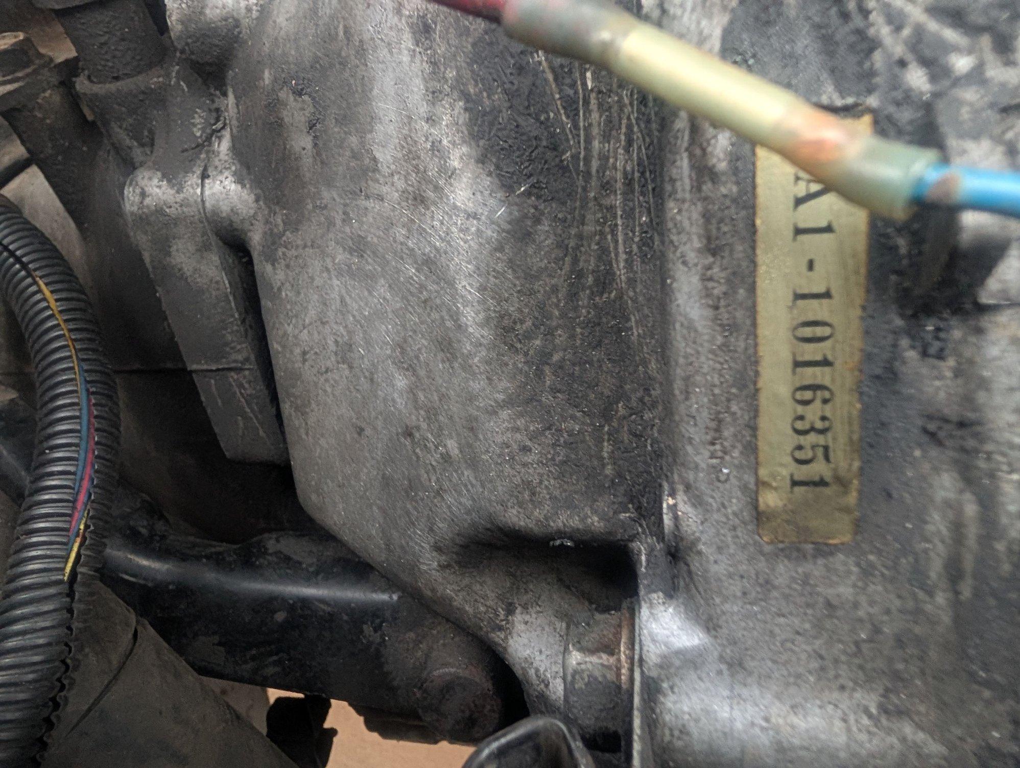

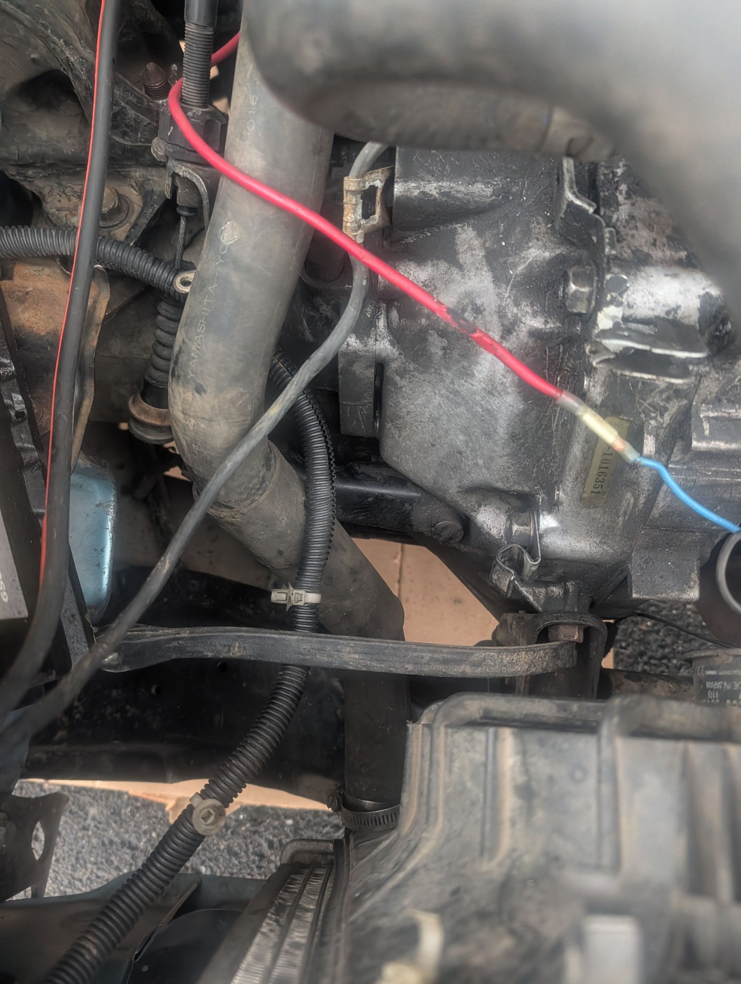

Thank you guys for the information just to update here's a picture of the trans and the vin on it

Yup that seems to be a 90-91 trans. The clutch is different on the 92-93 years.
You can probably support the trans on a jack, take off the mount and space it without having to do much else.
That wiring looks scary.
