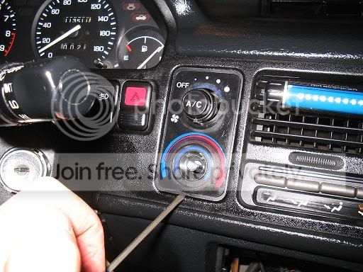

No i am trust me i'm a Blackhawk Mechanic in the Army, being "mechanically inclined" isn't the problem. Ok so i took the two srews out just above the gauge clust then i went under and took the single screws to the left and right of the steering collum. Now the WHOLE thing wants to come out from the vent to the left of the steering wheel where the cruise controll is all the way to the fan strength and cold/heat dail. This is where i am having a problem. Everything is popped out EXCEPT the part by the fan strength selector, cold/heat all the climate controll bottons and what not. I tried gently prying at it with a flat head skrew driving to see if it would "pop" out but to no avail. So, does anyone know how to get it off?

Just stick a flathead under it, if this is the first time, its not going to easy w/ those clips. You just going to have to yank, but make sure to disconnect the sun roof switch from the back, that switch does not pop out like the other 5.

Yeah, on the left side of the interior, that vent, you should be able to pull it out for enough, to disconnect both the power mirrors and the sunroof switch. And then you can yank the thing over the steering wheel, and then you just have the 4 screws holding the cluster in.
