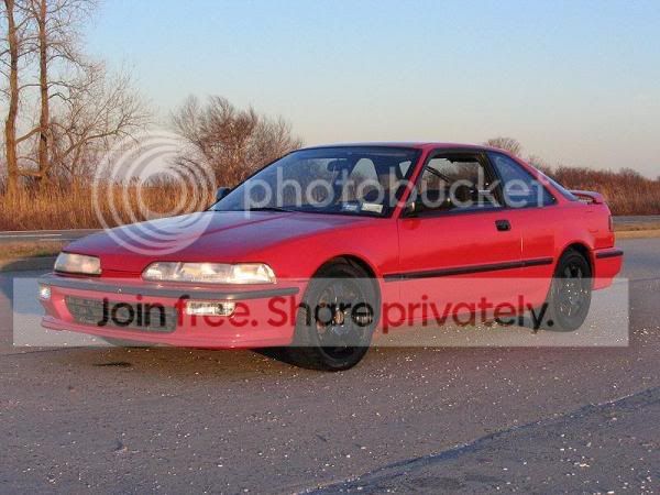

a DA9 is a 90-91 integra and the bumber front bumber looks like this
the DA9 is OBd0 and has a 3 spoke stearing wheel.The seat padern on the seat is diffent to the DA6.DA9 has a S1 tranny and the DA6 has a YS1 tranny caseing but not Ys1 gears also on the 91's the tail lights are 50/50.I'm sure theres a few things i left out but you get the idea.92-93 integra DA6 is better
O and this is the bumber on the 92-93
^^thats my old car it was a 91 with a 93 bumber on it^^
