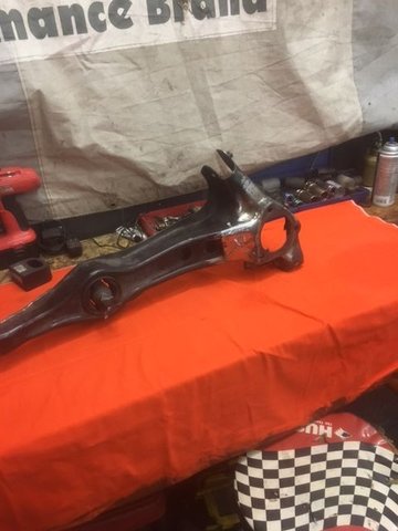

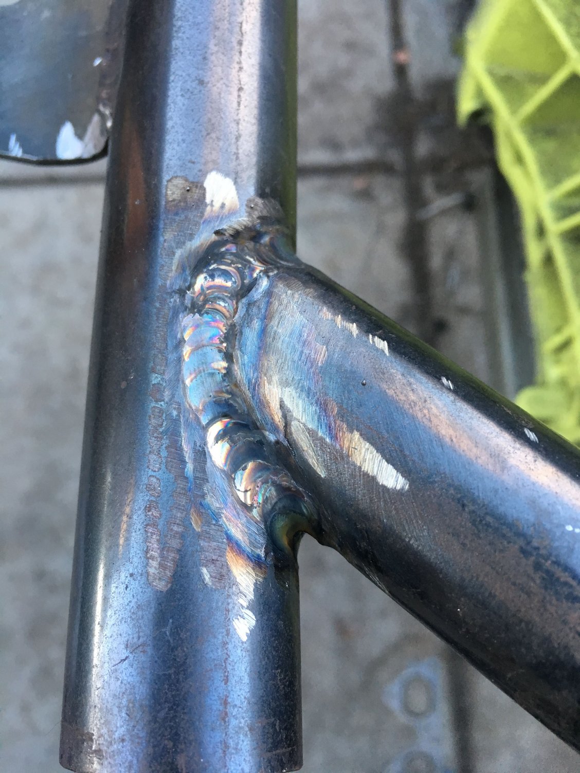

Here is some pictures and progress of my current build, i made the trailing arms buy cutting out the flanges on the crv arms and fabing them and boxing them to the stock trailing arm. tube front end getting mocked up, also boxed in frame rails. 31" intercooler
forward facing mani
old crv arm after the cut
boxed arm
almost finished
test fit.

cage progress

awesome fab work. Keep it up, looking forward to seeing more!!!

hell yeh. keep us up to date, love seeing odd projects that involve custom fabrication.
