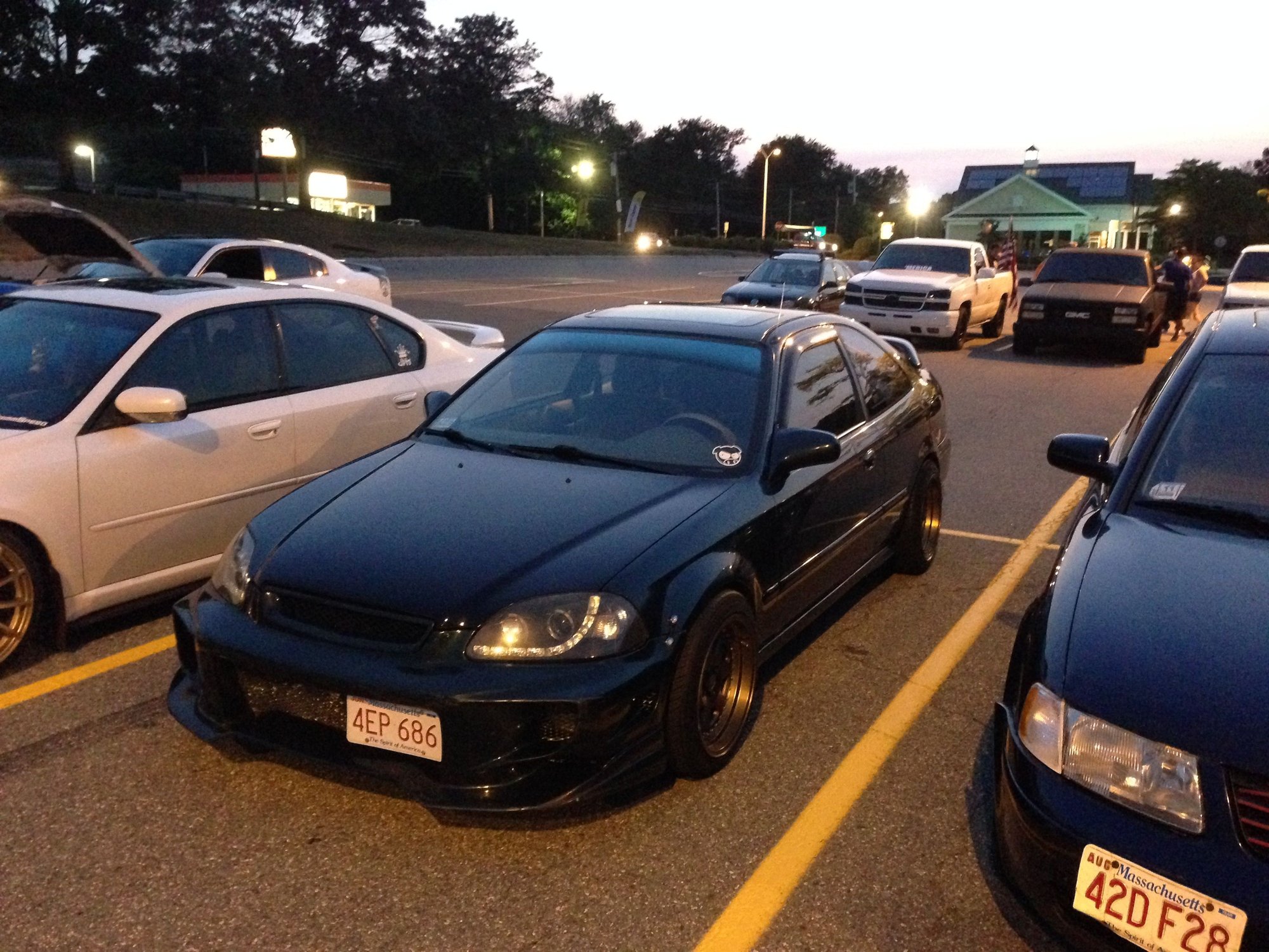

The civ

The civ

First off whats with the ropelighting in the headlights?
