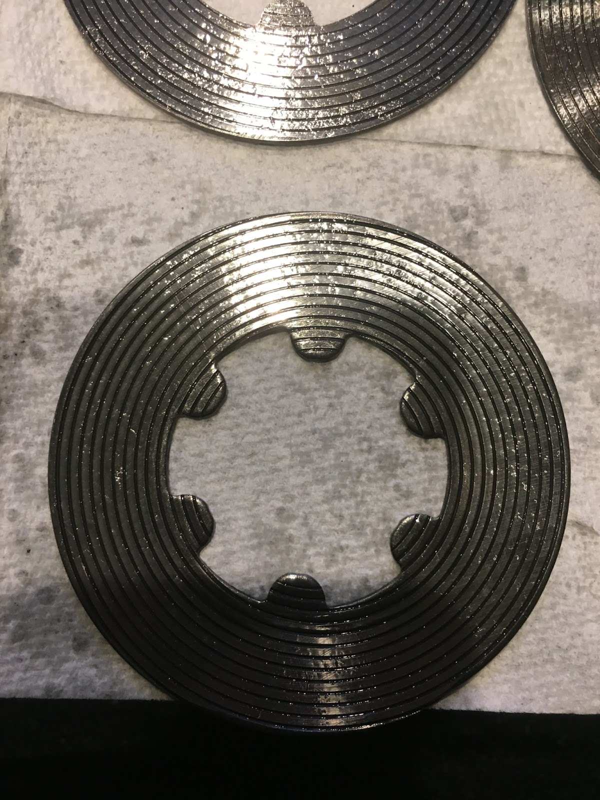

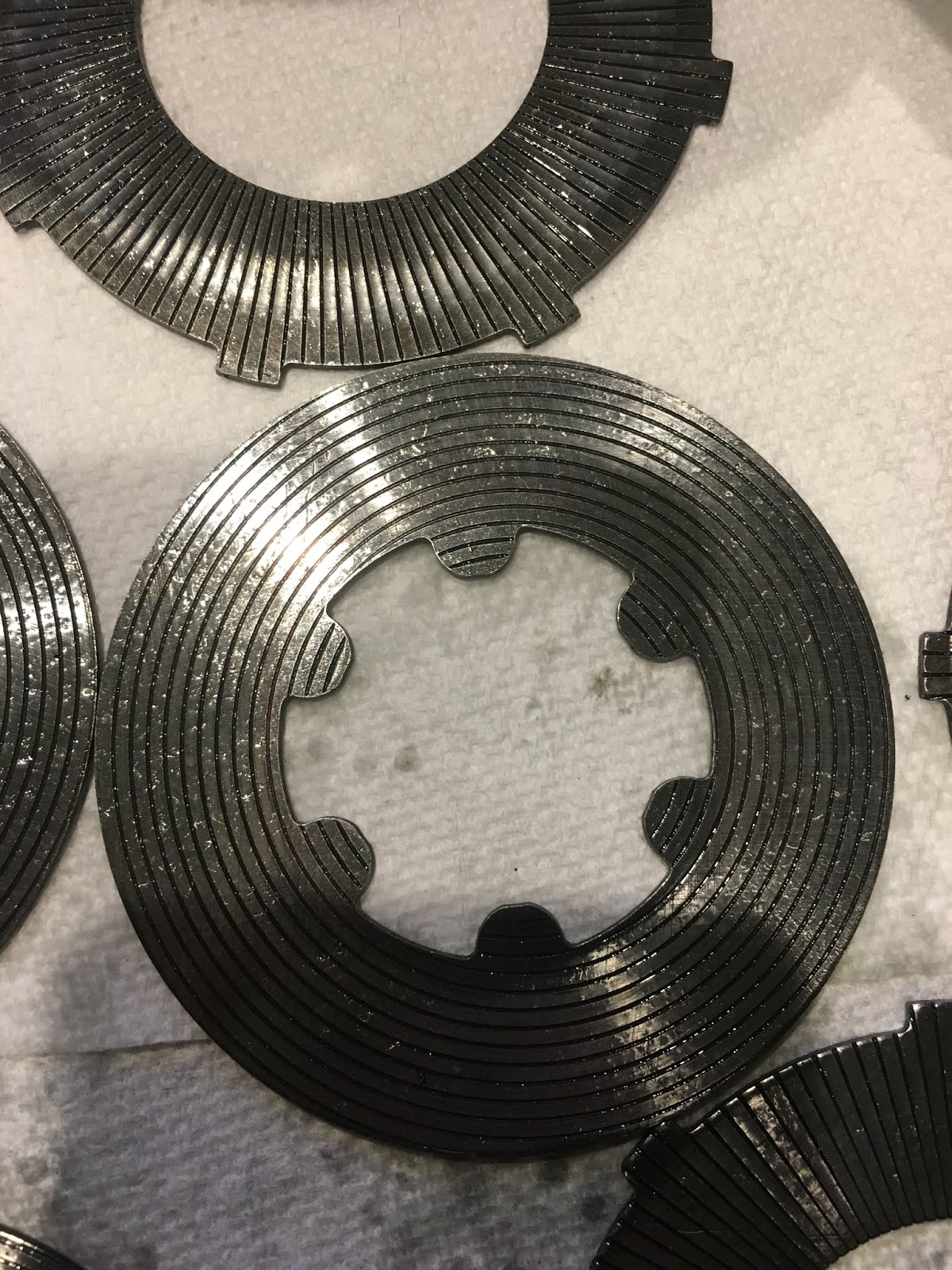

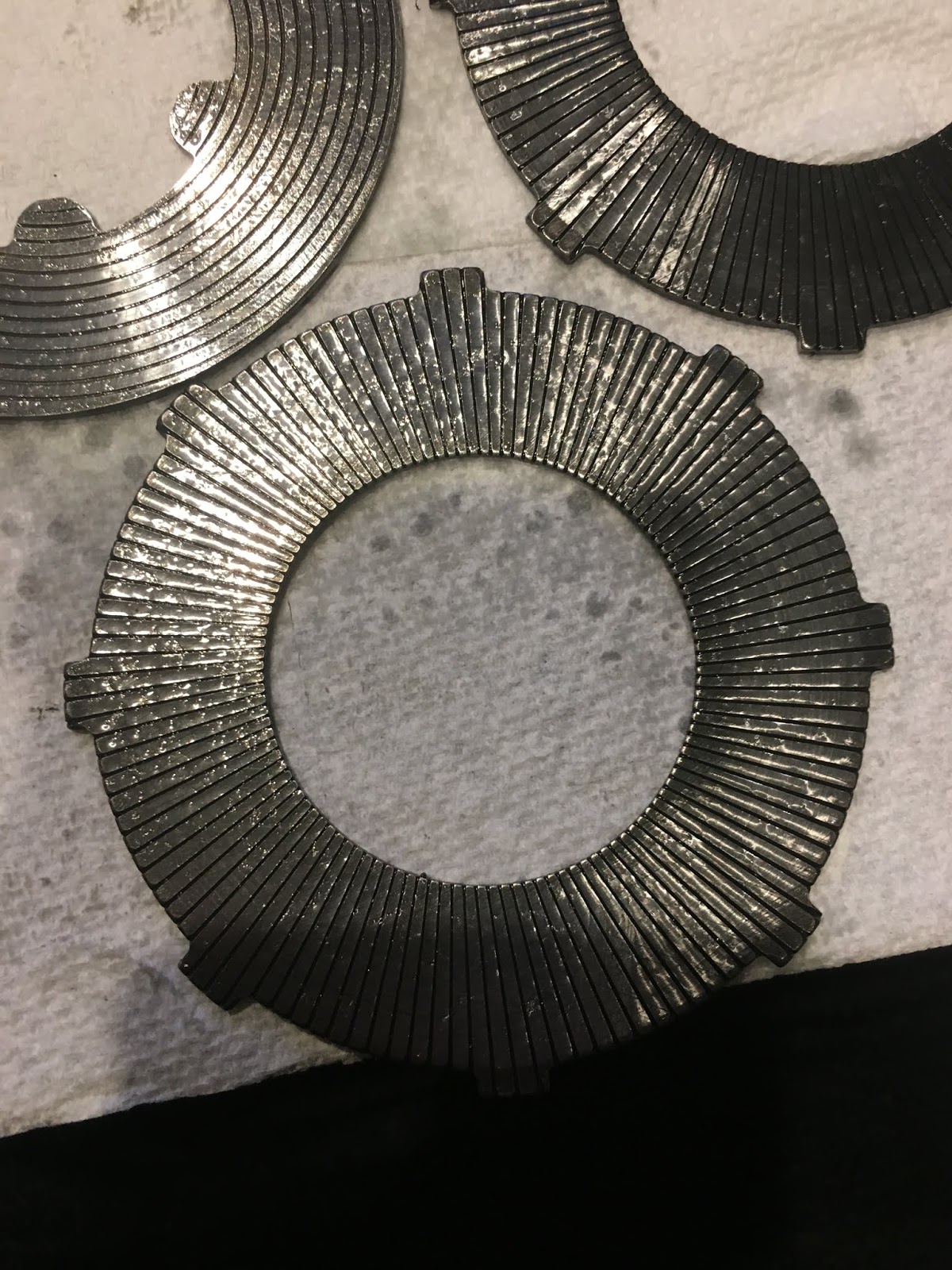

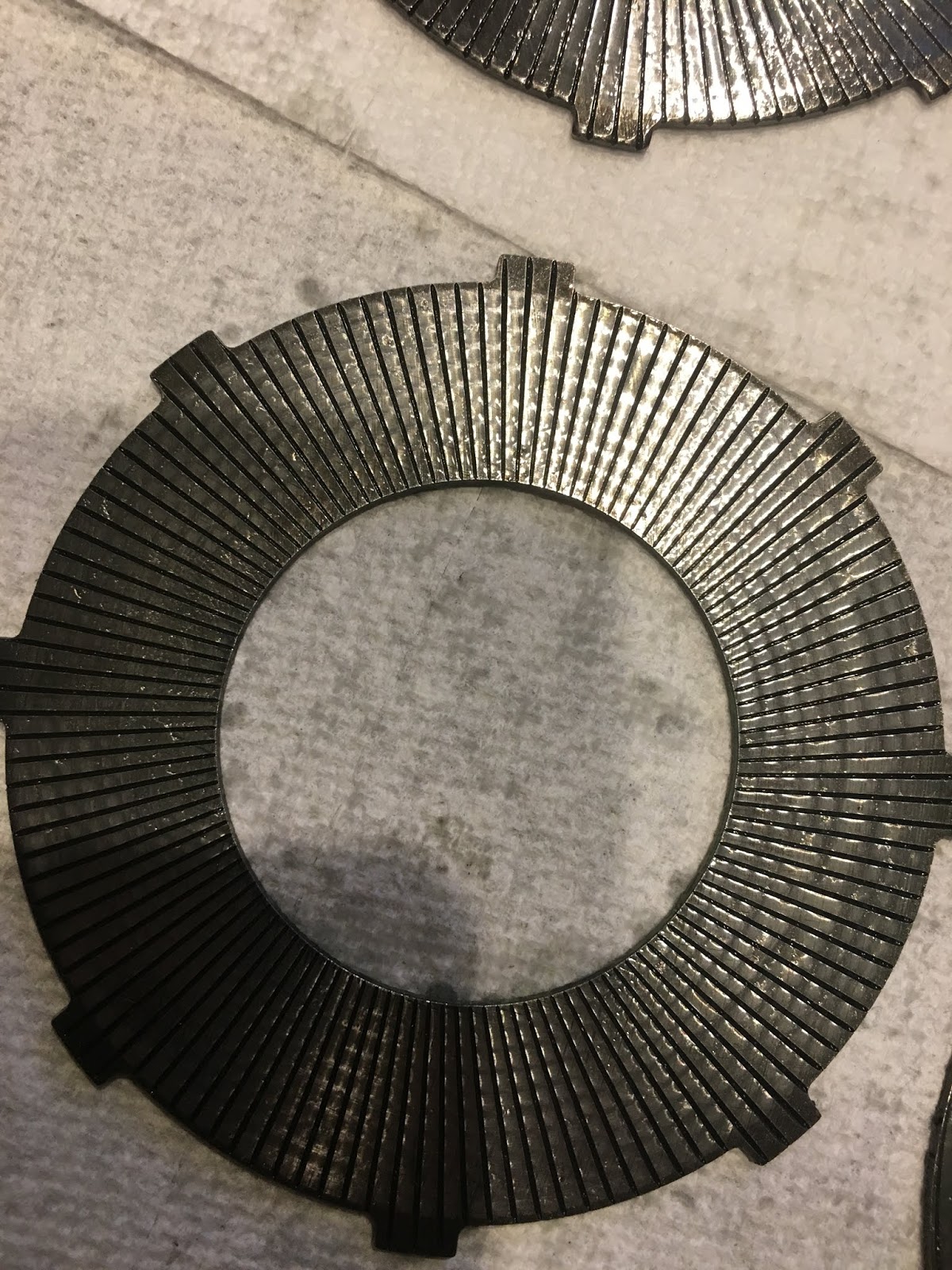

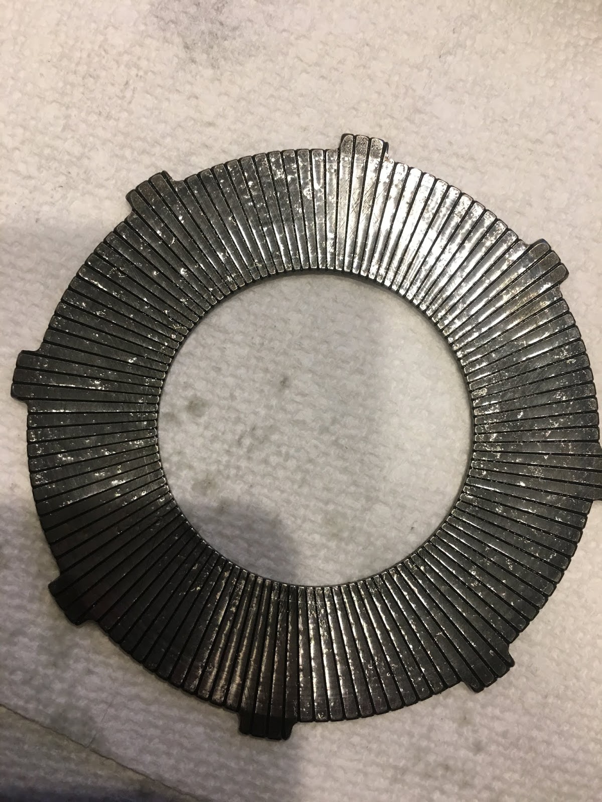

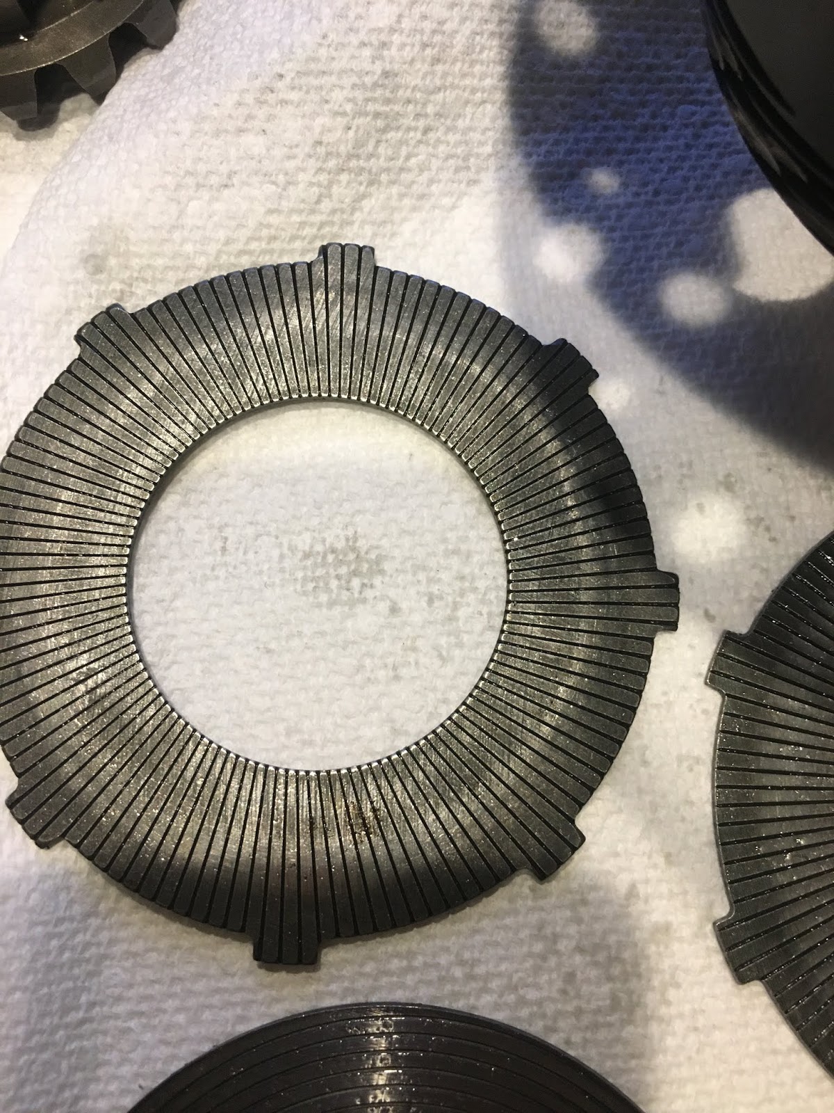

Here are some pics of the clutch plates I used-- Kaaz said they were no good. I used them anyway.
figured it'd be good to share wealth of knowledge...
Car handles MUCH better with this new diff OMG. Hanging on the outside of turn 1 at Lime Rock Park where all of the clag and debris is from peoples' tires and dirt is now possible at speed. It makes the clunking sound under load at low speeds which is normal. I'm running Torco RTF trans fluid.
Can't think of much more to add.
