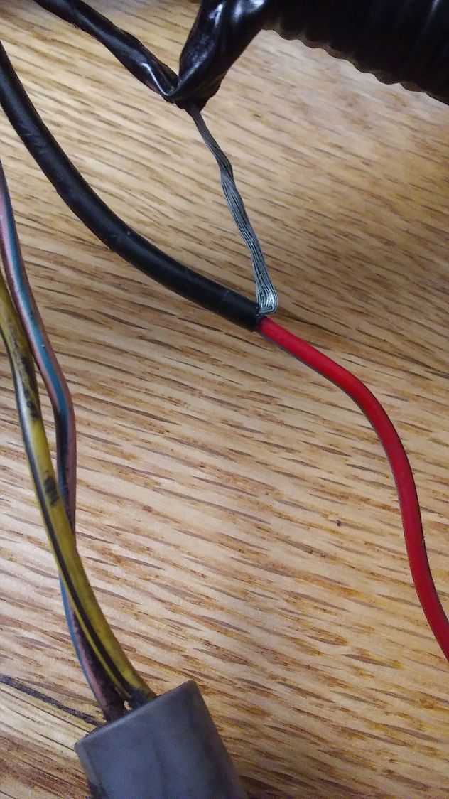

I'm just finishing up a swap going over engine harness and re taping the loom. I have a single red/blue wire I'm unsure of its right next to were injector loom branches off? supposedly an 0bd1 gsr harness

Knock sensor. The braided shielding is a dead give away.
