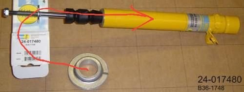

Oh...did you get rid of the stock style perches that came with the B6?
There aren't any lowering springs that fit flat perches like those for your GC's.
Pro-kits look progressive in the same way as ITR springs do. Dead coils to take up space, mostly. If you can find the stock spring style perches, ITR springs would be a good alternative to aftermarket.
QA1 makes progressive flat bottom springs if you think they'll help. Summit sells them.
Or see if H&R will sell you the progressive springs from their street performance (Bilstein shock based) coilover kit...though they may be that weirdass 70mm ID that bilstein loves to use.
Flat bottom springs are CHEAP. Look on ebay or summit racing. They're like $30-50 each, usually. Just figure out your current spring ID (probably 2.5"/65mm).
They're called coilover springs. Or universal coilover/race springs.
Try like a 12" long 150 or 200LB/IN flat bottom spring.
I'd be more tempted to use 150's. But...again, springs are cheap.

I'm not following what you mean about the perches.
You can just remove the GC sleeves and put on the stock spring adapter that came with the shock, right?
Like...remove the GC sleeve thusly:
Install the stock spring adapter thusly:
Yes?
You cannot (absolutely not) use pro kits or any other lowering spring on flat mounts. It won't work.
People use pro kits using the stock spring adapter that comes with Konis and Bilsteins.
See?
eBay doesn't make springs.
But eibach, hyperco, stance, QA1, and other makes of reputable springs are sold on eBay. New or used.
Summit also sells said brands. QA1 and Summit's house brand springs (also made by QA1) work great.
Yes?
See?
I could do that but then I loose my height adjustability, which defeats the whole purpose of everything.
I realize the pro kit has a rounded coil on each end, but if the end coil is flush with the mounting surface, wouldn't it work? I realize if the end coil is helical, it won't work properly, but I have yet to see a picture of an EG specific pro kit spring off of a car, so I can't say for sure.
I guess I am unclear on the "purpose of everything". That's deep AF.
For the sake of THIS subject, though...I am unclear on why you want pro-kits specifically.
No...you cannot use them on a flat perch.
-They will sit tilted off to one side. This will put a lot of side load on the shock seals.
-I don't think stock shape springs (like pro kits) have a constant diameter.
-Springs undergo torsion (twisting) as they uncoil and recoil. How will that work out with a pigtail spring on a flat perch? Badly.
-etc.
Think about it. If flat perches "should work fine", then why would Honda spend money to design stamped spring perches that have features to seat the pigtails?
Why would aftermarket companies (even ones who make absolute shitbag bottom dollar shocks) spend money on stamping out the perches so that they seat the pigtails?
What is your apprehension to previous suggestions? Your choices seem very very pointed...but you're providing vague details. Help us help you.
The easiest thing to do is buy softer linear rate springs.
If you want progressive springs that have flat bottoms: QA1 makes them.
If you want Eibachs ONLY: Pro Kits and stock perches.
If you ALSO want adjustment: Make your own compound setup using Eibach tender $pring$, Eibach $pring coupler$, and a shorter flat bottom Eibach spring.
Note the dollar symbols.

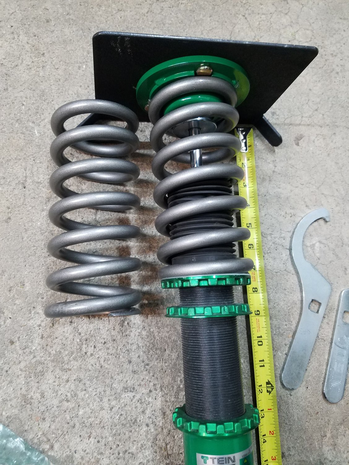

Preload is a misused word. Each rear corner of the VX is 380lbs-ish. With 250lb springs i would have to compress the springs (with the wheel off the ground) about 1.52" in order for the suspension to be at 0 preload. Any more compression than that is TECHNICALLY preloading the car and increasing the over all rate of the suspension and will make the car much harsher. Even if I adjust the sleeves ALL the way up, I only compress the spring about maybe 1/2". Even so when the car is on the ground, it will have the same static preload with the 380lbs of weight on the 250lb spring whether compress the spring 1/2" or slam the car and leave huge gap that requires a helper spring. End result is the same....380lbs of weight sitting on a spring that is compressed 1.52" If I compress the spring 1/2" in the air, the spring will drop an additional 1.02" on the ground.
Preload is word to describe the LOADING of the spring PREvious to setting the car on it.
You preload the spring on a bench to some amount.
You space between the lower spring seat and the tophat spring seat is less than the length of the spring.
Its pre-compressed.
That's the definition of preload in this instance.
The spring on the right is preloaded about 0.75".
You cannot change rate by doing this. You are adding a set amount of LOAD to the spring by pre-compressing it.
Also....
A VX weighs 380LB per rear corner. Maybe? But that's total weight. Not sprung weight.
The rear suspension also doesn't have a 1:1 MR.
Each rear spring probably is supporting like...450LB, though. Sprung weight is probably like 300LB. MR is probably 0.67 (guesses). 300/0.67 = 450.
