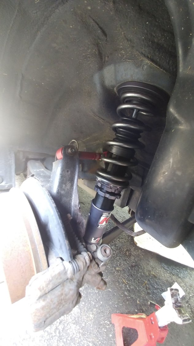

Due to there being a lack of reviews on the K-tuned k1 street coilovers for the EK/EM1 chassis i decided to write this up to help others who are in the market for coilovers. These were installed on my bone stock EM1. Currently they have been installed in my car for about a month and close to 2,000 miles. Upon unboxing the coilovers themselves they seem of pretty good quality and everything feels pretty sturdy as do the wrenches that come supplied with them. The part where other coilovers may come on top is where the adjuster for the dampening is built in the actual coilovers, these come with individual allen wrench style ***** which are inserted at the top of the shock. Once installed I left the settings for dampening all the way soft. When they were installed, both front and rear Truhart camber kits were installed for performance and eliminate tire wear as were inner and outter tie rods. There rest of the suspension setup is stock including the sway bars and bushings.
When on the street finally, the ride (settings still full soft) felt kind of soft/mushy which the alignment being far off could have added on to it. I turned the front adjustment ***** 10 clicks in the front and 8 in the rear. This gave me a ride practically identical to the factory ride I had before which was what I was looking for. This ride seems to be a bit stiff which can be a bit harsh and mildly annoying if you constantly drive on bad city roads (I live in the Chicago suburbs). Once on the highway the ride feels much better and smoother and can easily be taken on a road trip without getting annoying. Cornering has improved drastically and therefore I can take corners much faster. The summer tires I have also help which are Dunlop Direzza DZ102 205/50R15. A month and almost 2,000 miles later I checked the settings and the left front had moved. I returned it to soft to count the clicks and I counted 7 (originally set to 10). The rears had moved to a stiffer setting but I lost track of where they had moved to. I set the front back to 10 clicks from soft and the rear to 7 clicks from soft. The lock rings were still tight and had not come loose at all. I will be going to the track in 2 weeks and will be messing with the settings there and will try and do an update.
Overall I would recommend these coils for the regular enthusiast looking to maintain a close to factory ride with a moderate drop as I don't know how it will ride when slammed. The goal of mine was to still be comfortable but had a good handling and good looking EM1. These are more expensive than a lot of other coils in the market such as Function & Form Type 1 and Type 2 as well as Skunk2 but I feel that the ride quality might be a bit better on these for the price. (correct me if I'm wrong). Anybody else that has these on their EK's let me know how your guys' experiences have been.
*UPDATE* So i was able to go to the track, Autobahn Country Club in Joliet, Ill (North Course) and besides being fun i got to see what the car could do. Before the first session if i can remember I set the front settings to 16 clicks from soft and the rear to 12 from soft. The ride itself was still pretty good, no complaints, but a bit stiffer obviously. Cornering was not bad, a bit of negative camber would have definitely helped as the alignment is set to spec. After the first session i was planning on stiffening up the coils some more but got distracted and left the settings alone for the rest of the day. Overall the car held its ground for what it is. The seats on an EM1 don't have the best side support so having your body getting thrown around does take away confidence. I did drive the car on the street at these settings for a couple of days and occasionally it got annoying over rough roads as it was a bit stiff (not bouncy) so i dropped the settings back to 10 in the front and 8 in the rear for a near perfect ride.
Yes the lock nut did get tightened.
